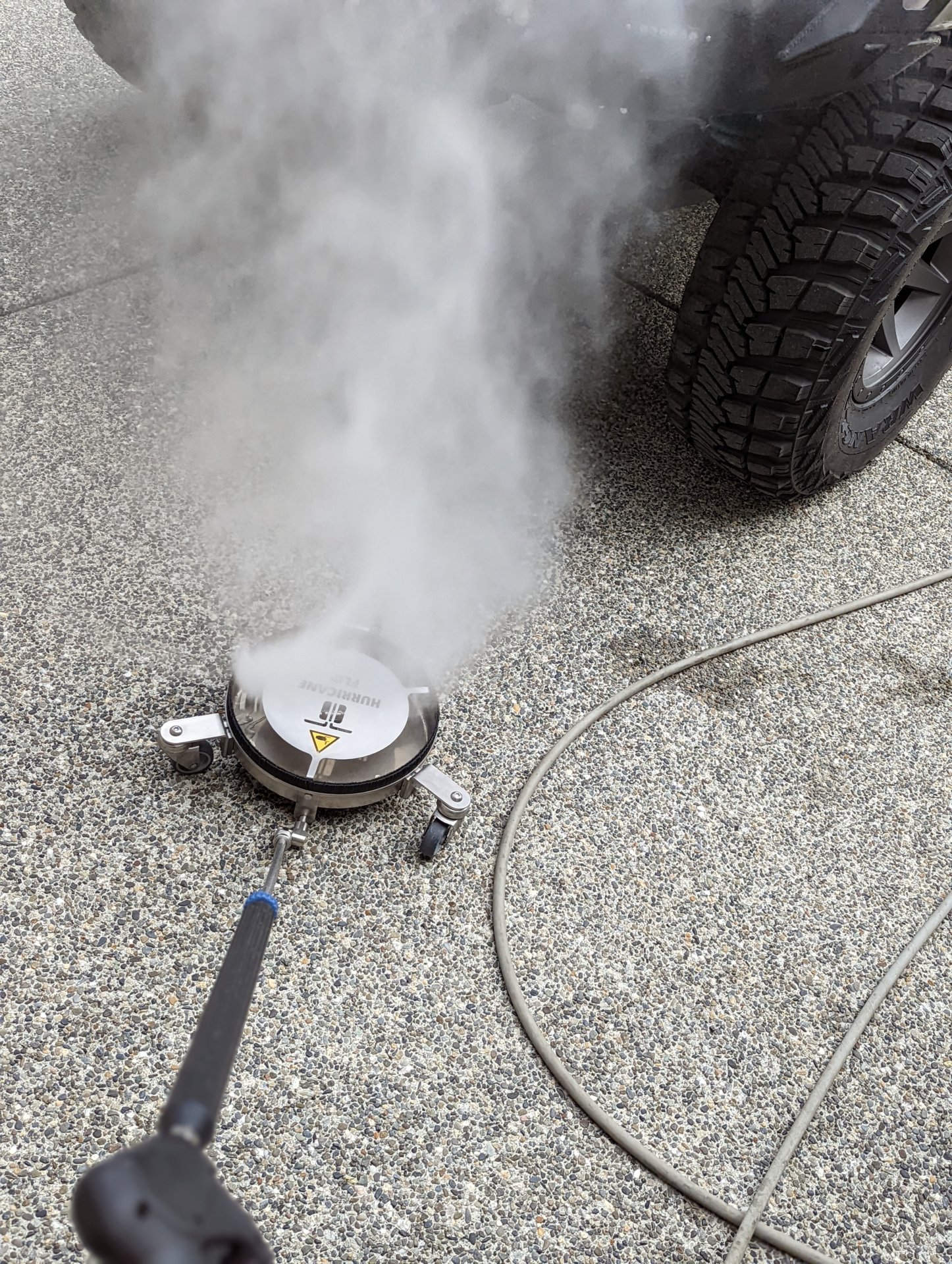

Mosmatic Hurricane Flip does a good job of getting where you can't with a regular pressure washer wand. Probably one of the better investments I've made for the truck.
Oooh I like that
