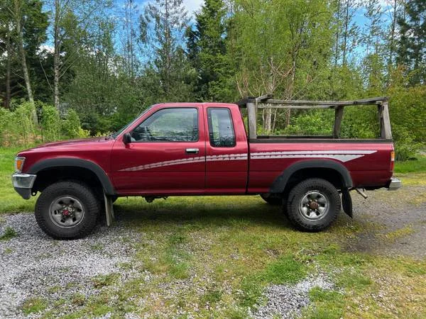

I recently picked up a 1990 4WD DLX Extended Cab Pickup to add to our motor pool. I have a thread about endlessly baselining my 94 LC over in the 80 Series Tech...but its long and rambling. I'm going to shoot for brevity here.
Photo was from the CL post. Manual transmission, 279K. I bought it from my kids friends Dad. He used it run his fruit tree pruning/ landscaping business. Paid 7k.

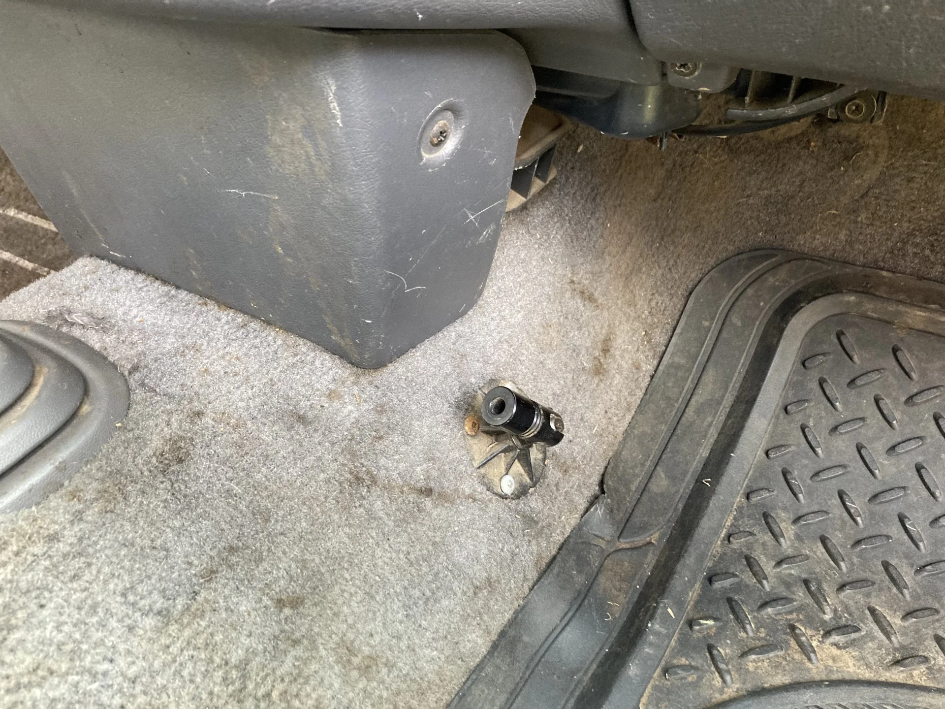

Mystery fitting on transmission hump (with details of mildew grime)

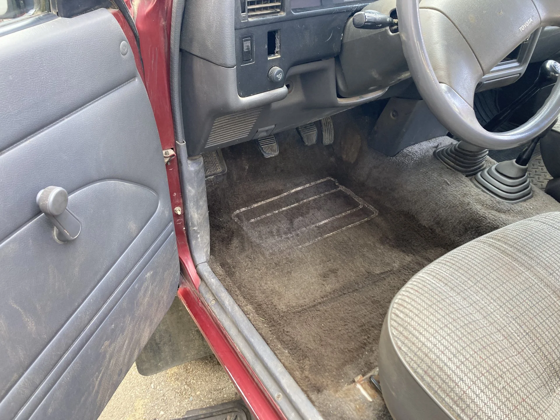

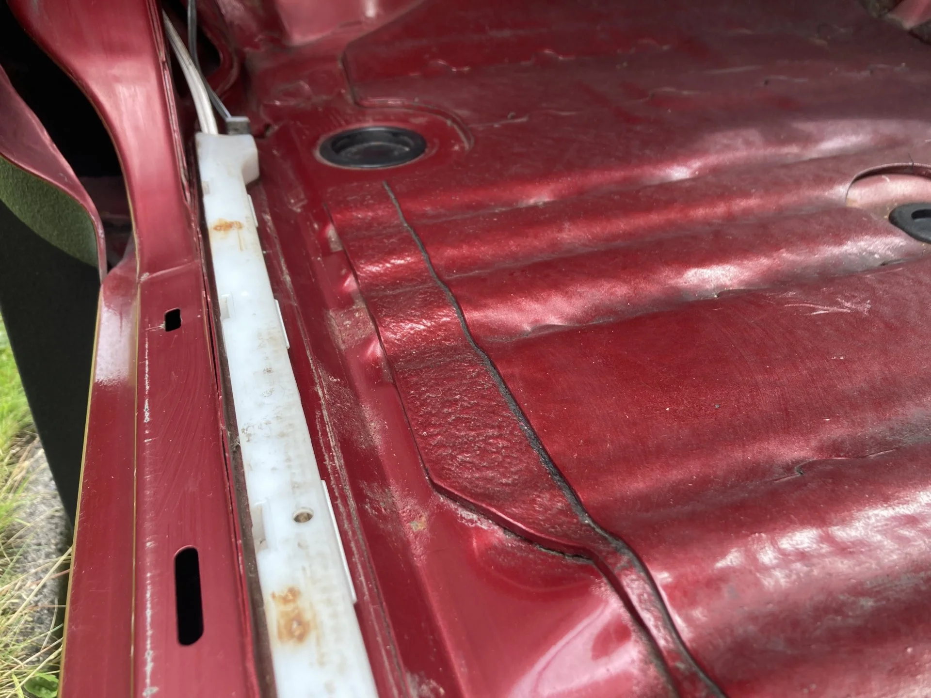

Took a bit more time to hunt after the water leak. I decided that I just needed to pull the carpet and clean out the cab and look for pooling water that way. The carpet was gross, and falling apart.
I gave it a good clean with the seats out. Vacuum, then simple green 3:1 with a brush and then a second vacuum pass. Fortunately there isn’t any huge hidden rust holes….but I think there would have been.
I’m no expert, but this looks like the beginning of big problems. I’m planning on removing the paint in all the bubbled areas, then sanding any remaining rust. I’ll then use a converter like Ospho then prime it before new carpet goes on. Undecided about converter and primer.

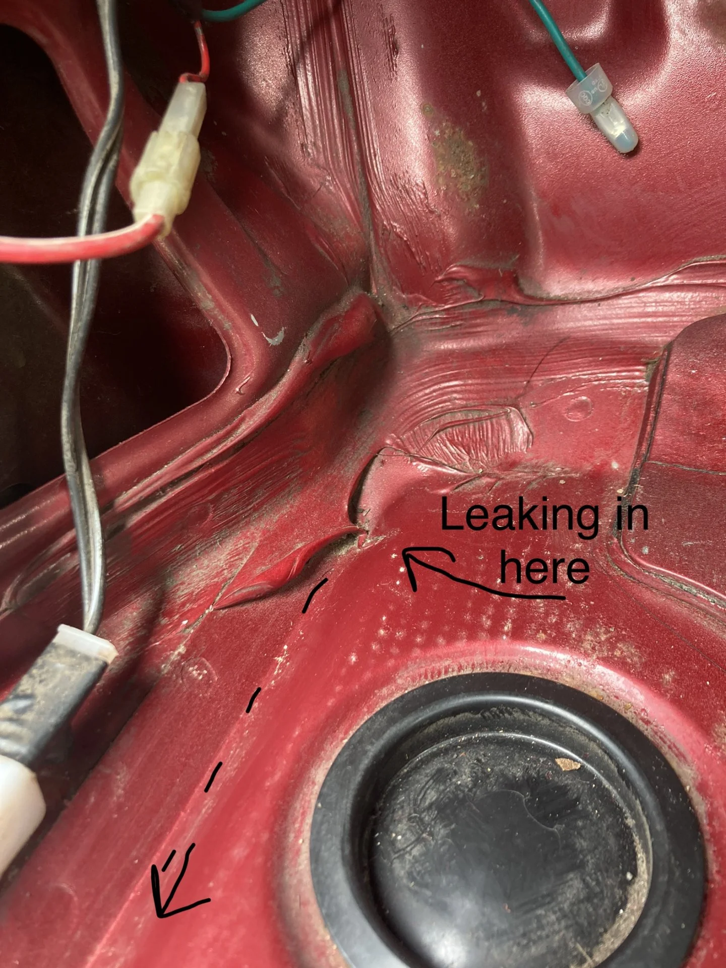

As for the leak, I think it’s come in from here:

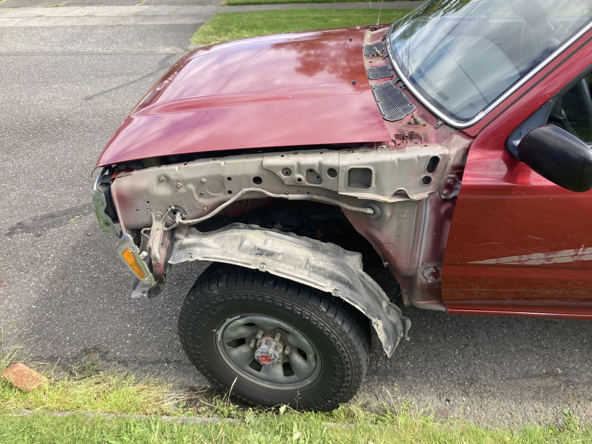

So I pulled the fender too.
I think there are a couple of places water can ingress to the cab through some rotted old seam sealer. I’ll need to confirm after cleaning up the dirt, blowing out the cracks and resealing with some 3m automotive seam sealer. I’ll update when I’m on to testing.

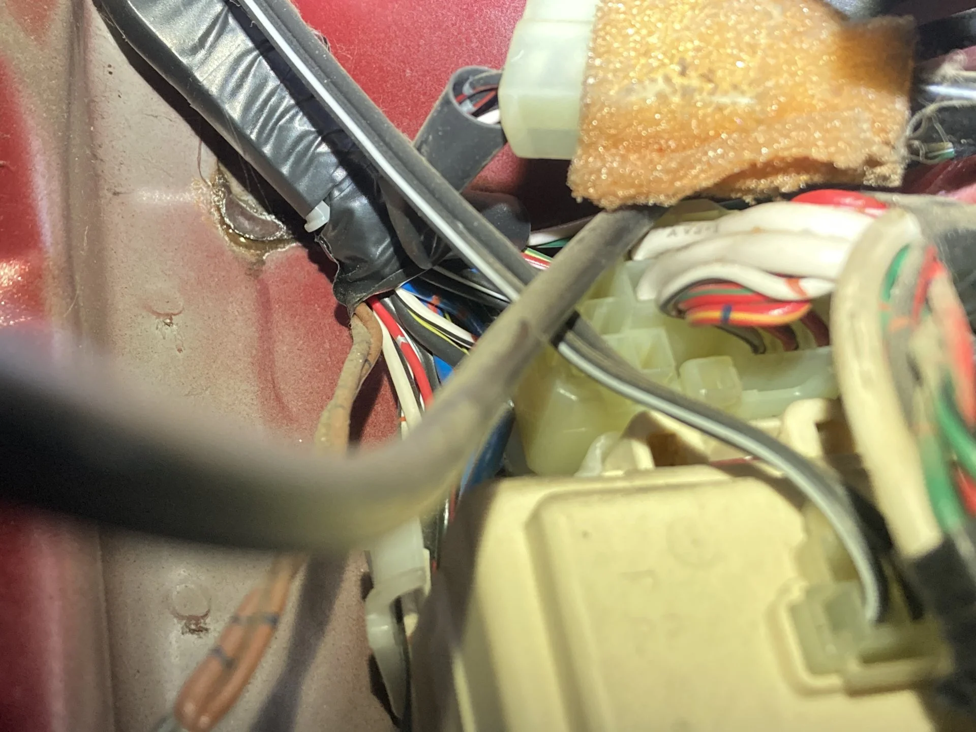

Ok I think ai found the leak. After running the hose slowly on the windshield for A couple of minutes I started to see water come i through these failing seams. The old brush on seam sealer has finally cracked and failed. I can’t remove anymore body panels at this point. So I’ll clean it up and goop on plenty of seam sealer when it arrives. I’m not sure it will solve the problem completely, but it might be the best I can do for this old pickup.
Water is seeping along the seam you can just see behind the wire loom in the upper left of the photo. While there is a water track there, most of the drip is coming down behind the fuse and relay block.
I’ll obviously be removing/ loosening a few things around here to be able to spread on more seam goo.
On the outside, under the fender, I did find a few places where the factory seam sealer has cracked and failed. I’ll hit all these places too and see how well that thwarts the leak.
Leak Free
After a heavy rain last night I confirmed my leak is solved. That feels good.
