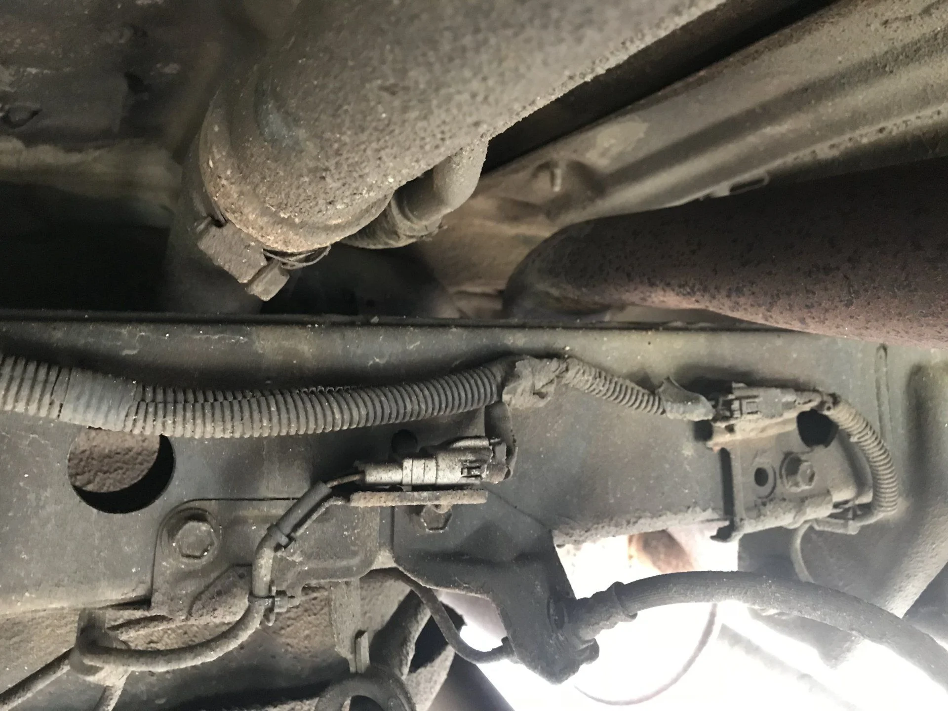

  • CEL-Oxygen Sensors replaced 2/10/18
  • CEL- Knock Sensors (both connectors are broken off and dangling) replaced both knock sensors 2018

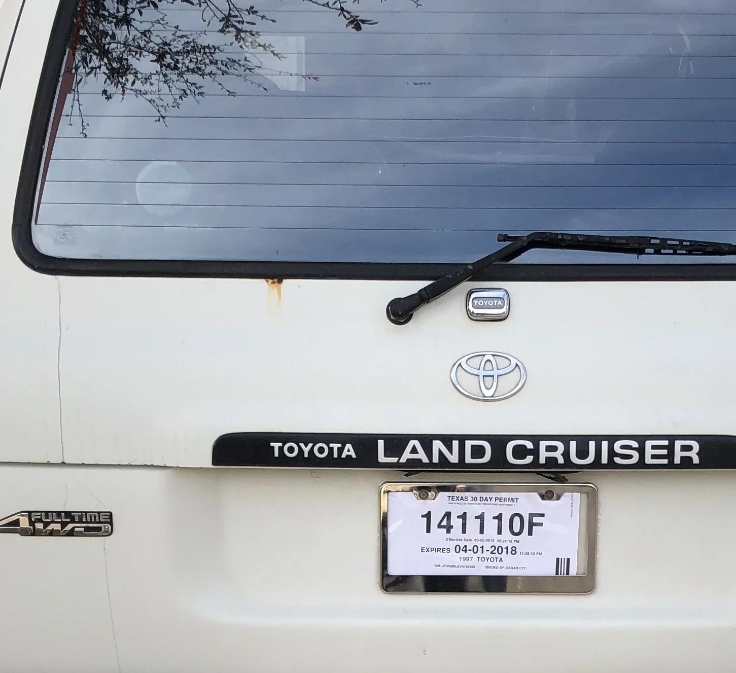

Yep mine is in the sameish spot, perhaps a bit less advanced. I haven’t searched that item on the list yet...it’s behind my giant spare tire which distracts me with its awesomeness. ;)
Can we compare rear window rust spots? I’m wondering if this is a common problem and if so, what is the cause.
For what it's worth, having looked at hundreds of for-sale listings, I've mostly seen it to the right of center. I have no idea why it happens. Mine had it, too. When I repainted, I just pried the seal up, went at it with sandpaper, hit it with rust converter, followed by a bit of body filler due to minor pitting. I'm not too worried about it since, in the worst case that it rusts again and worsens, the rear hatch is probably one of the most plentiful body parts to find in wrecking yards.
The correct way to deal with it would be to pull the entire rear window, wire-brush down any rust, epoxy prime, filler, seal, repaint, then reinstall with a new gasket. Personally, I'd probably use urethane sealant like what's recommended for the windshield. I wouldn't attempt any kind of in-place application of sealant for fear of trapping moisture and making the problem worse.

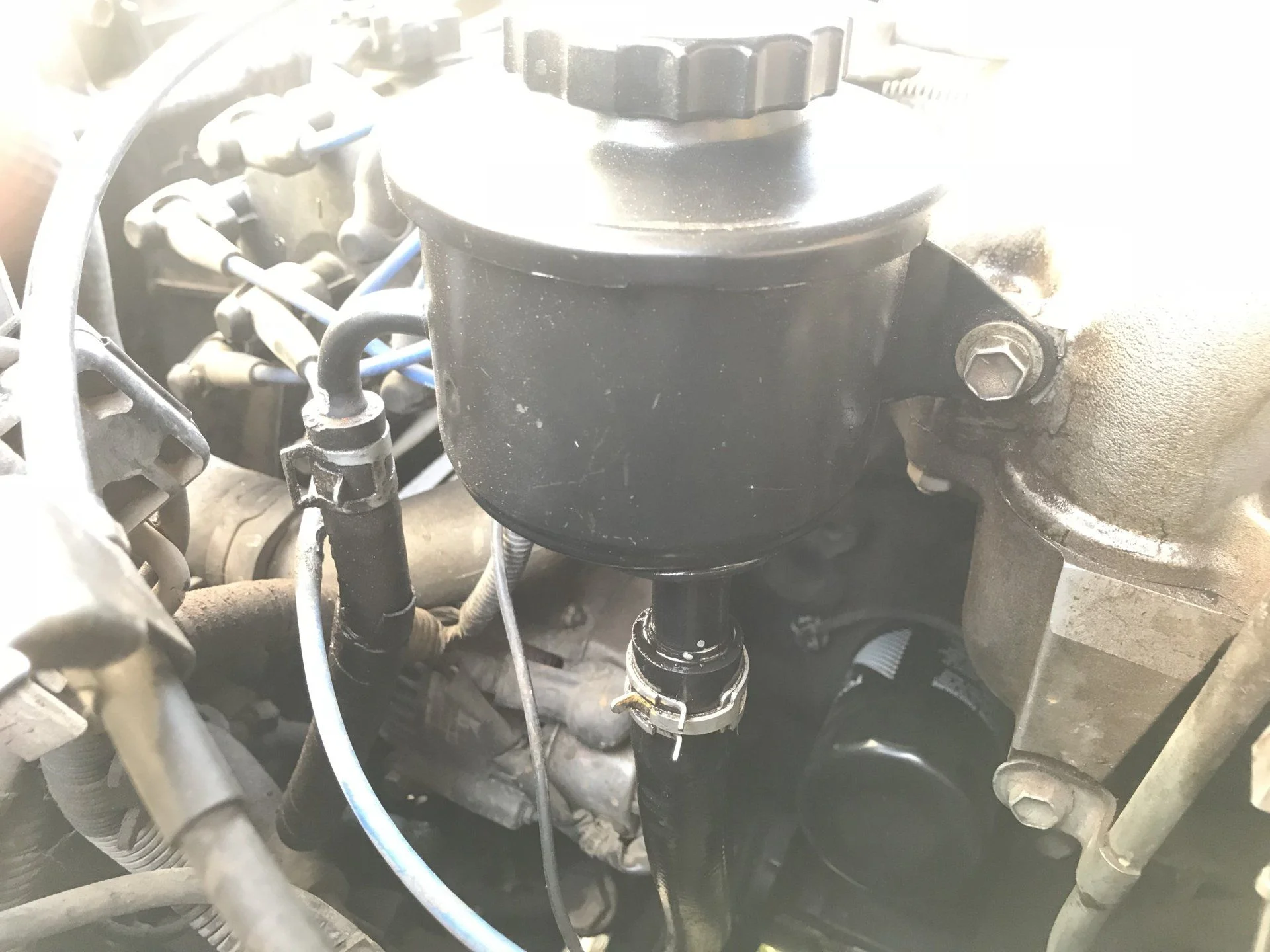

PS leak-I wiped off a huge amount of grime and PS fluid off of the reservoir when I brought it home. So far the only leak I can see seems to be coming from the larger hose which I believe is return hose. It's just a slow seep at this point.

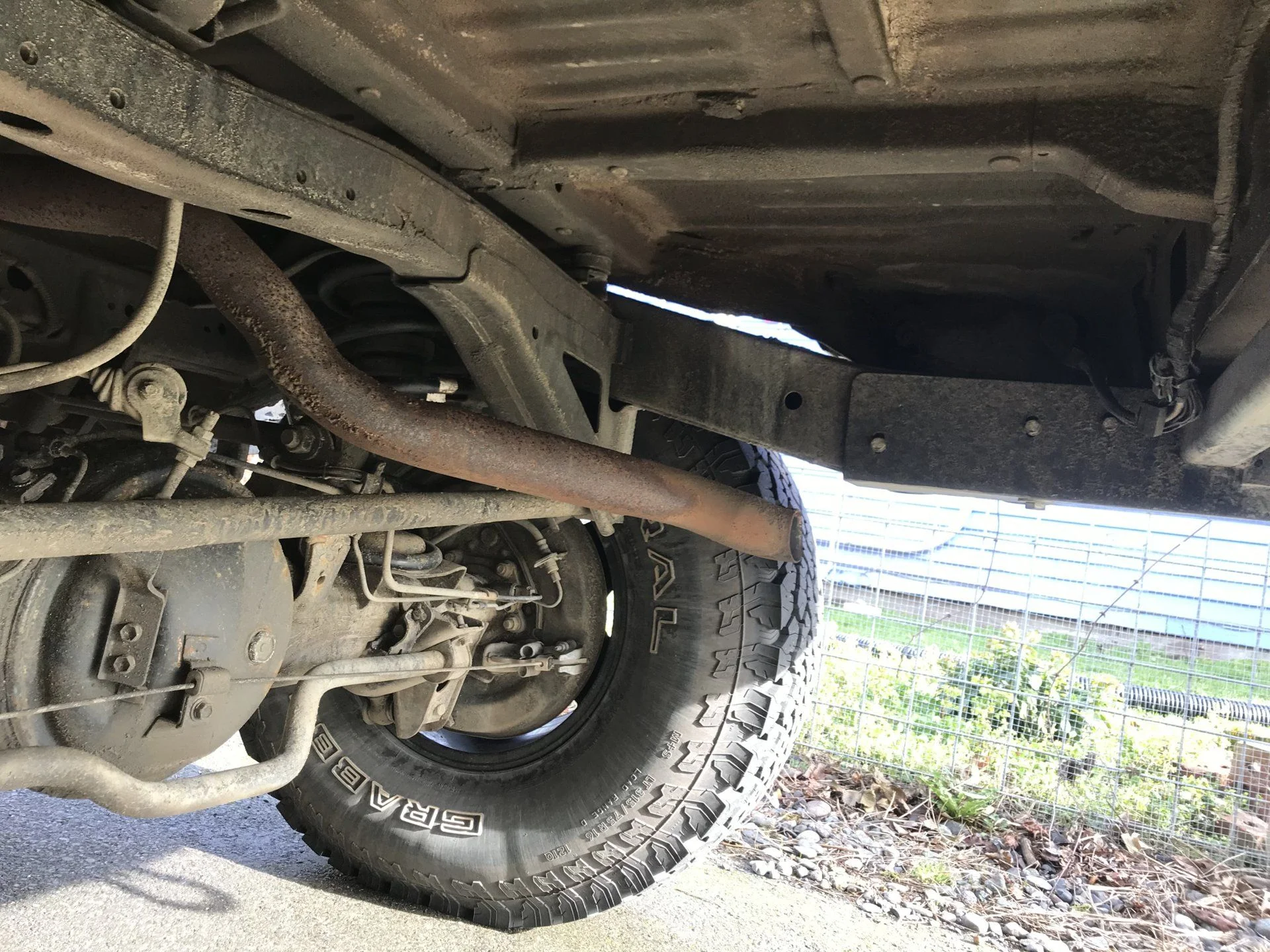

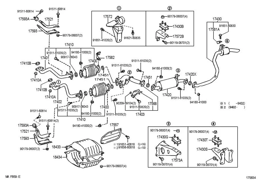

The exhaust hanger you show in your photo and bracket are missing, as is the tuner. The shop that installed the bumper elected to cut if off IIRC what the PO said. When purchasing the vehicle I attempted to contact the shop in Bend, OR that did the work, but they never got back to me. Needless to say seeing those things missing without a solution to secure the tailpipe is a little concerning.
The whole thing is loose and that sucks. It needs attention. I’m sure that the deformed tail pipe isn’t helping performance at all. Im not sure where the last bracket connects-is the bumper obscuring mounting holes? I'll search for a photo later...
