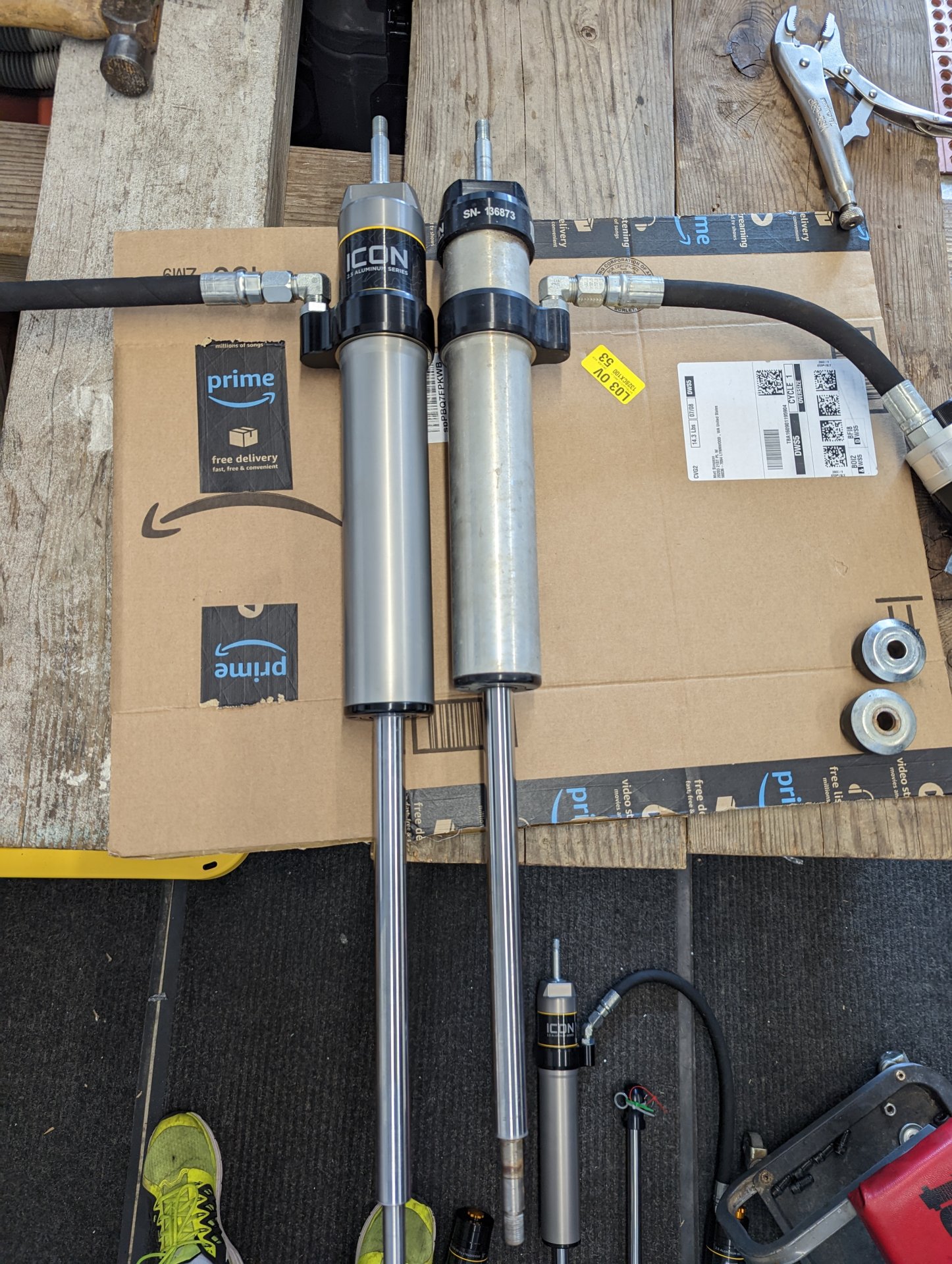

New Icon 4-6" lift shocks arrived - Fronts are on, rears look like they need to go back to Icon with the hose assemblies installed on the shock bodies upside down.
Fronts installed
Rears will have to wait - hose unions look like they're assembled upside down on the shock bodies.
For anyone interested. Here are the differences between the Icon 0-3" shocks and 4-6" shocks:
Fronts are about 1 3/8" longer. A little less than an inch difference in the bodies.
Rears are a bogger difference - about 4" longer overall. aAcouple of inches longer at the body.
What's the overall travel on the front shocks ?
What the overall travel on the front shocks ?
I didn't measure before I installed and realized that would have been a good number to have. I'll measure when I tear the front end down in a few weeks and put new radius arms in and spacers for the air bumps.
Icon 4-6" rears have 11 1/4" of travel.
