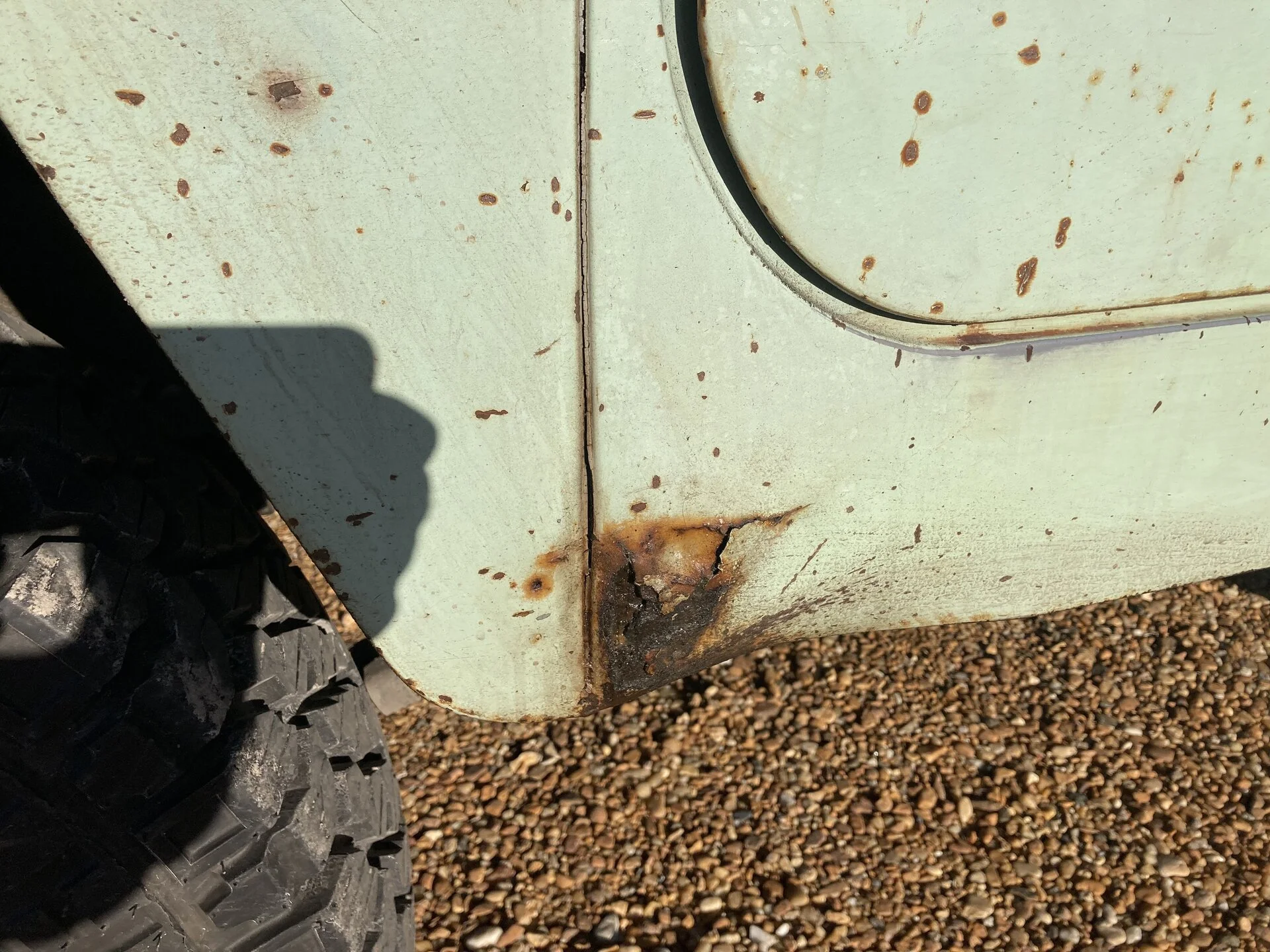

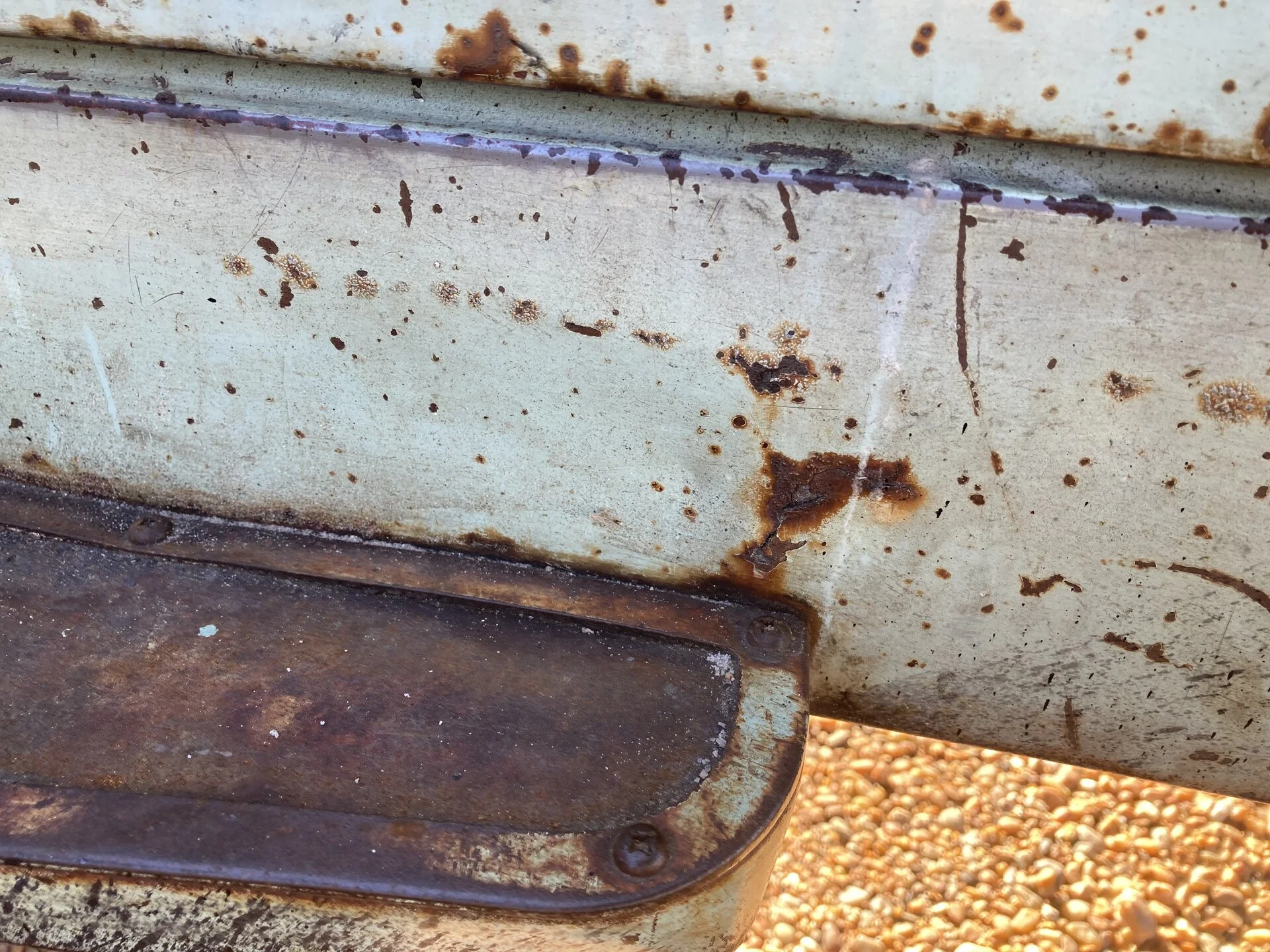

Engine discussion asside, Rachael is going to be at work tomorow so I need a project to keep me busy. I am planning on cutting and welding in new corners to my rockers. I have the whole outter rocker patches from CCOT. But I am thinking I am just going to make patches out of them that way I can leave some of the nice patina. Any tips or tricks from those that have done this? Looks like I have a few spot welds to drill out too. Here are some pictures for referen
This side is the worst.
Other side not as bad.
Ill need to make a patch here it looks like too.

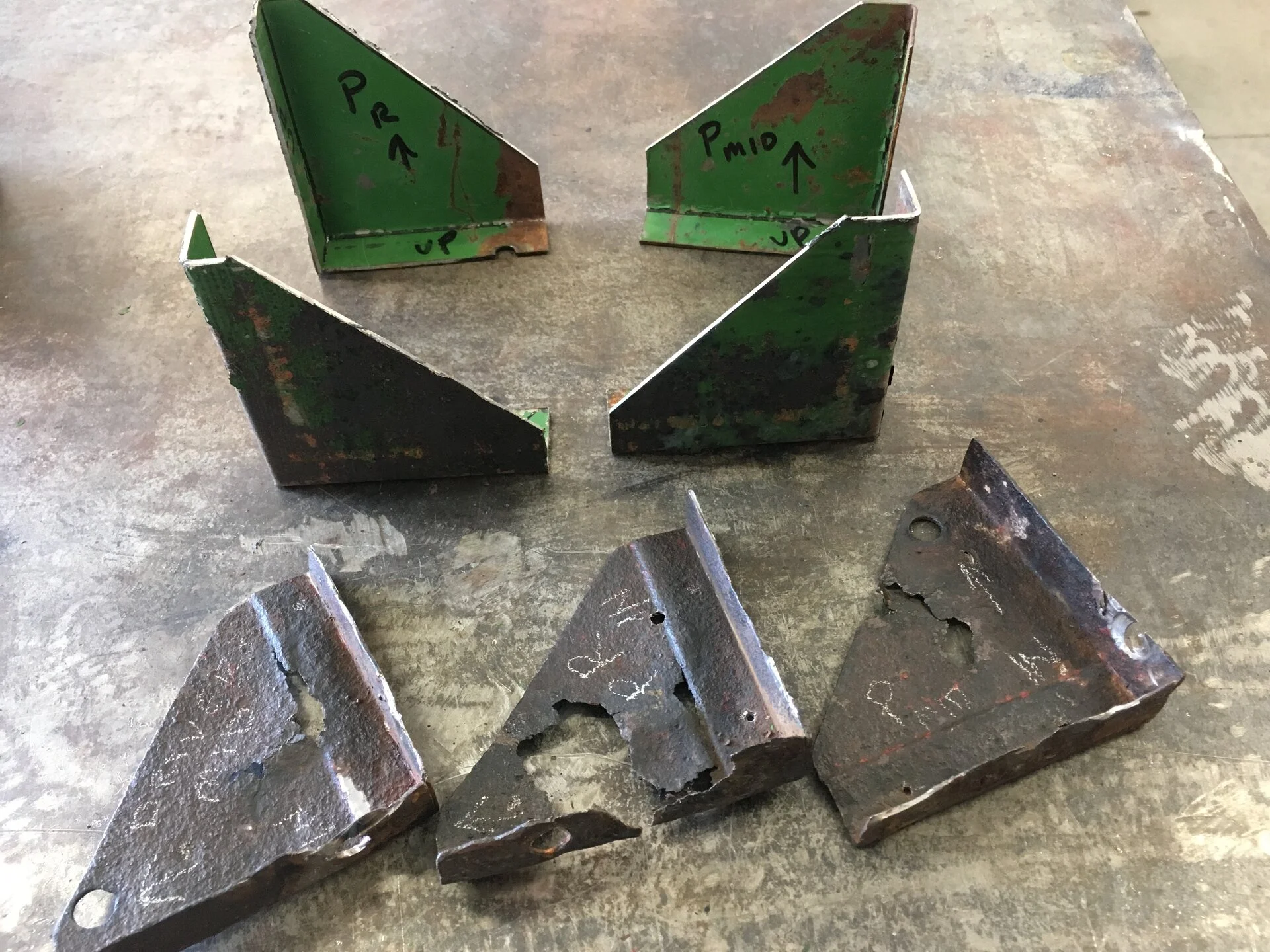

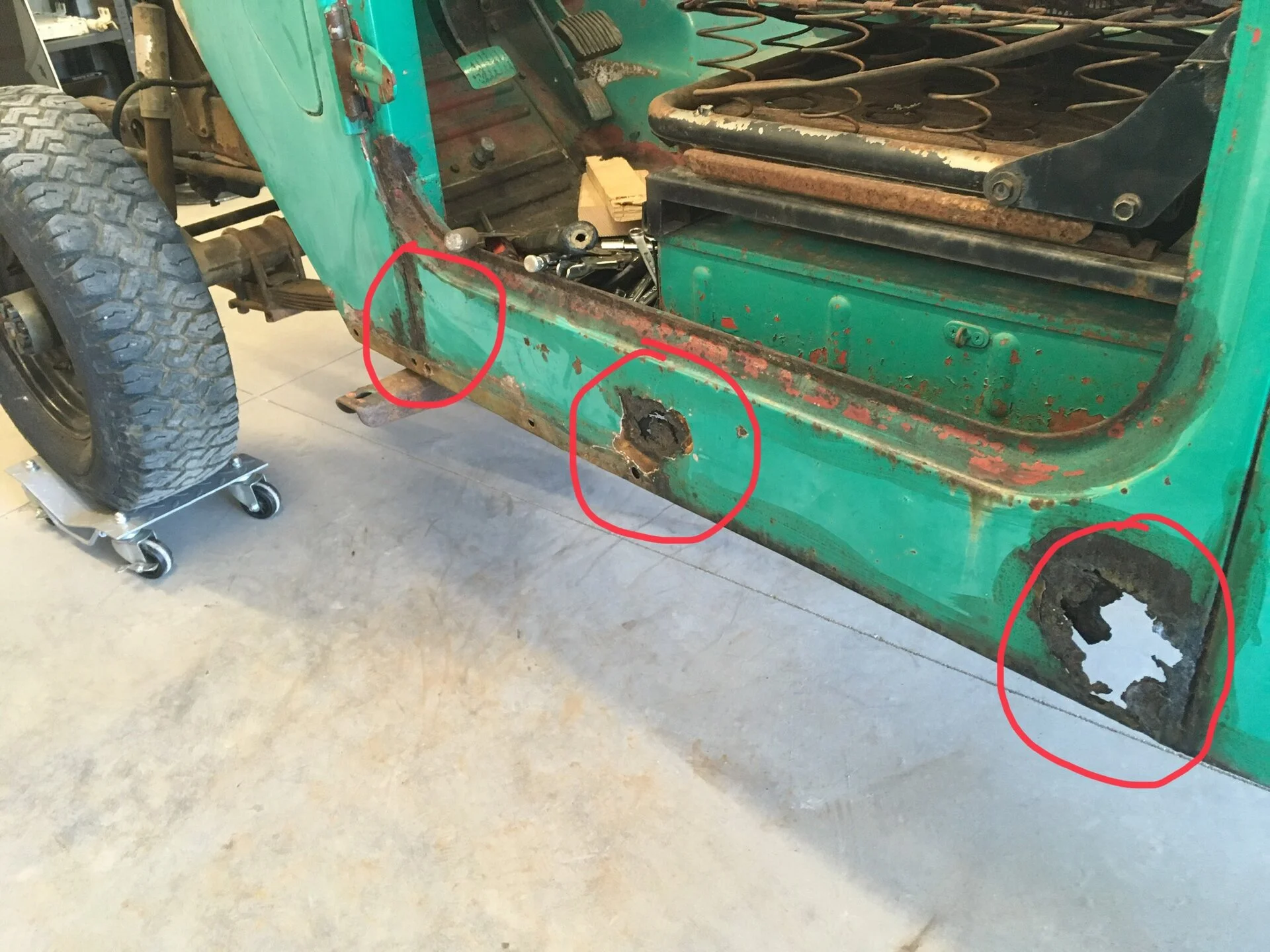

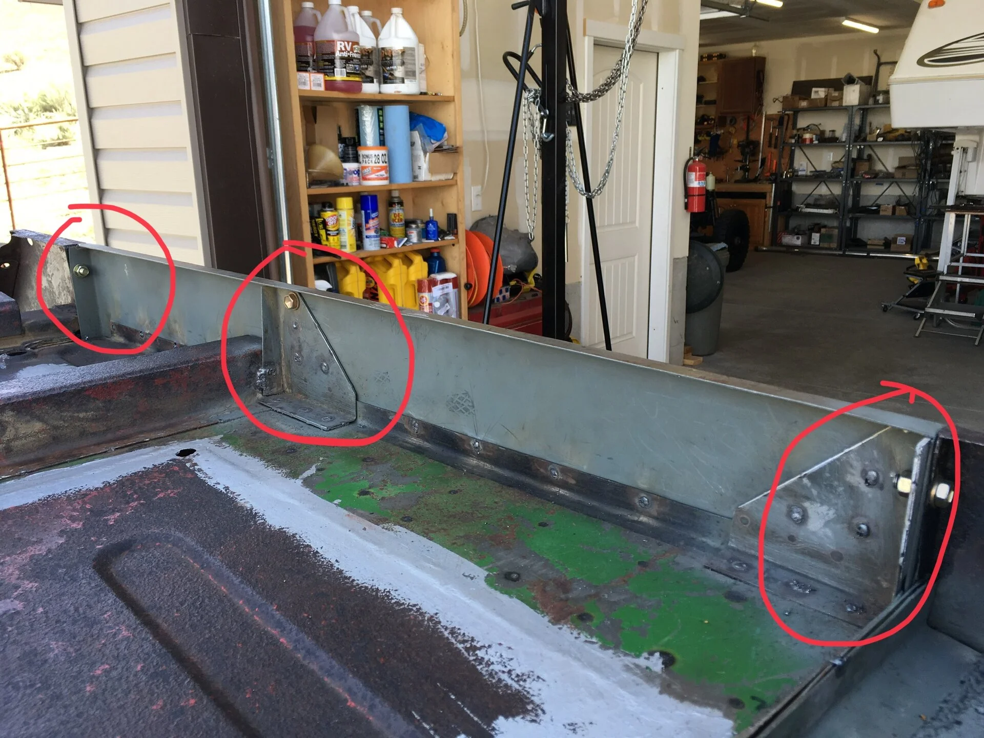

Heads up - have you looked at the backside of your rockers? Here’s what my ‘63‘s looked like (drivers - passenger was as bad if not worse). There’s substructure in three places that have caused misery for a lot of cruiser owners for years that might need to be replaced as well. I built all my own replacement pieces.
Yes, that’s John Deere replacement steel, nothing but the best 😂.
humm.... I have looked under there. I think one of them looked rough but the others looked ok. I may be making new ones as well. the driver side one is pretty toast I think. thanks for the heads up on this. I think I knew these were a thing but didnt think about it. But you are right I may be waiting till I can get some more metal to fab up some of these. Ill check the dump tomorrow for some scrap metal.
if it were me....I'd rock the small rust spots and patina and coat it in fluid film. will save so much heartache and headache.
rust has a BAD habit of hiding the worst on the inside.
I gotta fix it. It will drive me nuts if i dont. I can do it. If I can tackle that rear sill I can do this.

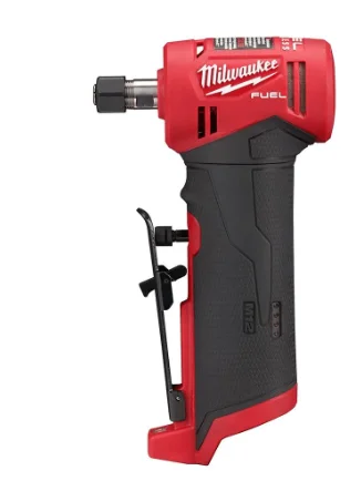

I was in the same boat - compressor too small and didn't want to invest in a larger one due to money and size.
Bought the Milwaukee M12 angle die grinder. It's a bit pricey, but has worked very well for my limited requirements. I get about 20 minutes 'continuous' use out of each battery, but I think you can get larger ones that will last longer. FWIW.

Milwaukee has a lot of nice battery powered tools. Seems like every pic in one of Nolan’s threads has a tool I haven’t seen and then think I need.

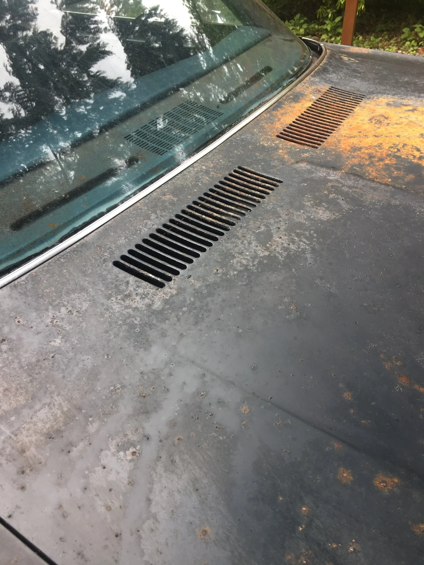

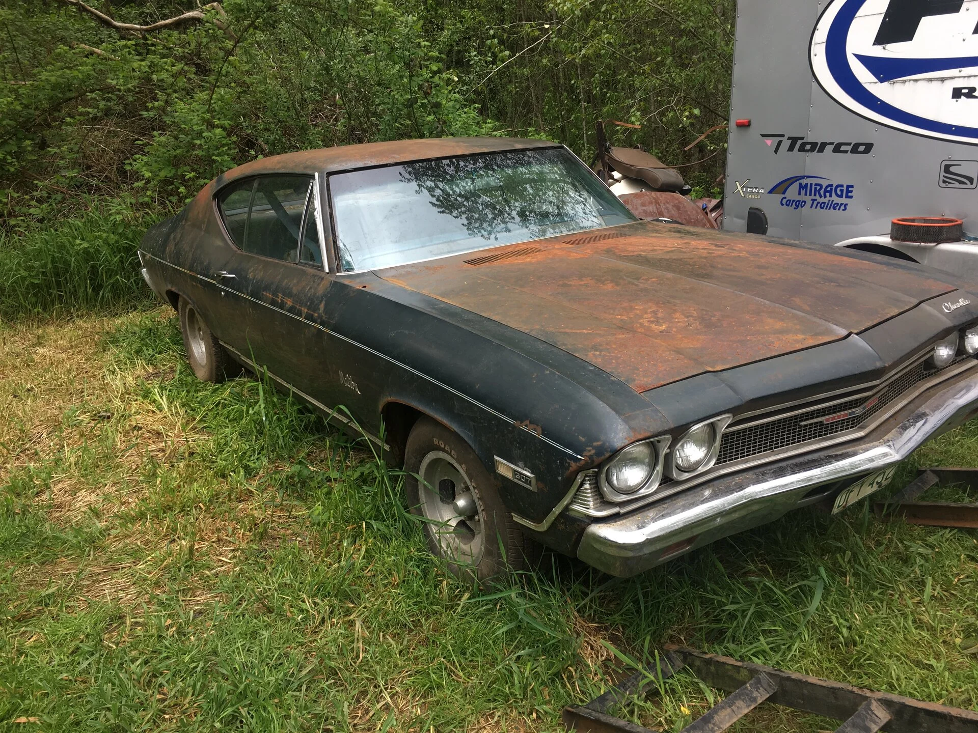

Here’s how my Chevelle hood turned out. This is literally just spray Ospho from a spray bottle and rinse off with a hose 7-10 minutes later. Was test spraying just that half of the hood.
Is that the original paint @Skreddy? Ospho will turn black (actually the converted rust) if left to dry but it looks like your approach of letting it sit for just a bit and then rinsing got rid of most of the rust but left the paint, correct? If so, nifty! Think you could now just wax over the top to seal? Nice chevelle!

Yeah I need one of these! I thought I had seen one of these someplace! exactly what I need. I also use a Milwaukee impact wrench. Its fantastic!
So I am waiting on some metal sheet to fabricate the structure on the back side of the rockers. Like @middlecalf mentioned above the rocker structure on the underside was iffy. I didnt start cutting into it yet because I dont have the metal to fix. Additionally it looks like it will be raining for the next 4 days here so I am glad I did not start.

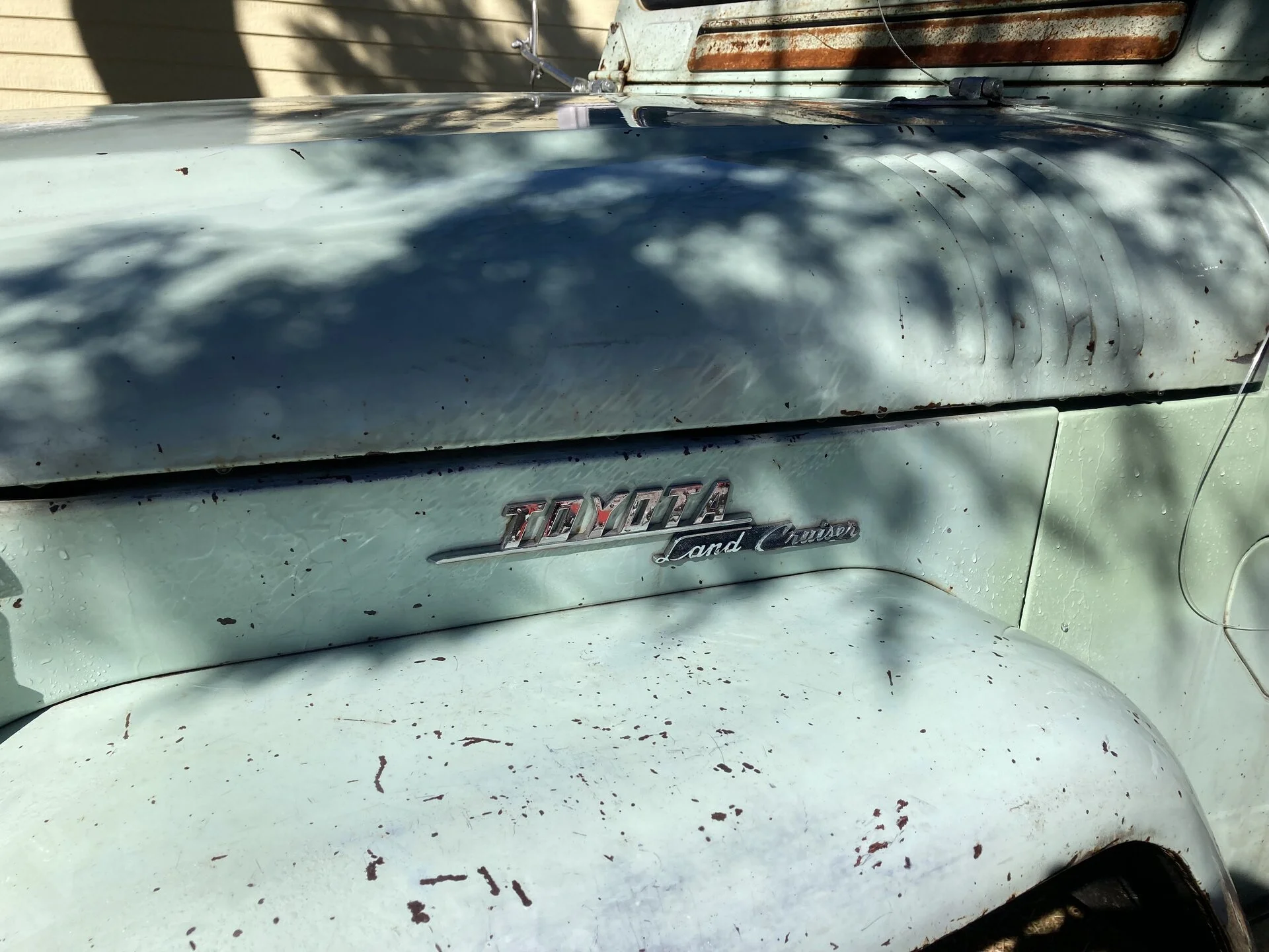

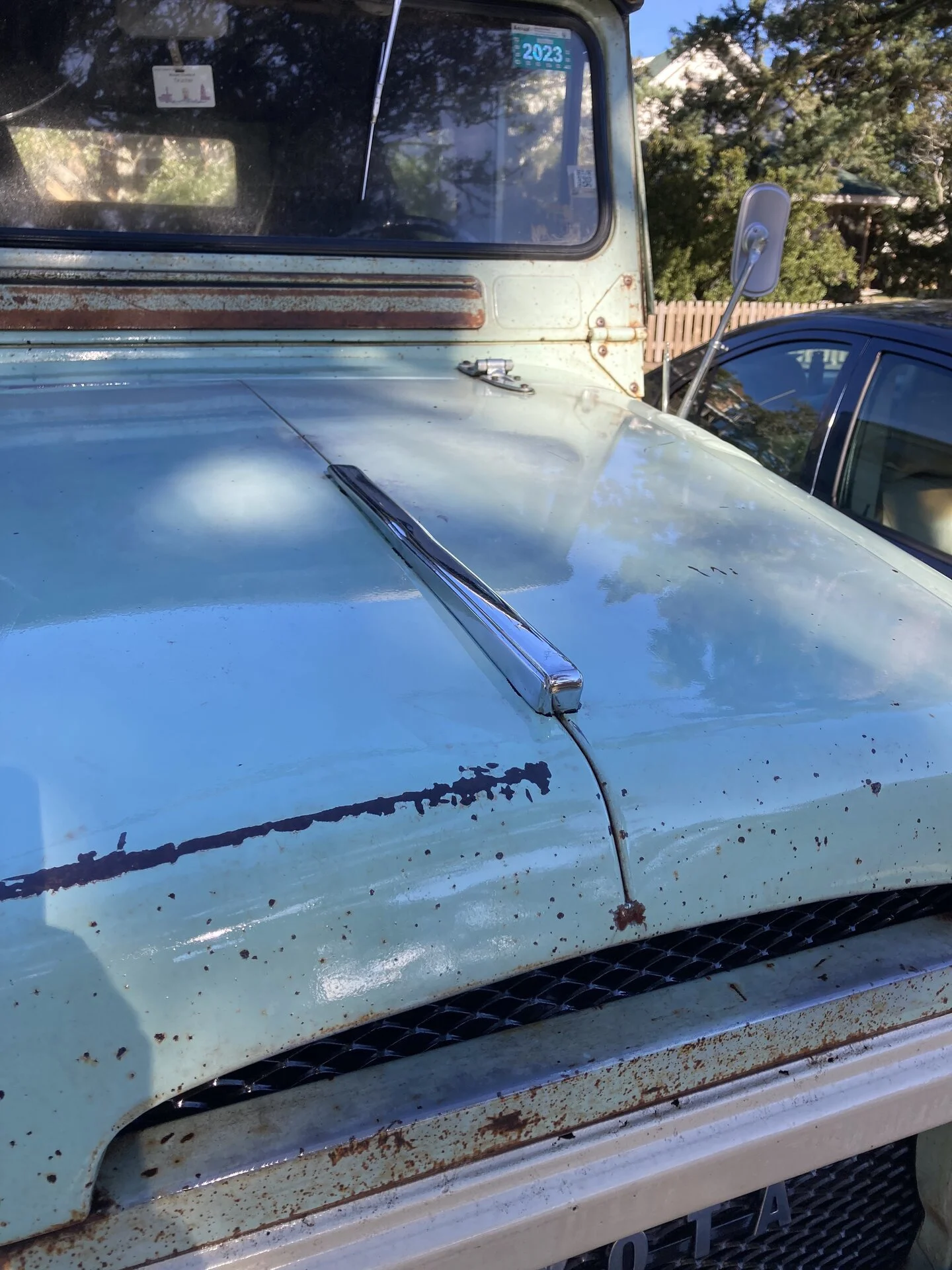

However I did scrub the old salt wagon with a sponge and some of this rust converter comit type stuff. The wagon is looking spiffy.

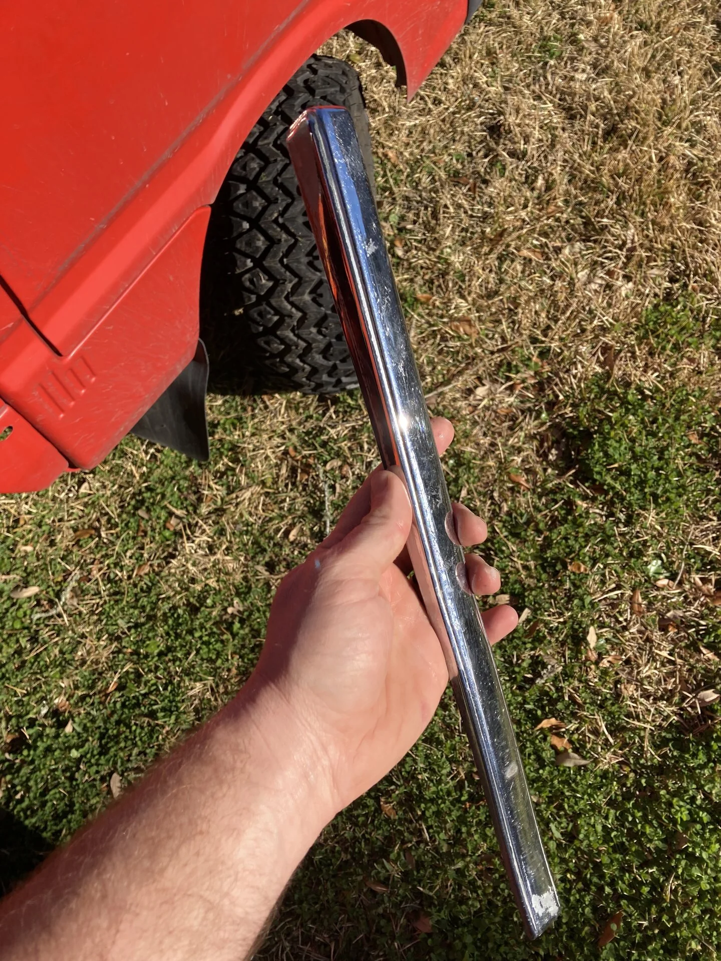

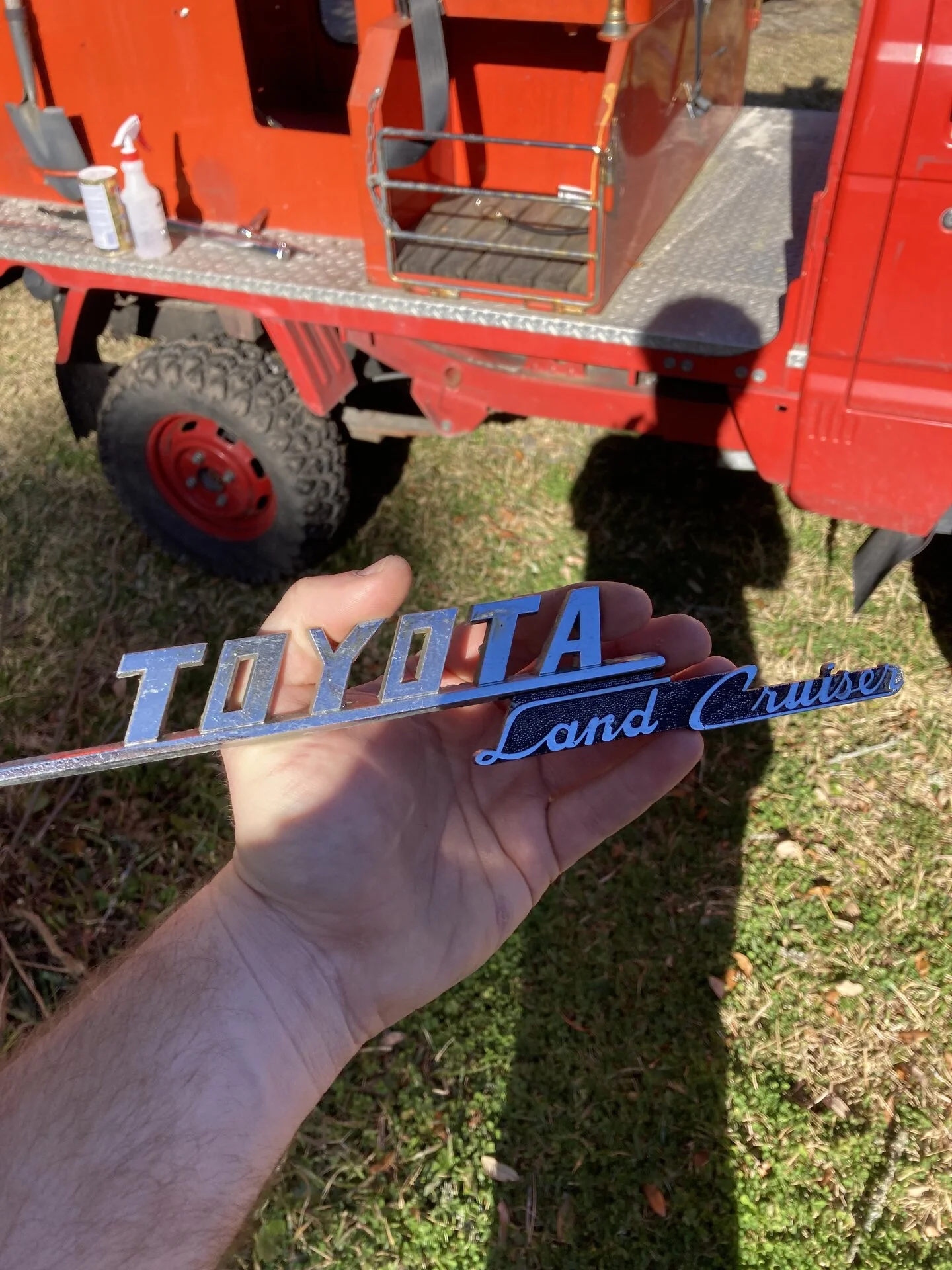

I cleaned the hood arrow and the land cruiser badges and now they look almost new as well.
I also used this stuff called flood Penetrol Oil-Based Paint Additive Conditioner instead of linsead oil. I think I saw this on a video about preserving patina on a volkswagon. It turned out really nice and it drys quicker than linsead.
