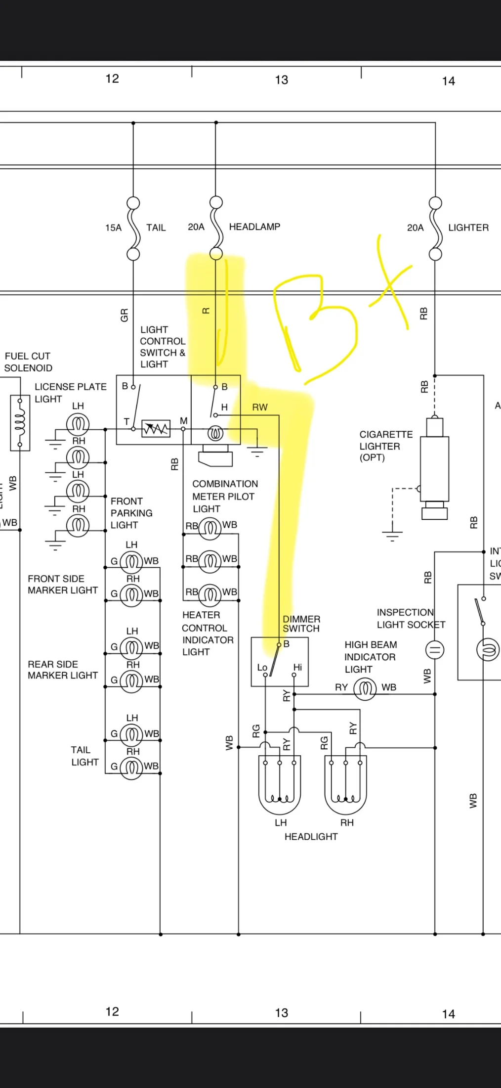

Should have a red power input to the headlight switch after the fuse. This will be always hot (battery positive)
Then red white output of the switch to the dimmer switch when switch is in on position.
If you have power all the way to the dimmer switch jump across the dimmer terminal from red white to red green (low beam) and see what you have. Also can go to red yellow (high beam)

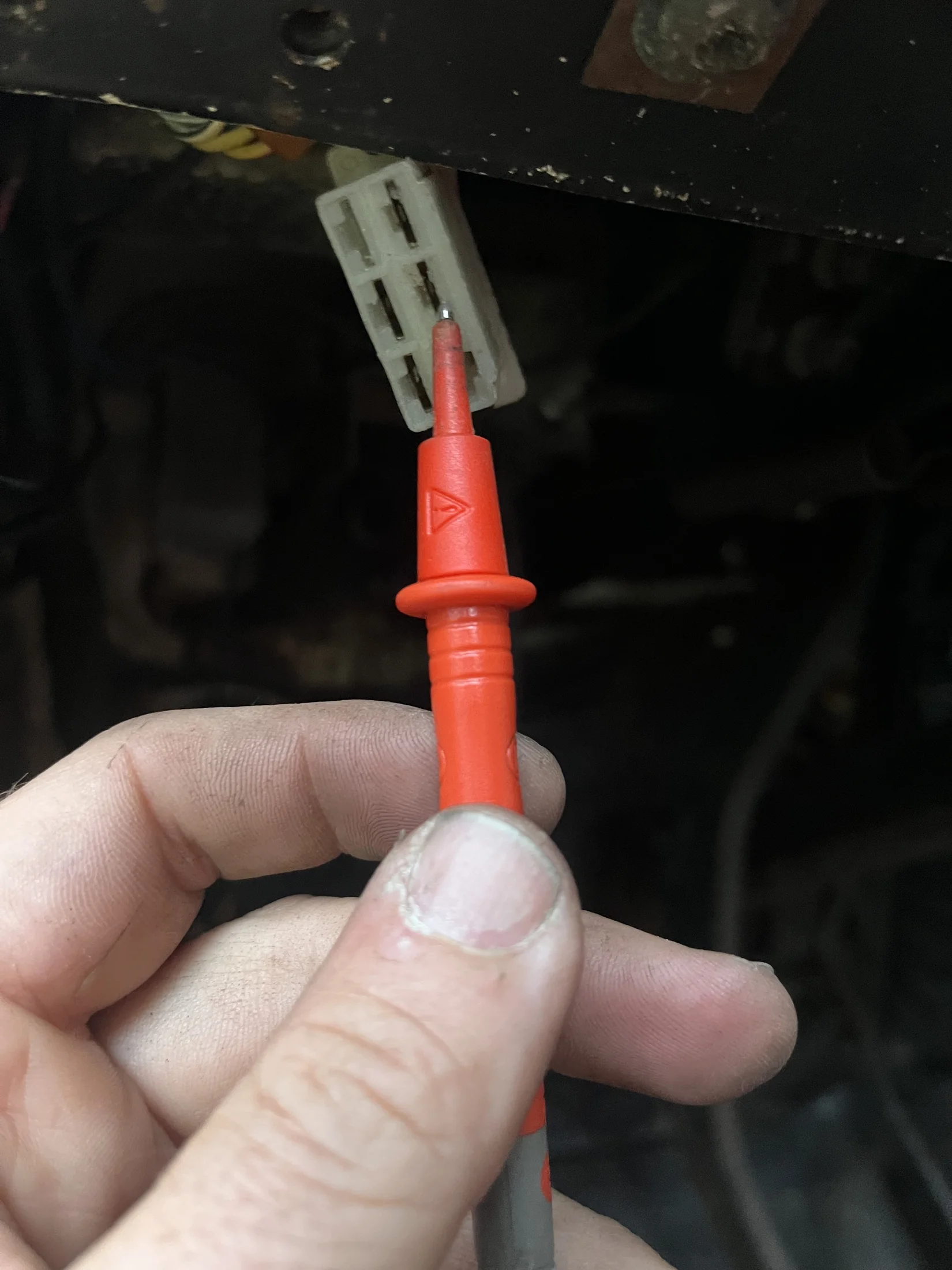

I didnt have alot of energy today. I caught a cold the first week back working... probably the stress. I did double check to see if I had power to that switch. I just wanted to share what I found.
This terminal on the connector to the head light switch has 12v power. I guess I need to check what wire that actually is. I will check that tomorrow. Does the power go to the high low switch in the column from here or does it go to the fuse block? I have been cleaning connectors and that did not help much. although turn signals seem stronger. I got some fine grit sand paper and sanded the terminals on the fuse block as well. no luck there. although thats where I stoped. I had power to the fuse block but I did not scrutinize and really check every terminal. I think tomorrow after work I might undo the wires to the fuse block and clean there too. then check voltage there too.

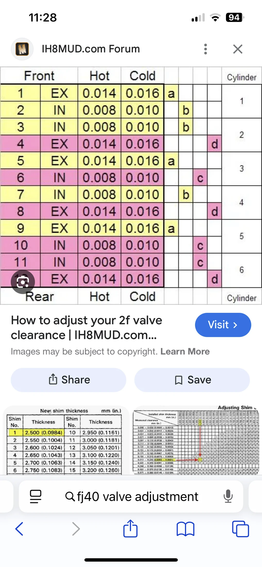

I have some other good and bad news. Ill start with the good. I notticed some wierd idling noises so I decided to adjust those valves. and holy crap they were way out. Some were way too tight and some too loose. but after I adjusted them everything seems to be running better. no wierd bogging and seems to fire up quicker. other good news Is I got the trans tunnel for the 3 speed to fit the 4 speed. for those not in the know: 4speed fj55 t-tunnels are not the same as 3speed t tunnels. and they dont miss match. I just trimmed the 3 speed tunnel some around the shifter hole. Now it fits and is bolted down. Now I have 4 low working as well. I just need to buy some shifter boots now.

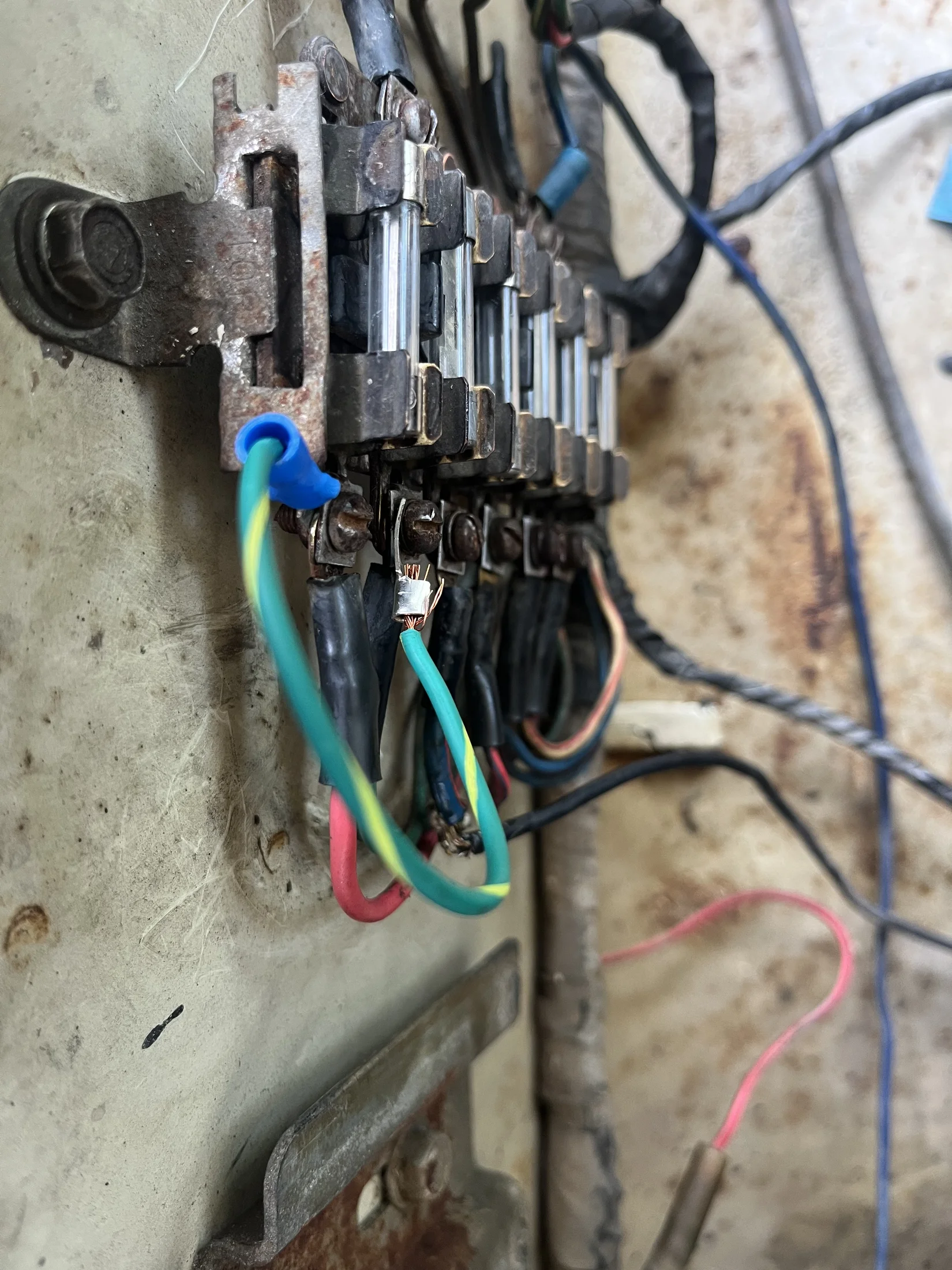

Let me be the first to say I am not an electrician. I think I have figured out that I am not getting the headlights working. seems I am not getting power in the fuse block on the fuse that the headlights go to. I swear I checked and got power there. but maybe the issue is a loose connection or somthing because when I looked this morning No power. Out of curiosity I jumped it with one that does have power. (the fuse right below) and the headlights will work that way and the switch works that way. My question is does this mean my fuse block is damaged? Or am I thinking about that wrong?

Fuses can look good, but be bad - the fault is at the attachment point inside under the metal cap. Use a multi meter to test fuse for continuity cap to cap. There are nice little fuse puller/testors that are very handy.
The clips on the fuse box can be corroded. Disconnect the battery and use like a 30 cal bore brush to clean the clips. The wires and connections on the back side of the fuse box can get corroded or loose. Look carefully at the wire crimp connections - corrosion can crawl under the insulation making a poor connection.

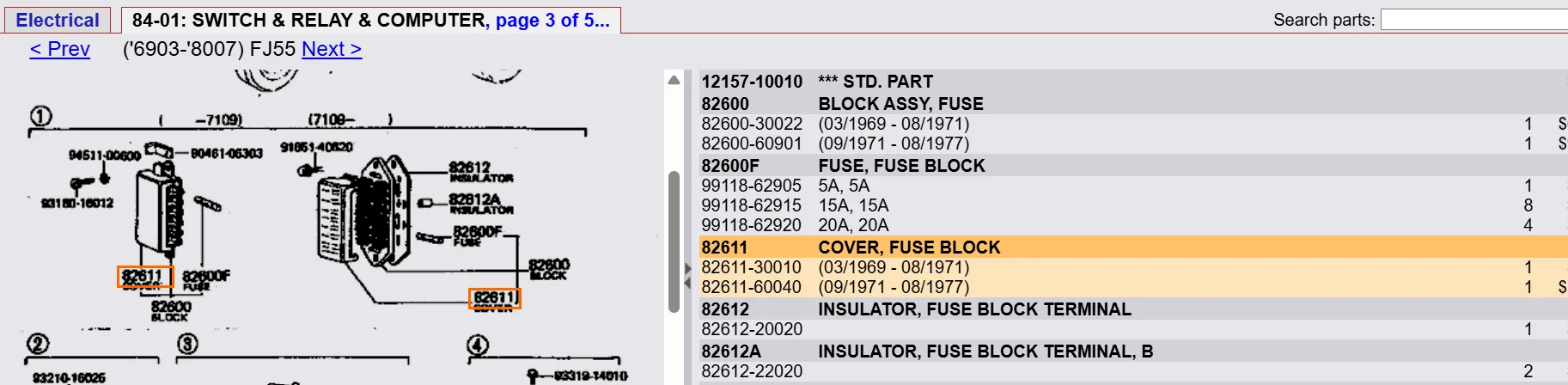

City Racer has what you need. It says FJ40 but the part number is the same as the FJ55 through 08/71

Fuse has continuity. I did check that. just not power to the fuse block there. Ill re sand the clips and see. might just replace the whole thing as I am having issues with other electric stuff like my heater and the radio comes on and off. I swapped the horn and headlights on the fuse panel and now the headlights work but the horn does not. Ill look at the wire connections next and report back.
I was just looking at that. yeah I think mine is may of 1971. so i would use the older one. I found one a little cheeper than city racer on fleebay. I love city racer though! Looks like I got the last ebay one.
For Toyota Land Cruiser FJ40 Fuse Box and Cover LandCruiser FJ40 1971 Early New | eBay - https://www.ebay.com/itm/355460628173?_skw=1971+fj40+fuse+block&itmmeta=01K433P15GW3FFVDQJPK17G74C&hash=item52c31abecd:g:Ns0AAOSwPGllyu-E&itmprp=enc%3AAQAKAAAA8FkggFvd1GGDu0w3yXCmi1cBt%2F2T7zx8FConB0xqY0Si%2BykfKBR5ywr4YMfwczhzh9R%2FhvRiGGkzhX5%2B9YrBlhdvtZGBJxleNJ%2FHAEqFtsH7%2F6gNCgcqQAPYjn5KSfQ8edcMmKl2%2FHvDghyxxxx1omxCIeW10ge2b0ipT%2FNBJHcVJI35FIcrpXT6jmxj5iOkP6QsmWnaX8JJIIFd%2FCbwM8k2avHmsyQUMjCSUDA1wMbXqGwSnm8YZG1ORFQ2v6QVbJvoAl2loLGChBNJ1V%2Bhz1PkDnI3StHdof3Rt6tsRoqPsXXd1gbuz0p61zCrLgu%2FFw%3D%3D%7Ctkp%3ABk9SR_iS2OOgZg&pfm=0
Sanding the clips erodes the plating on them making it easier for corrosion to form and leads to more often cleaning. A $1 bore brush is very effective without causing more damage. A small coating of dielectric grease helps. Paste wax can work too.
this thing purrs after the valve adjustment. I did the valve lash the other day and holy crap at TDC on #1 the first two valves were so tight. I think sombody did an adjustment with it running by ear or just guessed or somthing but none were close. I think I can dial them in a little more but what a difference! it runns way smoother. I always use the chart below from Mud!
Head lights work with high and low beam. I am replacing the fuse block and seeing if that fixes my issues. It was cheep enough and I want reliable. Like I said above, If I swap the head light wire and horn wire on the fuse block, the headlights work and the horn does not. I am just not getting power to that first fuse.

I like to "just" hear the valves. Better to hear them than burn them, is the rule I learned.
True that. they are way better now than when I first started it. too tight and too loose on most.
