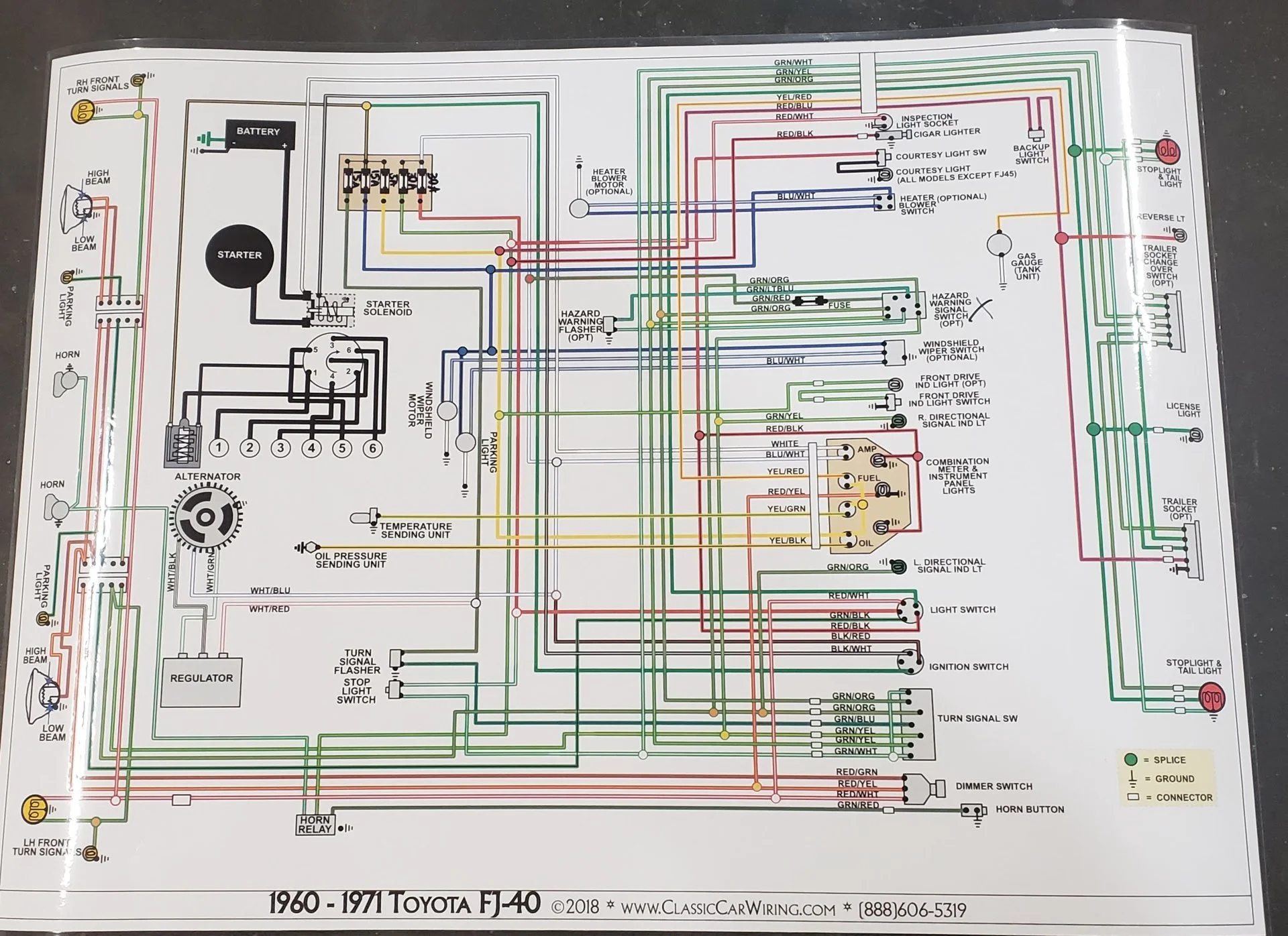

Do you have the rear harness that goes from the passenger side firewall to the rear crossmember? There should be two wires that come out of that harness (same harness that has the YR fuel tank sender wire - and WB ground). One is GY, and it’s positive, and the other is possibly GY as well (or B, can’t remember) and it goes to a frame ground right in that vicinity. If the light is on and the FD is not engaged, switch the wires on the indicator switch. The rear harness plugs into the main harness at the passenger side firewall, there should be a GY in the main that then runs to the light socket, and the a return GY wire that splices into the Y wire off the fuse box as the circuit power source. I think this is right. Meter everything so I don’t burn up your rig 😂.
Here‘s a pretty good schematic

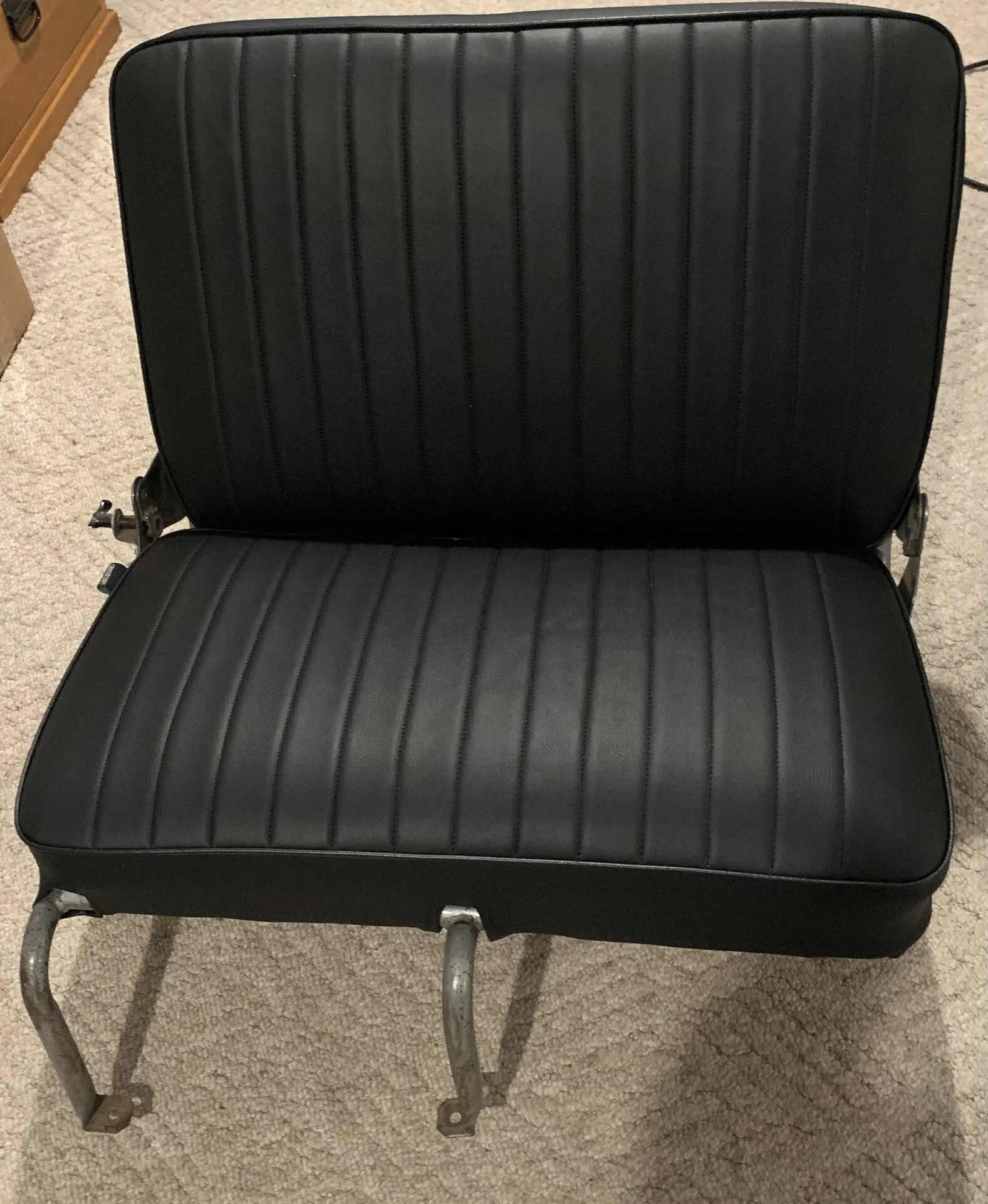

Cruiser Corps is a couple hundred bucks less than SOR, not to mention what shipping would be. I’ve never used the SOR covers. I have done 3 sets of Cruiser Corps covers and have been mostly happy with all 3 (2 benches and a set of buckets, plus rear jumps). The coral being not quite factory correct shouldn’t really matter since it’ll not be up against existing coral. And you wont be able to tell its not factory next to that V8 anyway…… jk.

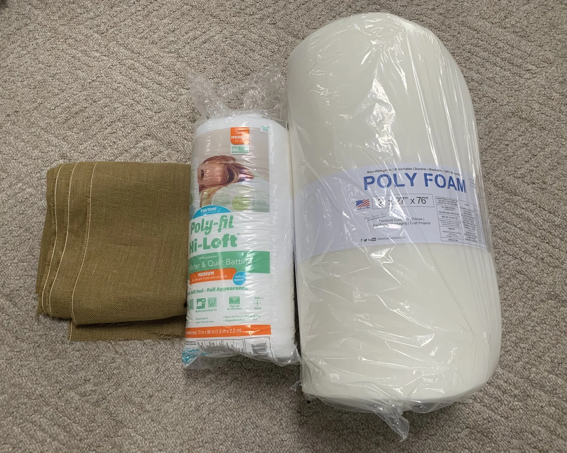

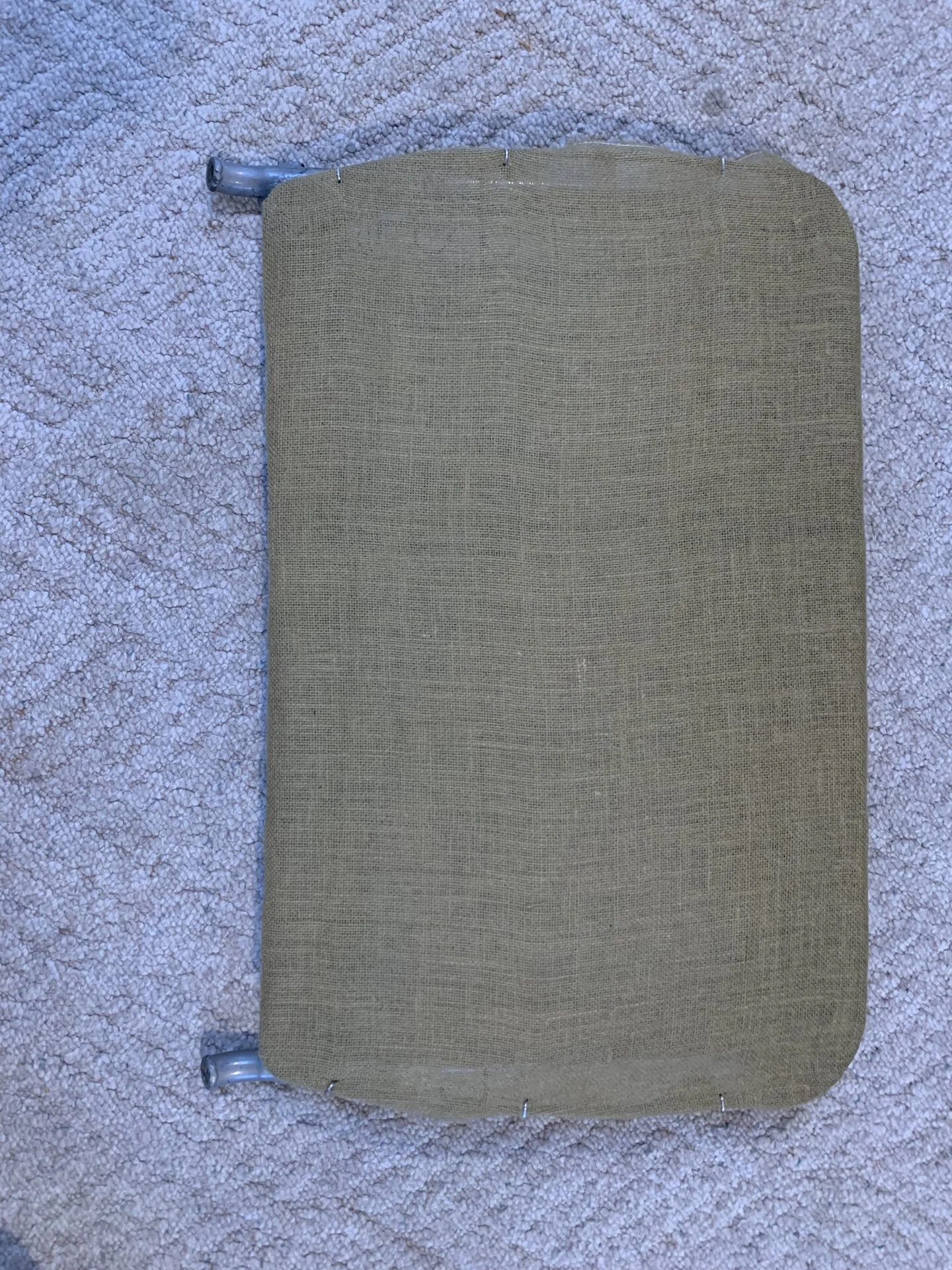

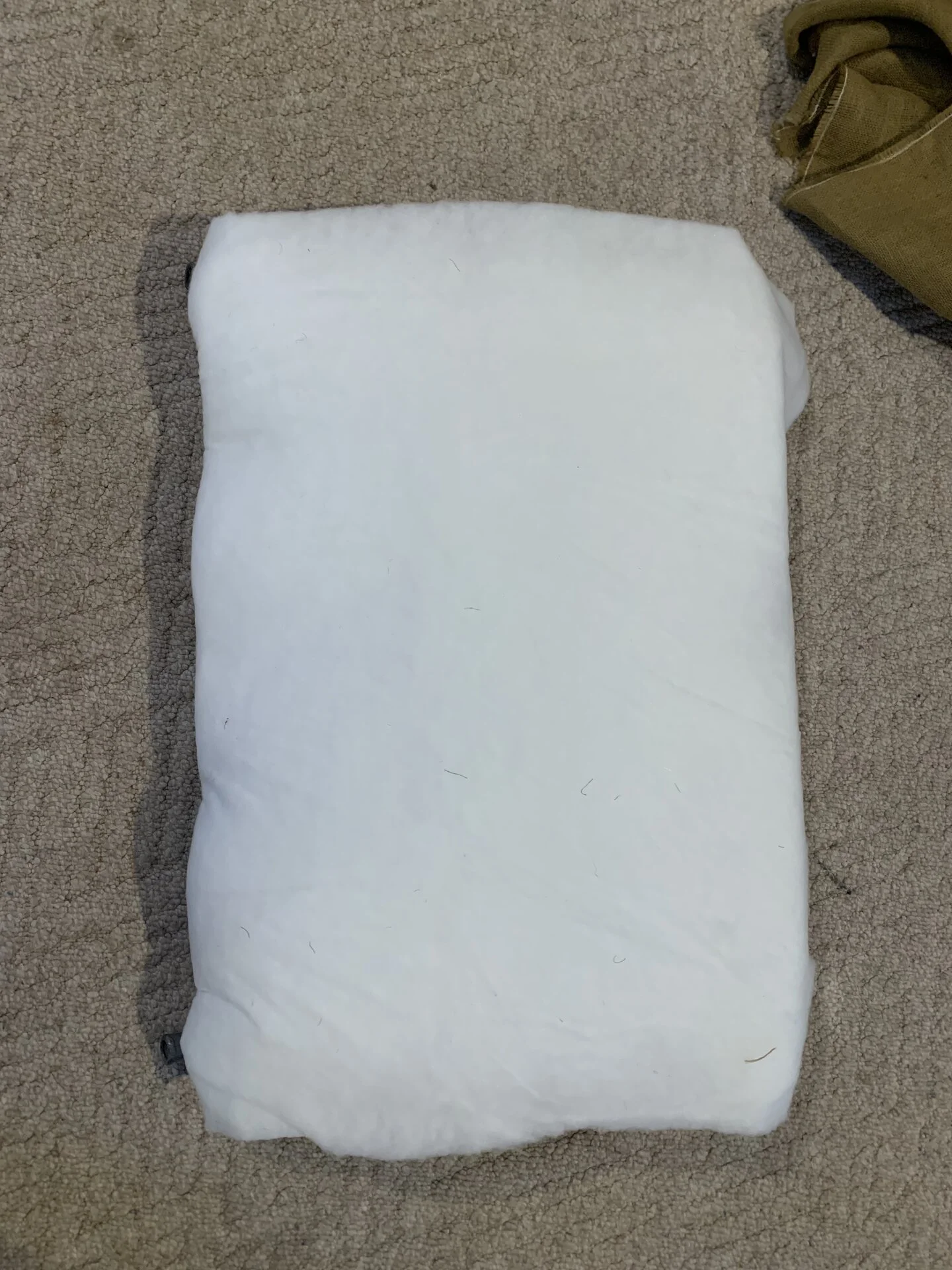

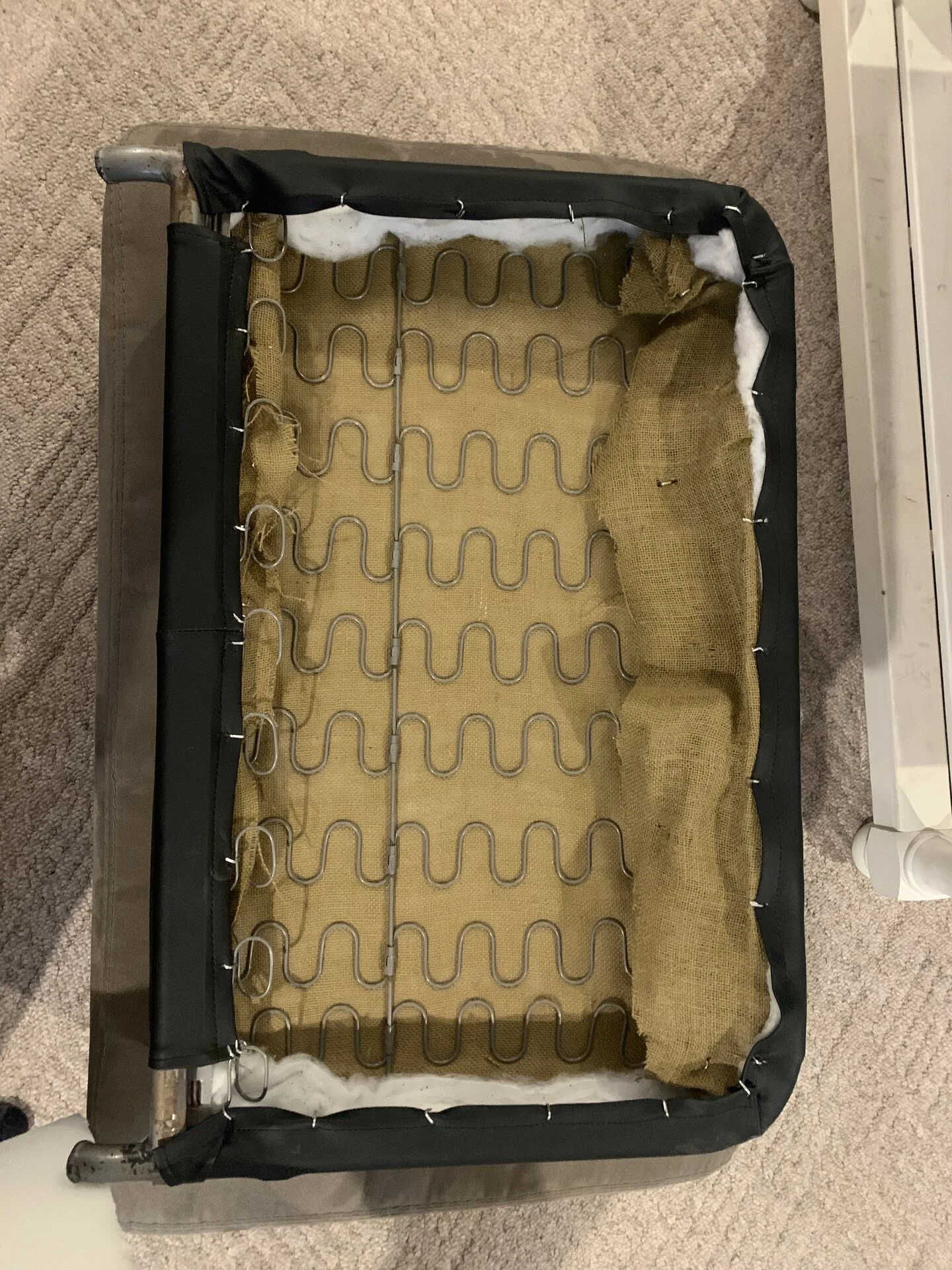

I just got foam from a local fabric store. I wrapped burlap over the springs, foam over that, then a thin layer of poly-fill batting over that (mimicking jute batting kind of), then the covers.

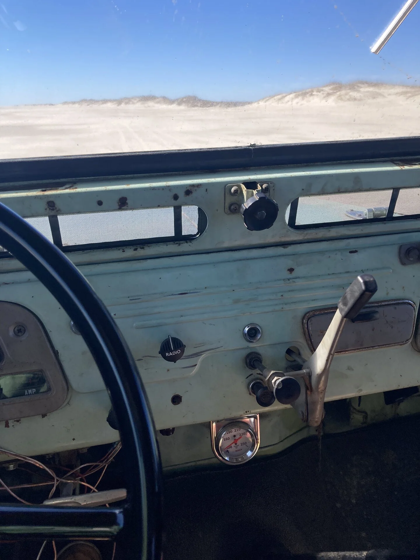

well the good news is the 4x4 and 4 low all work as should. at first I could not get the transfer case out of neutral, But I adjusted the linkage and tightend some things up and now it works like a charm. Its actually easier to get it in 4x4 than it was before. I took it out on the beach and all worked just as it should.

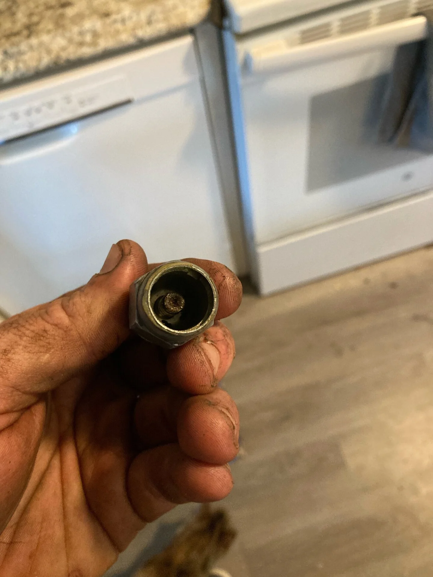

The bad news is when I had the green light switch out today to connect the wiring I dropped it and the bakelight crumbled and the electric terminals fell out. I think I am righting this switch off. so I will be looking to buy another if anyone knows where to get one let me know. Also I will be buying covers sooner than later. I cant put those ugly best top seats back in. Ill post some pics soon. my wifi is being annoying.
I just got foam from a local fabric store. I wrapped burlap over the springs, foam over that, then a thin layer of poly-fill batting over that (mimicking jute batting kind of), then the covers. View attachment 3246891View attachment 3246892View attachment 3246893View attachment 3246894

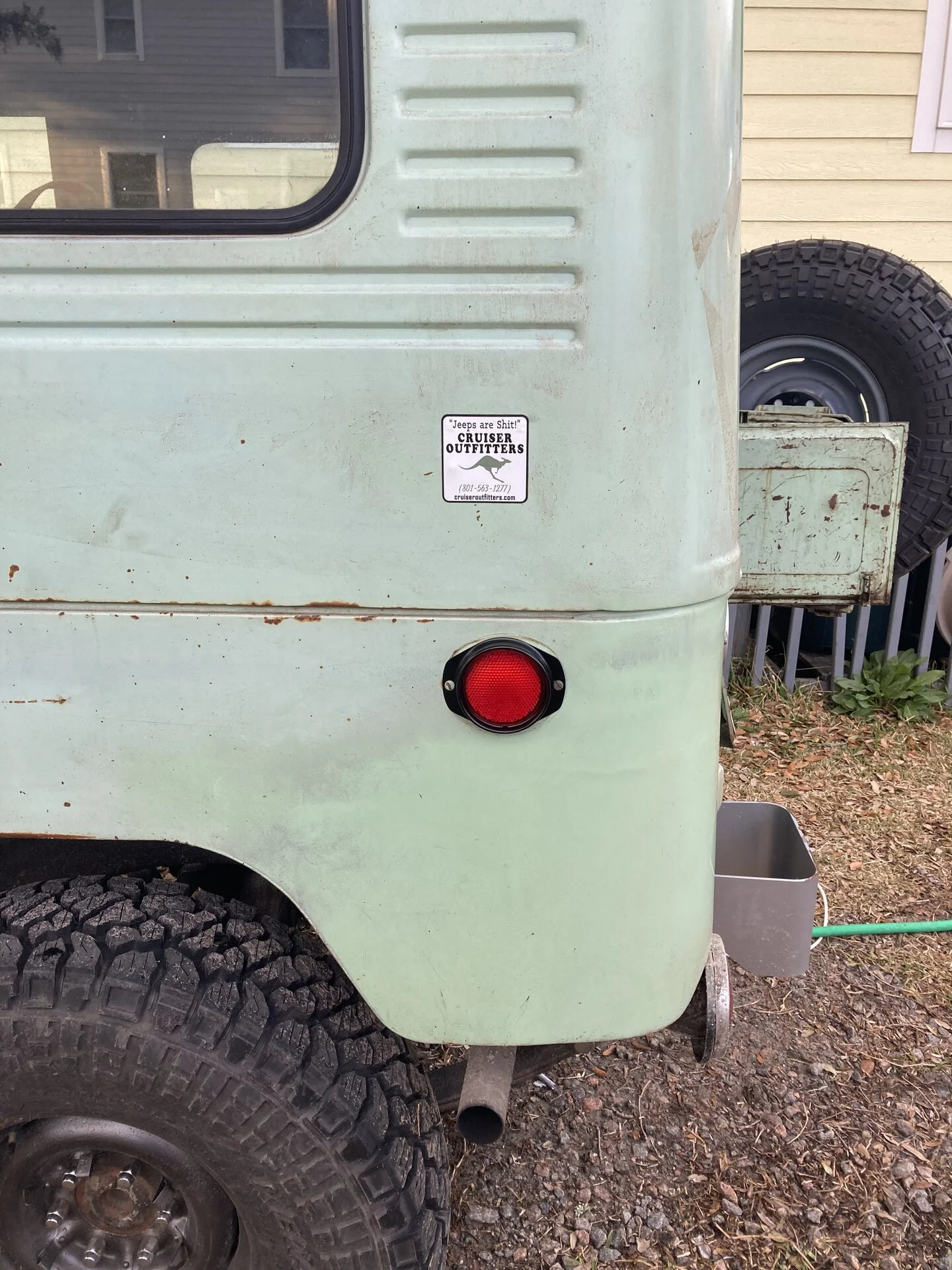

I got these Sick Koito reflectors for my fj40 in today. I got them from @red66toy . I am excited to take of the fence post reflectors and put some correct reflectors on haha.

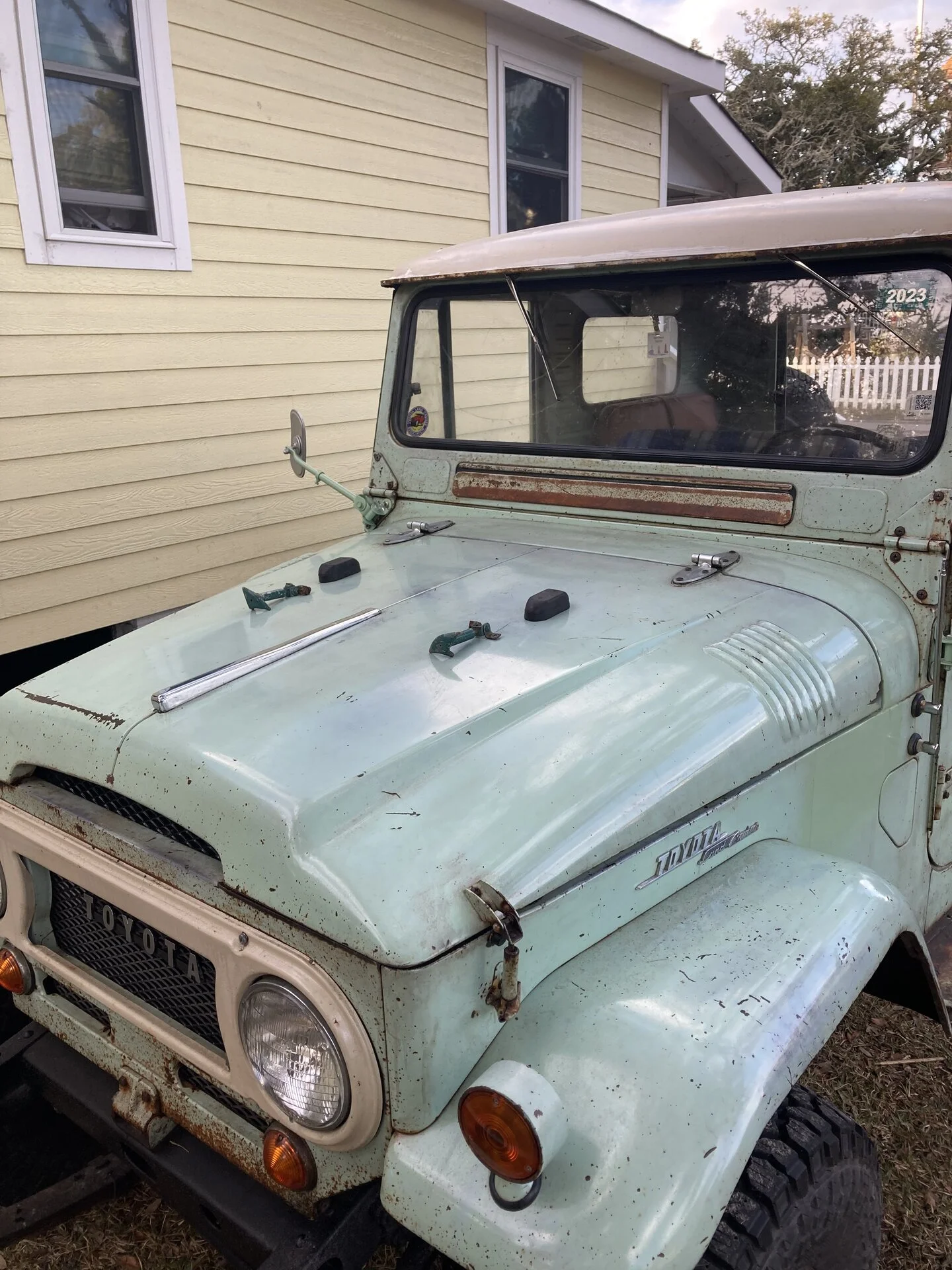

The Koito reflectors look really nice on the cruiser. Ill probably buy a third one for the rear too. I started to add the hood assesories. started with the bump stops. I will figure out where to put the hooks after I weld in the hook retainers I made on the windshield. as stated above I had to find these used hooks as I ended up with the wrong ones. I also Have some hood hook keepers coming.
Also last picture is me using the 4 low on the beach. Using the dash shifter. It shifted in and out of 4 low flawlessly! I love how this FD switch works. Its actually smoother and easier than the old lever! Just no working green light yet. Pardon the rats nest of wires. I had a speaker wired up to that bluetooth radio knob. I took out the speaker temporarily .

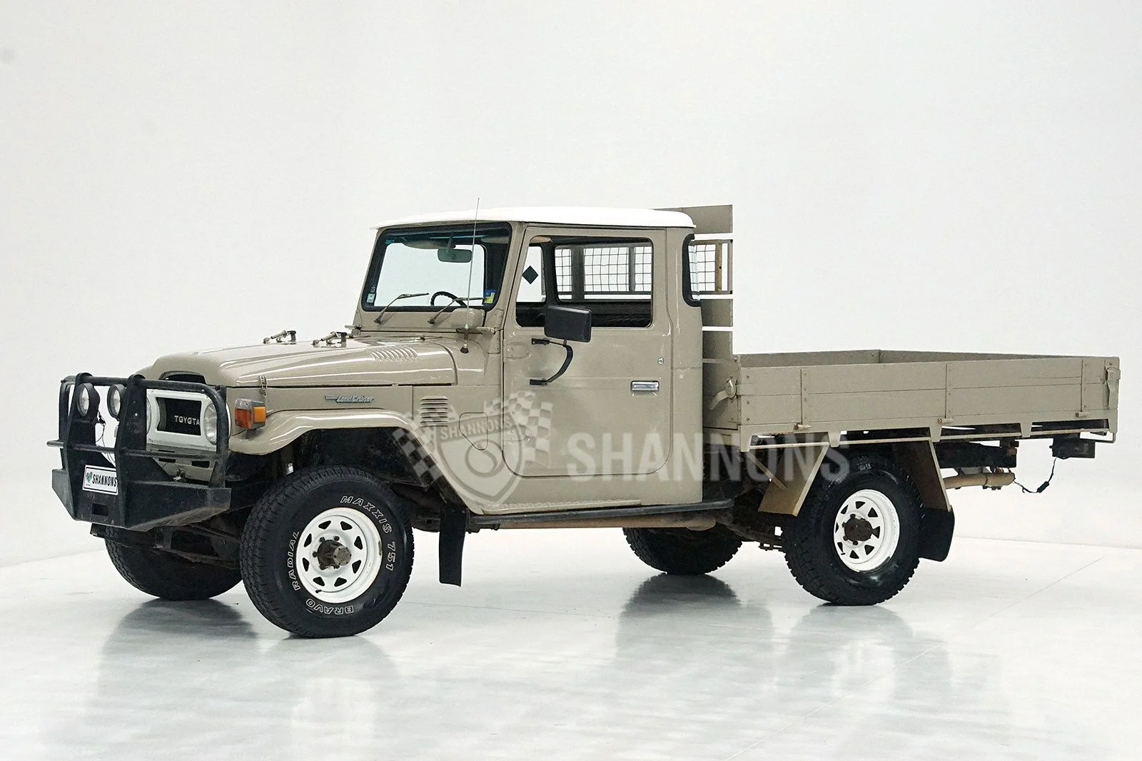

I wish I could afford a 45 right now! Every once and a while you see them come up for good prices. I was very tempted to buy a RHD Australian import one that was for sale In Virginia beach right before I bought this fj40. the only thing that deterred me is It needed a bed. somebody swapped in a flatbed on it.
I wish I could afford a 45 right now! Every once in a while you see them come up for good prices. I was very tempted to buy a RHD Australian import one that was for sale In Virginia beach right before I bought this fj40. the only thing that deterred me is It needed a bed. somebody swapped in a flatbed on it.
I think pretty much all Australian 45s are flatbeds
That makes sense. It looked like somthing added on in the states though as it was made of wood Like all wood.
