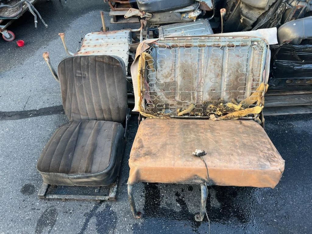

I finally found some seats for my fj40. I was having a hard time with shipping causing the seats that were rough to be over 1000$ I just bought these from a 1968 I was told. either way they look to be correct for my year. They need to be upholstered obviously. I think I am going to go with the coral color! This will be a summer project as I will need to wait till then to start it so I will store them till then. But I am super excited. Any input on seat color let me know. I know the rear jump seats are that coral color.

Good score on the seats. I vote for the coral.
I second the coral vote but I am biased. Mine had coral from the factory and when the time comes, I'll be replacing them with another coral set. It just looks good.
Black is also a good choice. You don't have to worry to much about sitting on them with muddy pants or whatever.
That being said, there's just something about these babies that pops. Maybe I'm weird.

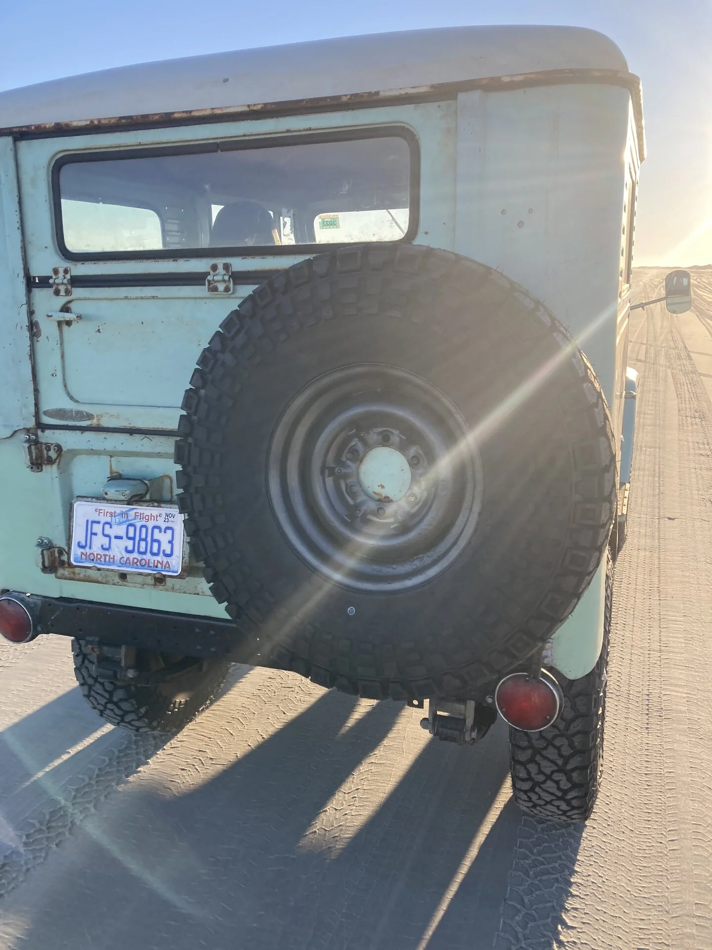

I forgot to mention I purchased a spare tire. I bought another kenda 33X9.50 15. I am excited to get a spare if anything to complete the look of the fj40. will post a picture when I get it mounted and installed. for now here is a shot that I took on my fuji gw690III

still waiting on the seats to ship but I did mount a spare tire. unfortunulty I will need wheel spacers (just for the spare) as the 33x9.50 15 Kenda kevlar does not quite fit with out impeding opening all the hatches and everything. any thoughts on what size spacer? I think I have a 1 inch tire spacer somwhere that I will try. Looks cool with a spare though!

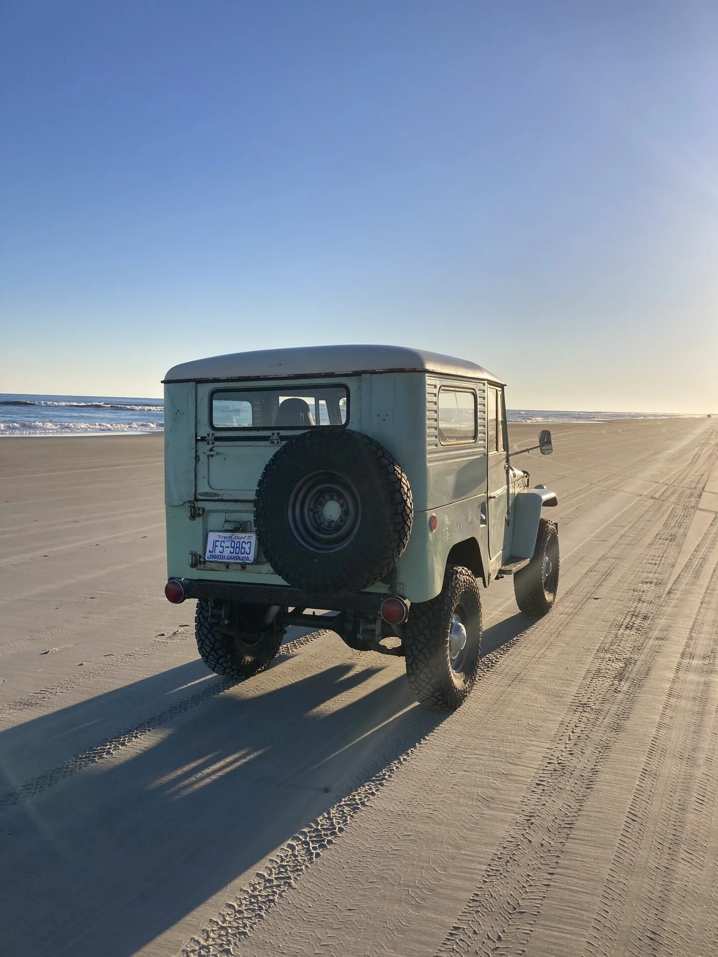

Want to get everyones opinion. Originality or something better? I really want to swap the engine out for a toyota engine at some point in the next few years. while my sbc runs well and works its not a toyota and it bothers me a little. In the mean time I want to start gathering parts. I would like it to be a relatively "easy" swap. or at least something that my capable willing to learn how to hands can do. I know what ever I do Ill need to swap out the bell housing and probably change out the transmission for a 4 speed for some of the engine swaps. The engines i had in mind are the toyota 3b no turbo. maybe a 3fe (I have experience with the 3fe). If I want to go crazy a 1fz would be really cool but I think maybe too much work. I also saw a 1kz swap on mud somewhere looked to be a little too much fab and wiring for my taste though. I also would not mind finding a good 1f 155 engine. occasionally I see them on face book marketplace. Keep in mind I dont need to go fast where I live. I am not a led foot.
This has been in the back of my mind for some time. If anybody has a better suggestion for toyota powerplant let me know. the only engine I dont want to do would be a ls swap.

It’s your truck, you get to build it however you want to, fit whatever comforts or looks you want, but I’ll just say what I would do
Excellent tire choice, it’s exactly the tire I’m getting. I’d get A/C for it (I live in Raleigh and Charlotte, so I know it can get super hot in the summer), better suspension because rough country springs suck, and I would just keep up with maintenance. The engine swap may cost more than you expect, expect something to go wrong.
Also nothing wrong with getting a 2F engine if you want that too. If it isn’t a 4 speed, I’d get a 4 speed in it

I really dont mind the 3 speed for now. but yeah a 4 speed is a plan I think. I was keen on putting it back to a 3 on the tree but that might be out. Yeah I actually have planned on putting a dobinsons 2 inch lift springs and kit under it this summer. the suspension on it really sucks haha. Thought about a 2f. you can get the 3fe cheeper usually for some reason though. :meh:
Right now I just want to start looking for parts for a swap. springs will get swapped this summer though.
there was a really really good deal on a 3b engine on mud recently. I am really tempted to bite the bullet. I dont mind going slow. like I said where I live the speed limit is 55 out of town and 25mph in town. I just came from a diesel kzj78. parts were annoying to find for that but I got accustom to waiting on stuff coming from over seas haha.
3spd and 4spd are both 1:1 in high. Do you need the synchronized 1st gear in the 4spd for beach driving? Do you just want to shift more often? Right now diesel is $1.50/gal more than regular ethanol, maybe $1.20 more than non-ethanol where I live. I’m not a hard core Toyota person so in your rig there‘s no difference between an SBC and a non-F135 motor for “originality” IMHO. Original is what original does 😝. Take a look at that Fuji non-digital camera in your hands 😊.
I know with the prices of Diesel its probably the same cost to run a diesel engine vrs a gas one. I loved the diesel in my kzj though but that was a turbo'd engine too. I dont need an syncro 1st so you are probably right. it stays in second alot of the time. I love the whine of the old transmissions too. I am a little bit of a toyota purist but I can make compromises for sure.
