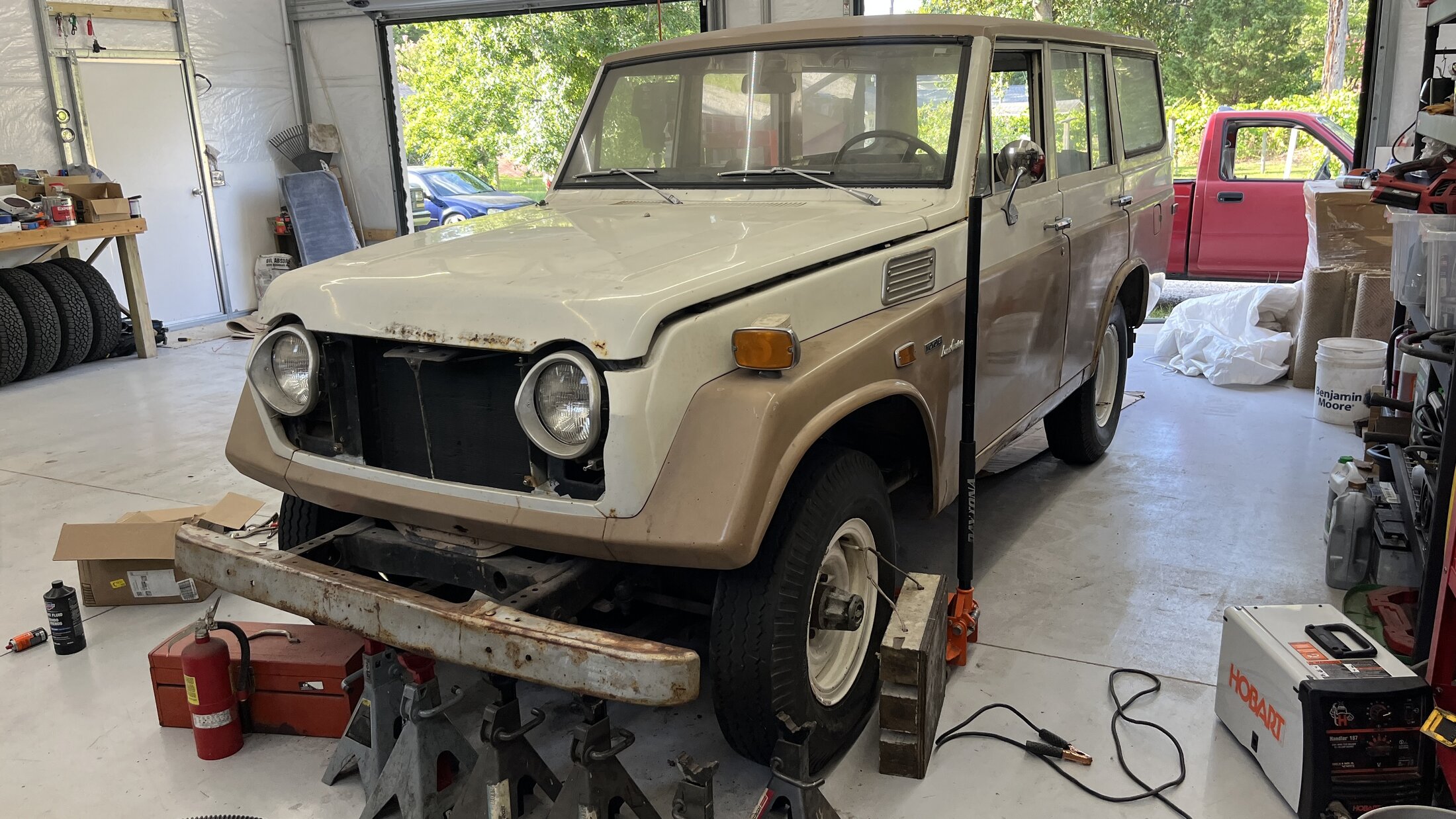

Alrighty, I have been in talks about trading the saltwagon for a 1971 fj55. Comes with new rockers to weld in and a spare 2f engine and possibly the 4speed transmission. The Saltwagon fj40 build may come to an end for me on page 100. I am still working out a date with the owners to make the swap happen. Thinking somtime after the 4th week. But I hope you guys are not mad! Ill probably take some flack for it moving on from the 40 but the fj55 is the DREAM land cruiser for me. I have wanted one ever since watching the movie 50 first dates when I was younger. (although it crashes in that movie if I remember right). Ill post some more pictures soon. It does have some of the typical rust. but its not terrible. Some bondo thats not ideal. Has what looks to be original interior and the bench seat witch in my opinion is the best. and even better I can put a roof rack on this to carry a surfboard easier! I am so tired of shoving a 9 foot longboard in the back of the fj40. Ill post more once it happens but this is the cruiser below. they have the front grill. I love the fact that the suspension has not been monkeyed with on this. Pretty original.

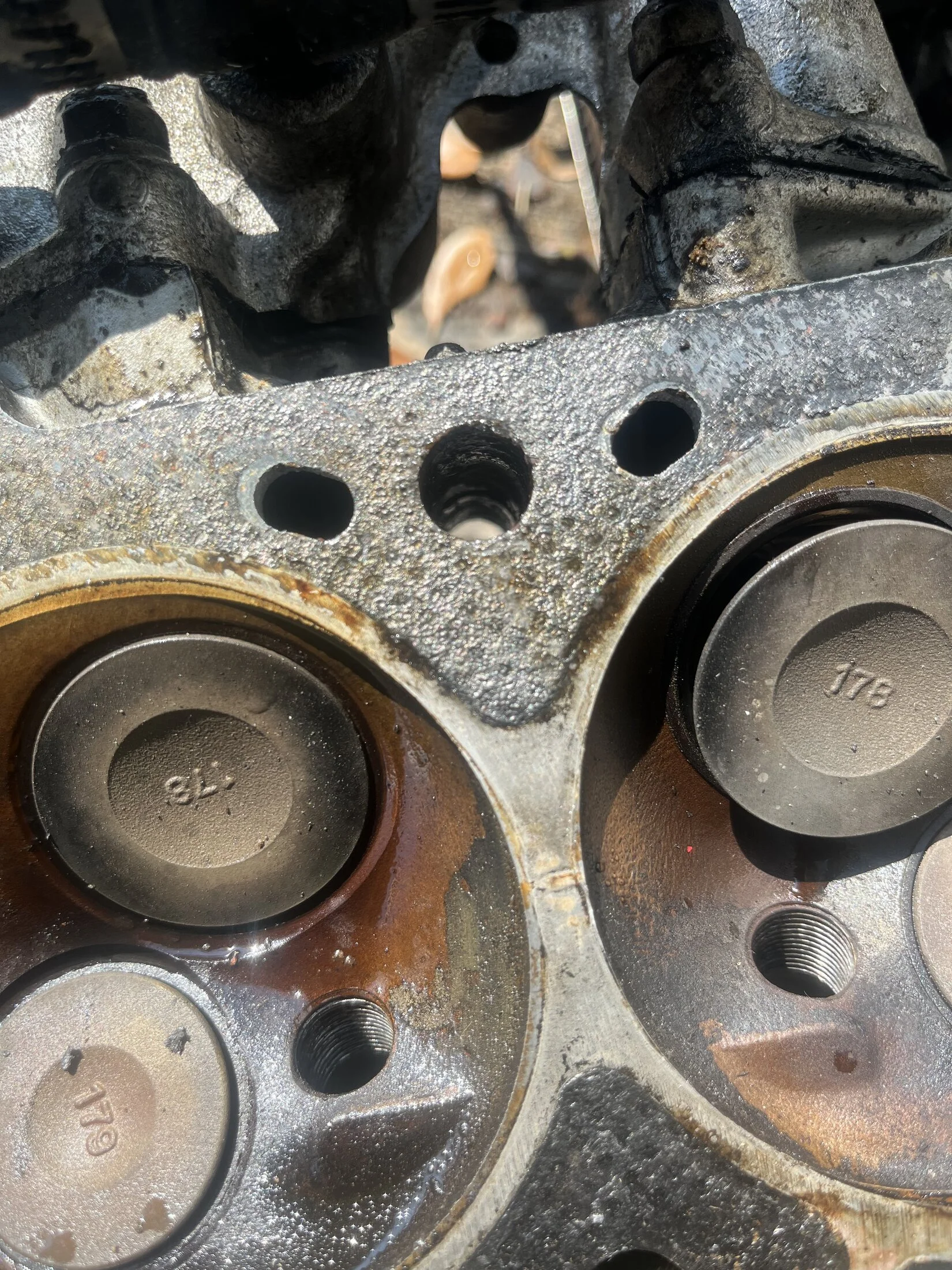

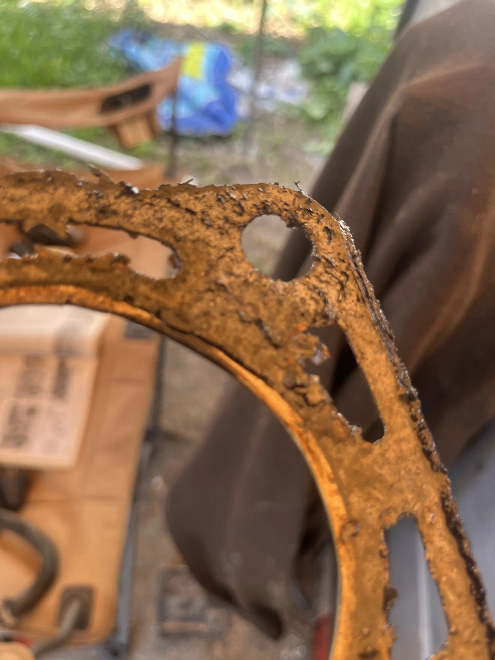

Alright questions for the engine masters. Non land cruiser related. the isuzu pup blew the head gasket (very mildly) on the way back from naggs head a few weeks ago. It spiked in temp and got hot quicker than usual. Did the exhaust gas in the coolant test and it took a few minutes but it did indicate that It did have exhaust in the coolant.

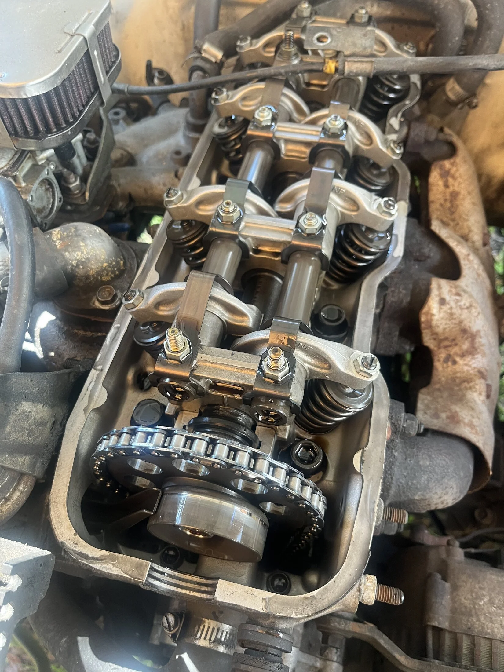

I pulled the head and found a few suspect areas. the most concerning is a spot between 3 and 4. its almost like somebody dropped the head installing it. I did find that the head was defiantly replaced/ machined. found one of those over heat tag things on the rear freeze plugs. it also was super clean underneath the valve cover. Jonathan says he drove it for at least 20,000 miles without issue in his ownership.

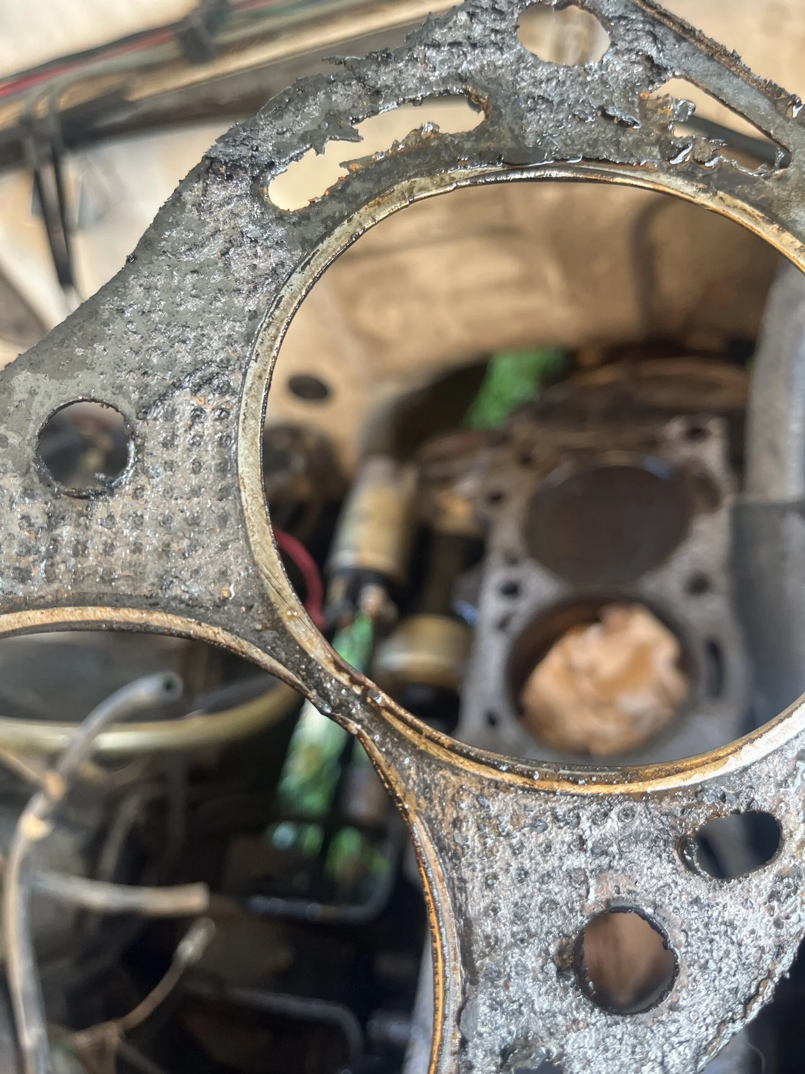

my question is: what do yall think of this.. its not a crack but kinda like a casting issue or a ding. it pressed into the head gasket. or the head gasket was kinked there when they installed it. not sure if it was the failure point. Do you all think the head needsmachining? its not warped.
This below in several spots I see cracks near coolant passages in a couple of areas.

What's the deck/block look like? I'd probably machine the head if the block is ok. You can use a flat edge and a feeler gauge to check flatness.
Theres probably a go, no go spec that Isuzu has for the engine.
Block looked fine. There is I cant remember what it is but I did what the haynes manual I have says on the specs. I checked the head for flatness with my machinist strait edge. The head checked out for flatness and no cracks other than that weird spot. really just worried about that odd spot on the head. Ill check the block after I scrape the old material off. More investigation tomorow.
You might get away without machining. Usually the protocol is to deck the head after a blown gasket. Be sure the block and head is ok between the cylinders.
The curse of living on an island only accessible by car ferry boat or plane is that for things like machining its a pain in the ass. I think I am going to get it done right though. I don't trust that weird spot. it may have been the cause of the failure too. its weird because the head is new. I think that gasket was toast when they put it on. I know its a common stop to fail between the 3 and 4th cylinder on the isuzu 1.9 engines. or at least I read that. I even found another new head that I could buy for 500$ thats alot though.
