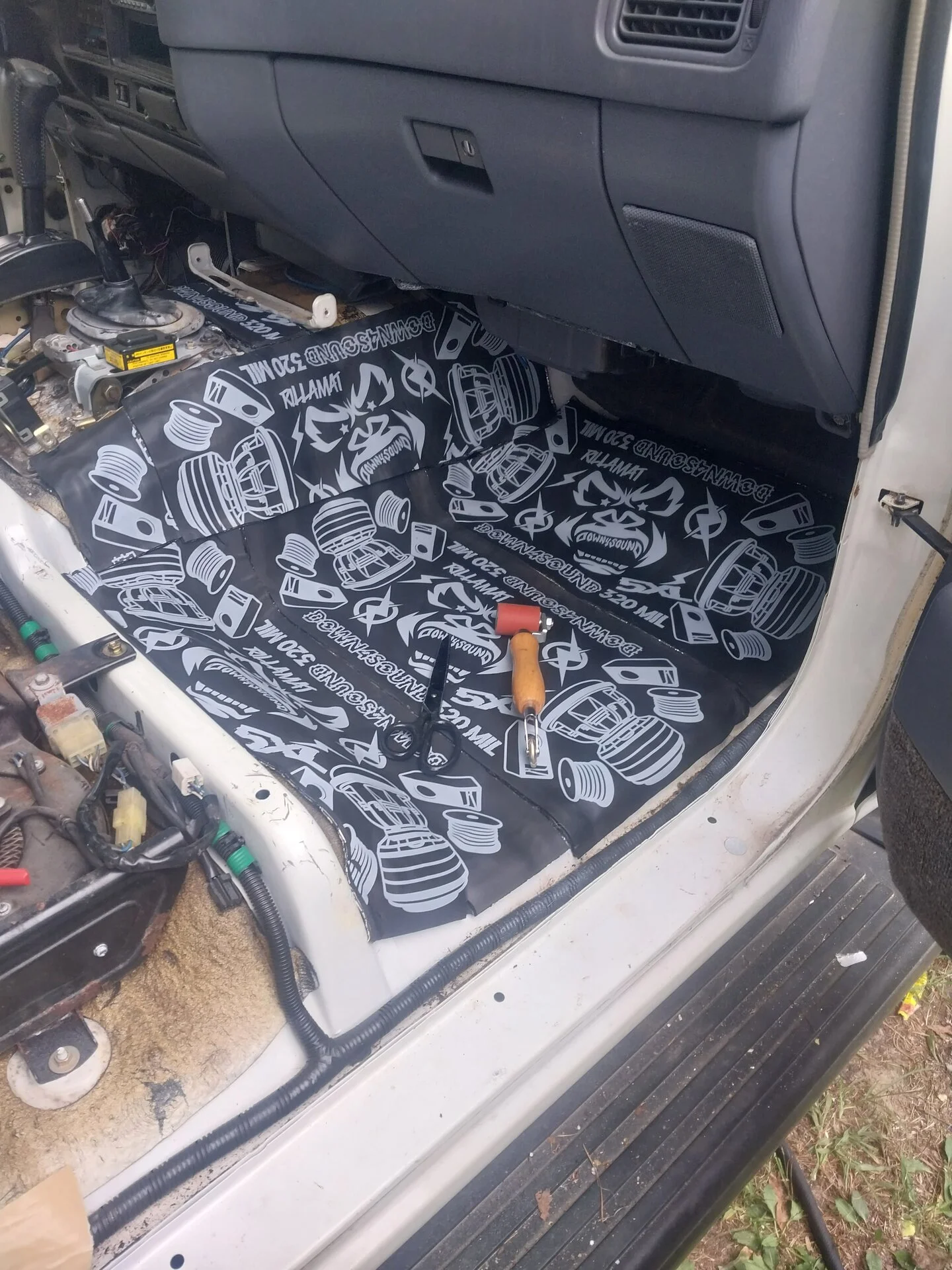

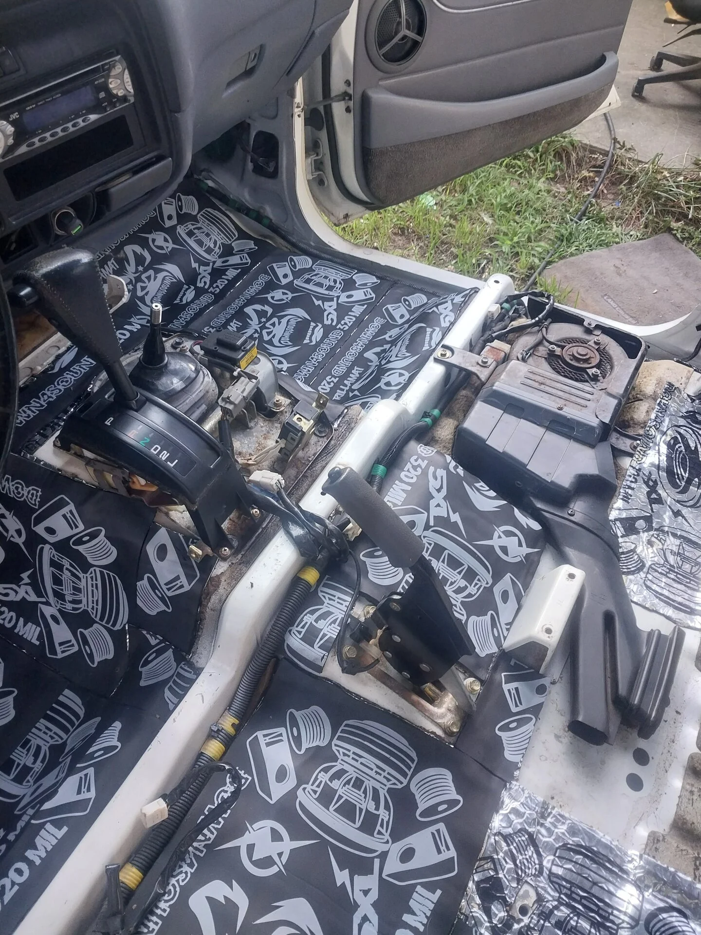

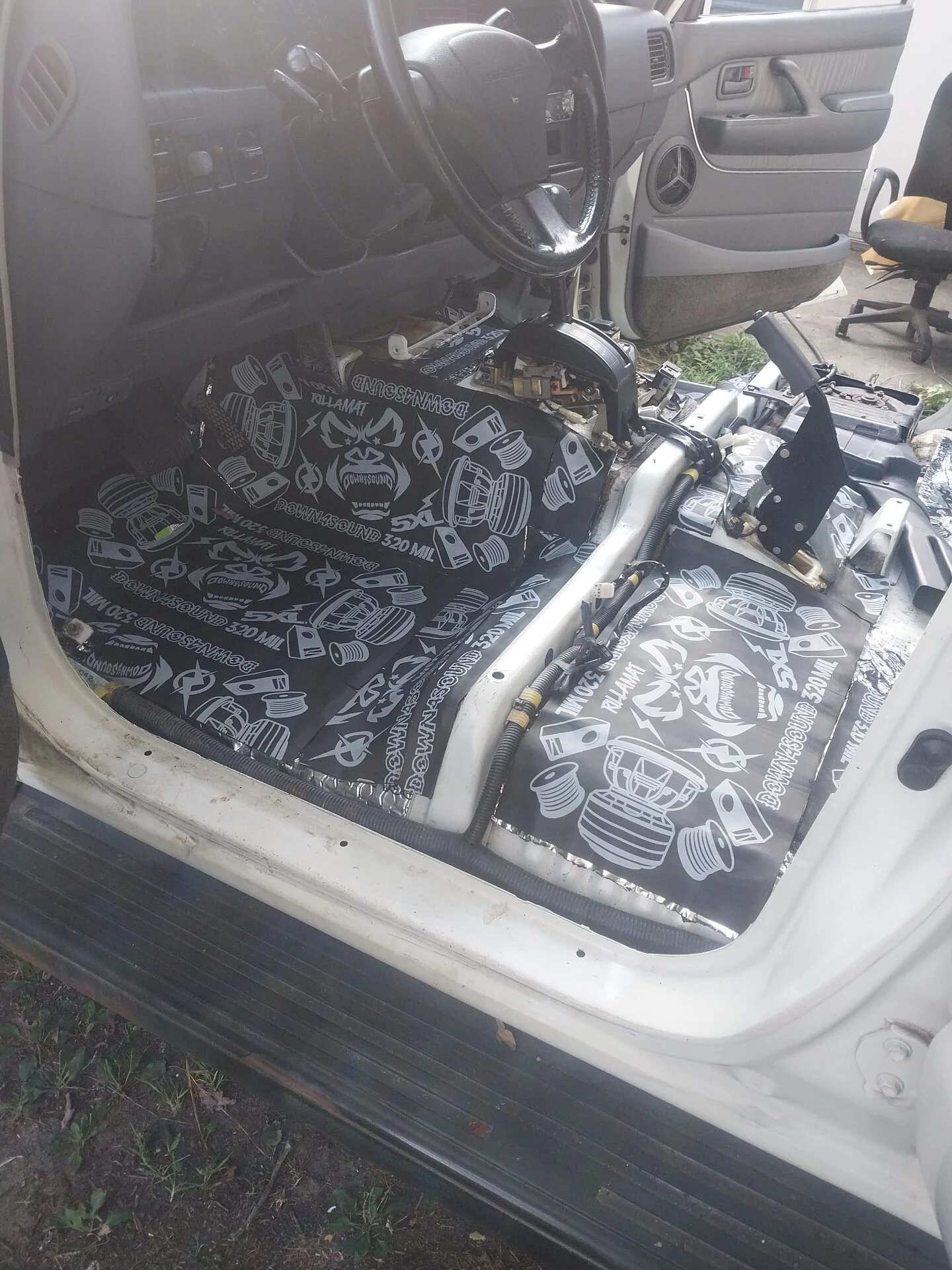

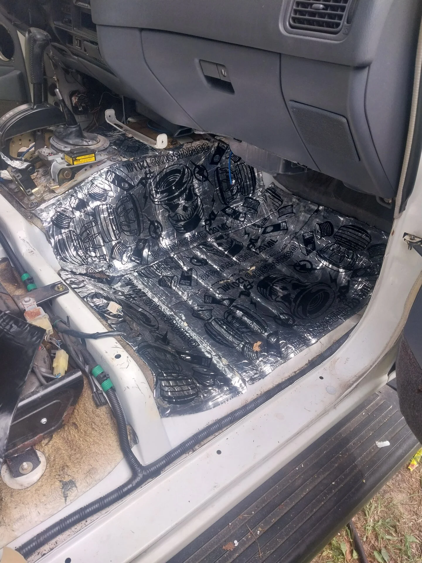

I can tell ya it's hot af with no carpet just put a couple layers of sound deadner in driver foot well and covered trans tunnel as well and put used carpet back in. When I got my 80 it didn't have carpet due to leaking roof rack . Been riding around for a couple years like thT hearing complaints about passenger side being extremely hot. Transmission tunnel really hot too not now tho. That's 440 mill thick of sound deadening including closed cell foam.
Tommy
just the floor and a layer of paint sounds rough. also as you are aware, the floor pan is not smooth.
consensus so far says a layer of asphalt style deadening and then closed cell foam on top, while the carpet is out. this stuff doesn't hold moisture like the stock stuff does
put your carpet back on top, then something like Weathertec mats
