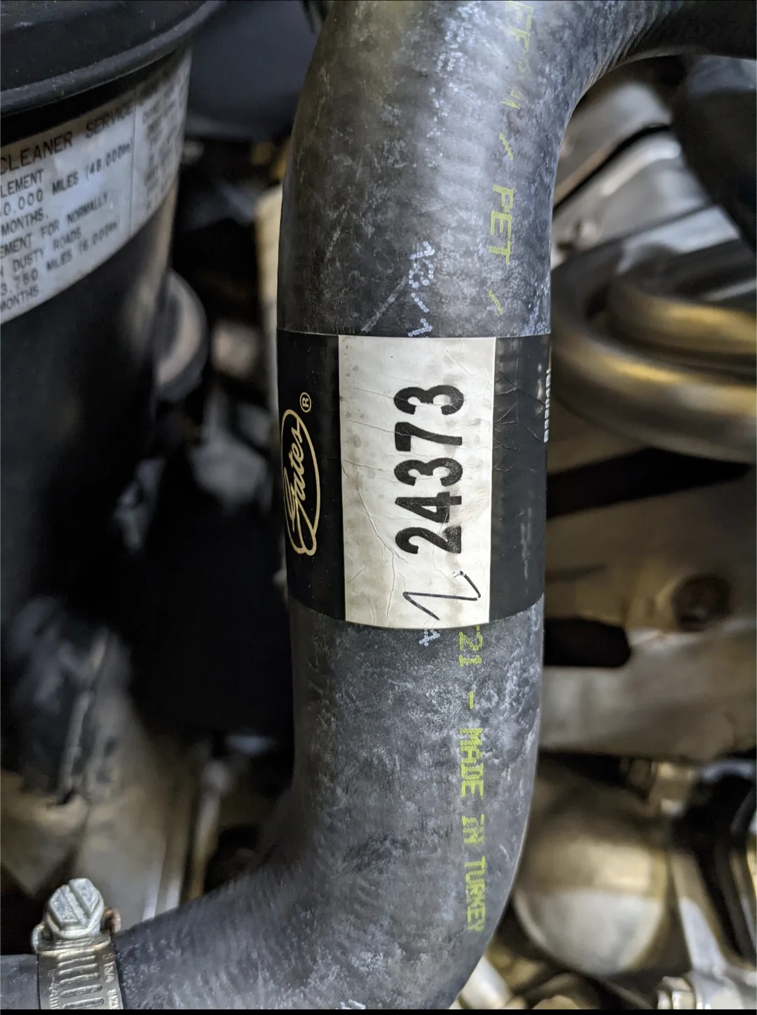

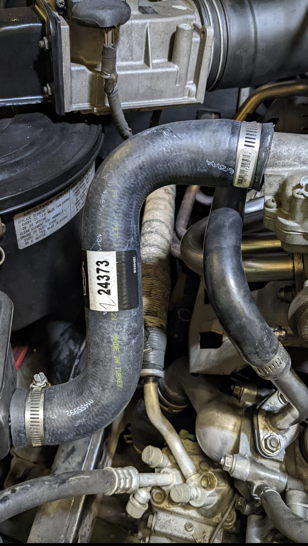

Part number for the S-shaped rubber hose that goes from the silencer to the PAIR/reed valve (1993)
If this is what you're looking for, I found a Gates that works perfect with a little trimming of the ends...
I deleted the silencer to make room for a 2nd battery box and used NAPA 9260 i think?
