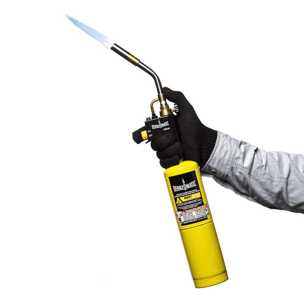

- as far as your manifold to down pipe stud :
- OEM studs are a high carbon steel , and resist drilling out , even with a Tiatanium high dollar drill bit , you can smoke bits only after less then a minute of drilling
when u remove manifold again , you have a 50 / 50 shot that a part of the stud will be sticking out proud of the manifold , if so you can take a OEM new exhaust nut and WELD is to the broke above the surface stud tip ...
you must pre-heat stud as much as possible prior to welding , if not
you will get any Metal to metal welding perpetration
pre-heated allows the weld to flow and penetrate right away , and results
in a solid bond between stud and hex nut welded to it
you don't need a fancy OXY torch set up
the Yellow MAP GAS torch set up Home depot sells will get the broke stud
plenty Cherry RED just prior to plug and slot welding your NUT on ...
like this : :)
good luck , you can do it !
