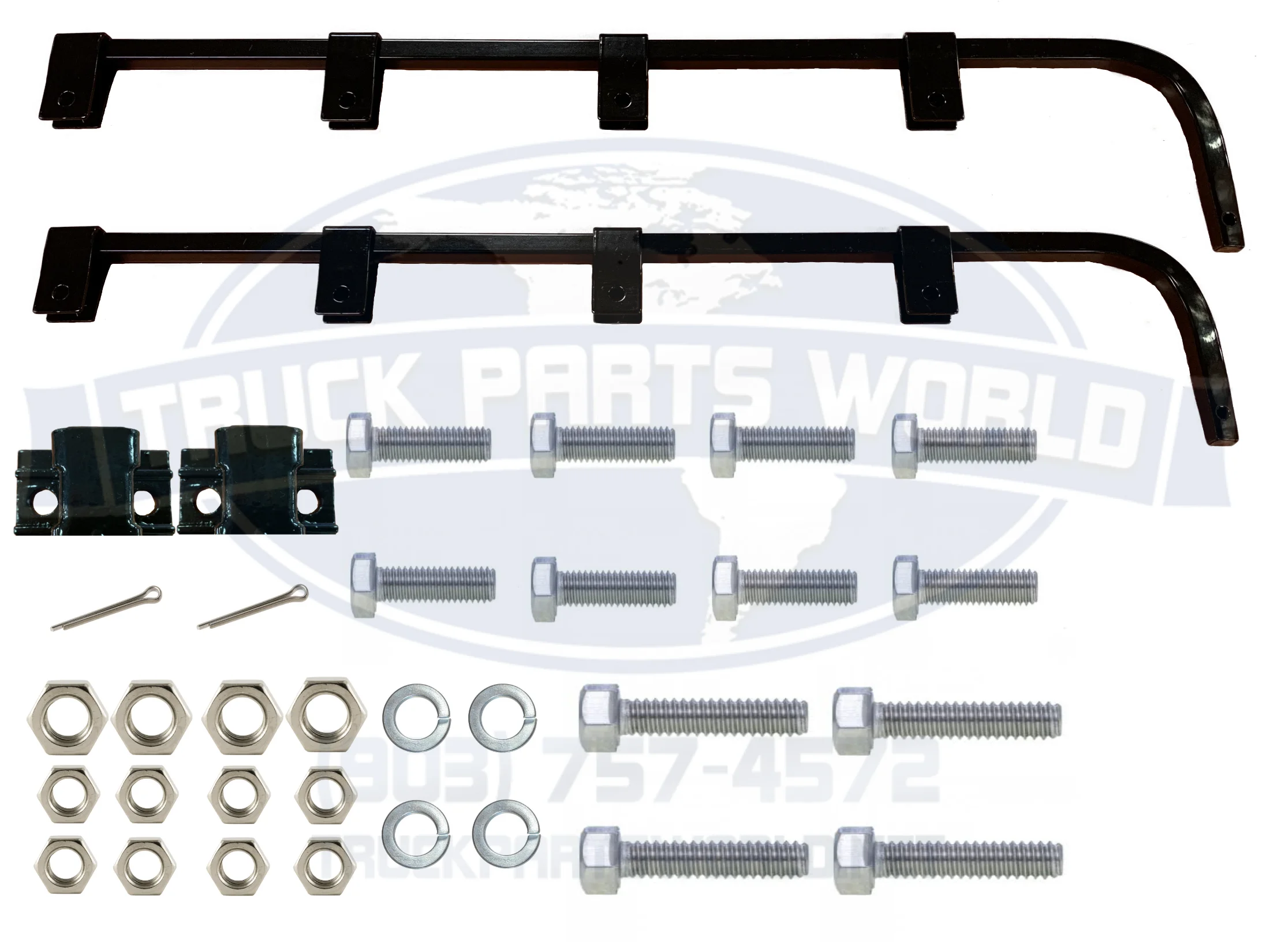

Hello everyone, 2 questions here: What kind of hanger / brackets can I use to hang mud guards on a 40? Also, Where can I find an AC compressor and a receiver dryer for the same car (stock 2f engine)?
I cut down a pair of these type of semi truck mud flap hangers to work on my FJ40. They are easy to remove if needed. The mounting part just bolts to the frame inside the rear fenders. Easy project that has worked well for many years.
