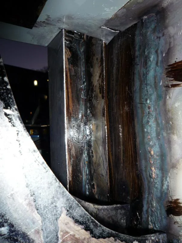

You have way more patience with that stuff than I do! That DS panel looks nice a straight!
Also...You take a lot more time grinding down the welds which will pay off in the finish!
SHOOT!!!

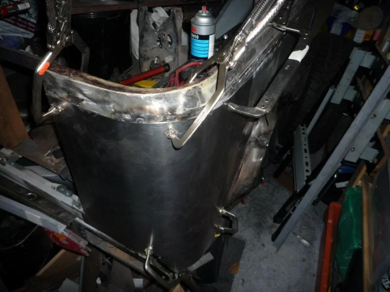

I learn as I go.
If any one is interested in how the difference between these 2 pictures was done, I will post a picture show later.

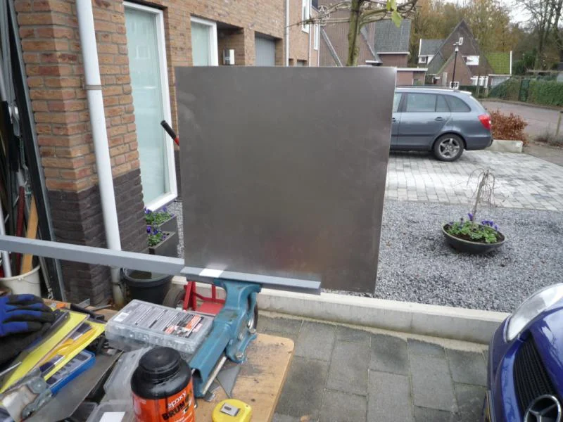

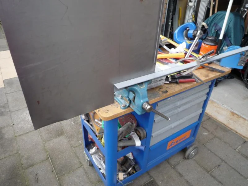

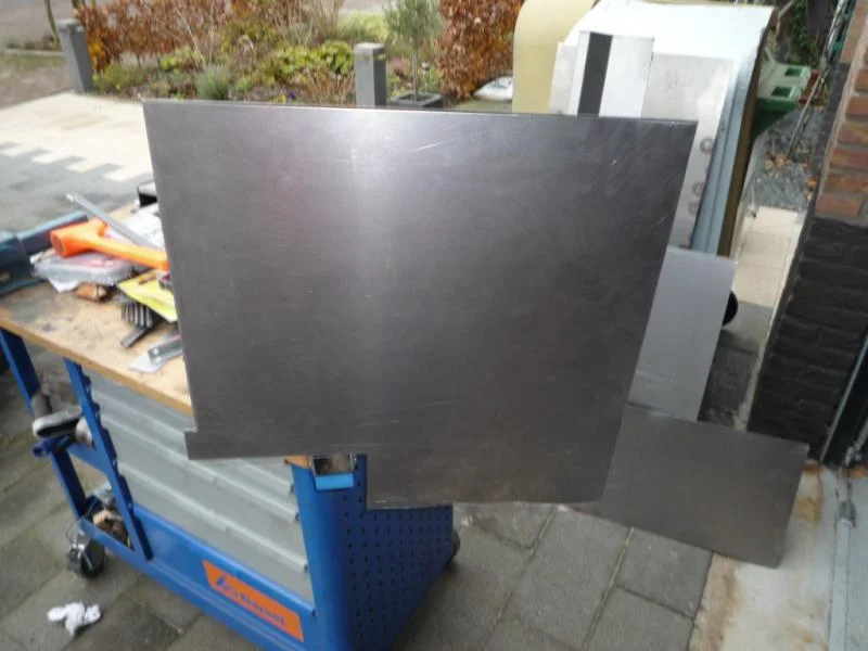

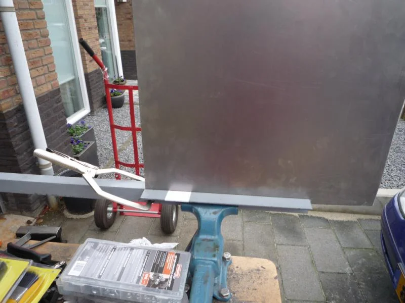

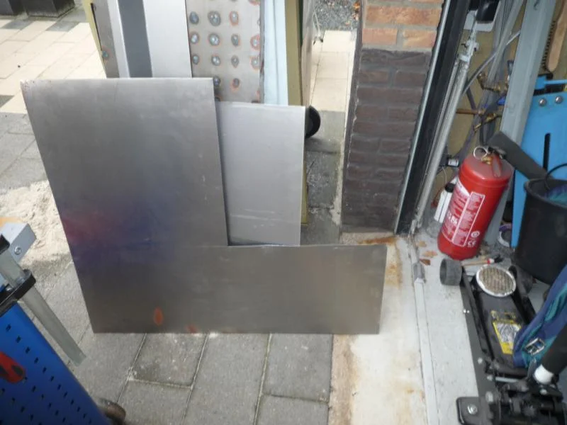

Started off with a sheet metal plate of 50 x 48 cm.
It is important to have at least one perfect square corner.
Took the messurements of the C post which is just under 35 cm.

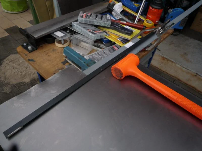

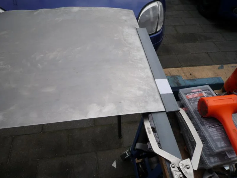

Made a cut 11 mm deep 35 cm under the top.
Used some angle iron 2 peaces and clamped them in the vice withe the 35 x 1,1 cm in between.
Take care that you have a straith line for bending otherwise it won't fit later on.
Use a big hammer and slowly bend the steel, use a flat bar to hit in the end to prevent dents but still get a sharp edge.
Sent from my iPad using IH8MUD

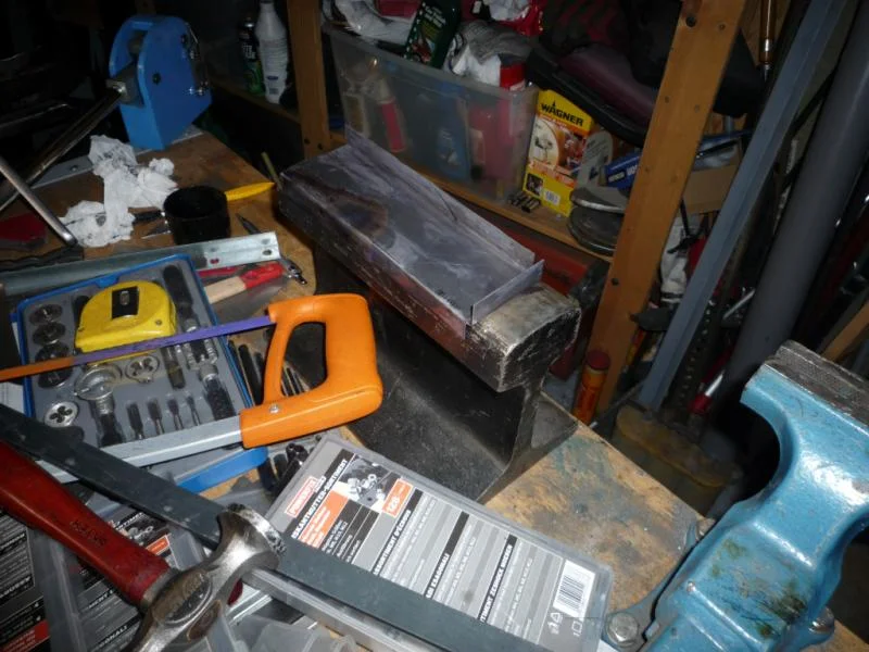

Second bend is the part going underneath the sill.
I meassured the distance before it angles down past the rear bumper, it is at least 20 cm.
Made a cut to bend it just under the sill.
Same method of bending and after that I started shrinking the edge untill it matched the curve of the sill.
You can see the flat bar and hammer used for the bend.

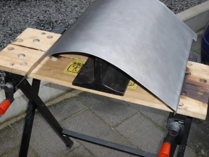

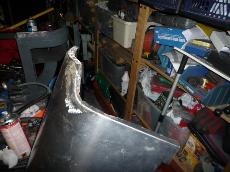

Next is bending to match.
I just start bending the curve in on the anvil slowly not to get edges in my curve.
Fitting all the time to get the shape right.
Then I trimmed the upper edge to fit the excisting part.

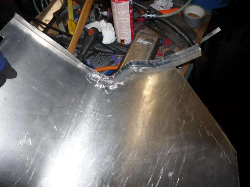

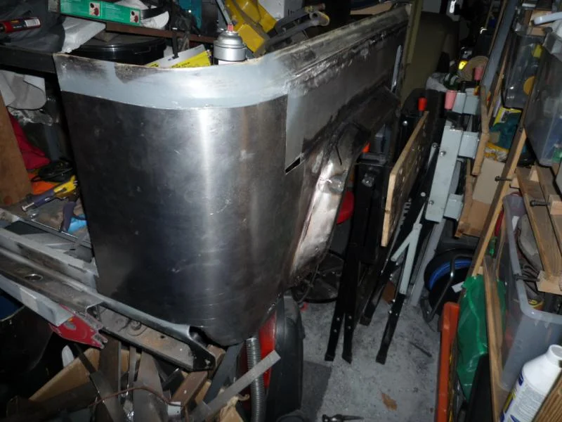

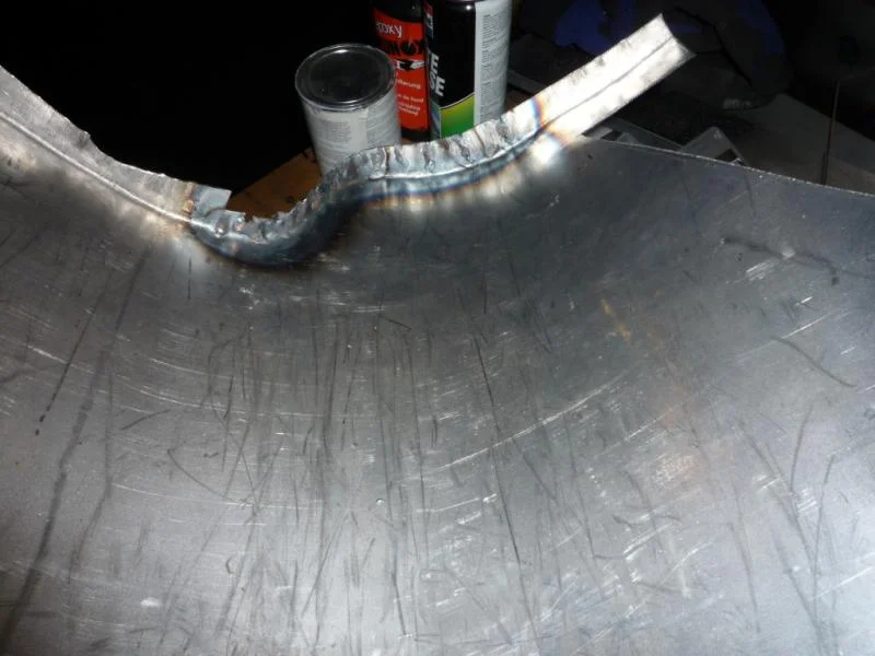

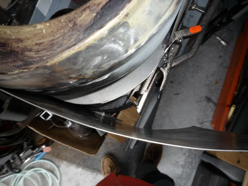

Next fase is to get the corner to connect to the rest of the fender.
For this I took a peace of angle iron and clamped it on the top of the fender where the 2 peaces overlapped.
It runs to the floor so it provides me with a good support in a line down.
I then clamped the sheet to the angle iron. I can then draw the cutting lines from the inside.
Next fase is getting the bottom in the right shape.
To be continued.

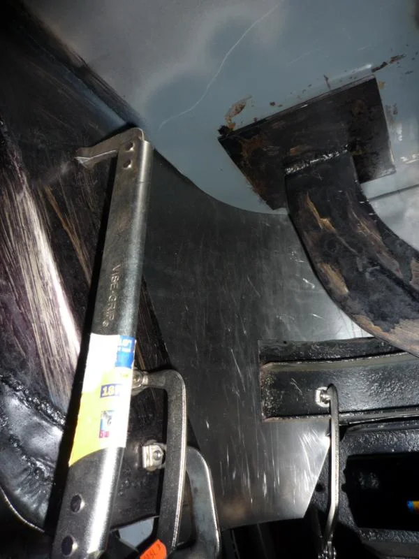

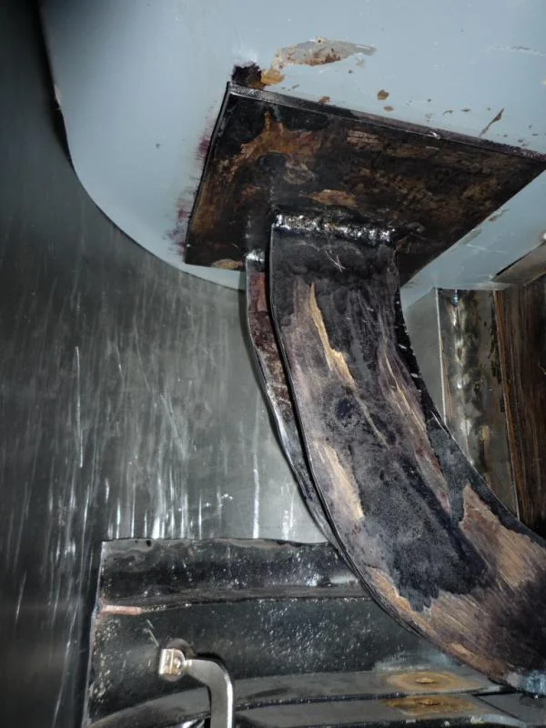

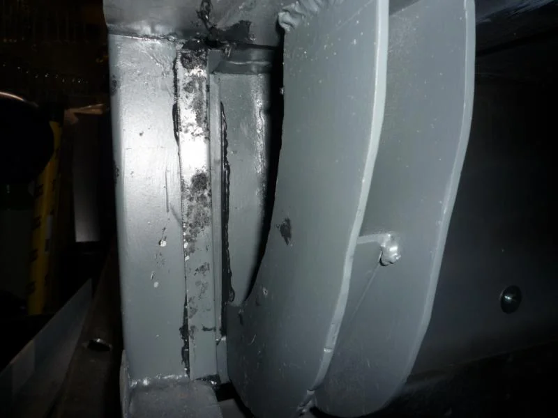

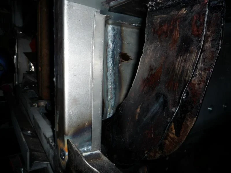

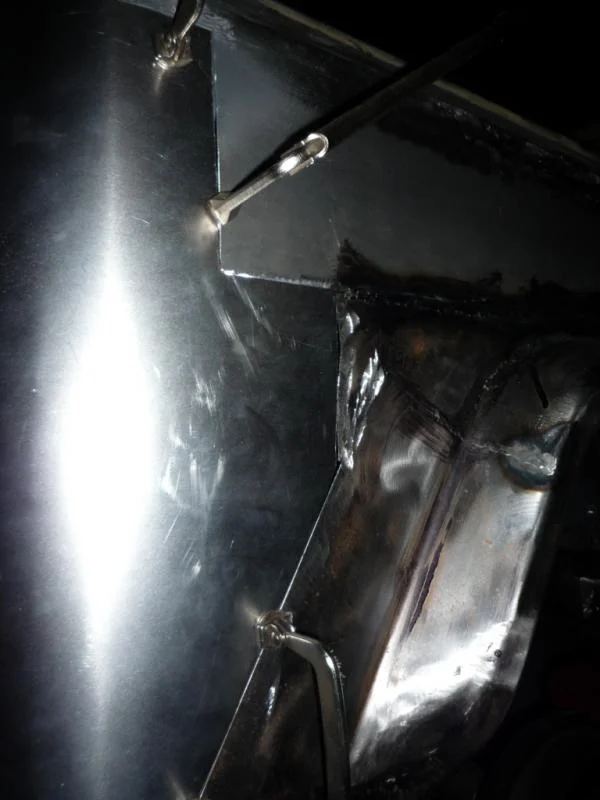

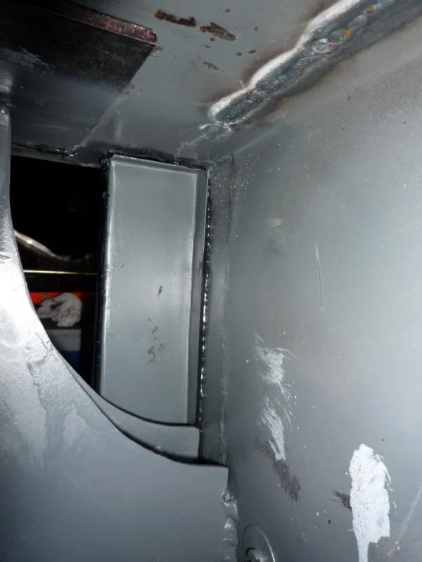

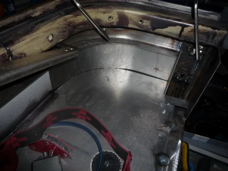

Got to spend an hour on the cruiser today so I made a plate to close up the C pillar in the wheelwell.
I plan to glue it in place, it has no structural function just to keep the dirt and moist out.

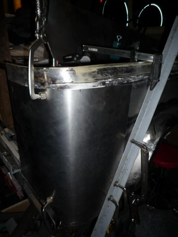

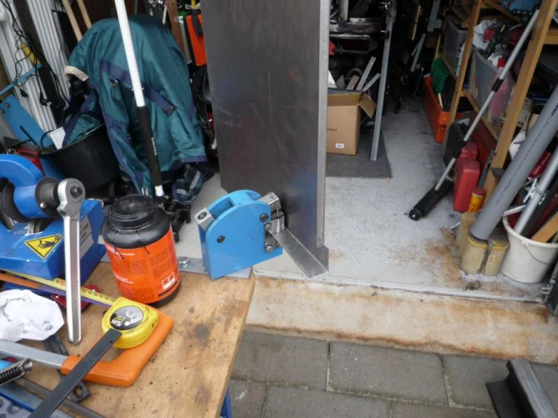

Question though, in post #286, picture 4, what is that blue thingamajiggy? Is it a bender or something?
Brilliant work mate!
I wish i had your skills, your patience, and when your finish, your shorty 40 :)
She looks pretty good. Im jealous...
It is a shrinker/stretcher. You can shrink or stretch parts the steel to bend them into a shape.
