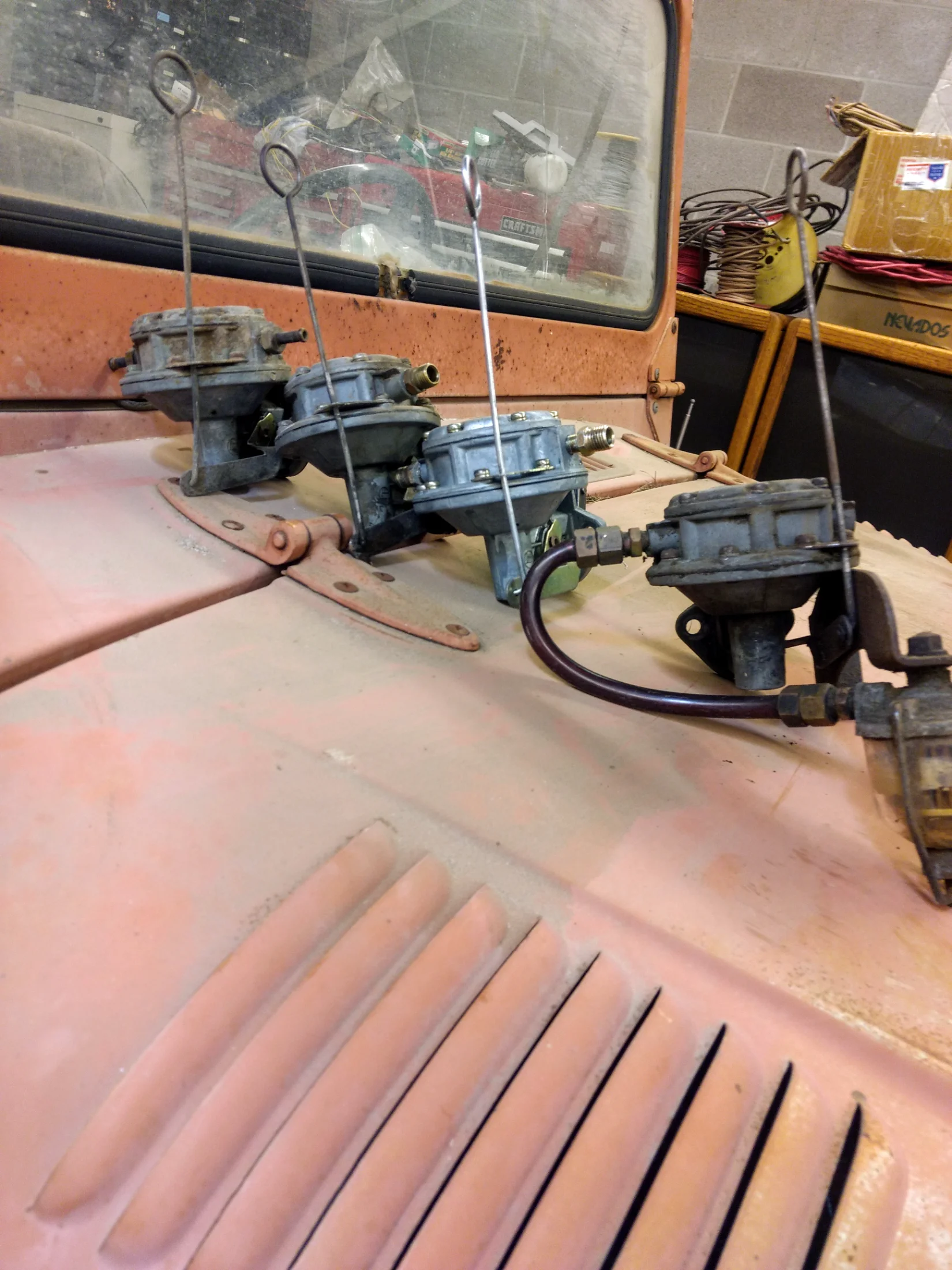

Toyota originally had option of priming the carburetor. They also invaluable when leaving a vehicle for a while and coming to dead battery. Prime carburetor. Couple pumps on the pedal, pull the choke and turn it over by hand. Using one of these would not have to mount and just hook of the inlet and outlet fuel lines and prime the carburetor. Hook up the lines to the original pump and start the 40.
