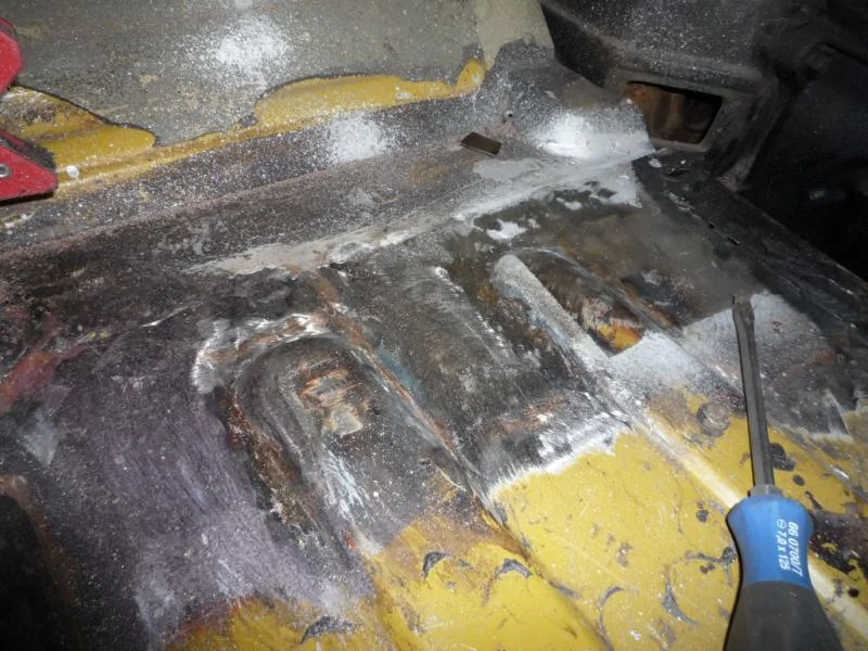

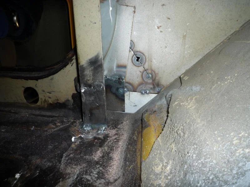

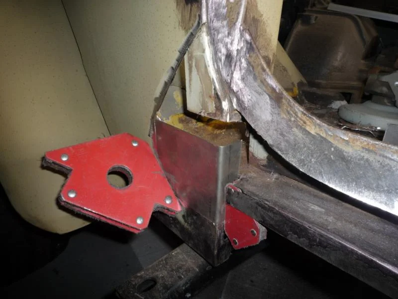

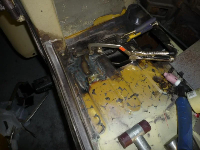

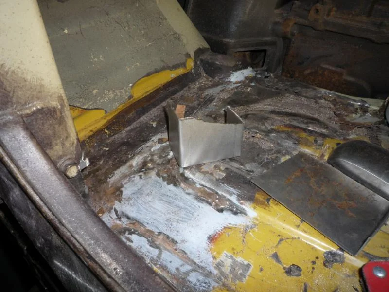

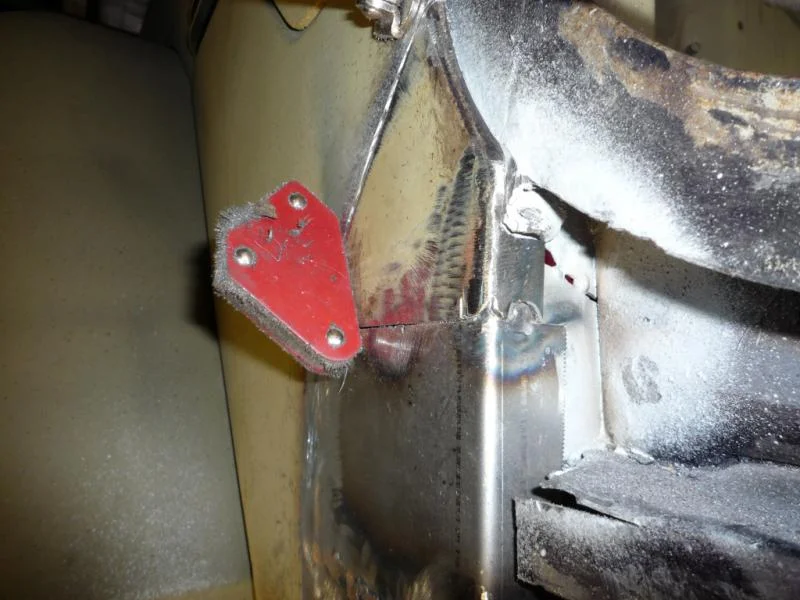

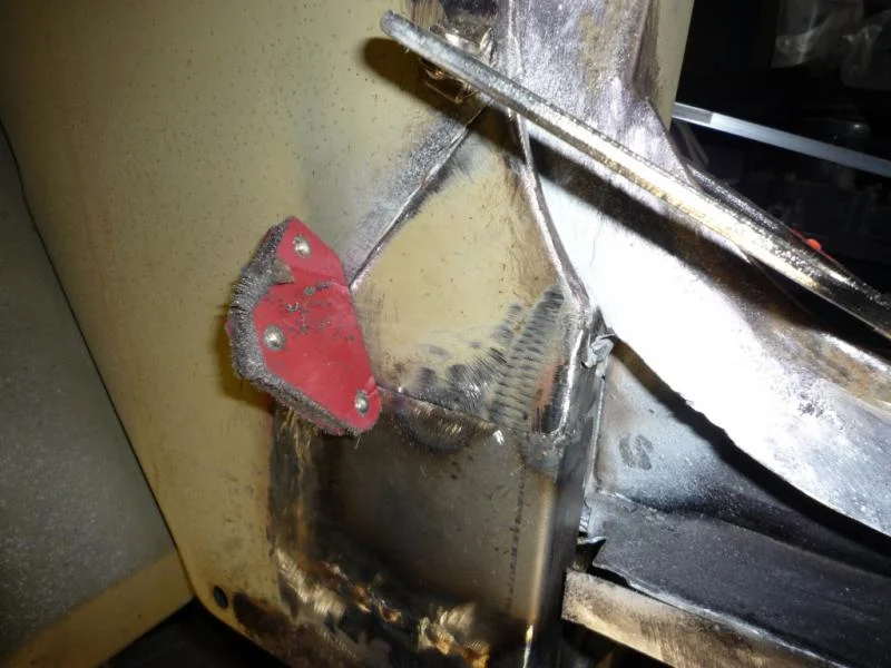

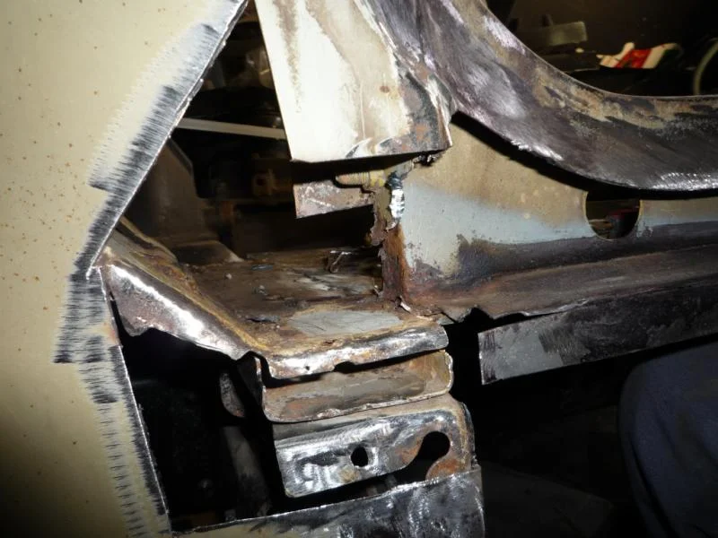

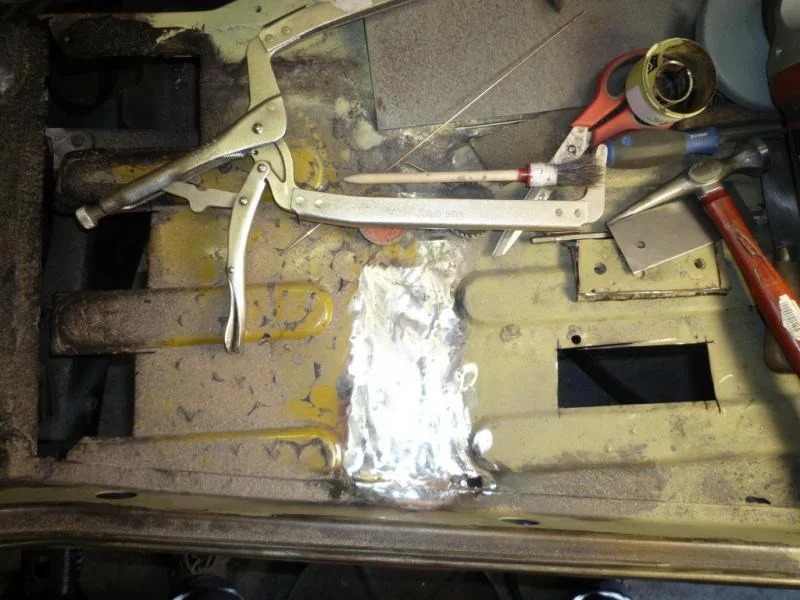

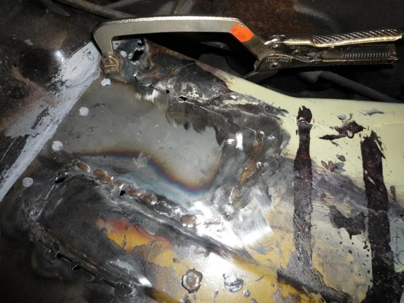

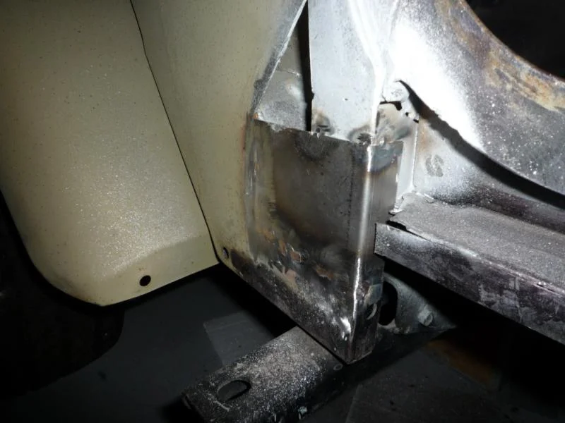

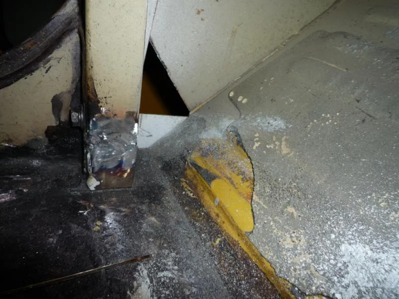

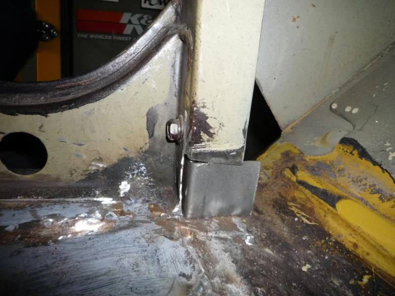

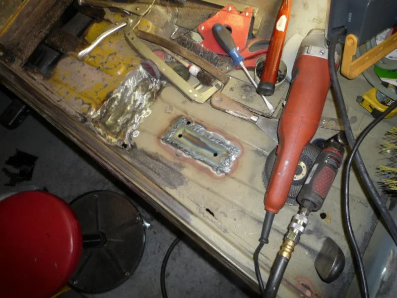

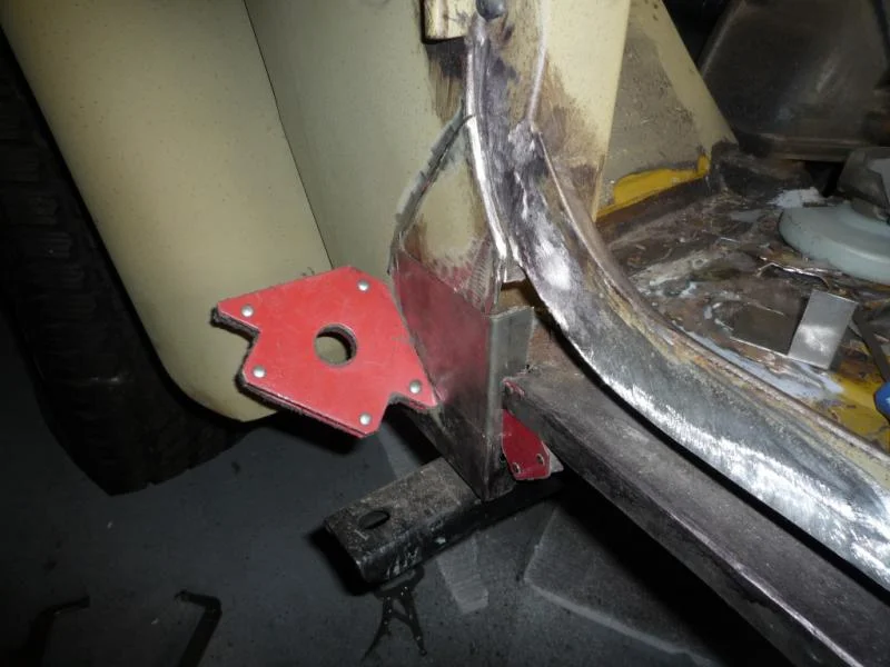

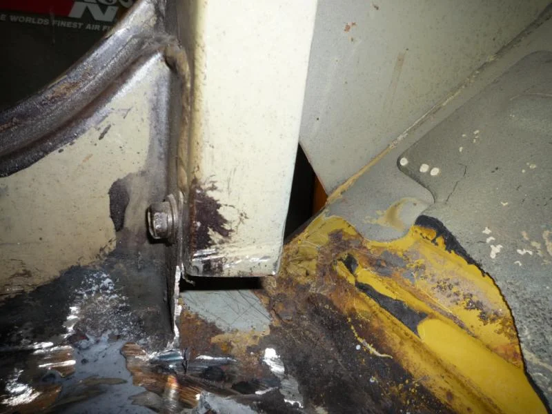

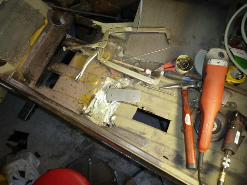

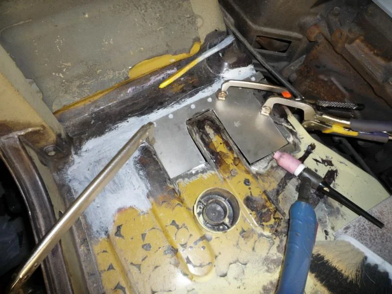

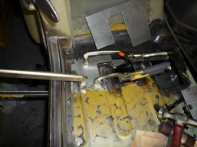

Started working on the DS floor. Some PO patches and some weak spots.
Sent from my iPad using IH8MUD

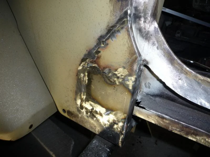

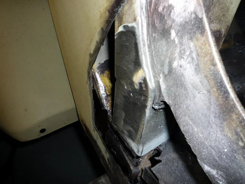

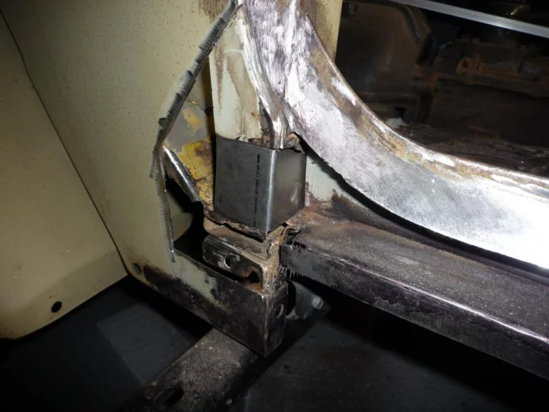

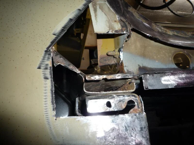

The front part had a patch places over the rust and had holes already.
Took a lot of grinding to get rid of the crapy welds.
Good to see you're back at it, Michael. Hope you new job works out better.
Thanks, it's nice to be back.
The new job is hopefully starting next month so enough time for metalwork.:grinpimp:

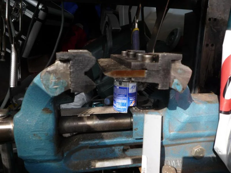

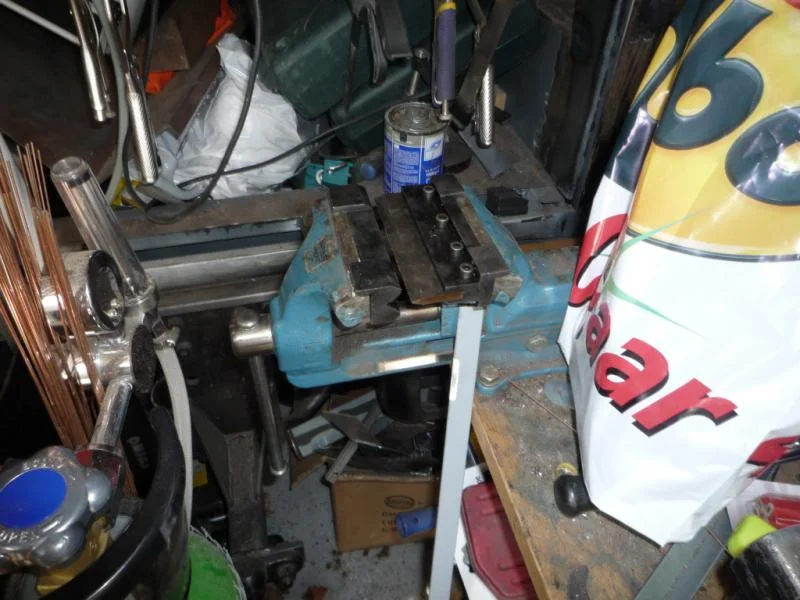

Where did you get the new tool and what do they call it. Been looking for something similar for my HF Press.
Here's the 6" vise mounted , also have a 5" unit -
http://www.grizzly.com/products/6-Vise-Brake/H3245
I plan to build one of these little buggers for light/small fab -
http://grabcad.com/library/sheet-metal-mini-workshop-press-brake
The swag unit is pretty big/heavy - if you have room they would be great just to have one on a cheap , stand-alone press like the one from HF , just plan to never use the included junk cast press plates - folks been badly hurt from them exploding .
