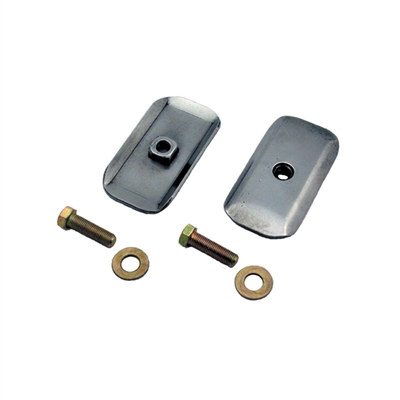

My 79 came with 3 point belts, although they were non-retractable... As @RUSH55 posted above, I've retrofitted the receivers for inertia reals into the pig body.. 2nd row belts from an 80 series could be cut out and used if you have access to a vehicle being wrecked. There is another thread i'll try and dig up too that has a few other ideas.
Edit; heres the other thread Seat belt question - https://forum.ih8mud.com/threads/seat-belt-question.751358/page-3#post-13561053
I drill A and B pillar and welded in these anchors. I then bought “Universal” 3 point belts from summit racing. Will post up some pictures shortly.
