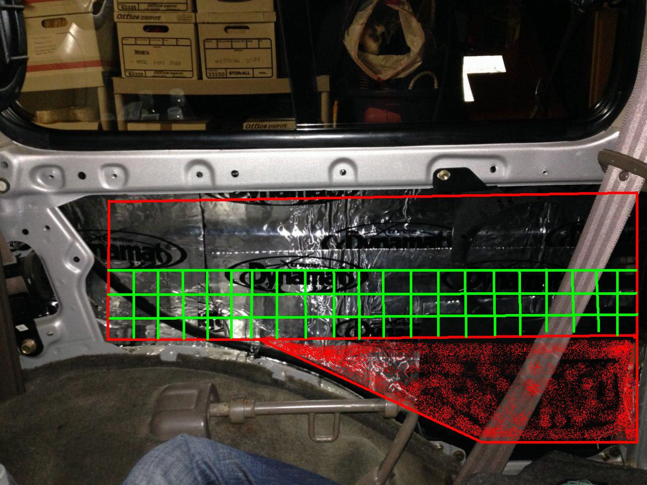

I would love to further discuss options concerning this. Its killing me that no one has been able to design a panel for this. Including myself. Here os what I was considering:

I've been contemplating this right side storage area for a while. I've got cutouts in foamboard that have taken me a long ways, but to bring something to fruition, that will require a lot of Q&A. Here are a few starter questions.
1. Hard as it may be, how many people would find it acceptable to remove all colored interior plastic from the 2nd row seat all the way to the back? Doing this would certainly open up the possibilities. I understand the desire to keep things stock. Of course if you remove the plastic on the right side, you'd want to match it on the left.
2. Would the purpose of this be to create openings into the cavity behind? If so, is it dead space behind, or would it need a shelf or two of some sort?
3. Would it be able to extend any further out than the existing plastic? Basically, if you extended it out another 1/2" or more, it gives more possibilities. It's a rather small space.
4. Speakers...
5. Is there really enough usable space behind the section that a cruiser head would find it worth the $$$ to utilize it?

Your on the right track. As much as I would love to remove both sides for some metal utilitarian panels I don't know if I would be willing to shell out the $$ for what it would cost to do. I'm not worried about keeping things stock. I would rather have function.

Build a can that you will cut into the existing plastic panel :eek:
The lower shaded area is a solid front of the can with the upper green area is stretchy cargo net
Thoughts?
Done with my MAD paint skills:rolleyes: from a stolen drawning
