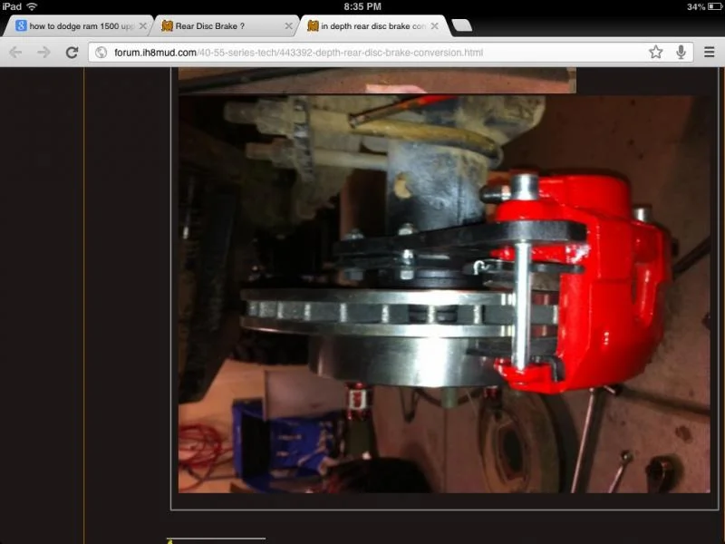

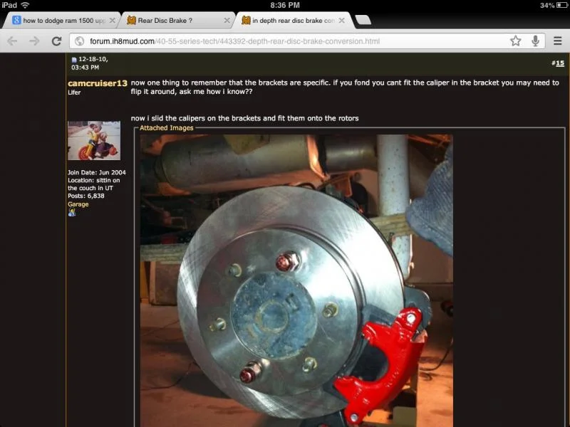

Do you have the right rotors? Take more pics of the flanges etc. see my thread pic halfway down

Your bracket or caliper is all cockeyed or something. I've been comparing side by side pics
See here
Disc woes
