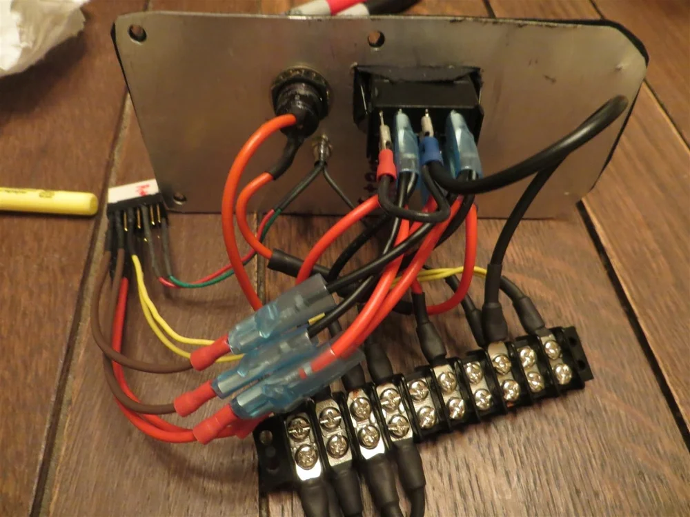

Using a direct switch control. Let me know if anyone wants to see a schematic, or wants to buy my (unused) pair of “1 touch” power window controllers. I’ll give you a good price!

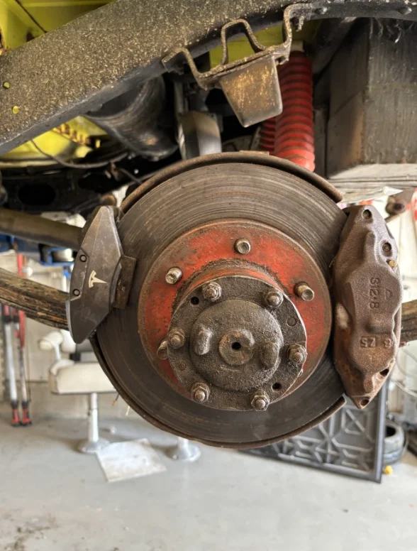

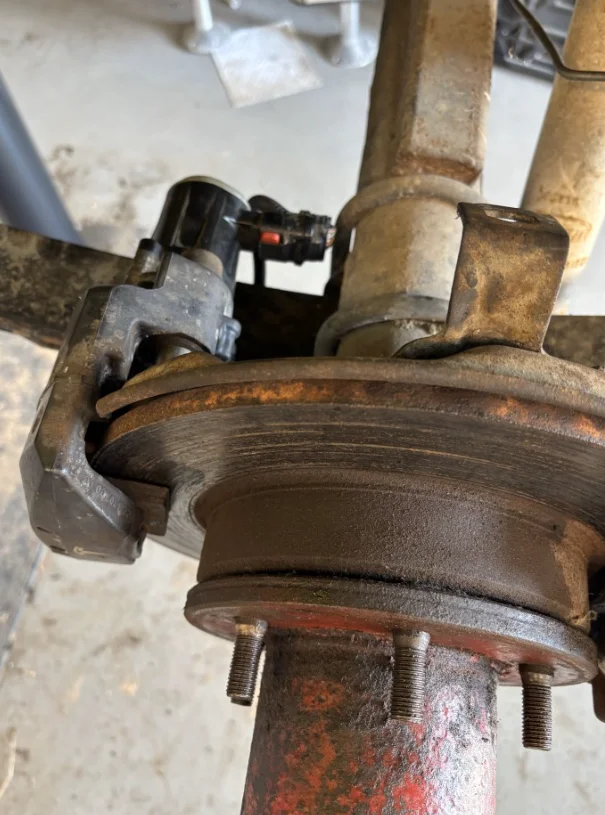

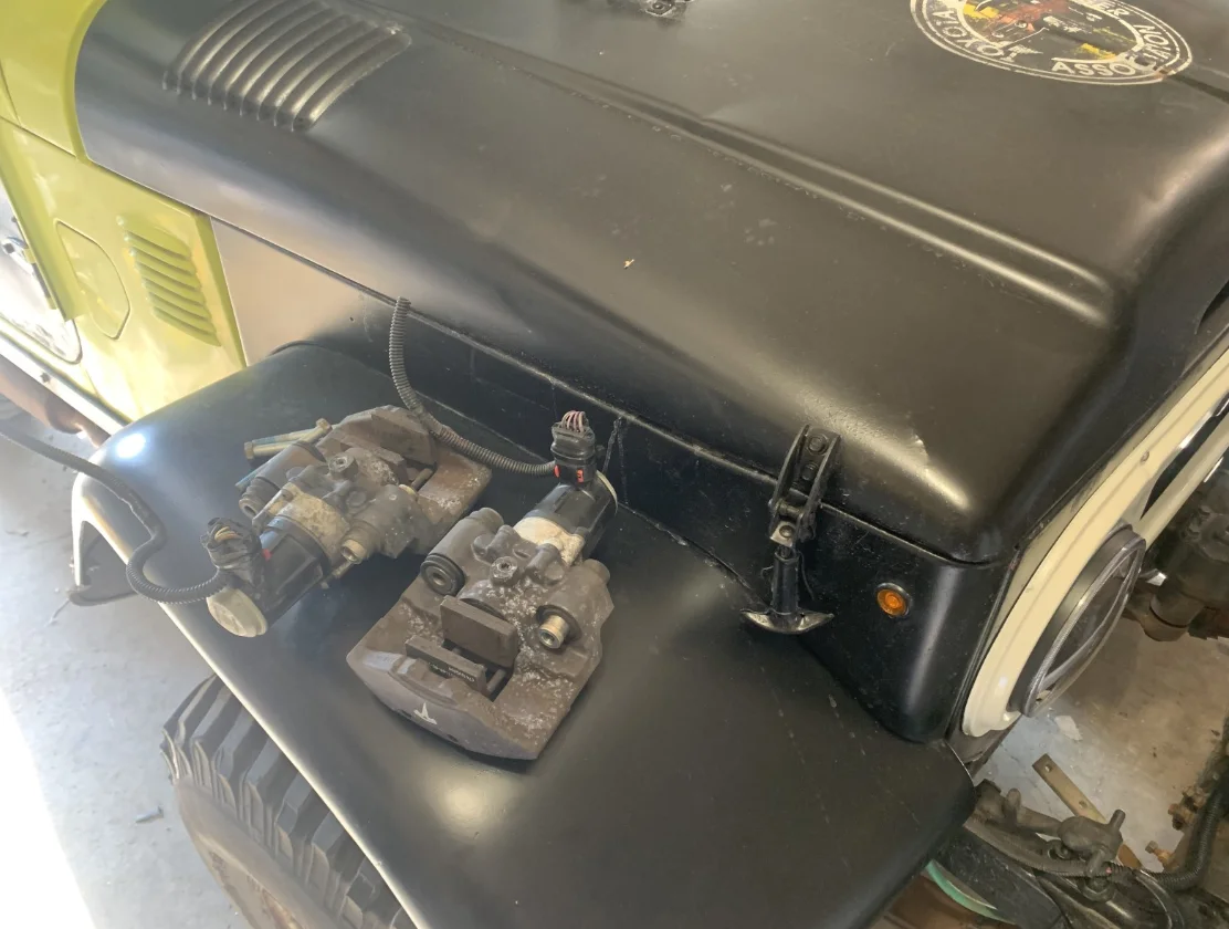

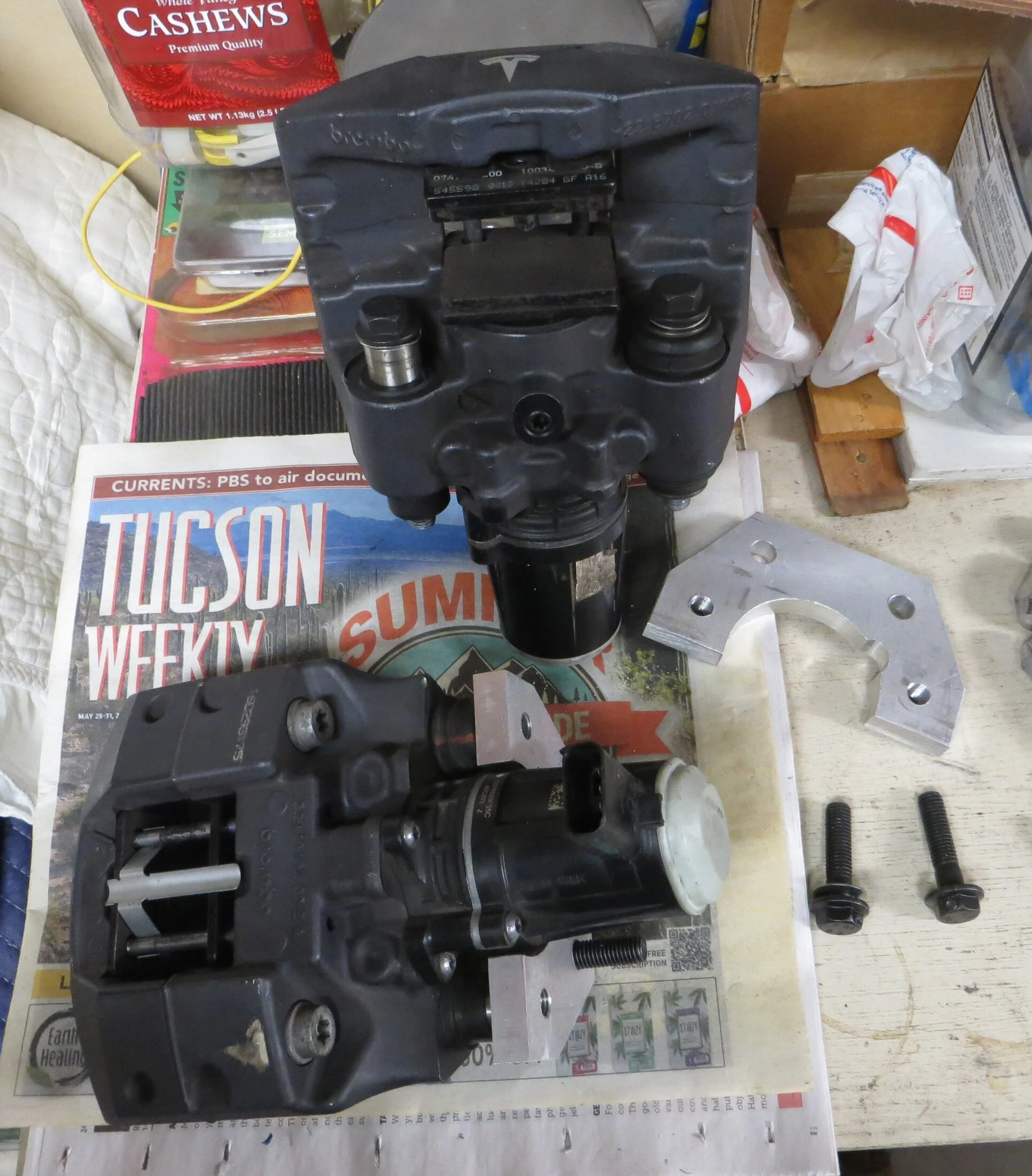

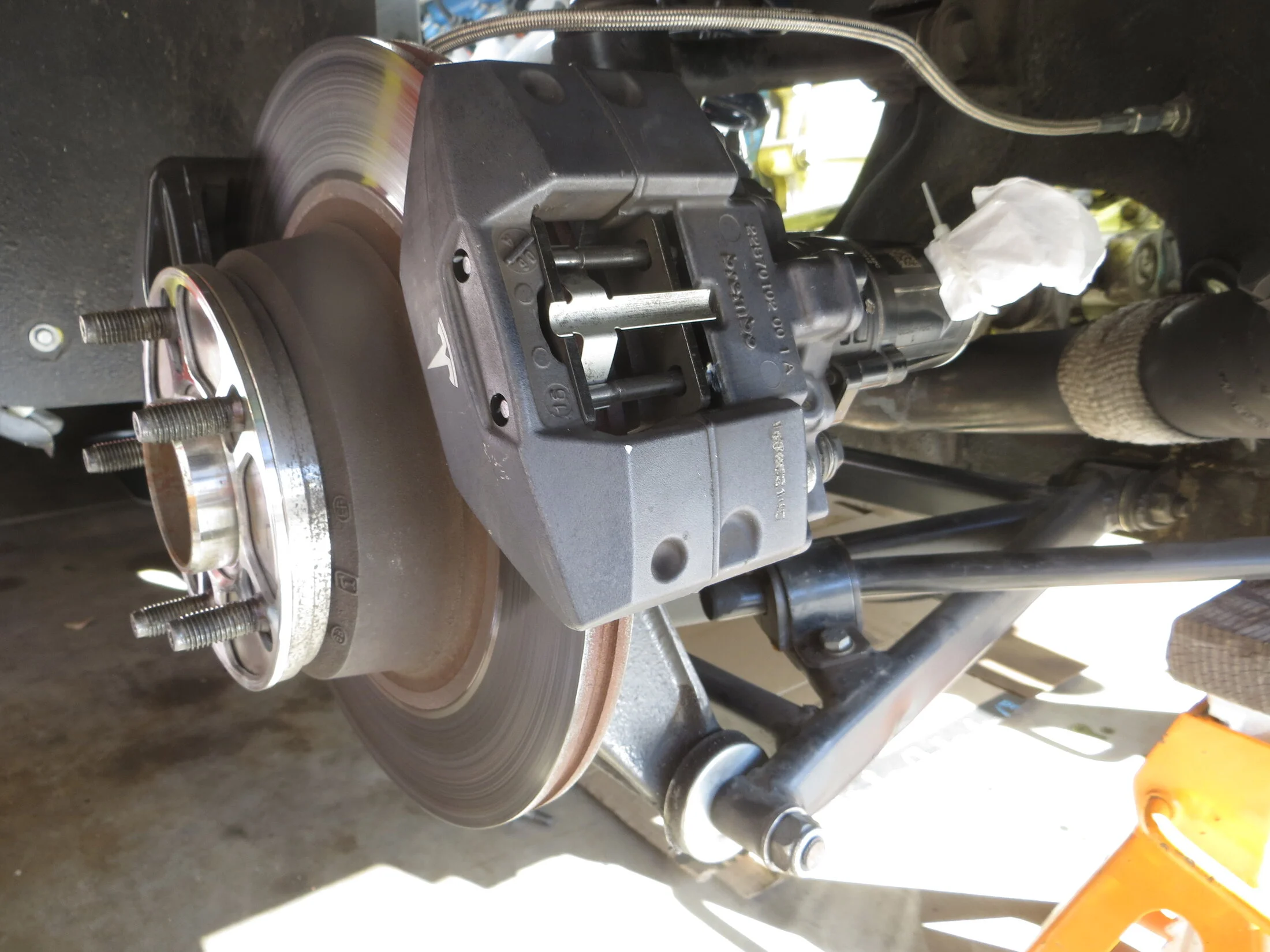

View attachment 3796101View attachment 3796103Finally got this one done! The ol' disc brake on the driveline thing was not working for me. This is a daily driver and she needs some time to warm up in winter, not to mention just being safe- a bolt down speed bump in the driveway worked for a few years on the warm up but offered no safety. I went for the Wilwood electric e-brake kit, which included both calipers, switch, controller, and harness that I purchased from Summit Racing for about $1300. I was not stoked to spend that much on this but would do it again in a heartbeat, given how it came out. The calipers came with mounting brackets that I had to change, so I drew some up on CAD and had them laser cut. They mount opposite the disc caliper and utilize the bolt pattern on the axle, hitting the top and bottom of the flange most rearward on the axle. If you're looking at the wheel from the outside of the truck, my brake caliper sits at 8-9 o'clock, and the new e-brake calipers sit at about 2-3 o'clock. Running the harness was not a big deal- there was plenty of length. I have the controller mounted to the very outboard wall in the glove box, safe from the elements, with the power coming right through from the battery on the other side of the firewall. Mounting the switch was probably the most tricky for my dash, which is wonky enough already as a result of some PO hackery. The Wilwood system does NOT use power while the brake is idle, either on or off, so no parasitic draws to worry about. It only uses power to engage or disengage. The switch has a nice LED ring around it to let you know it's engaged. The brake is rock solid!! Was parked on a steep hill with a trailer the other day and she was just sitting there, happy as can be. I like the fact that it's both wheels. I have been trying to solve this off and on for a while now, and couldn't be happier with the way it turned out. I had a few hiccups with the system- the LED ring also acts as a flashing code indicator if something is off. It was throwing a voltage code on the left caliper, so I called Wilwood and they immediately sent out a new caliper which fixed the problem. They were absolutely fantastic to deal with on all fronts. Love any customer service in this day and age, but they were next level for me!! One of the top 5 best mods I've done to date.

I bench tested them using a M12 cordless tool battery and it worked fine. I think crawling under the truck to do that wouldn't be too big a hassle.The little reading I have done on modern electric e-brakes mostly agrees with the fact that the brakes will be stuck on (or off) in the case of a dead battery. It comes up on various OE forums (Honda, etc.). In the event one cannot get a jump start, or enough power from a portable unit to release the brakes, it could be a bit of a PIA to get them off. In the case of the Wilwood, the mounting bolts are accessible without removing the wheel. Once the slider pins come out, the pads are no longer connected to the caliper and may be possible to wiggle off. Hard sayin'.

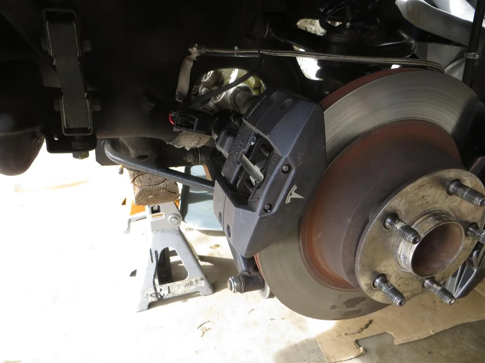

Electric Tesla part? I saw something like this on FB the other day and didn't remember it. So full electric actuation?Finally got one side mounted up. I guess its a hybrid now.
View attachment 3983283View attachment 3983284
