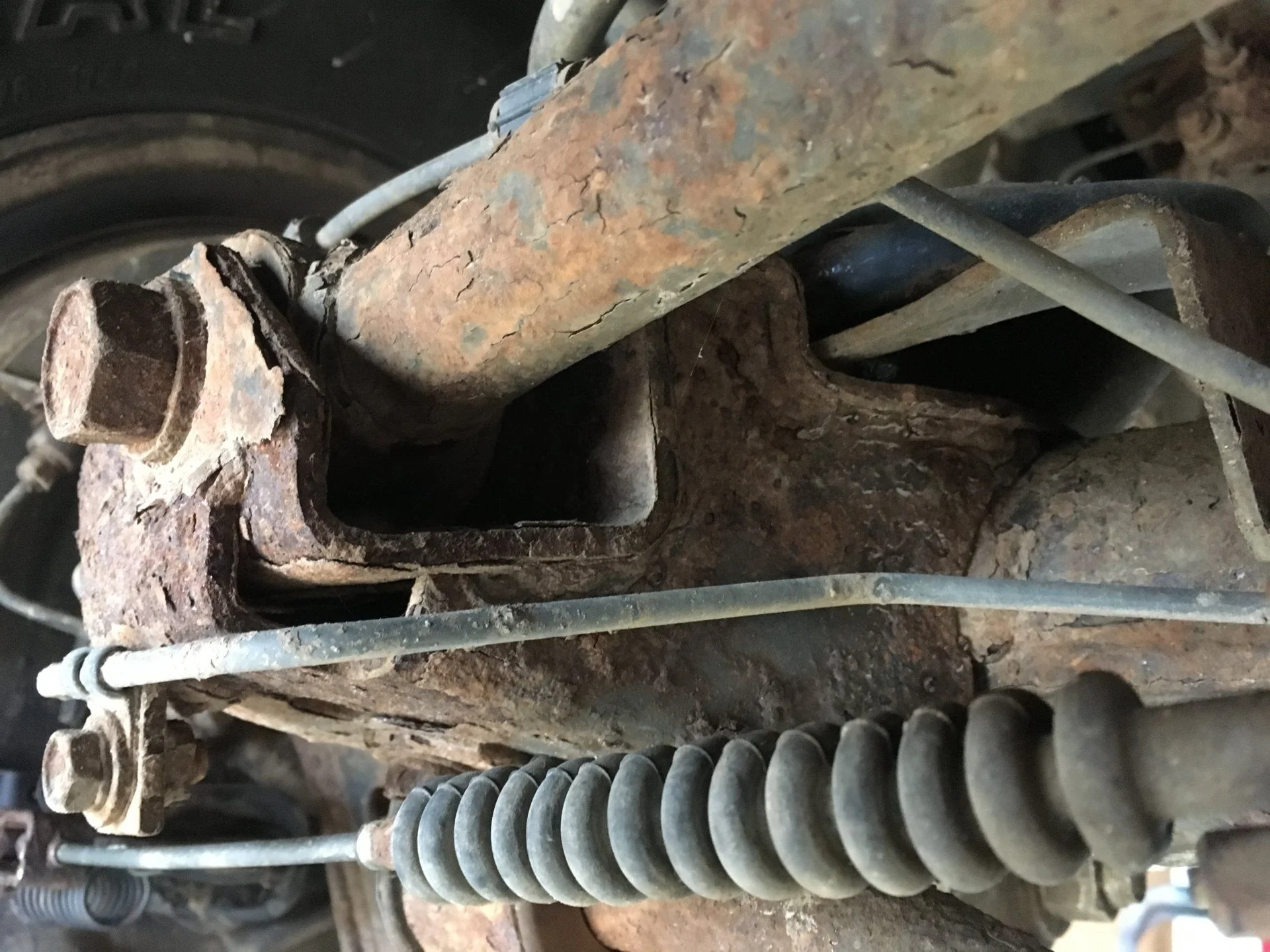

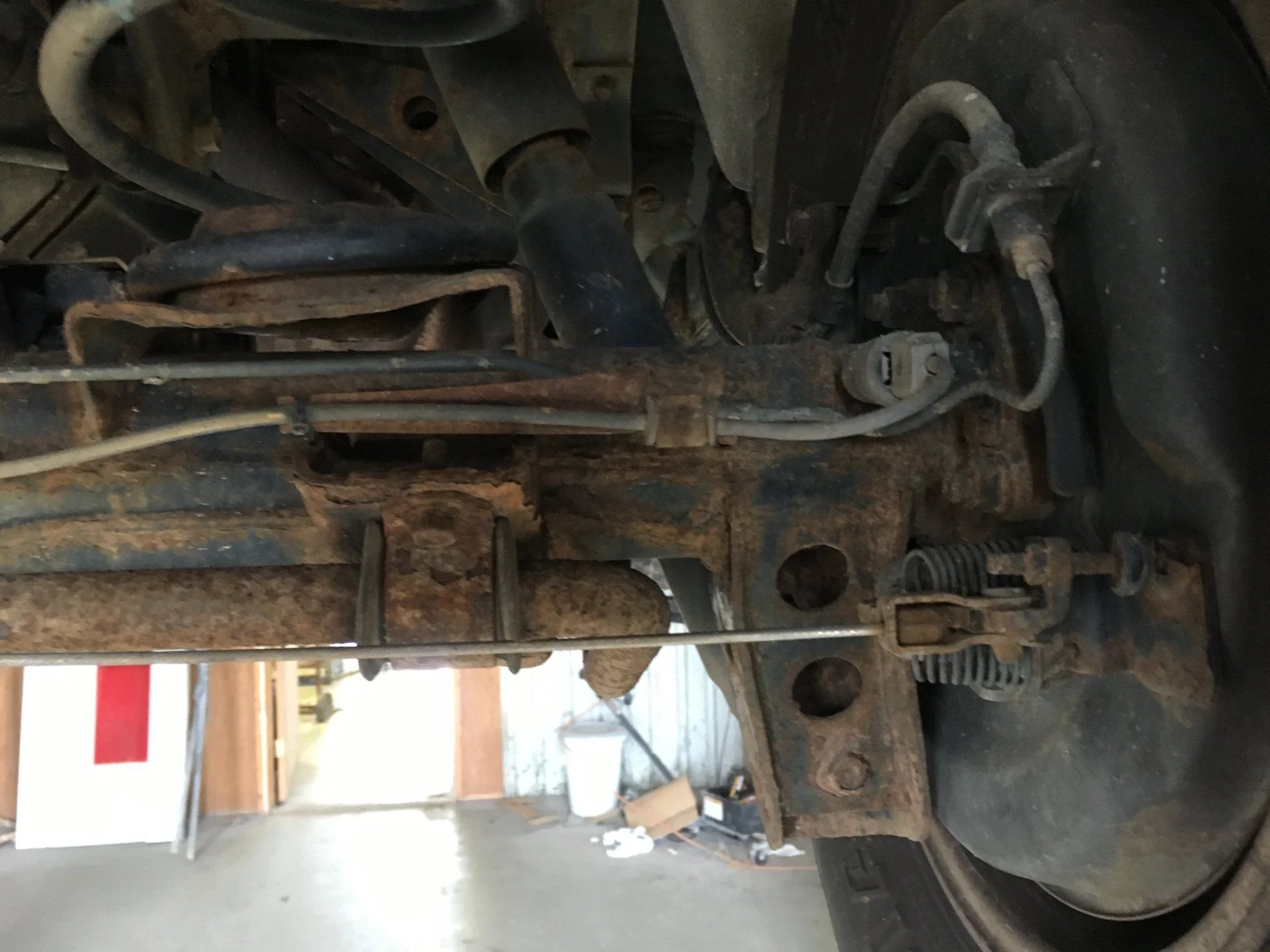

Alright, hopefully I can get these pictures to post. Baldilocks, I think you may have pegged it. The front is nowhere near as bad as the rear. Your hypothesis is the only one that makes sense.
Slow95, I will be contacting you shortly, to see what kind of a deal we can work out. My mechanic is offering to blast my current axle but I may prefer to replace.
If that truck was for sale up here, it would be advertised as "almost rust free"...
Did your mechanic say why exactly the axle needs to be replaced?
