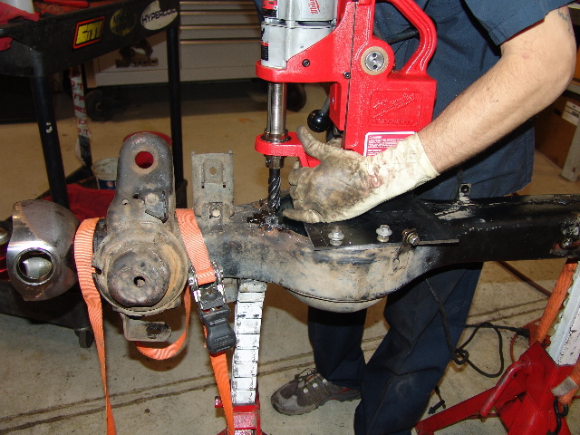

Front housing modified to accept electric locker third member

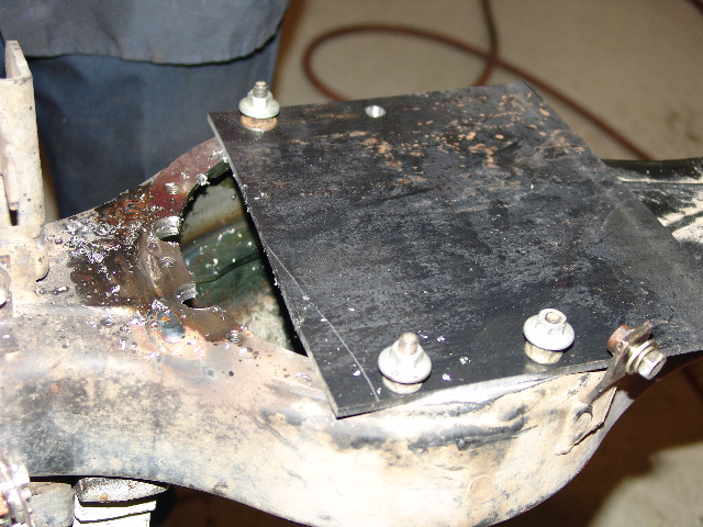

A metal plate is bolted to the third member mounting surface.
Next we use a portable magnetic drill press to drill corner holes on the notch.
Using an auger bit to form the corners of the notch.
Next we cut the notch between the two holes.

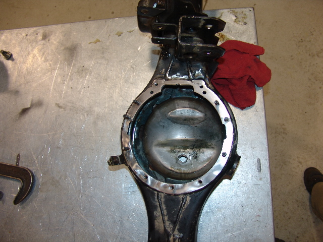

Some welded is added to the housing to increase the sealing area. This is ground smooth to provide a flat sealing surface for the third member.
The modification complate with the new holes drilled and tapped.
