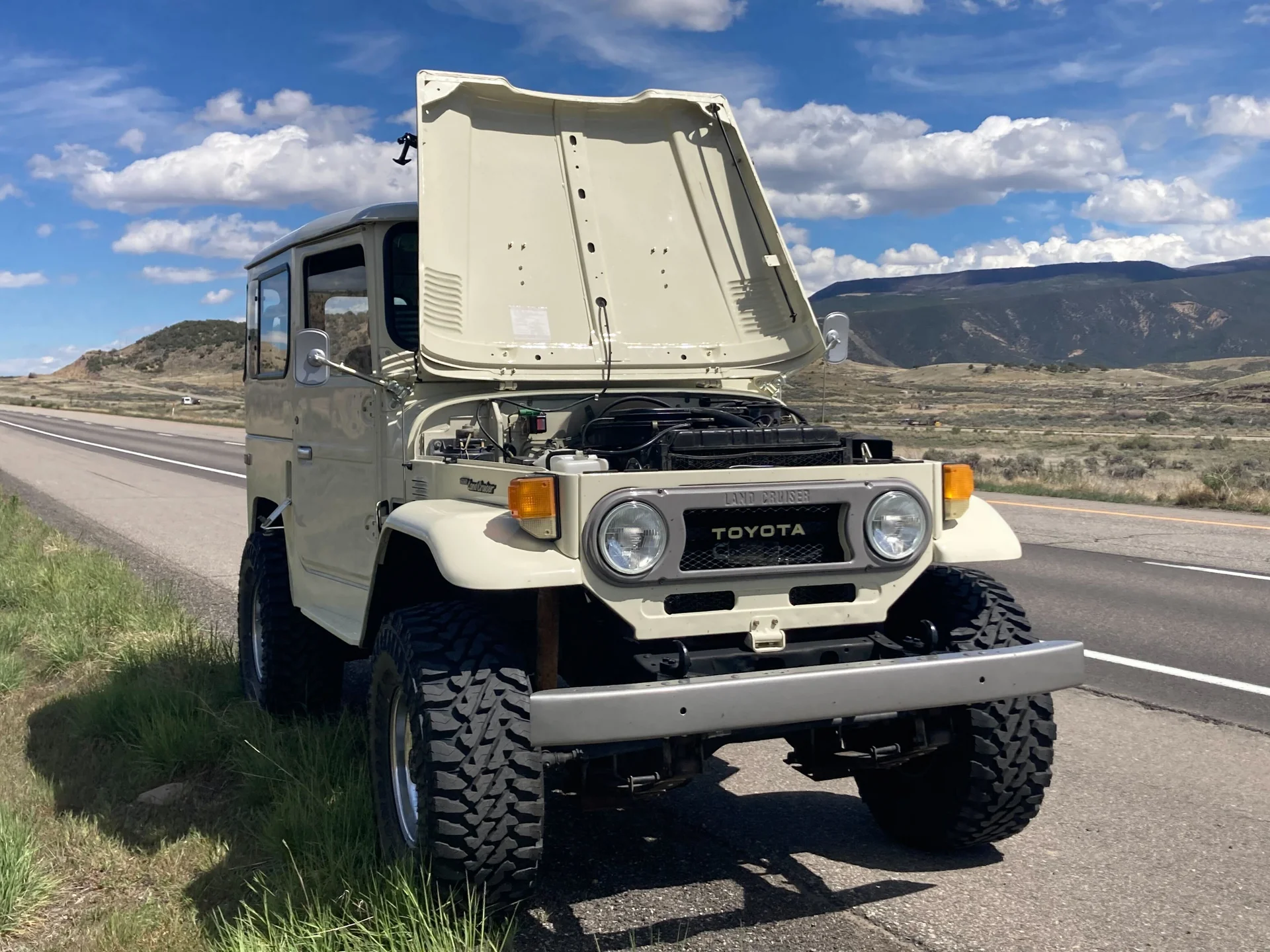

So @PabloCruise is stranded in grand junction on his way to cruise moab.
They are thinking fuel delivery. 1976or 78 fj40 carbed
Drove fine until outside of parachute. Then started stumbling lack of power.
Opened gas cap, no real change
Been using ethanol free, no change
Changed fuel filter, there was some rusty particles in it.
Ran and changed another fuel filter. Ran like 💩 again, then fine for a little bit.

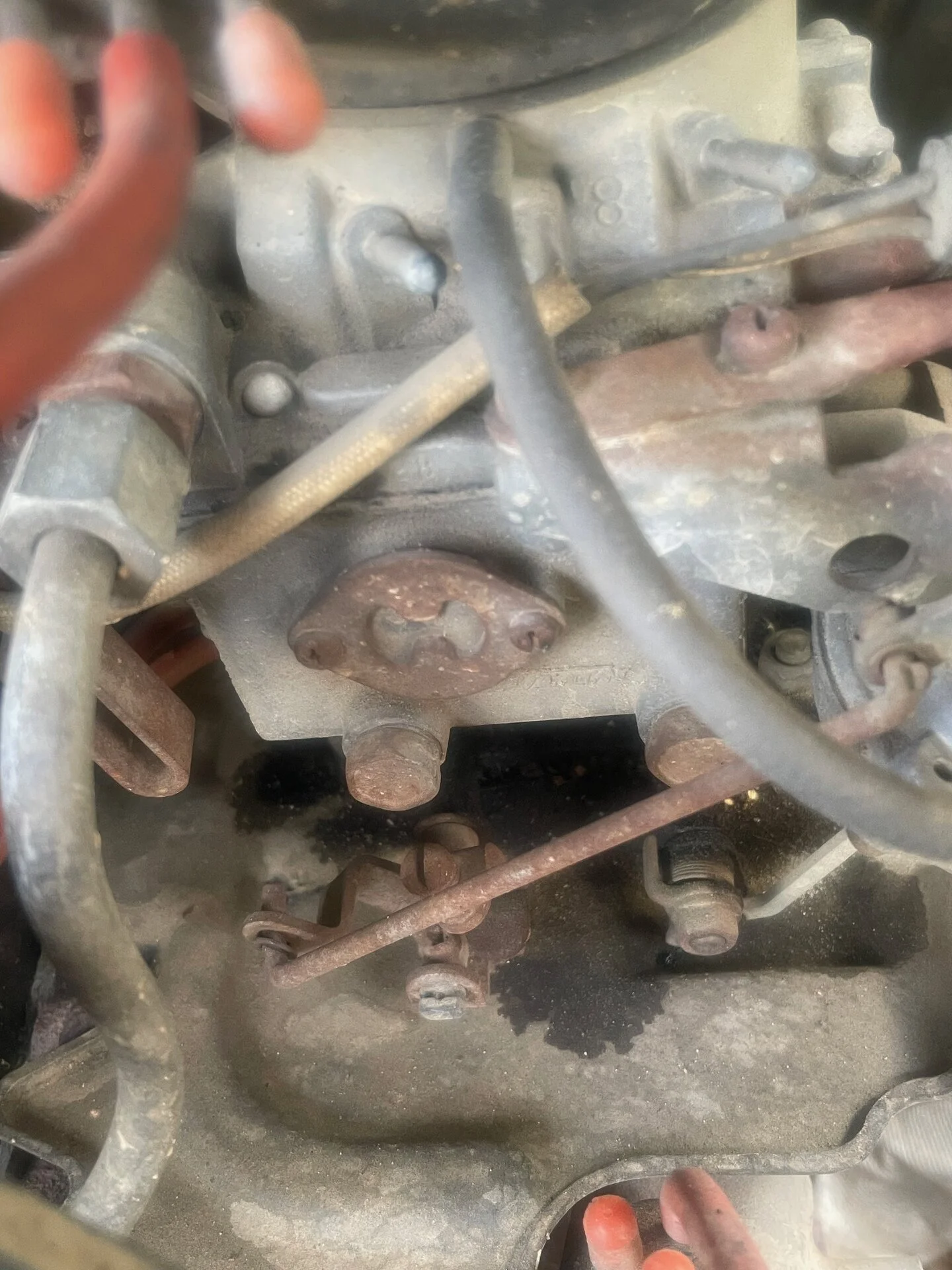

This came out of the first filter.
They are planning on taking all fuel out of tank, but don’t have a way to do it. Any shop recommendations or members in that area?

Pull the drain plugs on the bowl and flush with carb cleaner. May help some until the issue is fully resolved.

I'm assuming OEM carb. The pair of drain plugs are below the sight window and are 14 mm heads. Access is easy. There is a copper washer with each one. Don't lose those. You shouldn't have leakage after pulling these out and reinstalling, there's no substantial fluid pressure in the carb. Pull the drain plugs, use a can of carb cleaner with a straw and flush out the fuel bowl.
It appears draining the fuel bowls and flushing may have done the trick. They are going to press on….
