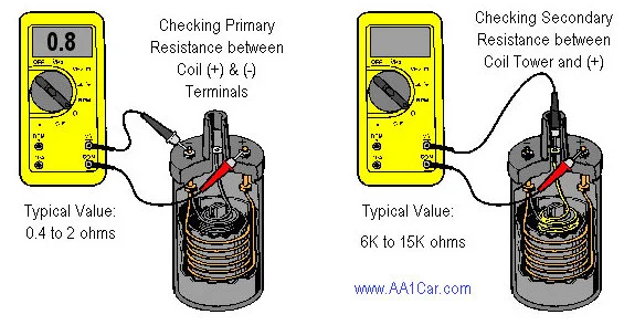

However, if coil is seperate, here’s a basic means of testing such

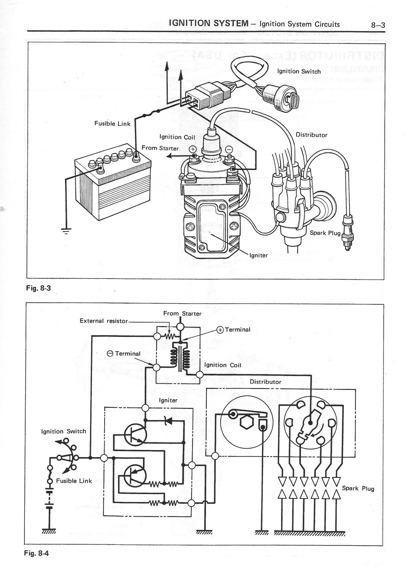

It is a factory Toyota dizzy, the coil is on the passenger fender (inner).

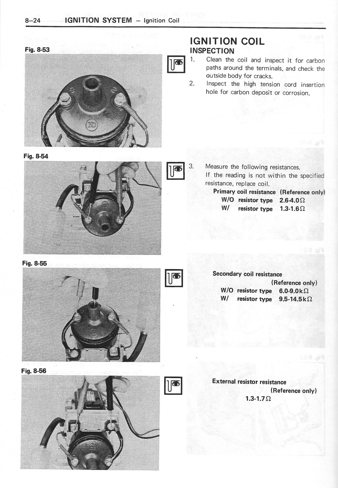

I am going to test my coil as per the FSM when it warms up outside, but so far this idea is checking a lot of boxes for me. Especially since our fuel system work did not yield the desired results. Not to say that was a contributing factor!

Rough running, stalling but eventually wouldn’t start (cranked, no fire). It had maybe 2 ohms resistance on primary (bounced around) and was completely open (no resistance) on secondary.
