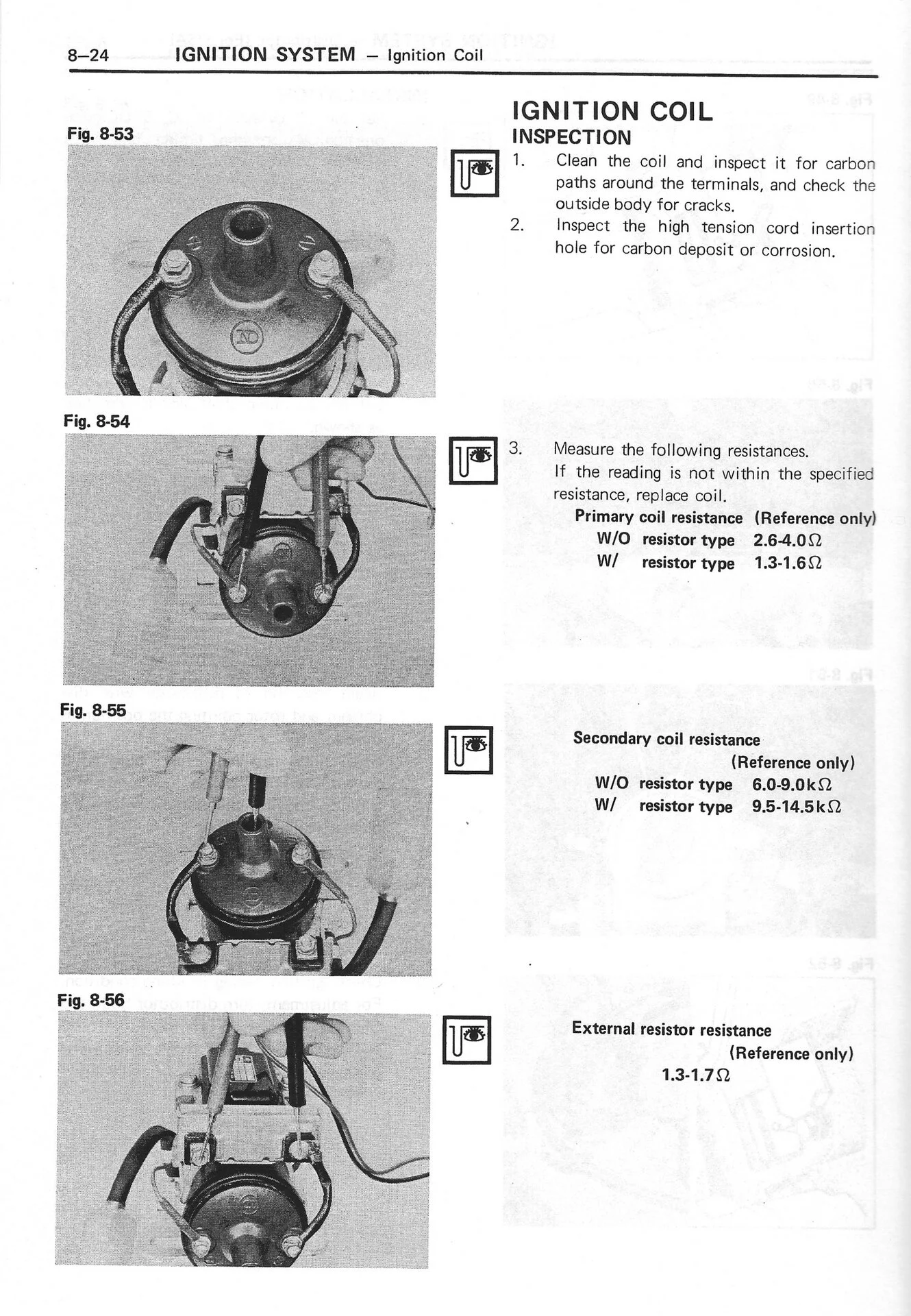

On your readings, you get 1.1 ohms on your primary and 13.48 k ohms on your secondary. That don't sound right if your the manual is correct to you fj40. It says primary should be: 2.6 - 4 ohms and the primary should be 6 - 9 K ohms. Almost looks like you have a good coil but the wrong application.....but I need more info before I can say that. Can you still see the part on the coil. I try getting the oem ones.

Thank you - see the test specs for Resistor Type - the primary and secondary windings test like this type:

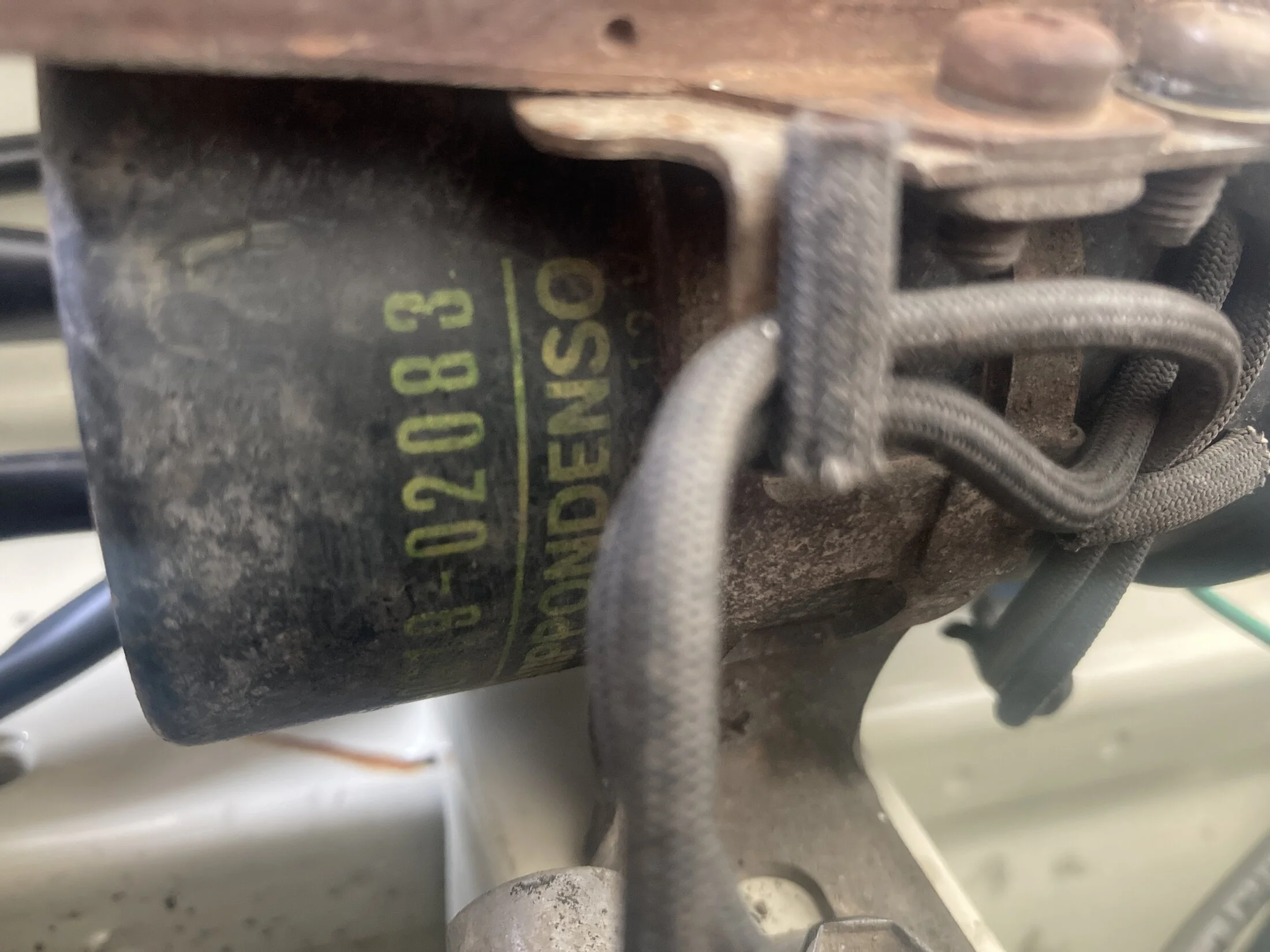

I was able to figure out what coil I am running:
