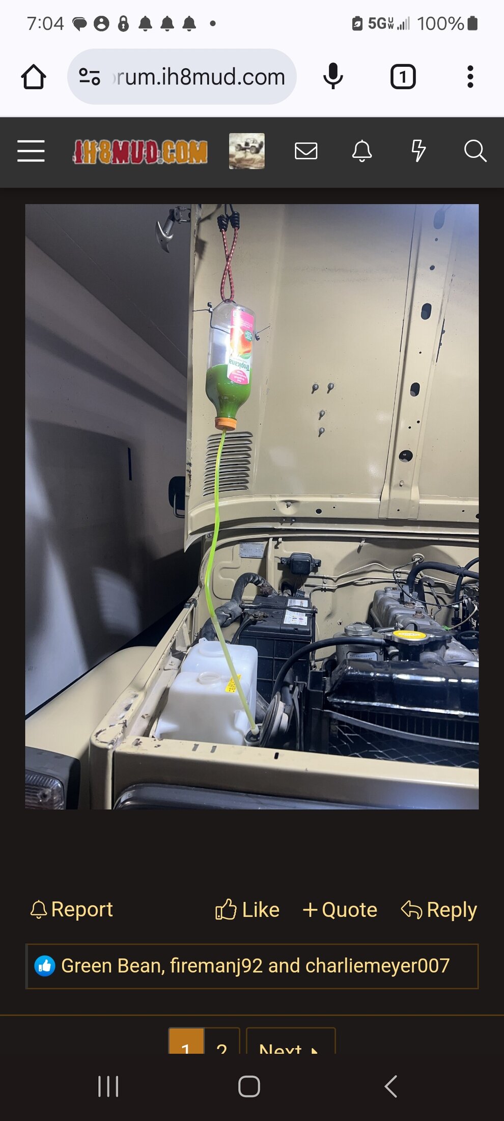

After a 45 / 60 min drive normal highway; my radiator fluid is boiling / overflowing from reserve tank release.
I am running a mix of anti-freeze + water and there's no thermostat. My temperature sender was dead. I had previously flushed & cleaned the system several times before and the system was empty for a long time. I feared a head gasket leak as the coolant colour changed to an dirty olive. Also at start-up, there are a "few" drops of fluid coming out of the exhaust. But that stops after a while; but no smoke.
I have jacked the front help release the bubbles, there was plenty. But was convinced, it was a head gasket leak - maybe a minor / small leak. Ordered some head gasket sealer (K-Seal & Blue Devil) and a tester. Tested it, and the fluid remained blue; but there were a constant stream of bubbles coming out. Ran it for about an hour (mostly at idle), the fluid never changed colours, but the bubbles did not stop.
Does this mean I have a very small leak or should I be looking at some place else? The water pump is functioning; when you squeeze the radiator pipe, you can feel fluid flowing. I have replaced the temperature sender and will take it for another test drive.
Debating if I need to use the head gasket sealer? Appreciate your input.

This contraption is just replacing the stock overflow tank and according to your description, appears it's working as it should. It's results are to be expected. Does your test kit indicate there are exhaust gases present?

The over flow tank is fed by the small hose next to the rad cap(circled in the pic). As the coolant gets to operating temp and the cooling system builds pressure, coolant is forced to the tank. As the coolant cools, it is sucked back into the rad. It is a closed cooling system. The tank has to have a/f in it when the engine/cooling system is cold for it to work properly. Using the proper cap for the application is important.

My contraption "IV solution" was mainly to get the bubbles out of the system; which happened. Agreed, as the engine / coolant gets hot, it is typically forced out into the reserve tank and then when it cools, it is sucked back in. If there is not enough fluid in the tank, air get pulled in. That's why i make sure there is alot of fluid in my bottle before the cooling process. If there is a leak in the cap or elsewhere, then the fluid would not get sucked back in. right?
