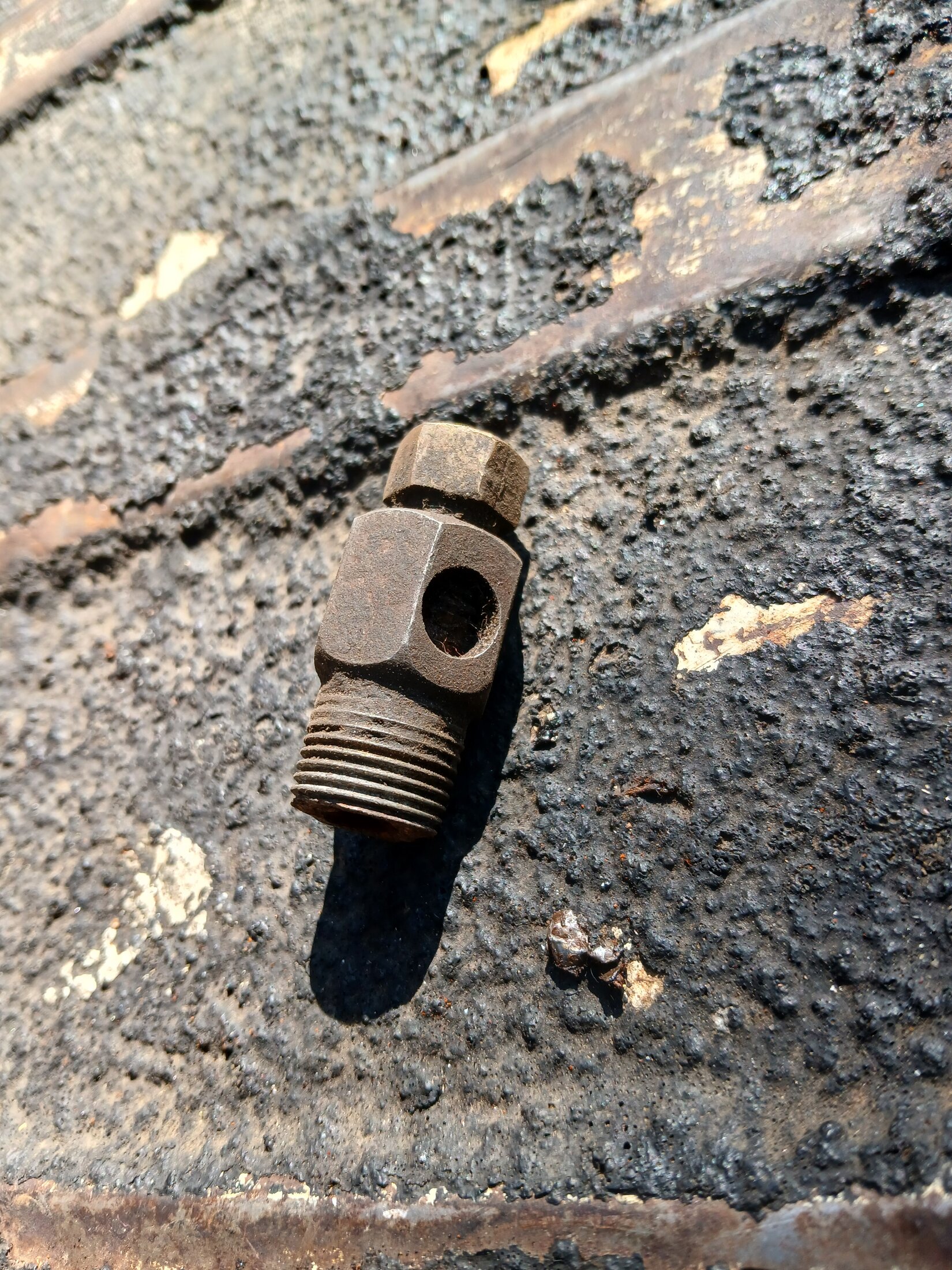

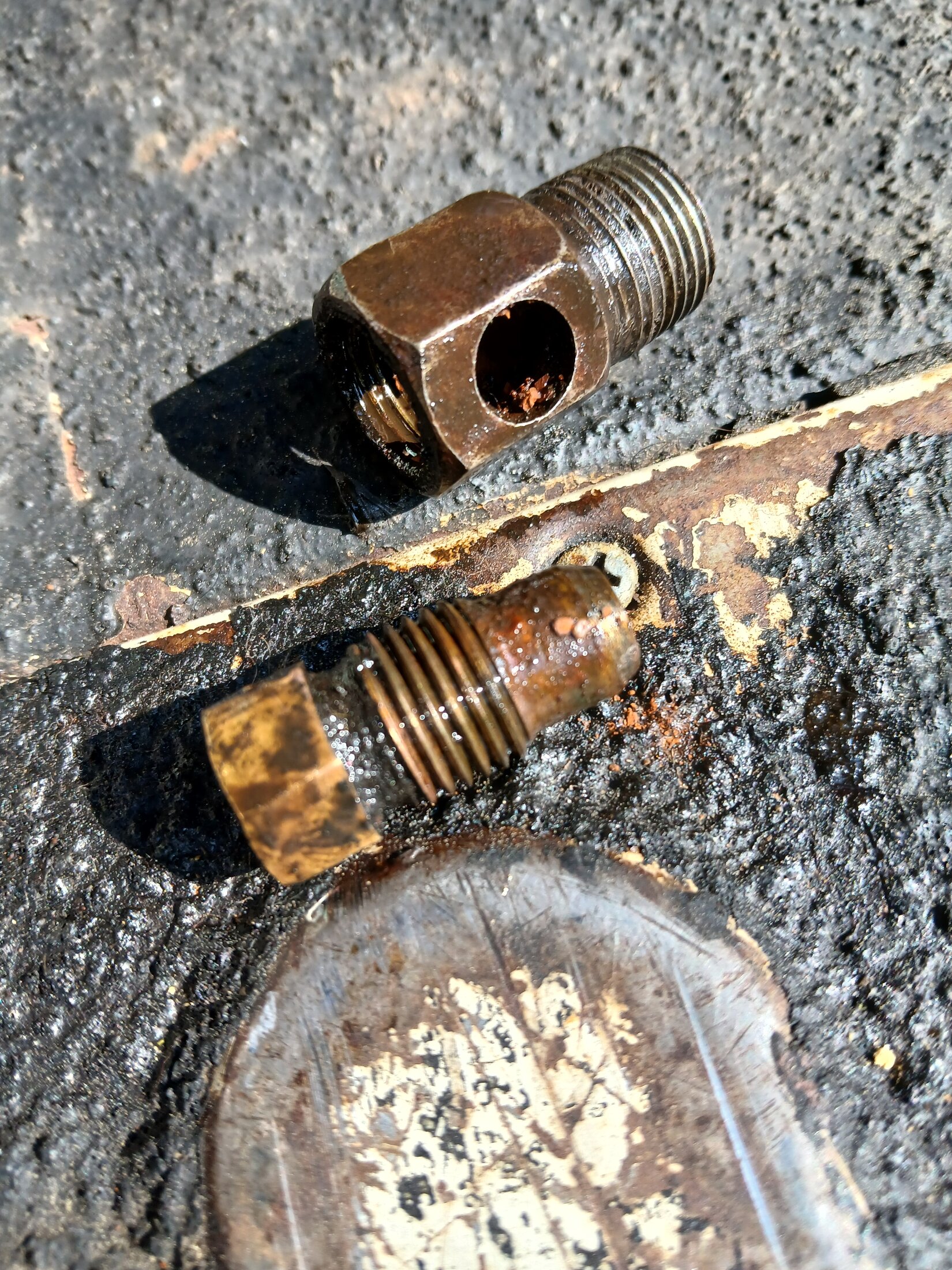

Block drain? Can you send me a picture of where it should be?
I replaced the temperature sender and noticed there was green coolant in that location.
block drain will be exhaust side of block, close to the firewall, cylinder 6 area between oil pan and head.
if it hasn't been opened you may need to use a stiff wire to poke inside and clean to get flow thru the opening
The block drain is the lowest point in the cooling jacket where crud likes to settle & build up. If opening the valve doesn’t let it flow than you’ll need to unscrew the whole valve. Clearing it out can vary anywhere from flushing or poking it to even in extreme cases (like mine), a drift pin and hammer to break through hard solidified aluminum powder leak stop that the previous owners had dumped in there.
pics of block drain
