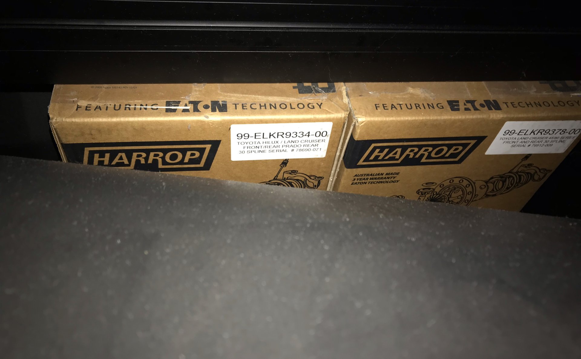

Those look new in the box

As to the photo, they are new in the box. ("Do you run them or even ever had them." was the original question.) After researching and riding in rigs that use them, I put my money where my mouth is. :)

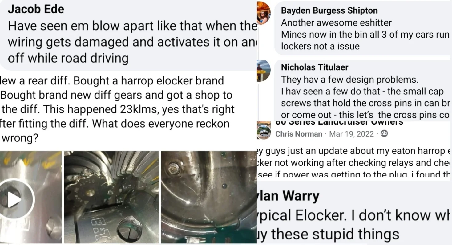

(Recent FB comments on Eaton/Harrop e-lockers)

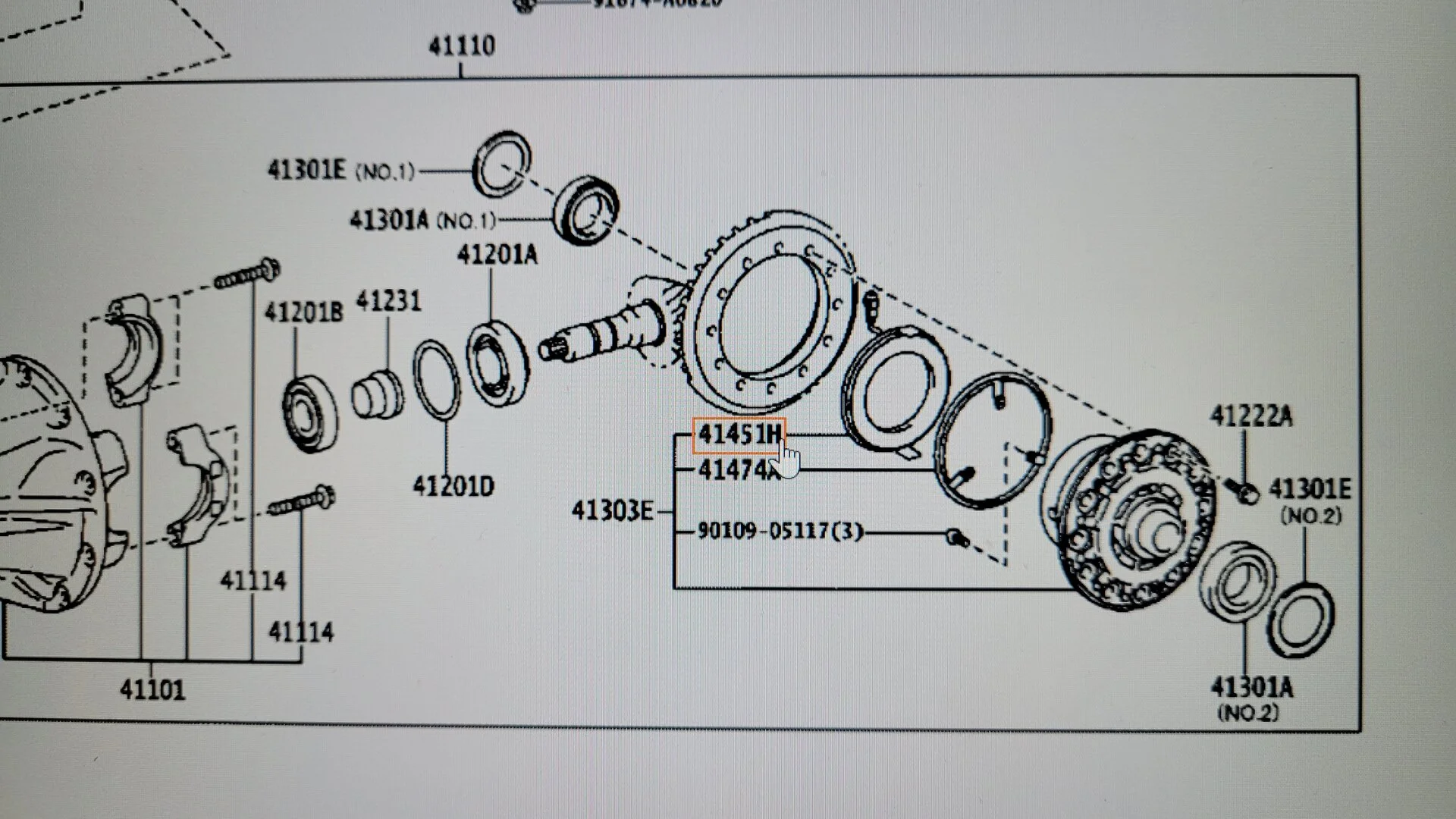

Now, for the OEM cable/e-locker. It has its own issues undoubtedly, particularly the 9.5" variant used on the 6x/7x/8x full-float and other semi-float/IFS/IRS applications. The issue is more related to the axle shaft failing and/or twisted splines between the locker's lock sleeve and the side great, making the repair very difficult and can require cutting a hole in the axle housing to resolve. This has been documented on Mud by myself and others over the years.
(This is where the 9.5" locker struggles for some)
