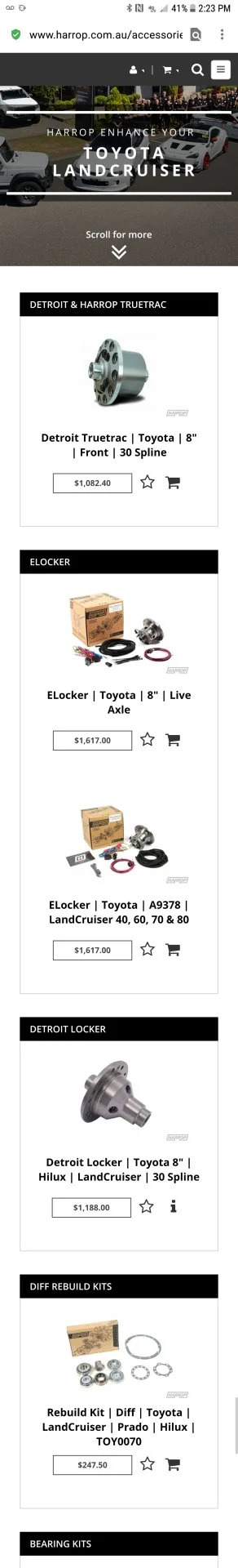

What model I buy for my 93 stock stock fzj
Pls see picture
Thanks

Dunno the model, but I'd go with Harrops Eaton; nothing better.
EDIT: See later photo for models that fit 1995 FZJ.
