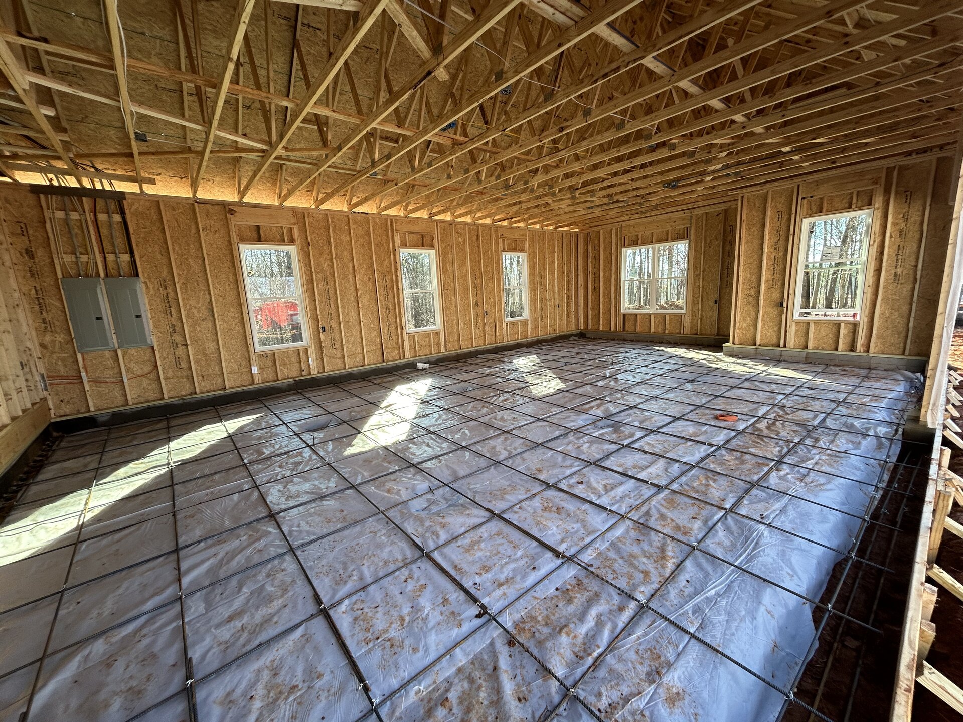

Nice! Concrete dude is starting for us tomorrow in fact. Dig it!
Rock’n’roll! Post up pics so that we can see it. Very happy for you.

Not sure why I made the decision just today, but we dug for piers, too.
Also insulated the house today. Garage will get insulated shortly.

For those of you (spazzy and Old Nick) getting concrete work done, just some unsolicited advice:
-Add a dead man anchor before the pour.
Makes moving non-running vehicles easier. I had to drill anchors into existing, which is limited to the strength of the concrete.
Drilled and installed today.
I wish I could have gotten some anchor pots or something else with a cover that would be flush with the floor, but these will have to do.
Mounted a total of 6 along the back wall of my garage- went overkill for safety. I have a very gently sloped driveway. Can use a come-along and 3" straps to drag a roller into the garage (or a winch and pulley). Will add two more anchors on each side of the garage door too.
Makes moving non-running vehicles easier. I had to drill anchors into existing, which is limited to the strength of the concrete.View attachment 3519991
Absolutely, man. Thank you. Yes, that's on my list. Planning on getting a puller (for body work and for chit I break around the farm). And, having those to move trucks around when needed will be great.
Female threaded anchors with matching hex set screws for plugs when not in use are a good flush option without going to full-blown anchor pots.
That is a very good idea. I’ve got pots on order and am hoping that they show before the pour (which is supposed to be Tuesday if it dried up… but it hasn’t). Maybe I’ll get lucky. If not, the anchor system you noted is the way I am going. The pots can be drilled out later.

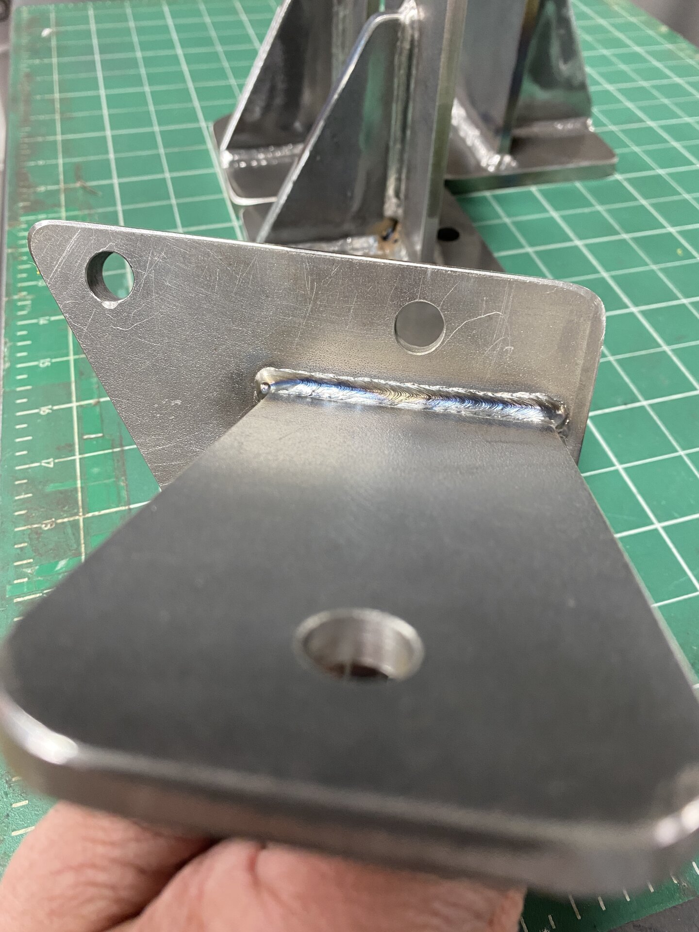

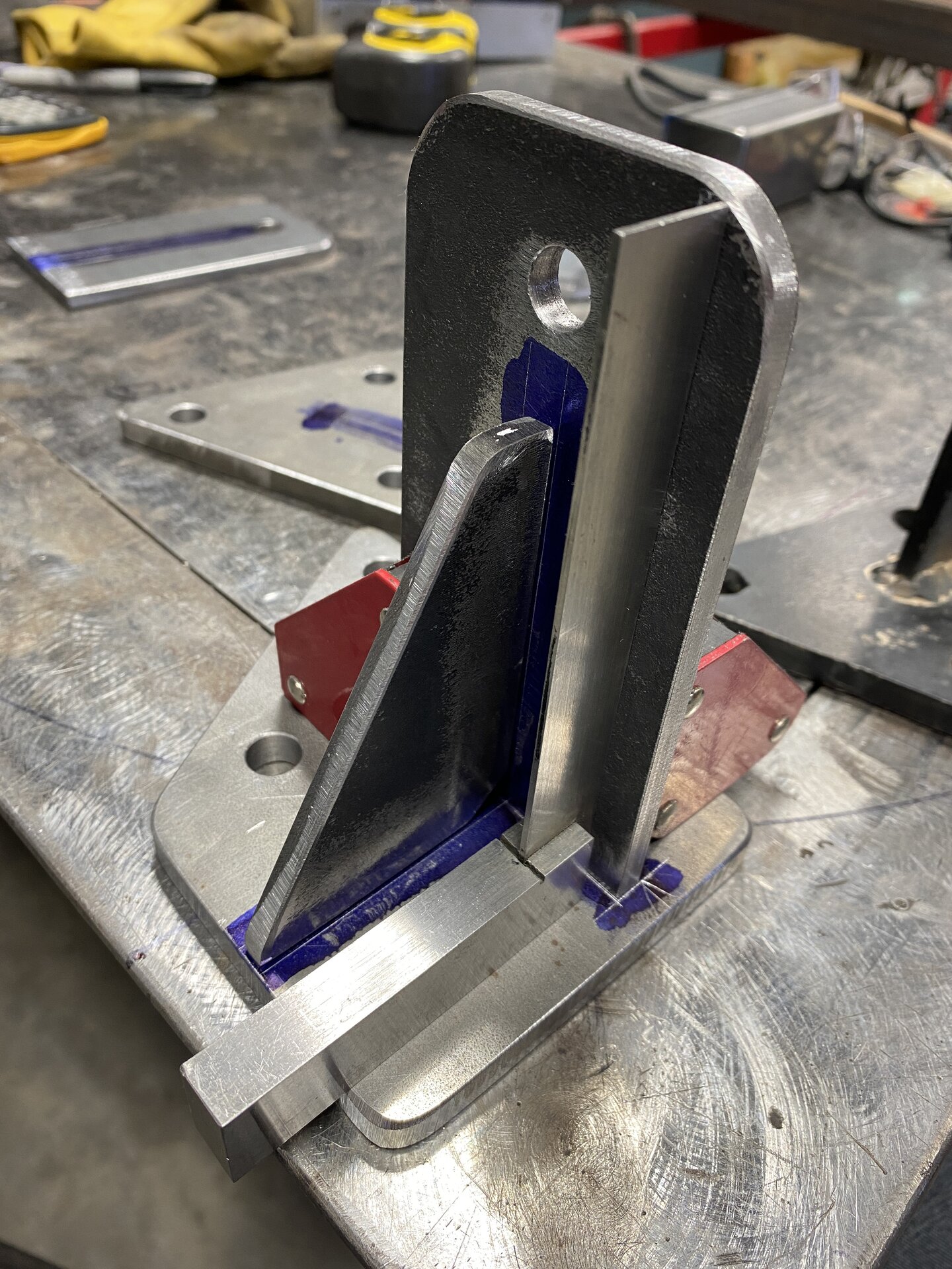

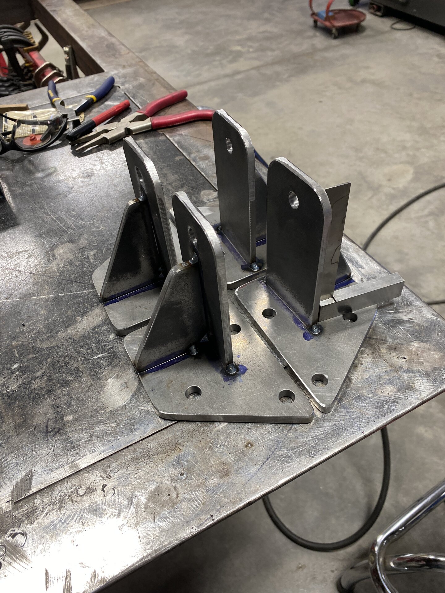

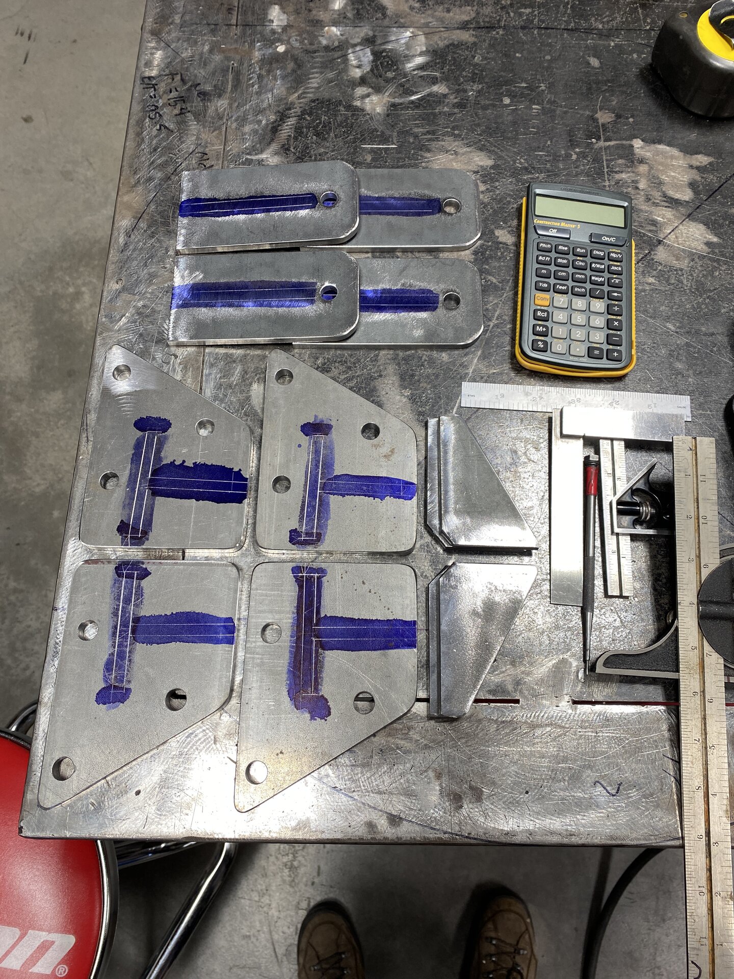

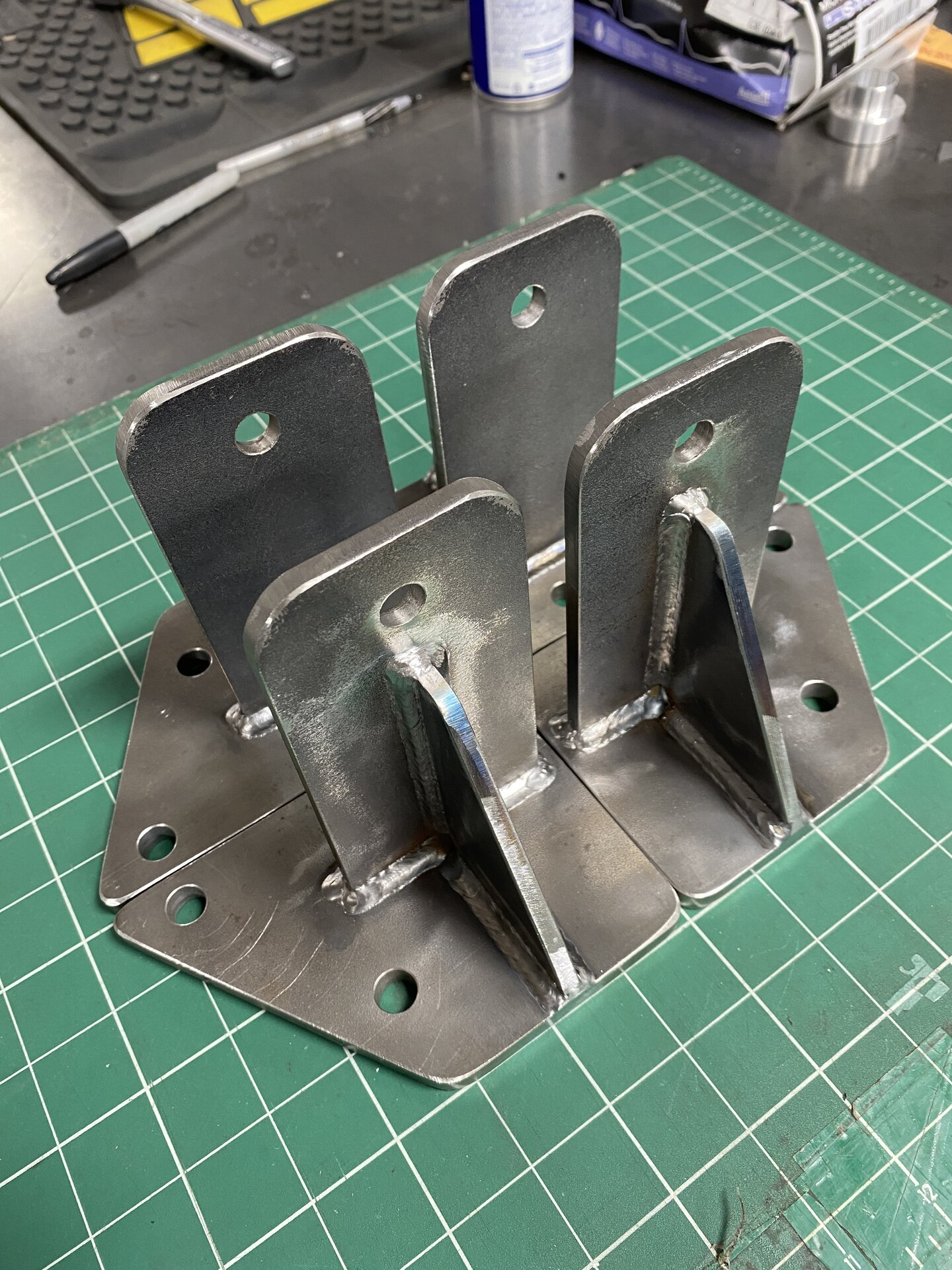

Fabricated two pairs of engine mounts for late 40's panel wagon and four door coup.
The engine tab is slopped 3.5º (right/left).
Squared up.
Tacked up.
Burned in.
Hard to see the slight slope but its there.
I have one of those calculators, super handy for framing and general layout, especially when working with feet/inches and fractions. But lately I've been doing smaller projects in metric, so much easier.
I agree, I mostly use this particular calculator for general construction such as calculating materials or grade work.
It does come in handy to double check decimal equations.

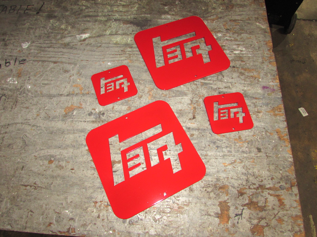

Putting together some bling for the workshop...

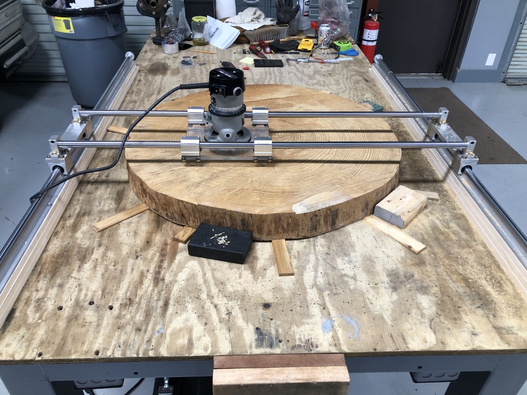

20 yrs ago someone gave me a 34" cookie from an approx 80 yr old loblolly pine. Always wanted to even it up and make a table or something out of it and came up with various designs of rigs to run a router over it. But recently stumbled across DIY router sleds on youtube and there was my answer, with linear rails from Amazon, for way cheaper than I could fab up. Gave it a brief try in the shop today and as expected given the mess, will definitely have to wait for nice day to carry whole table outside.

Very cool set-up and a gorgeous piece of wood. That's going to make a lovely table.

We'll see. Loblolly pine isn't typically thought of as furniture quality wood. It's well aged and hasn't split but I'm worried as it gets thinner that might become an issue. Assuming I can get it close to flat/parallel, will probably get some kind of oil treatment.
