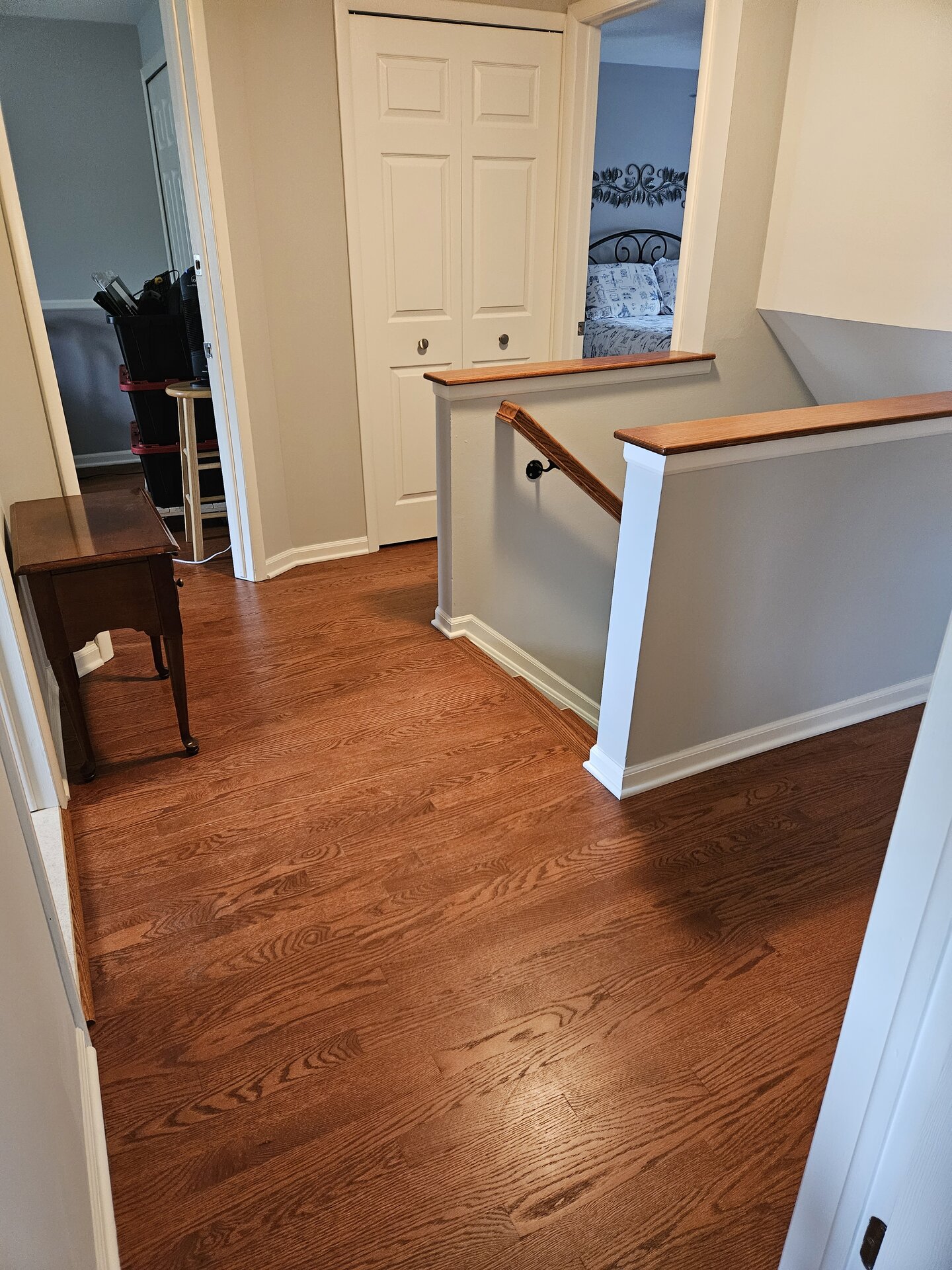

Also re-did/organized my office:
I had a flooring company do the 3/4" oak floor. It's stained in 'gunstock' with multiple coats of polyurethane. They also did the stair treads and risers. I did all the baseboard/shoe moulding (over 600'), along with some detail trim around the staircase. Another company came in an did the handrail, new balusters/newell post, and all the paint work.
After two months of sleeping on couches and/or chairs, I finally got back on a bed.

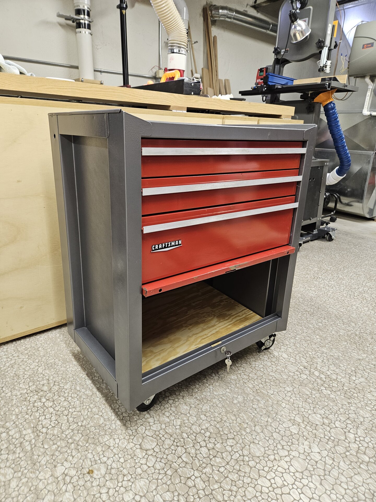

Finally got around to cosmetically restoring the 3 drawer + bay tool box I had picked up on MarketPlace a while back:
I tried selling it, but no interest, so I was 'forced' to complete the resto. I had already done the drawers, and they were in pretty good condition, so I didn't need to paint them. Which is a relief, as I hate rattle canning red paint.
The casters were also in very good condition, only needing a thorough scrub and lube. I cut a piece of 1/2" plywood for the bay area, gave it three coats of poly, and topped it off with one of the two remaining 2 drawer upper boxes.
Don't know what I'll dedicate this box for, but I'm thinking it'll either be for my plumbing 'stuff', or perhaps, all my router 'stuff'

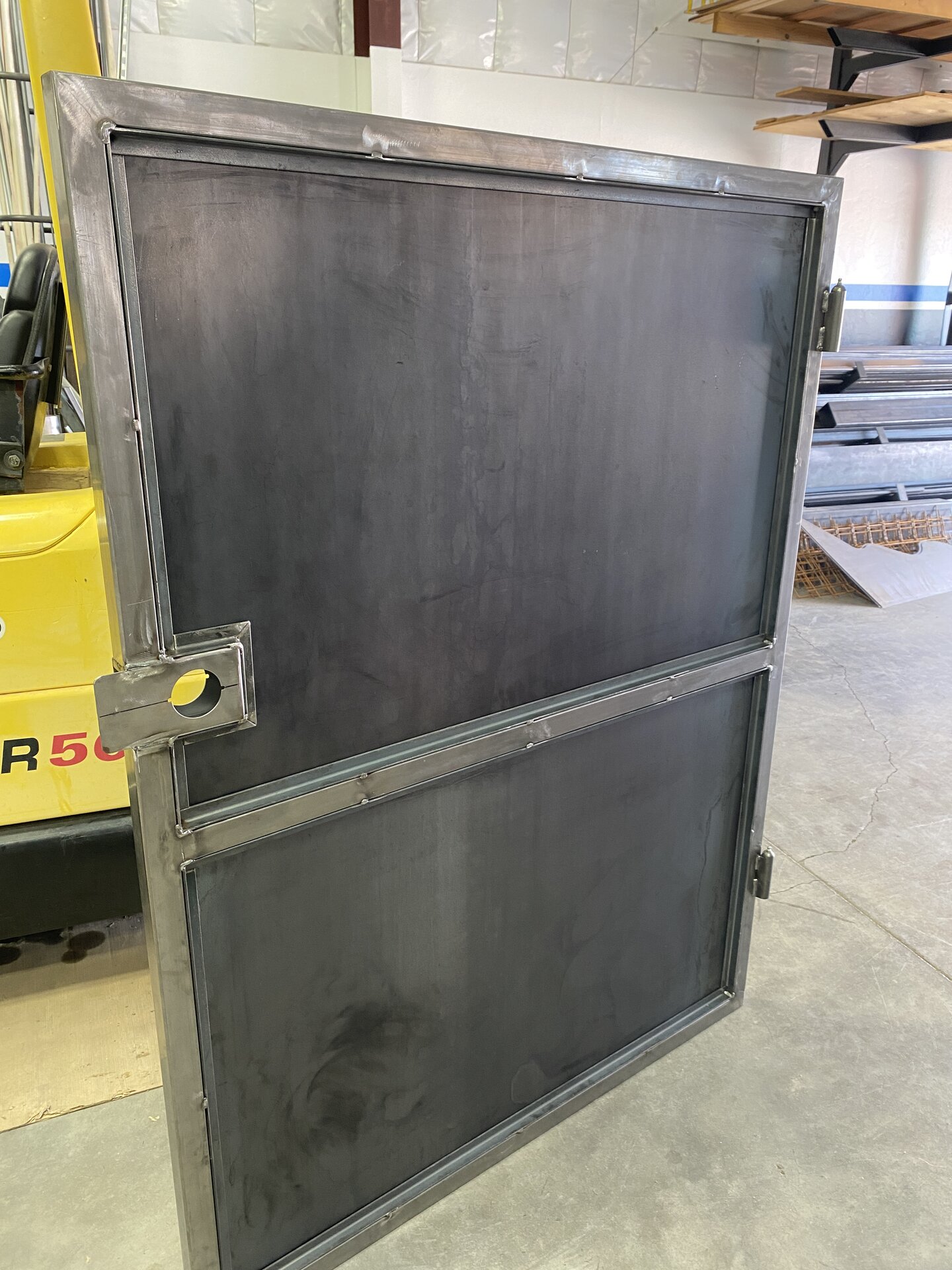

A little more than tinkering on this one, but a fun one.
Main frame is .120” x 4” x 6”
Door frame and door 14 gauge 2” x 2”
14 gauge HR plate secured with 3/4” x 3/4” angle frame both sides. Faux rivets rosette welded to 1-1/2” flat strap.

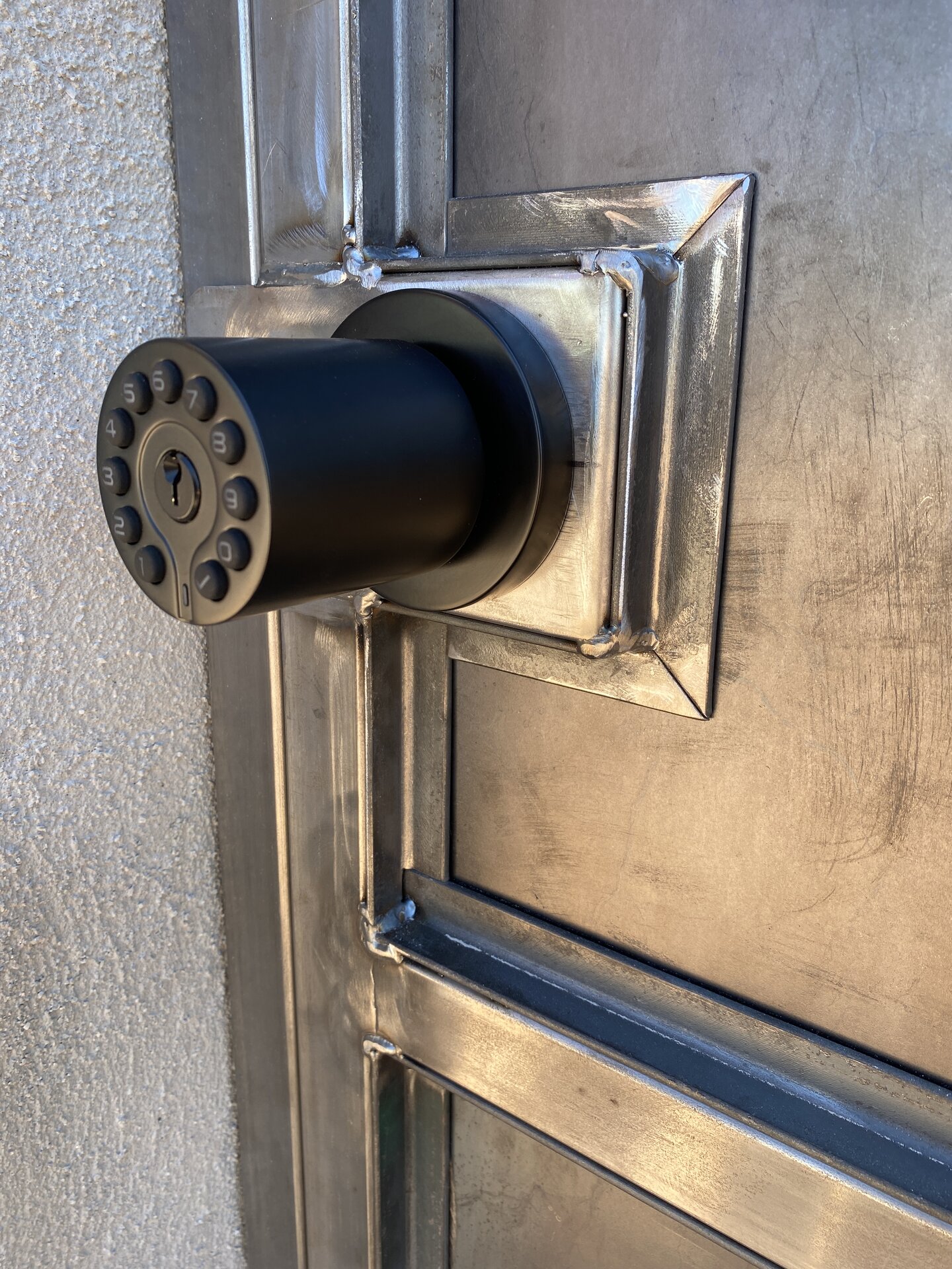

Door frame as secured to main frame using 1”x 1” angle both sides. Door knob has a keypad or key option on knob face.
The door shares the same details on the inside and has a vault feel with those 8” hinges greased. The rust patina was done using hand pump with peroxide, vinegar, and salt.

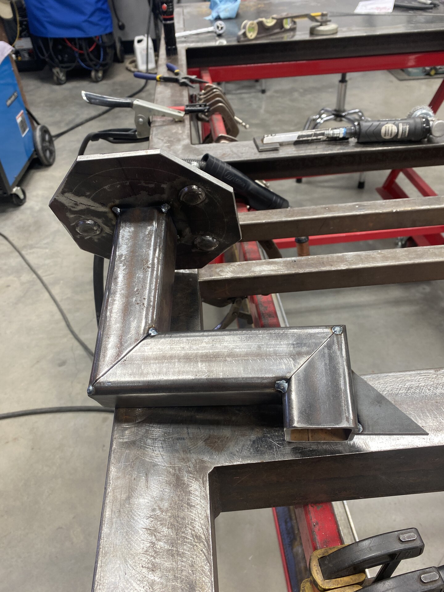

Spare tire mount for a new car hauler.
Laying out the hole pattern.
Tacked up for fitting.
I like using three studs minimum.
The new mount is primed prior to welding. The welding zone was taped off.
Welded in.
