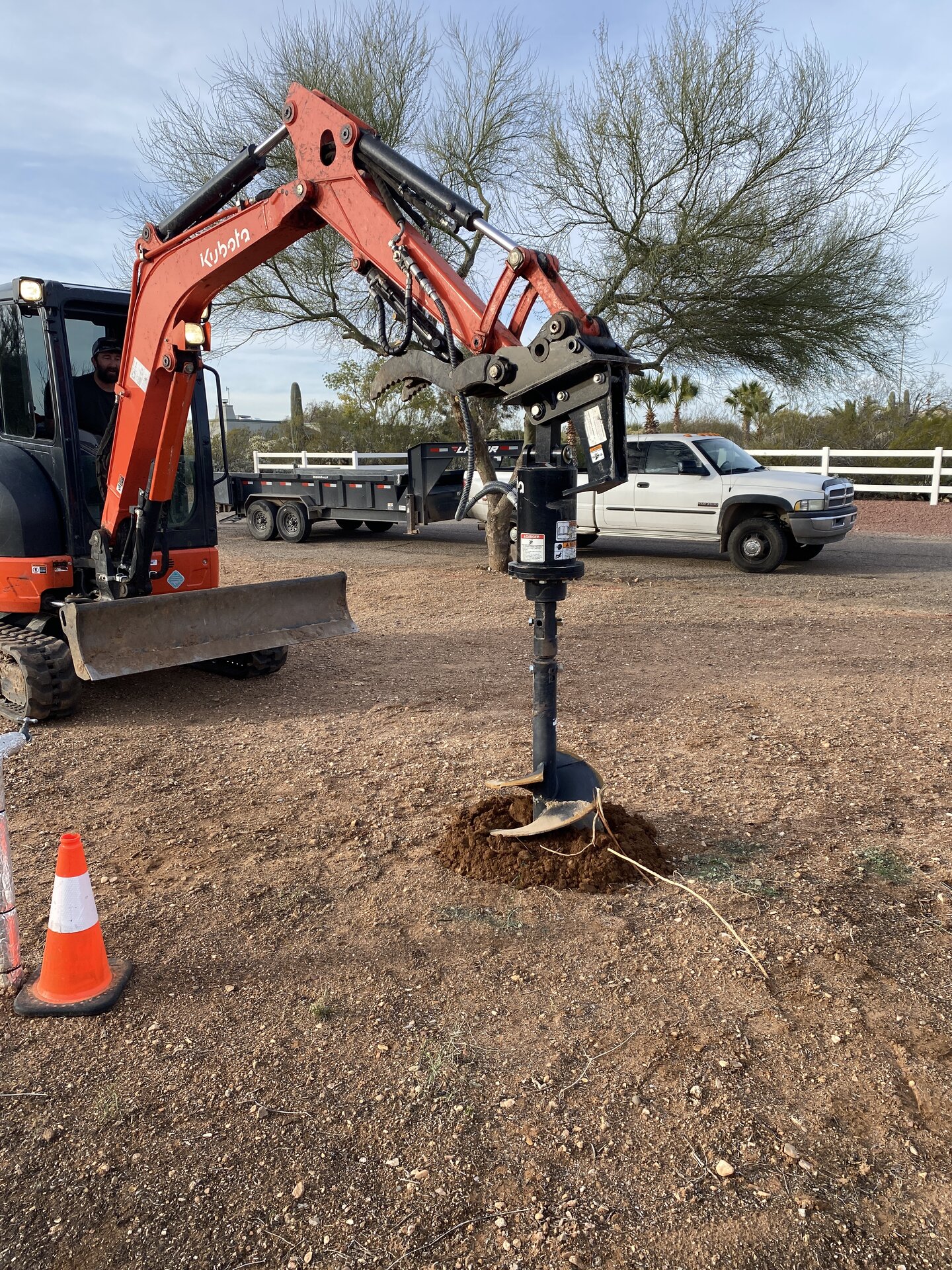

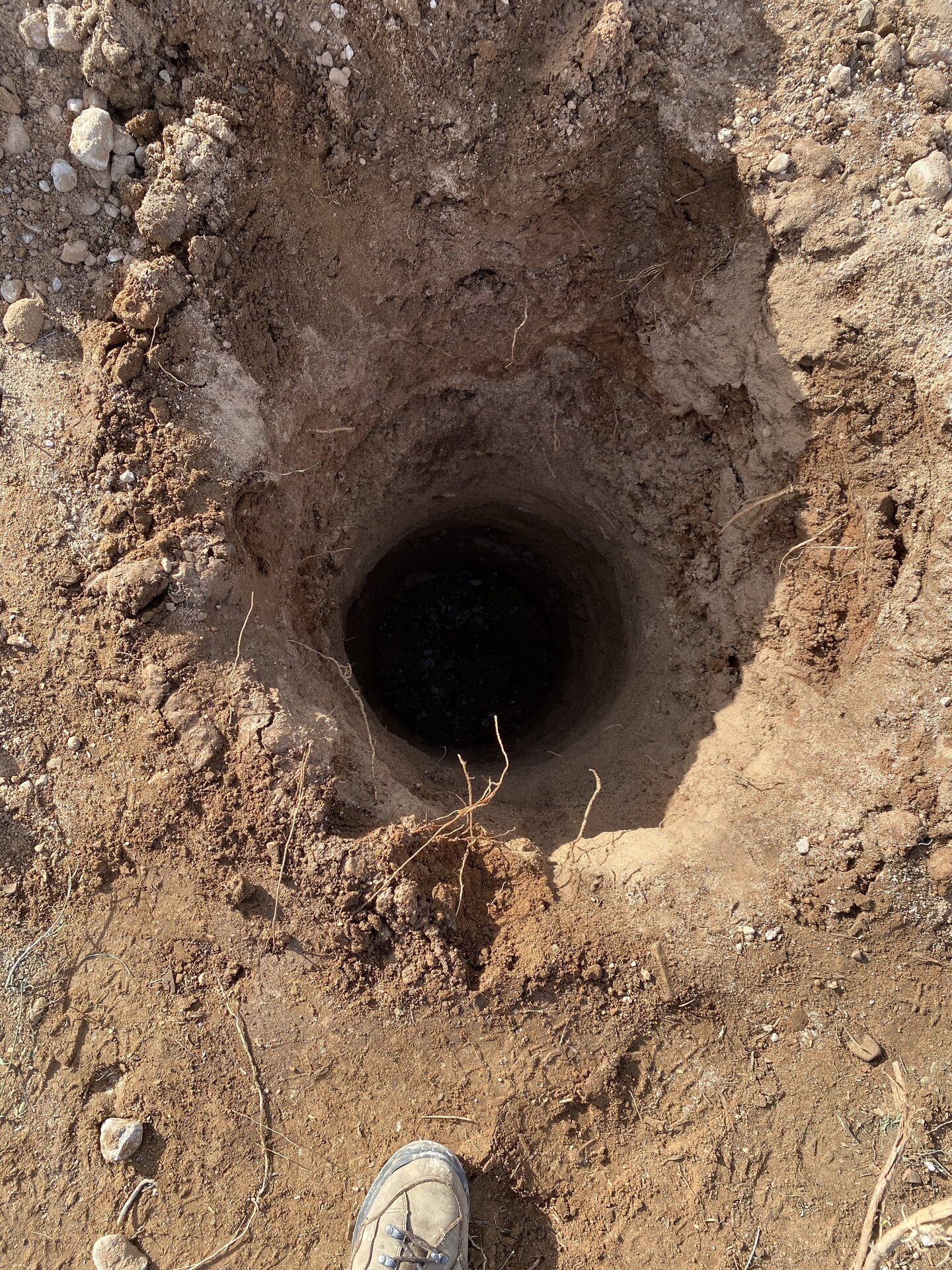

The mini excavator punched an 18" hole some 76" deep.

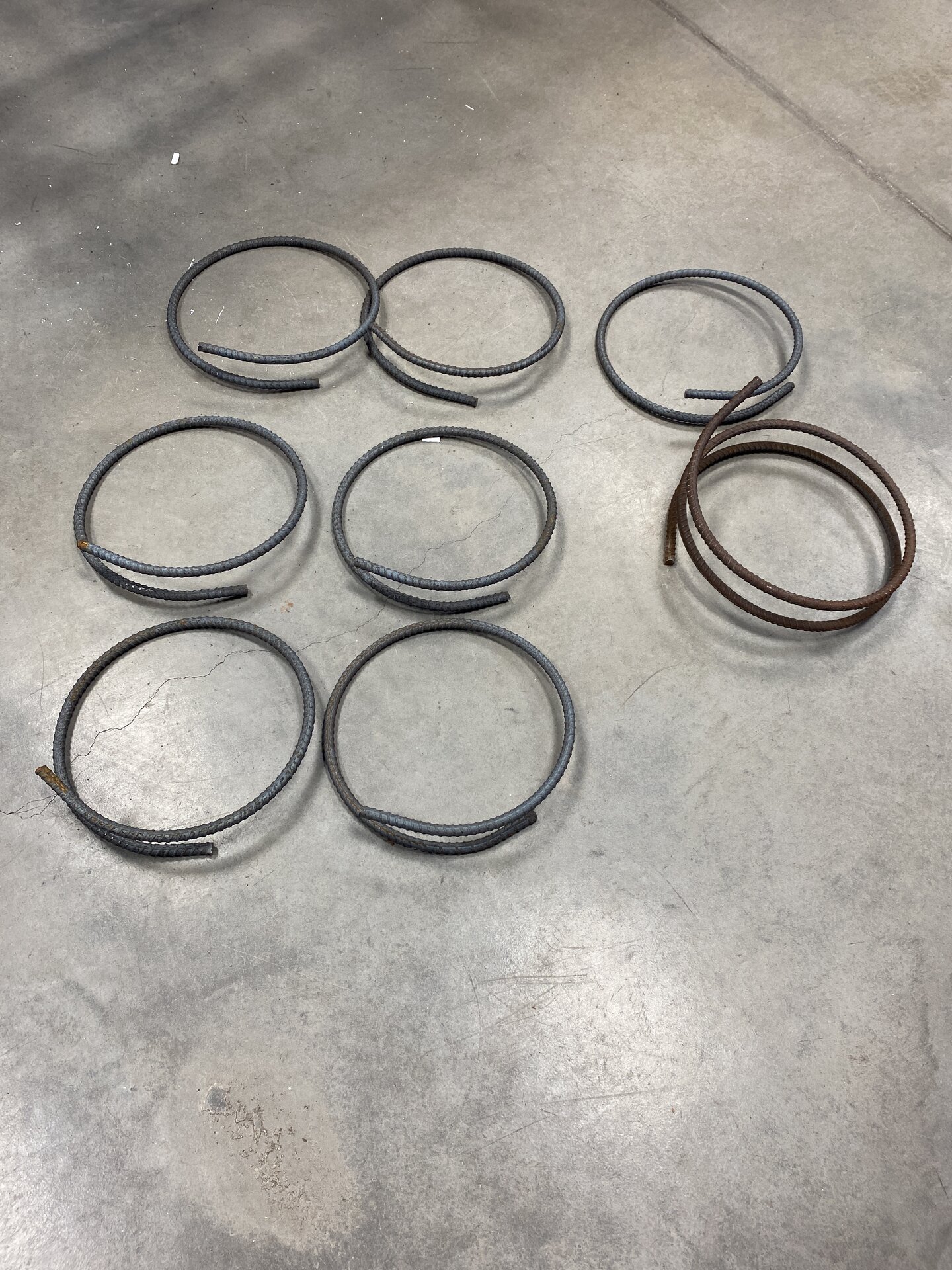

Some #4 rebar rings rolled into 12" circles.

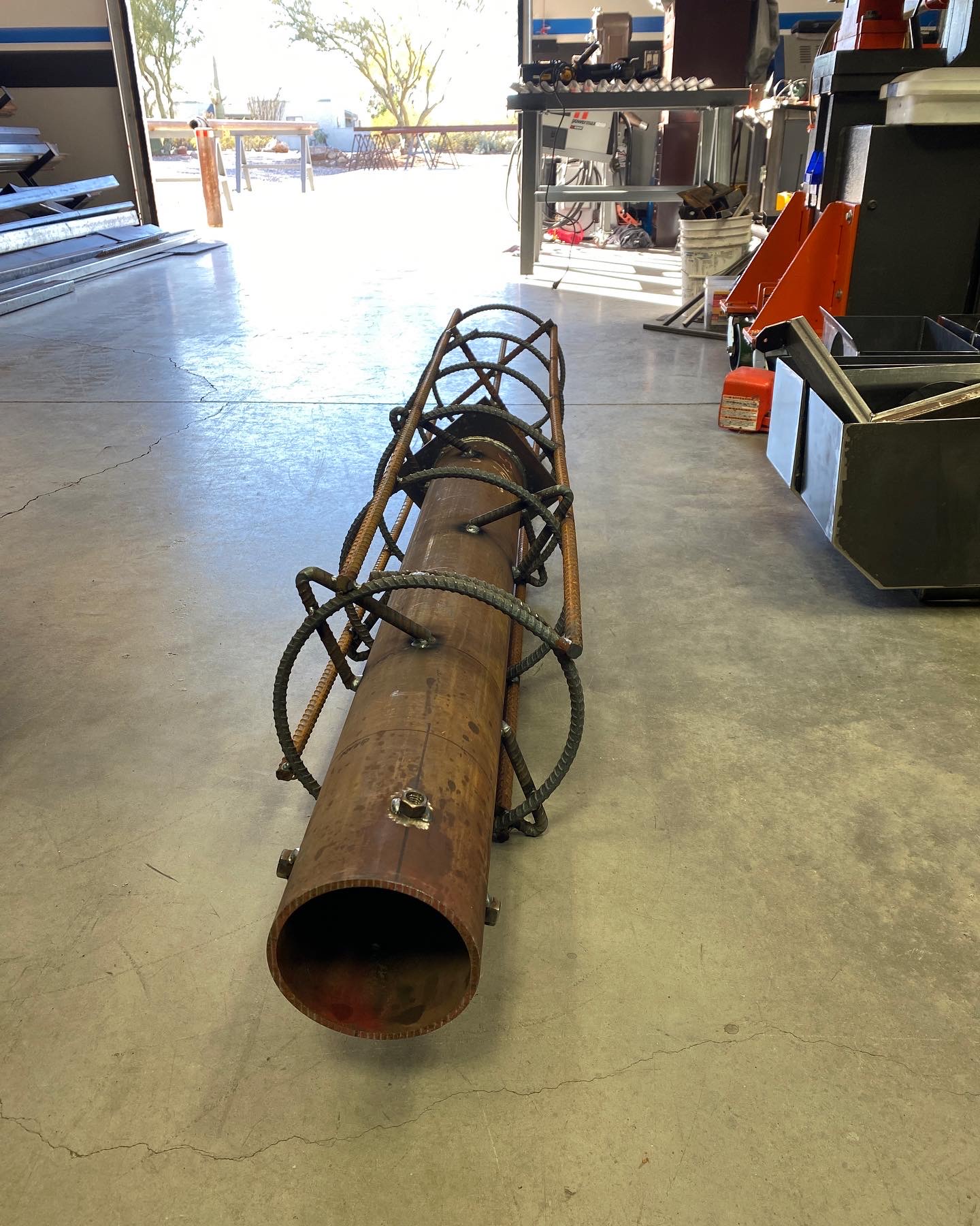

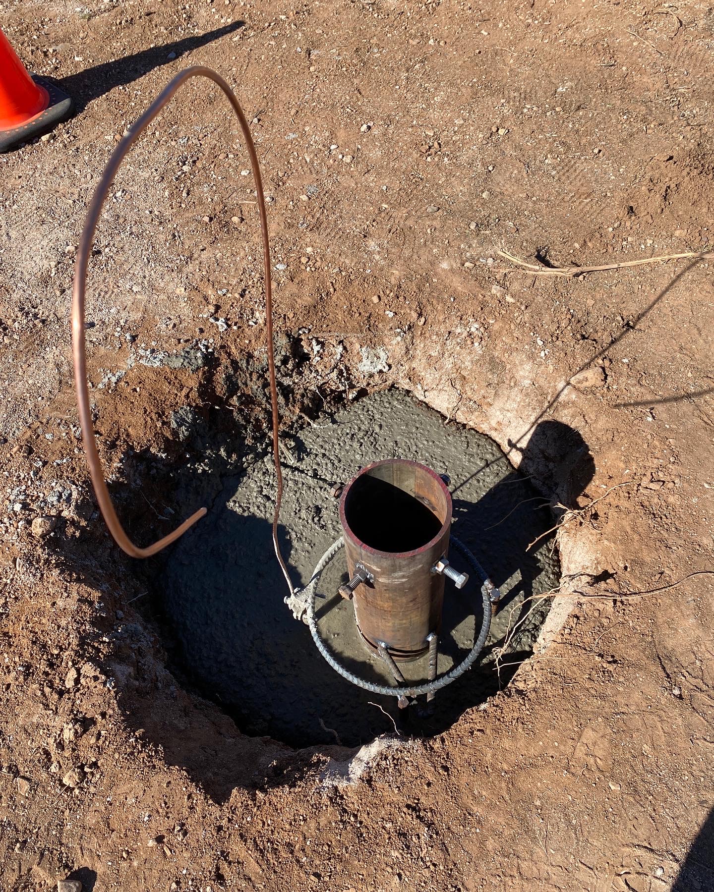

The weldment is ready to be set into the hole and filled with the initial 2500 pounds of high strength concrete. The top nuts welded to the open end are for jacking bolts for later plumbing of the receiver, the other end self centers over the cone.

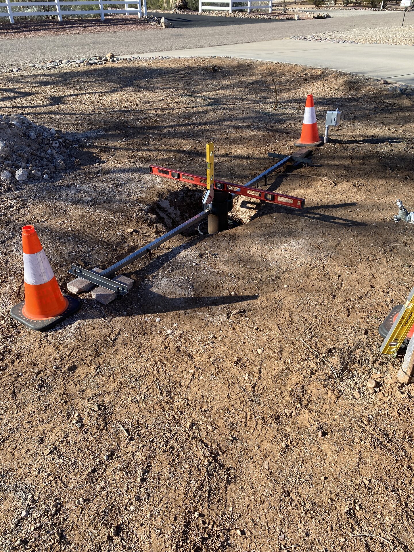

The jig I came up with to plumb the weldment in prior to pouring.
The same jacking bolts are use in reverse to fine tune level in all directions.
A UFERS clamp was used on the rebar cage and a section of solid copper #6 will be clamped to a 8' ground rod.

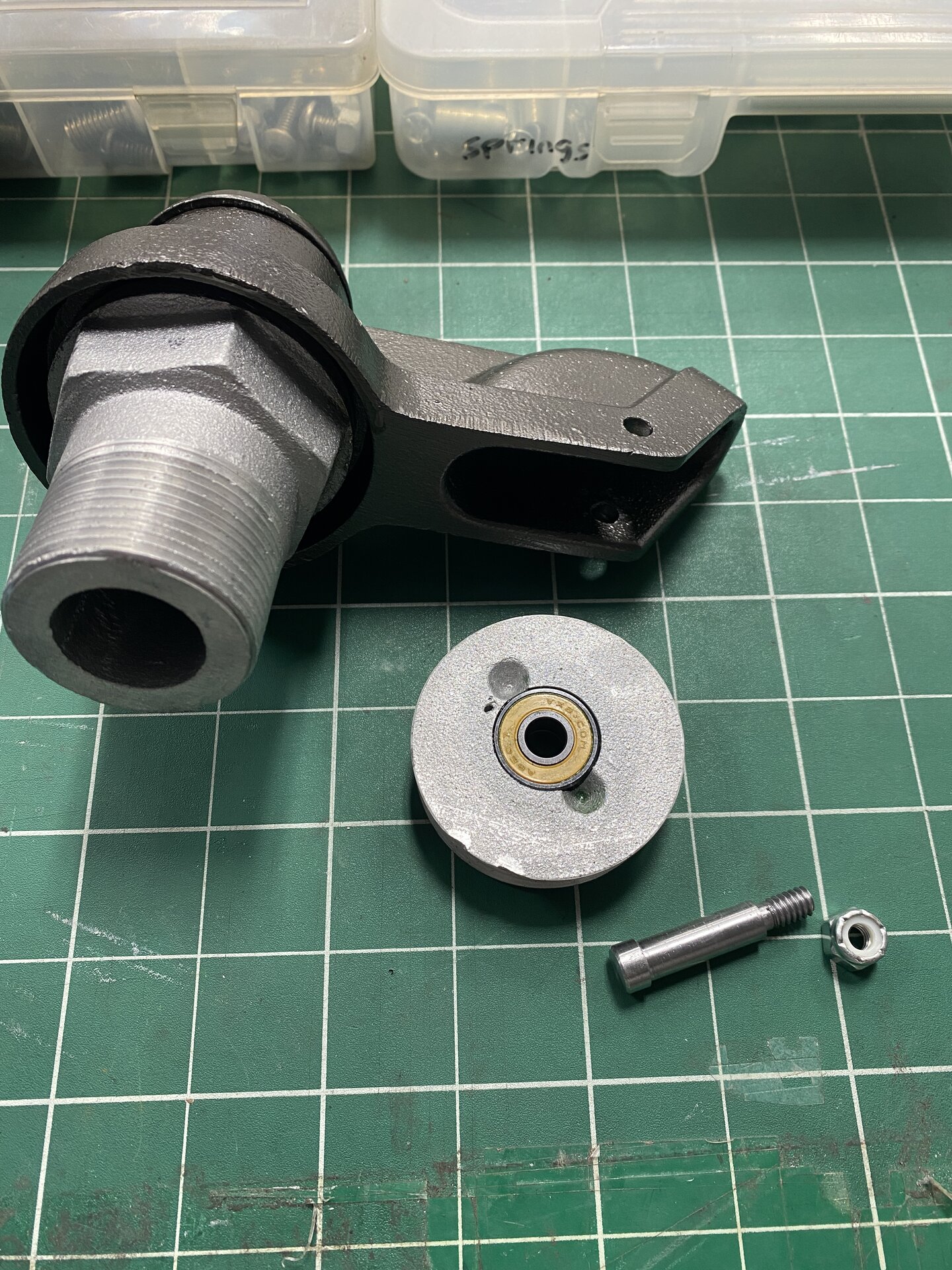

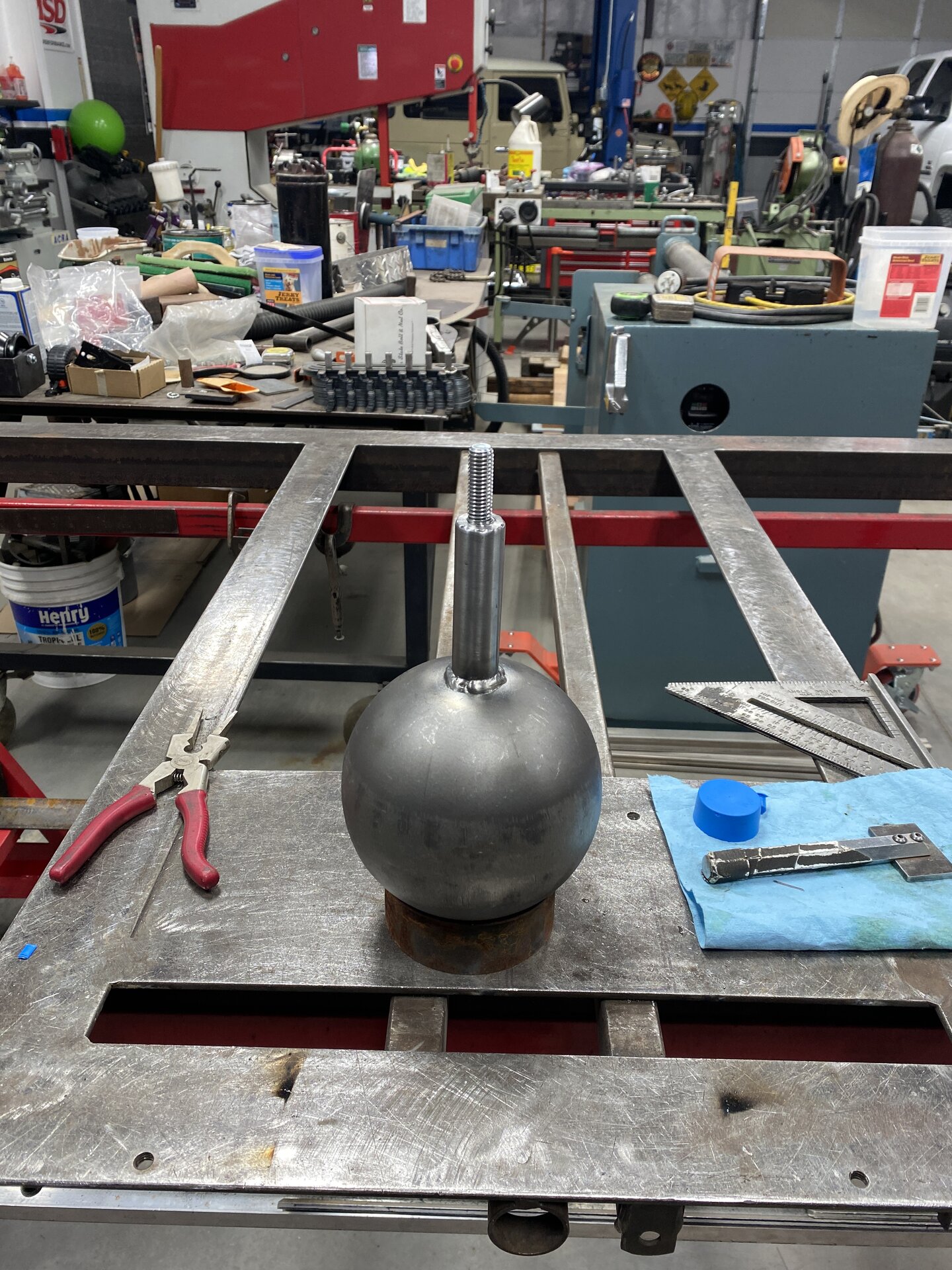

While this was curing, I started designing the fenial. I machined the pulley and installed a ceramic bearing and a 360º swivel truck. The Ball is a 6" diameter and threads into the top of the truck.
The ball.

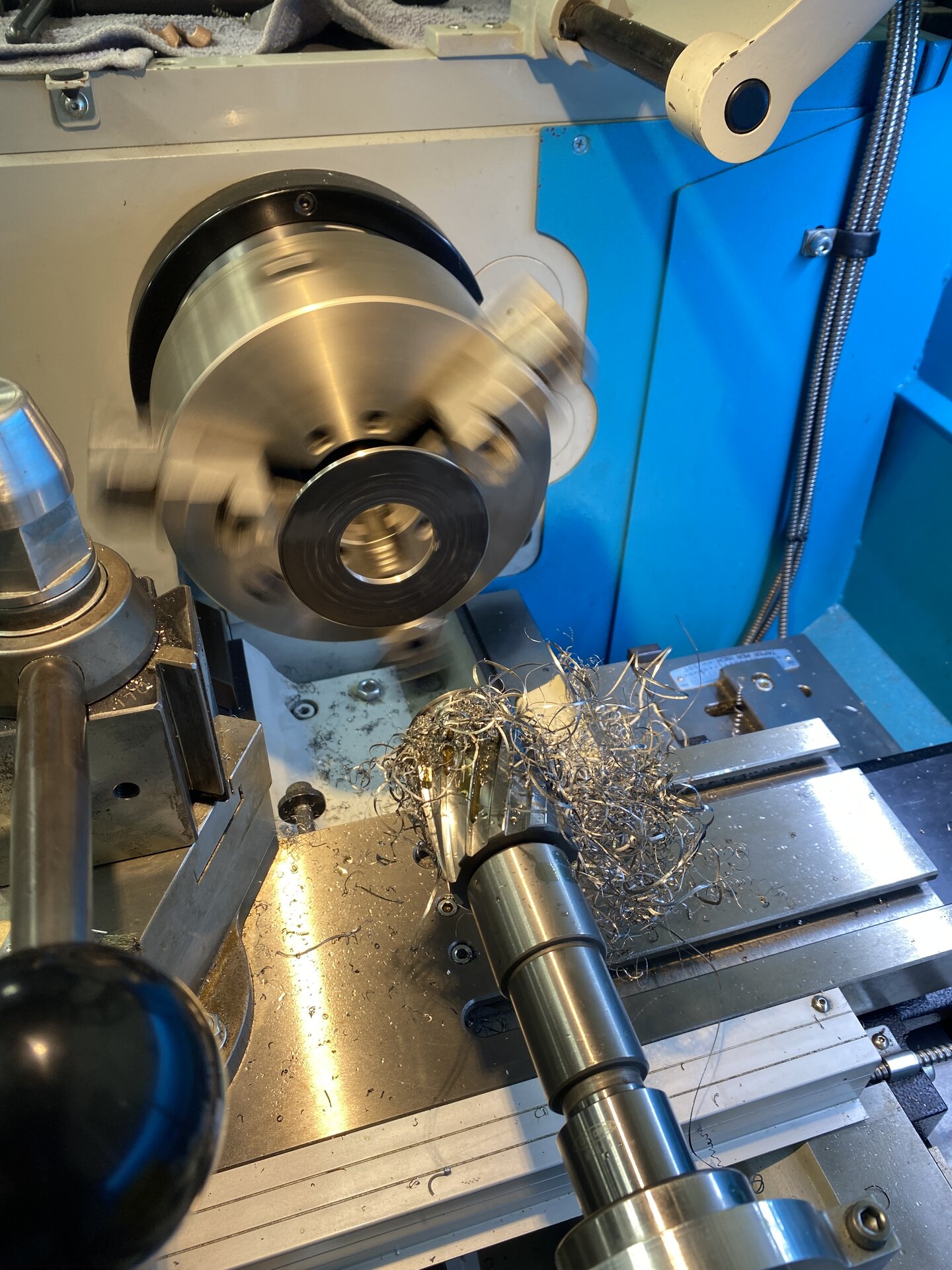

Bored out a cap that will have a nipple welded in to secure the threaded swivel truck.
A couple of light passes with a boring bar and the nipple slips in.
The truck with a new ceramic bearing and a new SS axel was also turned and threaded.

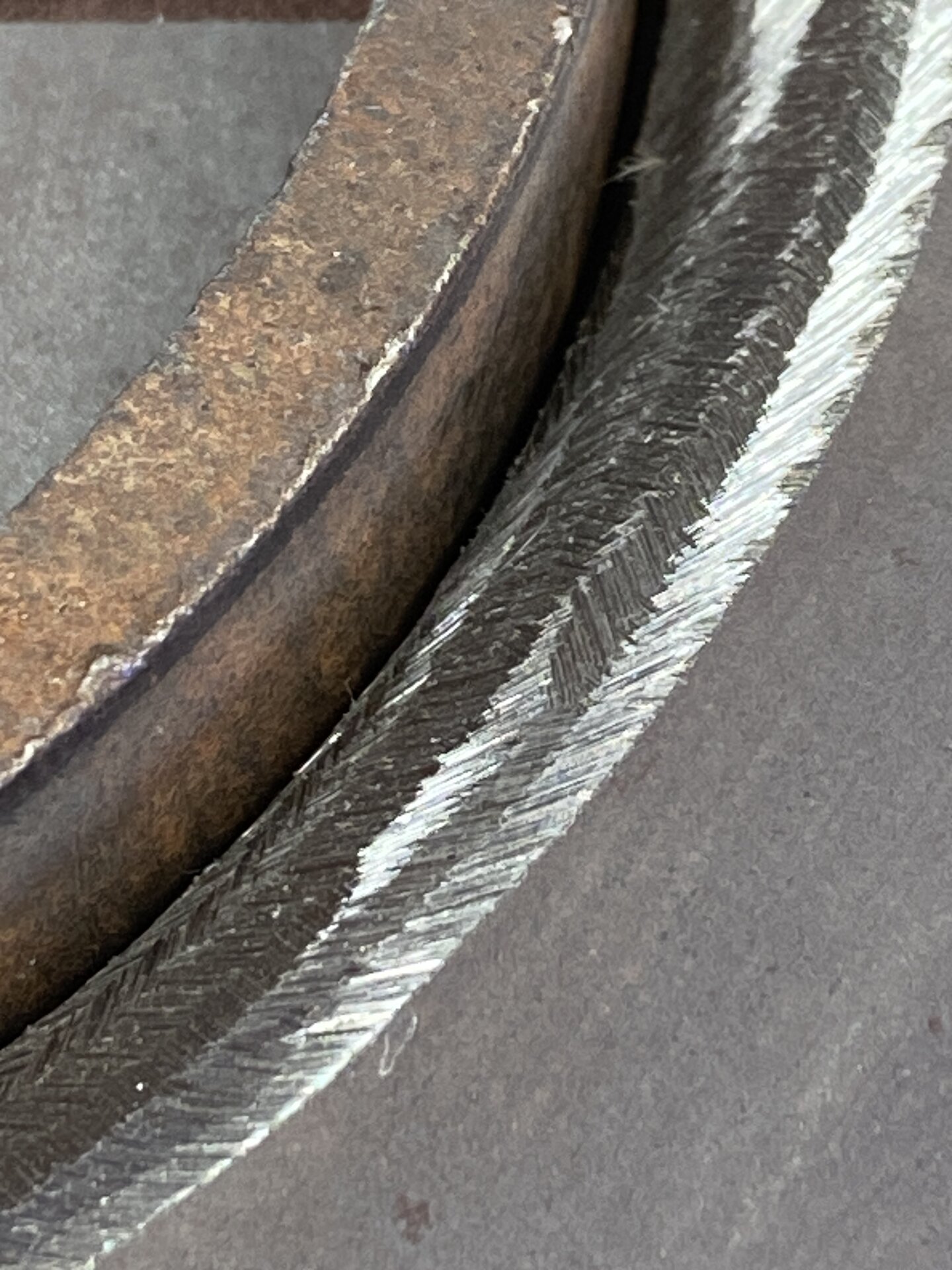

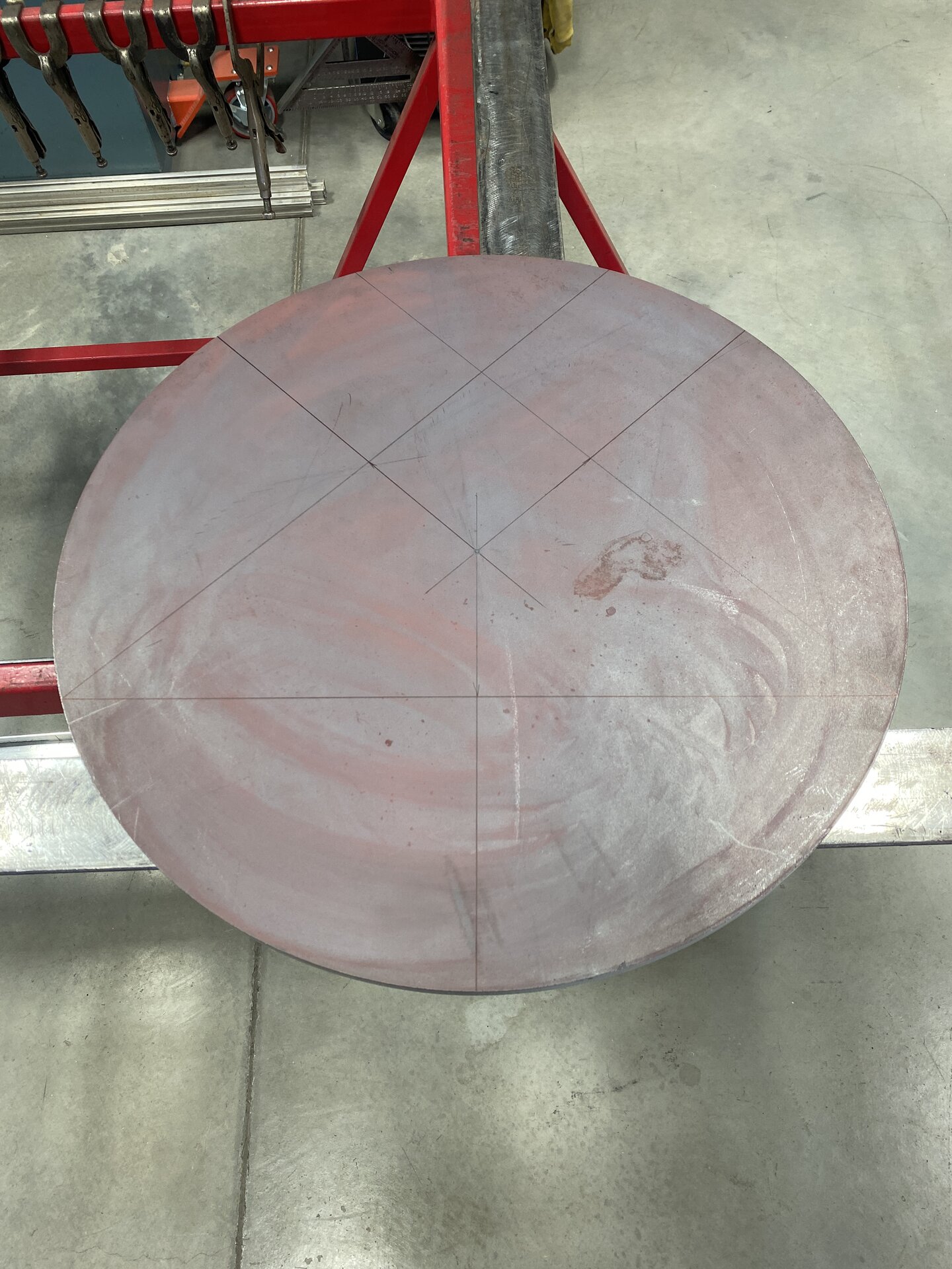

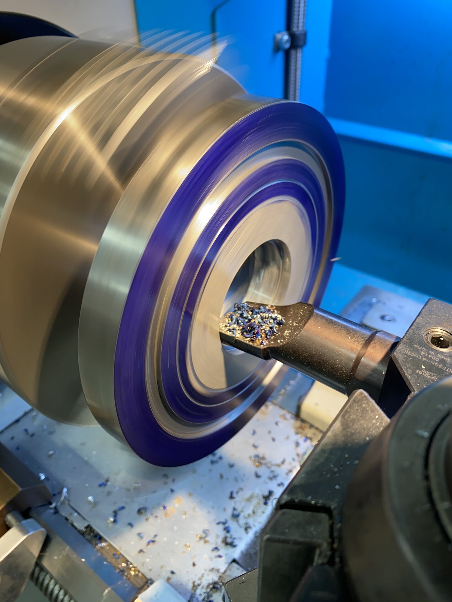

Next up was machining a 7" disc of 3/4" CR. This will be the adaptor for the top of the receiver sleeve. The outer groove will index over the pipe already set in mud. The adaptor will be welded to the larger pipe in concrete (underside) while the ID will accommodate the OD of the sleeve. Welded and then more mud.
I had to hand grind a trepanning cutter for that indexing groove.
Almost there. The foil is a trick to keep the boring swarf from packing in to the four jaw scroll/indipendant chuck.

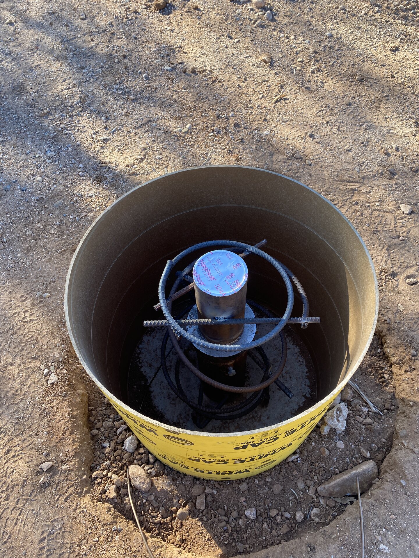

The Adaptor fit really nicely onto the lower section and was burned in. The sleeve was cut and lowered into the adaptor and self centered into the base. A 12" #4 rebar was also welded to this new section. A 24" sono tube was also set in and plumbed. Another 750 pounds of mud added to finish the pier.

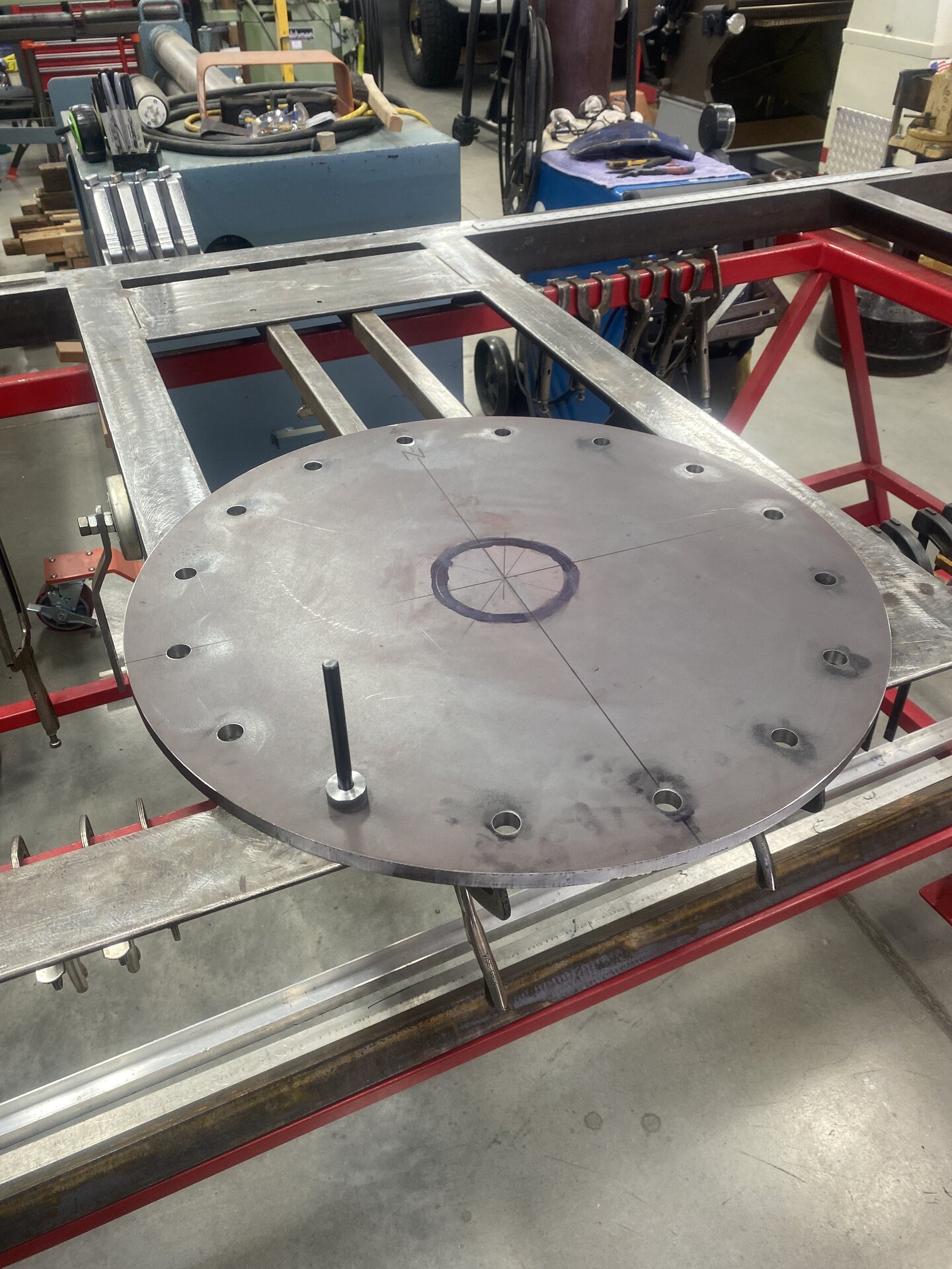

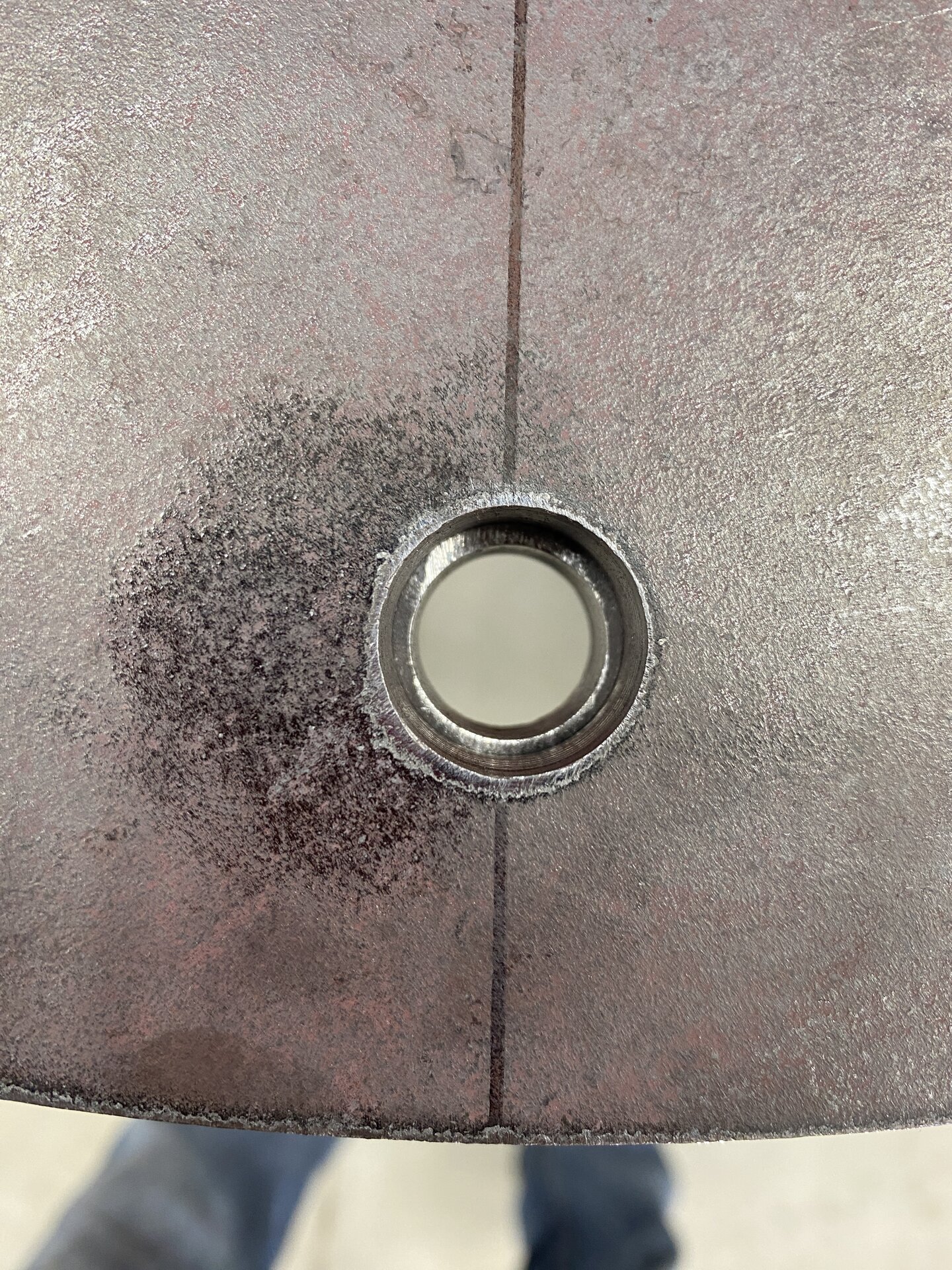

Cut the flanges on the plasma table and laid out the hole pattern on the base flange. This will take 16- 3/4" bolts.
Finding the center.
Some math I used back in HS machine shop for flange hole layout. Machine shop guide book I purchased in 1978 for advanced machine shop class was used to jog the cob webs in my head.
11/16" annular cutter provided the correct hole to tap a 3/4-16 thread.
I made a transfer punch bushing to allow for accurate transfer pushing of the second plate prior to tapping the 11/16" hole. A knurl was added to help grip the snug fitting bushing.
After transferring the holes, the lower flange was tapped on the mill to aid in aligning the tap. I ended up power tapping all the holes on the mill using a bolster plate as a platform.
The bushing worked well.
After transferring the punch locations a 13/16" annular cutter was used on the top flange.
Tapping the lower flange went well.
A clear shot of the threaded hole along with the top flange.

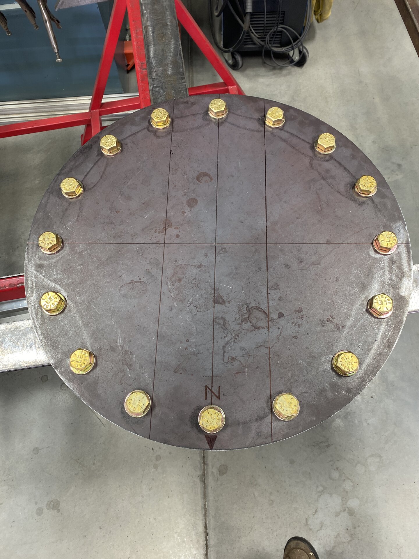

All 16 bolts fit with clearance. The North indexing on the top flange will allow me to weld the two 8" channel in the correct location so that the flag pole will pivot true south.

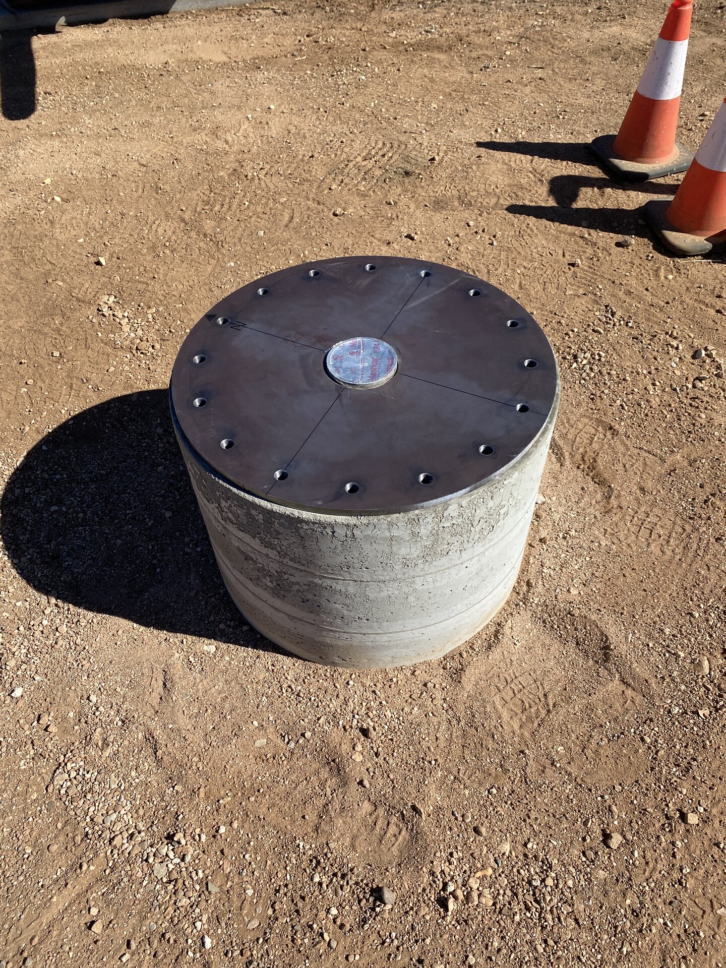

The flange looks pretty cool sitting on the pier. The top flange will remain blank and will seal off the opening. I'll probably use some silicone to keep water out when it gets torqued. I will weld the lower flange after I compleat the heavy welding on the top flange. Bolting them together will help reduce any warping from welding in the pair of 8" channel that will support the fulcrum point. Now it should be clear why the North lines are important.
The flange sit level in all directions.

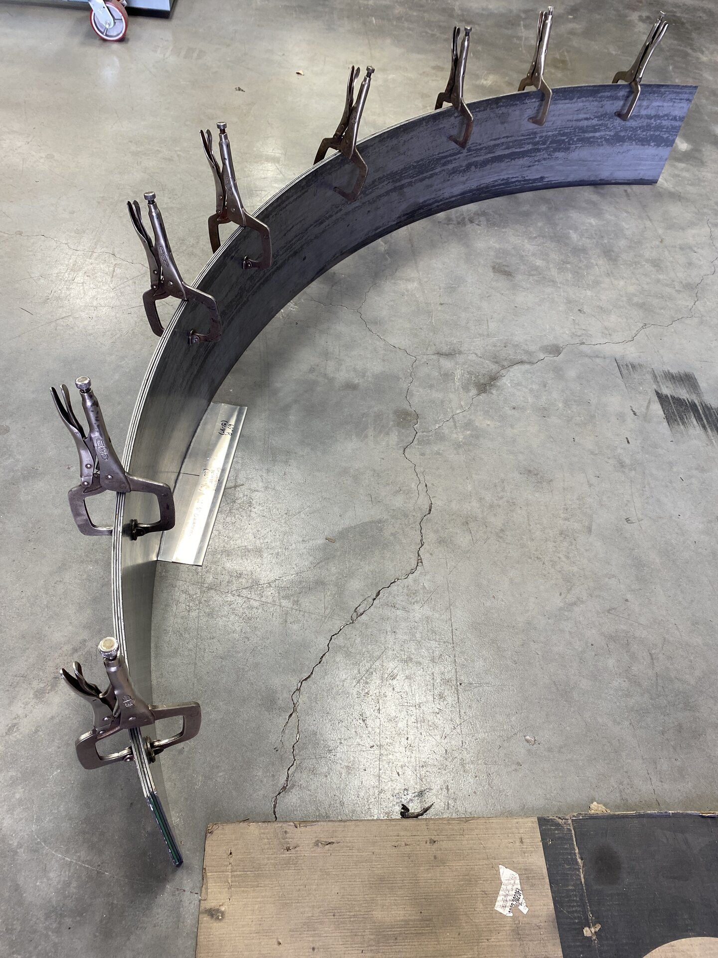

Here you can see the precut sections of the 12" flat strap, the connection clips made from 1" angle iron. The female side to the connectors have 5/16-18 qcarure nuts welded in. The rolling template was also folded over on the break to enhance rigidness.

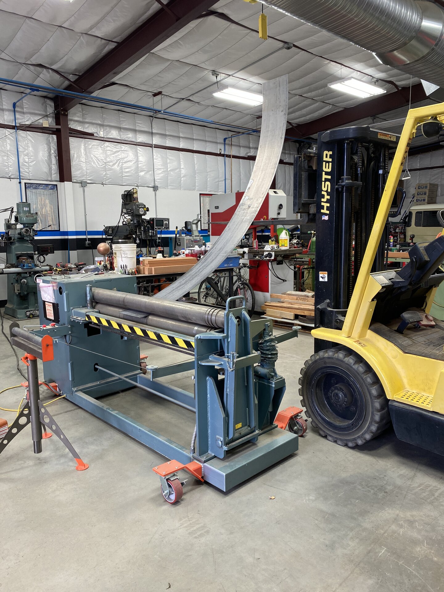

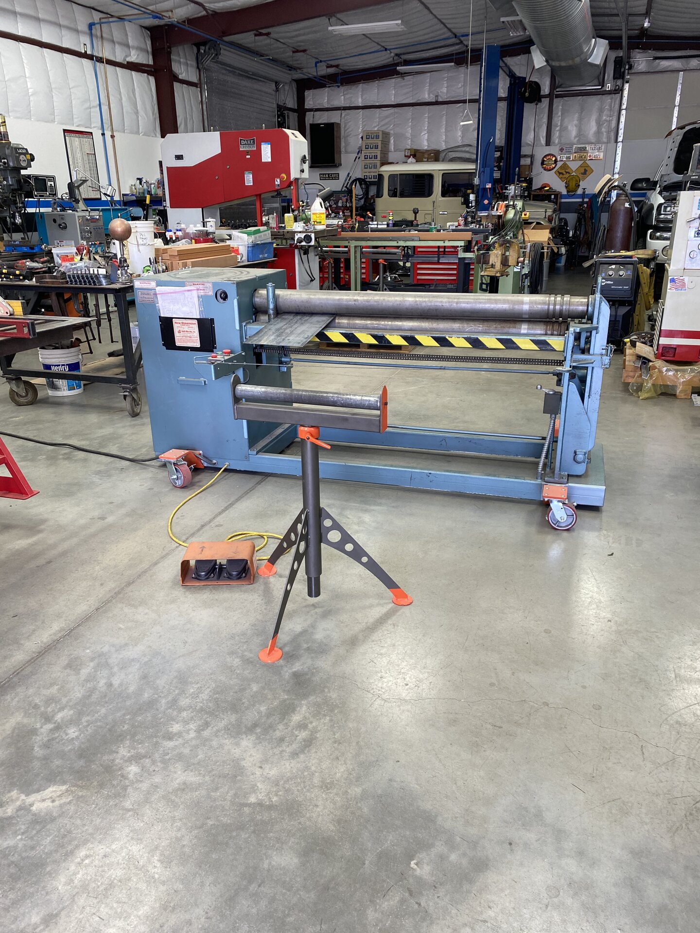

The rolling setup.
Achieving the radius with the help of the template.
The fork lift saved my hide again. I really believe I would have hung up all shop work by now if I didn't have this machine.
They're a match.
The connectors also performed as intended.
The ring came out nice.

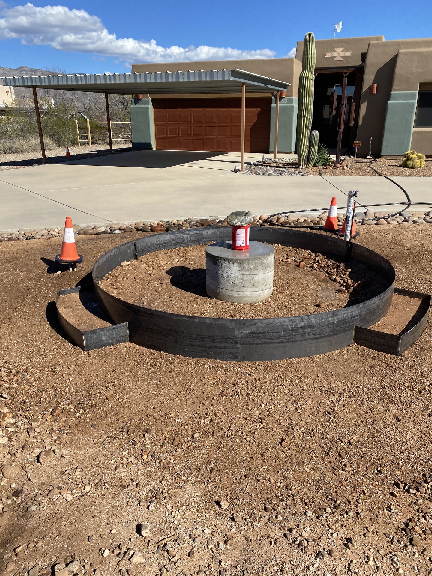

Break it down and move it out to the site.

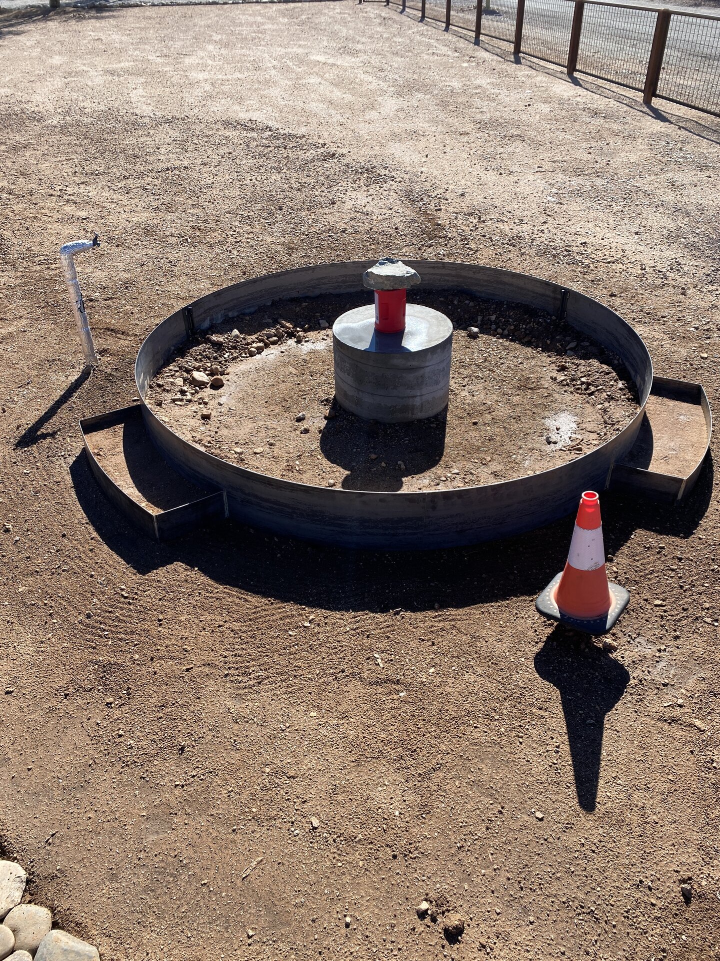

Leveling the ring wasn't too bad and it will elevate the pedestal 12" leaving the top of the concrete proud about 4".
Three 36"L x 12"H x 6" H steps were added 120º. the steps were also rolled to match the profile.
Back filled with rocky dirt then topped off with three inches of 3/4 - 1" coranado brown gravel will finish this off.
The water riser will be extended and secured to the side of the ring. The riser will also be lowered some and the spigot rotated away from the ring.
