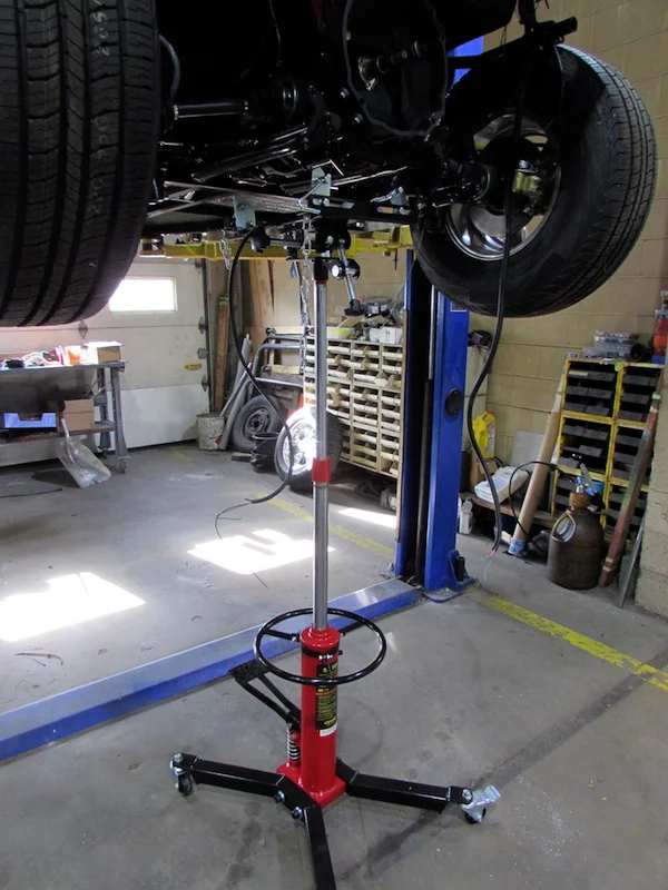

So I picked up this VEVOR transmission jack a few weeks back when Home Depot had them on sale for $132. As luck would have it, the local grocery store had a deal on Home Depot gift cards that week too - 10x fuel reward points. So I got a $135 gift card and got $34 off my next fillup - bringing the price down to about $100 plus tax.
Overall, for the money there wasn't too much to complain about. Yes, there are better options out there. They also start at $600 and go up from there.
The three things that I noticed in assembling it are the cradle, that the release lever is awkward - particularly if you're trying to keep a hand on balancing or maneuvering a transmission as you lower it, and the bolt holes through the legs aren't sleeved so the tubes flexed a bit and I was a bit worried about stability over time.

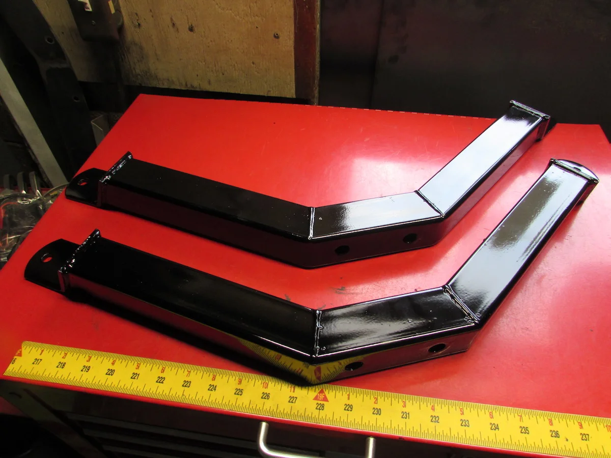

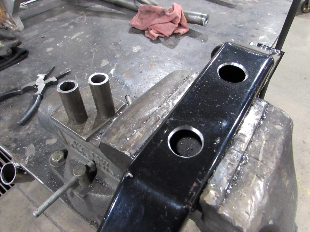

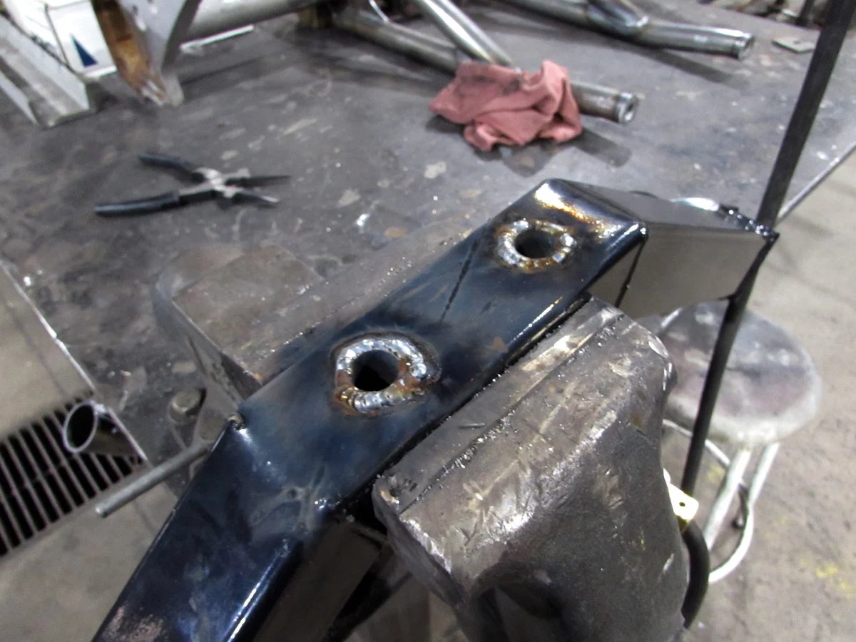

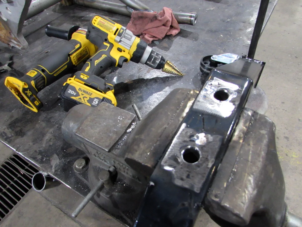

I decided to address the legs, because that was the easiest to start with. So I tore it apart, drilled out the holes, and sleeved them.
Then, because I can't leave well enough alone, I stripped the legs down and sandblasted them.
And then powder coated them before reassembling everything.
It feels a lot more secure now. I'm likely going to work on the cradle next to improve it. I'm not sure if I can do anything about the release valve to turn it into a foot pedal.

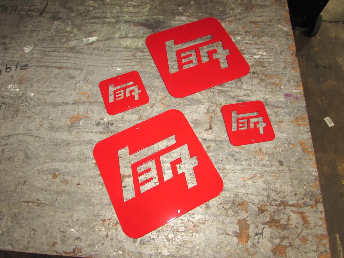

Oh, and while the powder coat oven was warmed up, I coated a couple cutouts I did on the plasma able while I was at it.

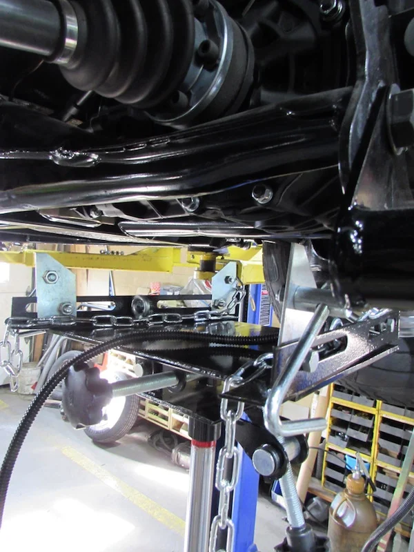

Those jacks are handy. I’ve had one for a few years and have made bolt on jigs for removing T-cases, transmissions and front axels when working alone. A must tool to compliment a two post lift.
nicely done!
that thing does look rather spindly when fully extended, though. Does it seem sturdy enough?
I haven't put anything on it yet, but extending it fully and shaking it around a bit I don't think there will be any issues. As I say, I'm likely going to make some modifications to the cradle to make it more useful.
One of the mods I did on the cradle (aside from custom jigs) was to tack weld the nuts to eliminate the need for two wrenches. It will be obvious which ones to tack.
I will also add these jacks are pretty stable when extended into the second stage.
Totally agree. Why don't people seem to understand captured (or welded) nuts any more?
I suppose that over 1000's of units the pennies add up...
