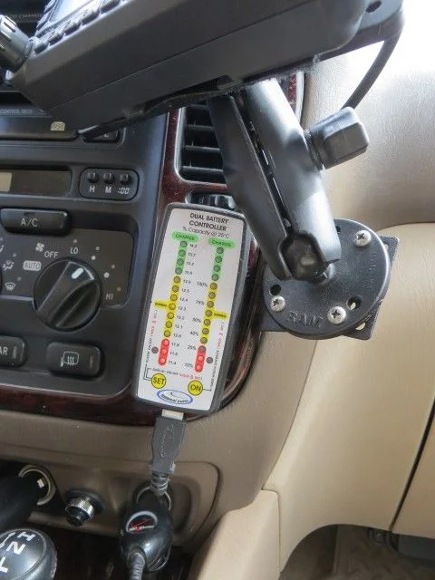

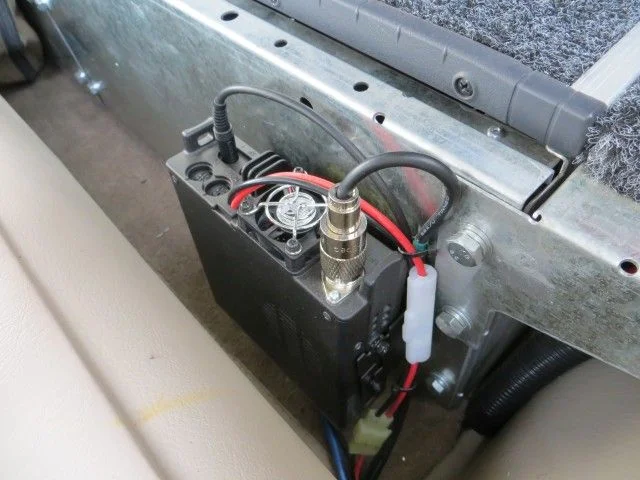

The Kenwood is a remote face unit, the control box is mounted to the rear drawers just behind the 2nd row seats. The control box is mounted to the dash using a RAM mount and PanaVise combination. The mic connection was added to the console, so when unplugged I have nothing more than a Cat5 jack exposed. There is an external speaker mounted on the ceiling just forward of the sunroof.

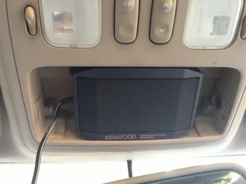

Kenwood speaker is super slim and fits in the garage door opener area with a little bit of trimming. I use it for the HAM.

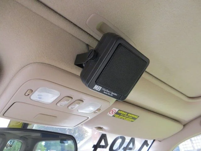

That is a good fit. I'm really liking the MFJ setup I have, I can aim it towards the back and crank the volume when we are using it as a pit radio during races, tunnels the sound out for a nice loud system.
Glad you sent this. I use the same speaker and was hoping it fit there. I'm planning to widening the opening and make the whole door fabric covered...
That would be really slick! Post a pic when you do it :cool:
