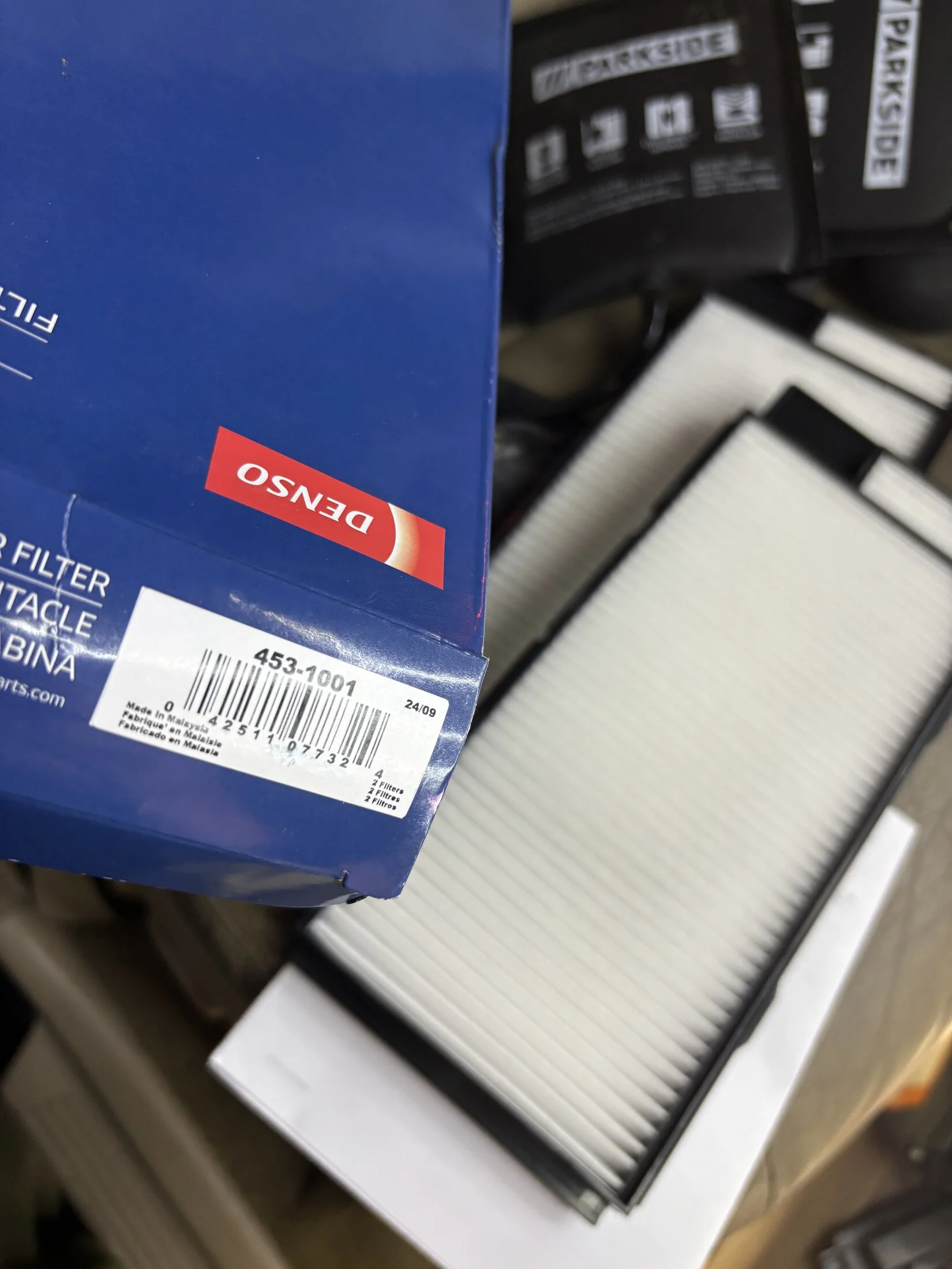

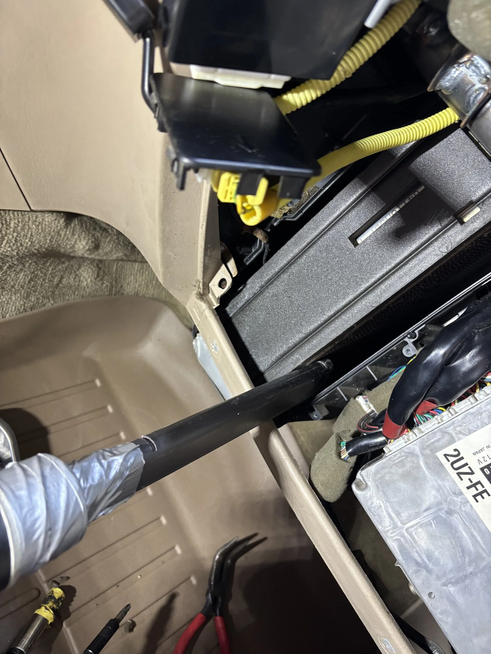

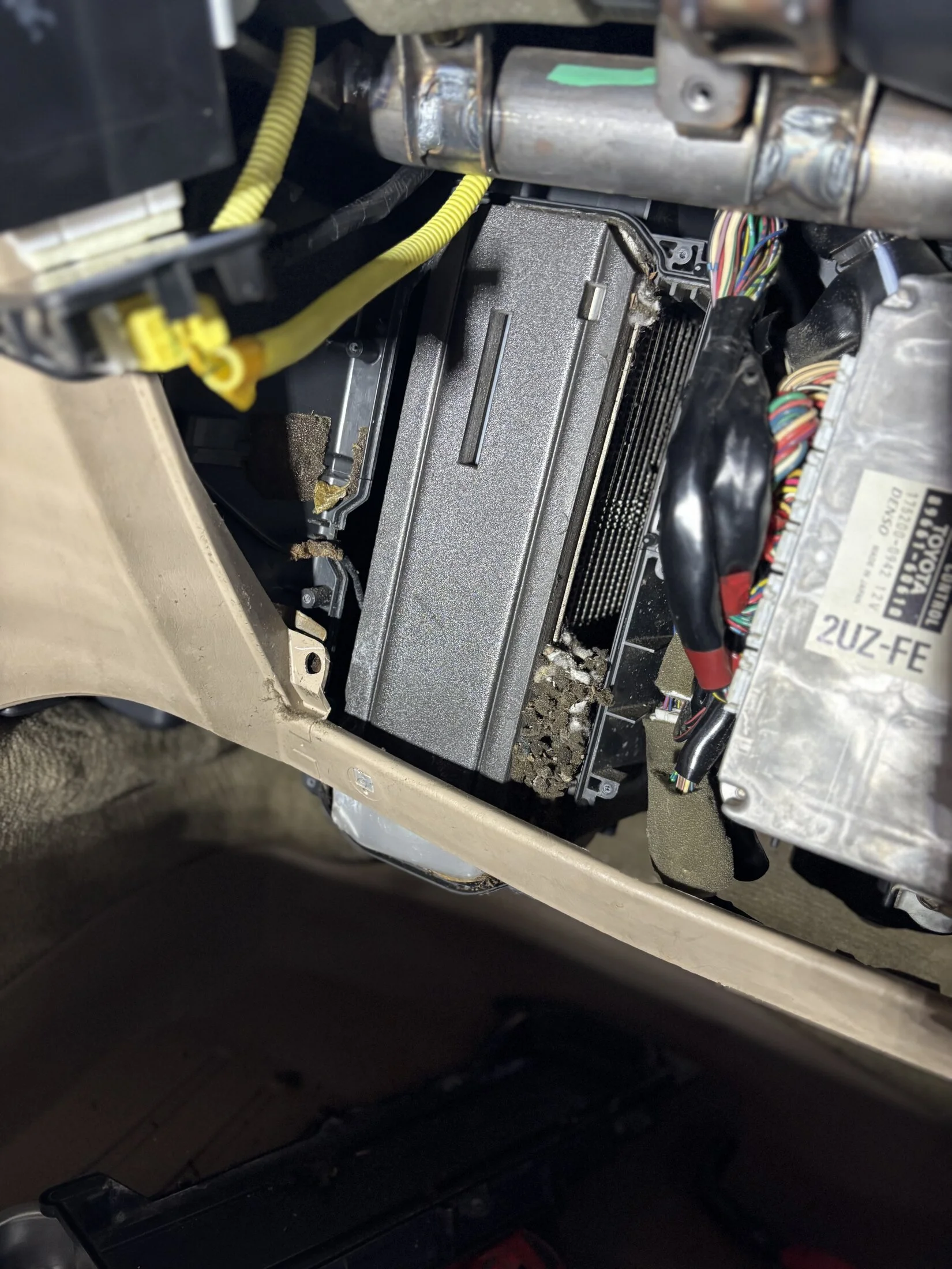

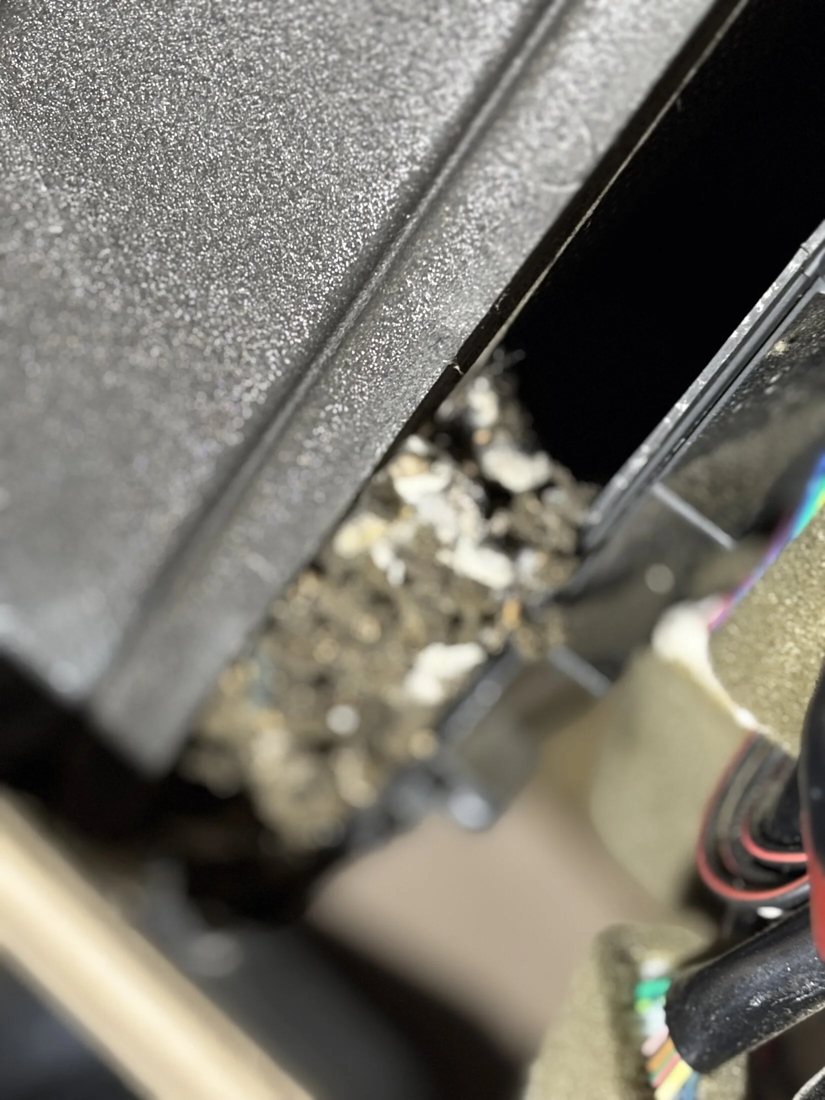

the rats nest in the engine bay have all been removed, no wires were chewed thankfully. theres still a smell in my air vents so i ordered new cabin filters and im planning on using gasket sealer on the bottom half of the cabin filter cover to remedey the condensation leak at passenger foot well.
-also ordered new pcv valve, grommet, and hose because i found tons of carbon build up when intake manifold was off :D

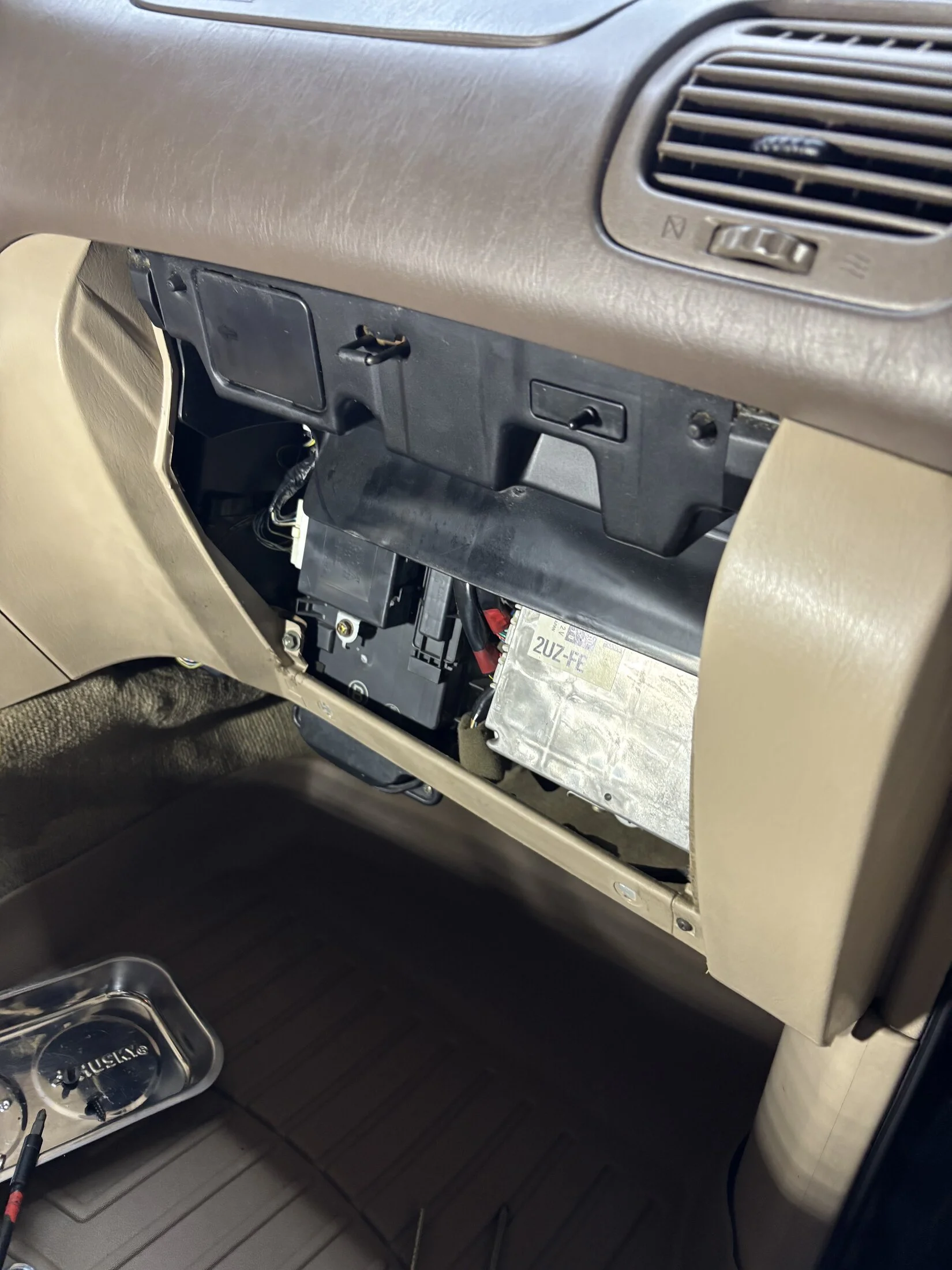

I've had a pungent smell from the air vents and dove online. Looks like the 98 has the door slot for the cabin air filter. 8 took off the door and cleaned out the area and used gasket sealer where the worn out gasket is to remedy the AC drip symptom on passenger floorboard.

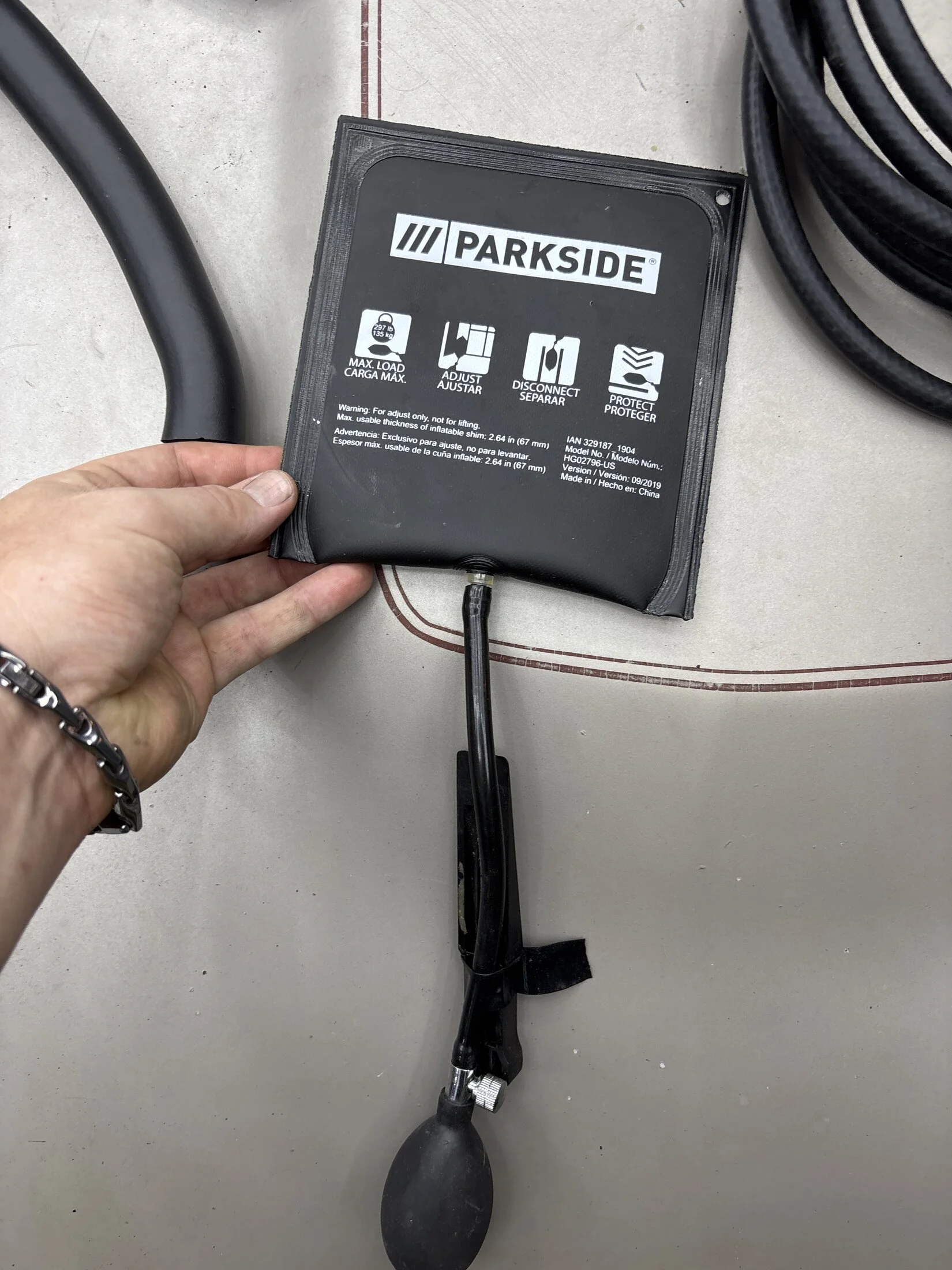

Used a pump airbag thing to hold the bottom trim open and made it super easy to get the door back on, I was kinda proud of this idea because people really struggle on that part.
I ran a whole can of Lysol thru every vent and let it sit. Then topped off the refrigerant from 30psi to 40psi with a AutoZone can. Complete air vent overhaul complete 🥳

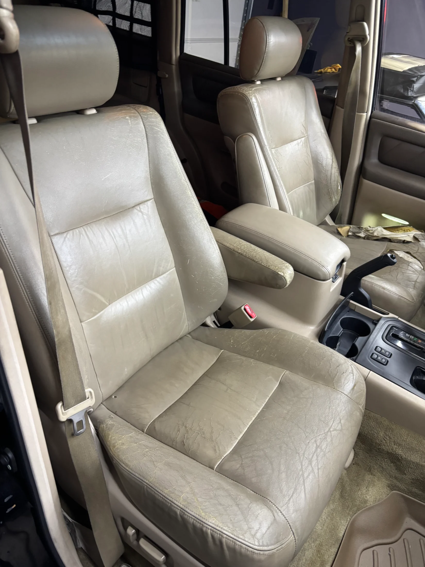

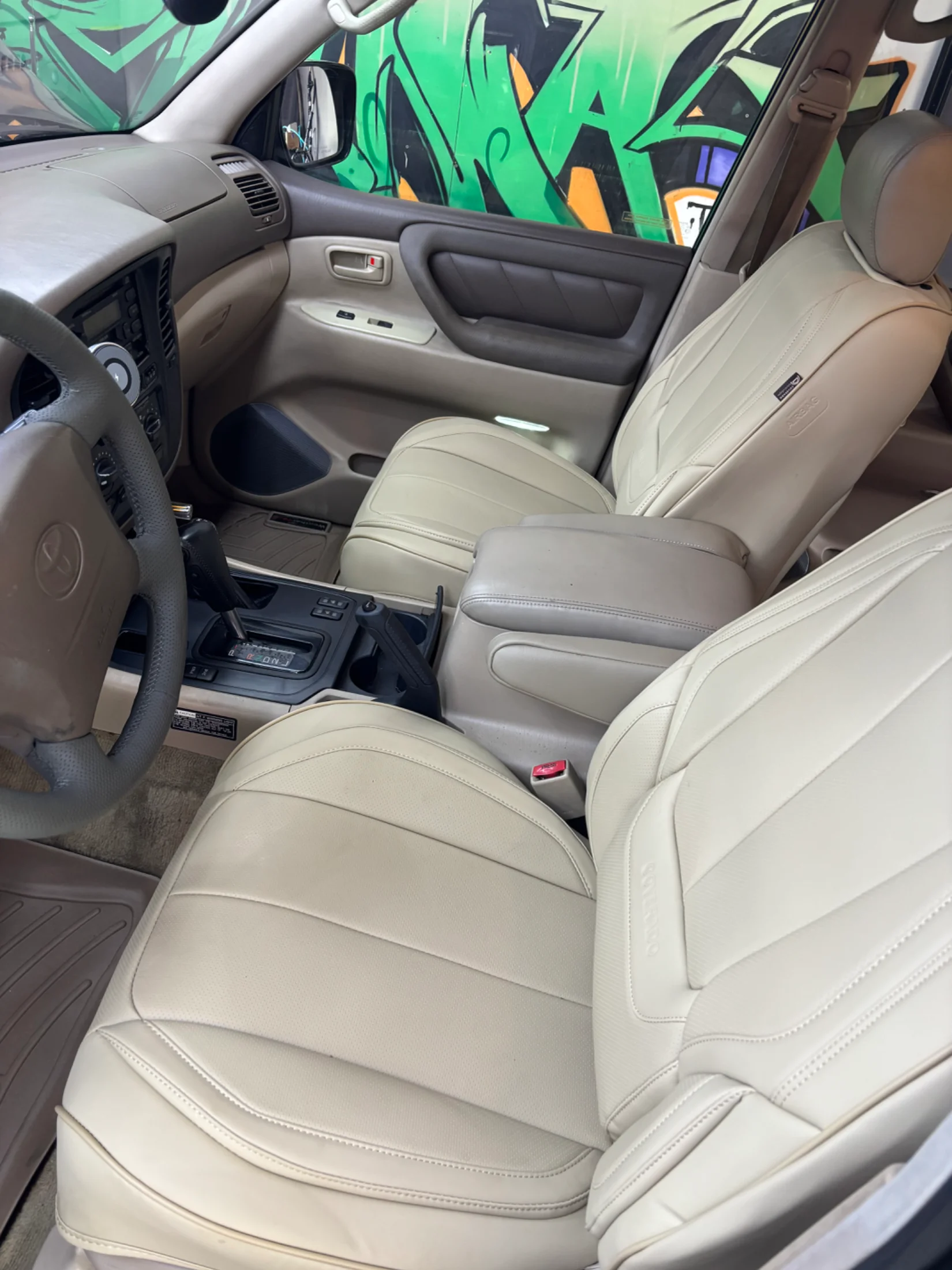

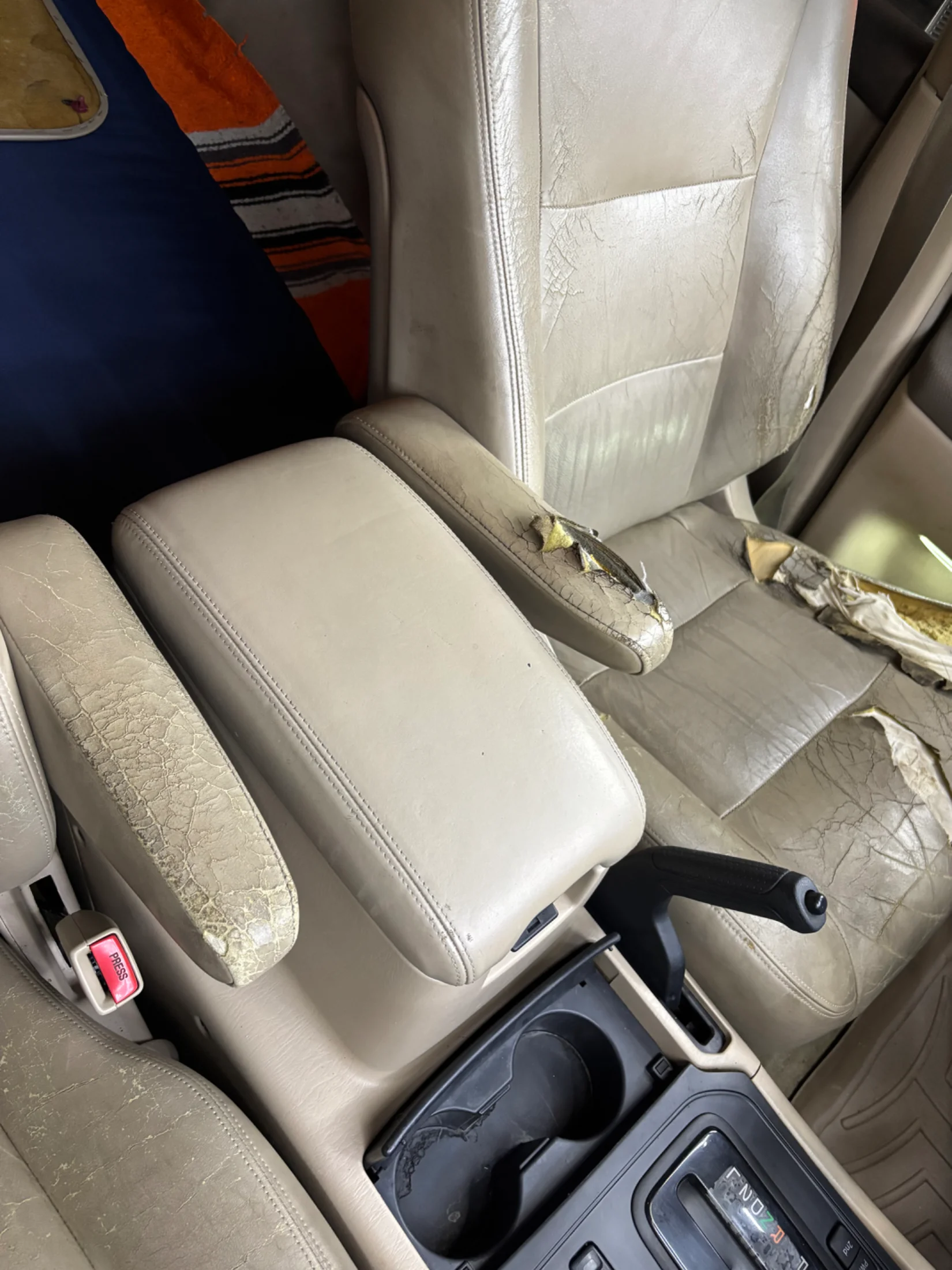

- replaced seat covers with coverado kit, could not be happier with the $80 investment there!
