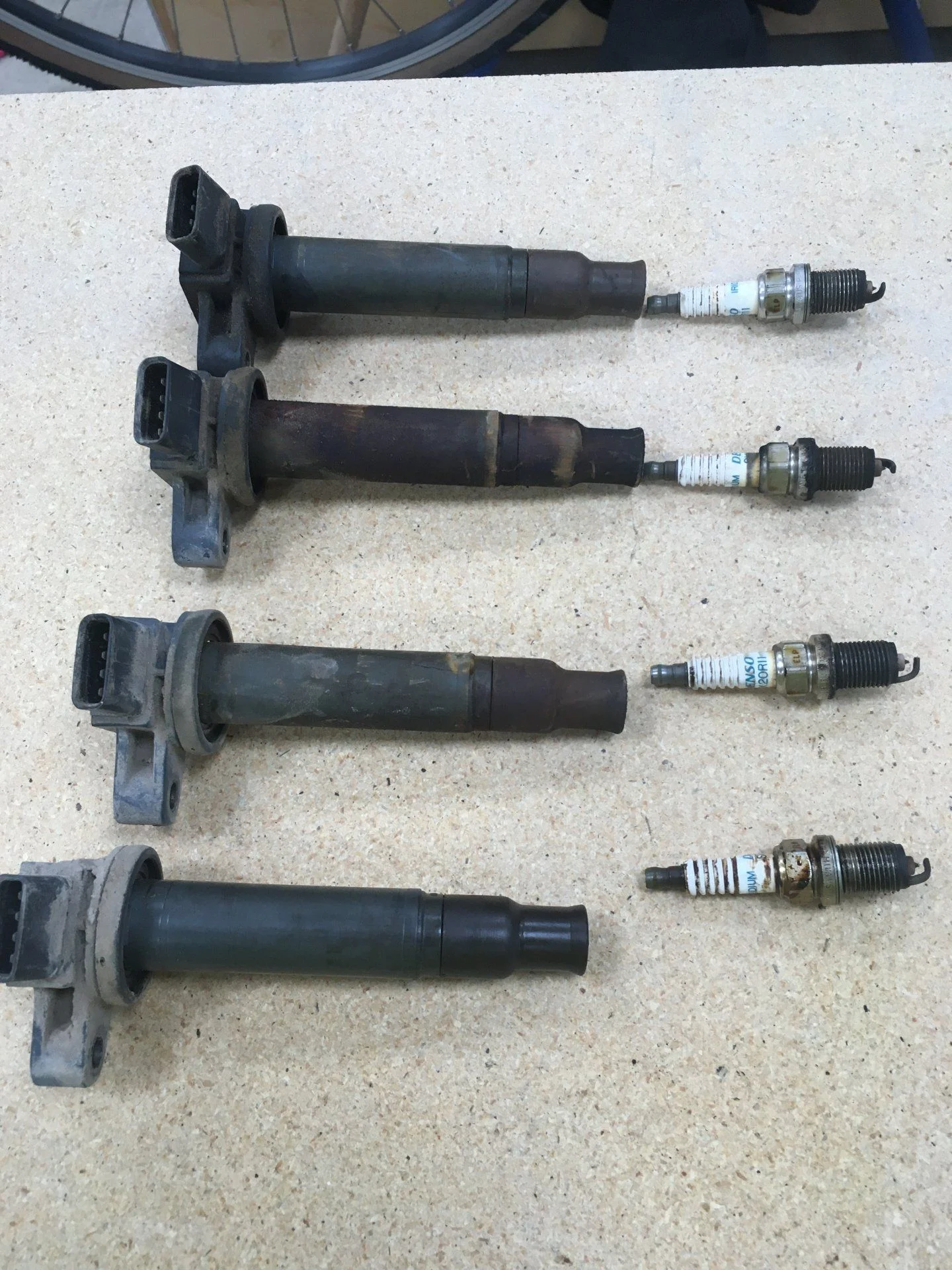

decided to dive in and take a look at the coils and plugs, most coils are cracked and one was a bit oily. I would assume that the plug tube grommet is not doing its job. I have part on order and will be doing a full tune up. I must be missing where the last tune up was documented. Planning to also change the radiator hoses while I am under the hood.
From a distance, Plugs 3, 4, 5, 6 don’t look so great. Looks like quite a bit of carbon fouling or fuel fouling.
they were not very tight in there.... as i have been reading up on Mud it seems that the "inner" plugs seem to loosen over time, maybe that could have something to do with it?
If the plugs were loose and the plug tube seals in the valve covers are hard as rocks, then very well could be oil seeping in and burning.
