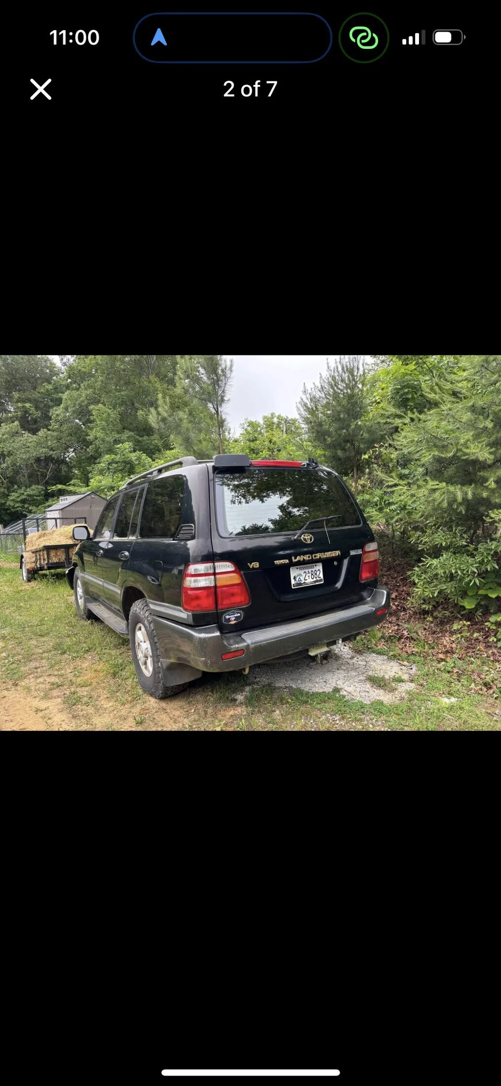

just bought a 1998 LC with 360k miles in very neglected condition.
heres what i see,
-damage from hitting a POLE at low speeds
-ABS light "scanner shows front right wheel speed sensor", im guessing this is what caused the pole hit
-rat droppings in and all over engine bay, hole chewed in air filter, air filter piece clogged MAF and i had to use paper towels wrapped around air filter to drive it the 2 hours home.
-disgusting interior
-new axles, but every bushing under car looks severly cracked
-no coolant in vehicle, refilled and i dont see a leak anywhere, no overheating, no white smoke out the back. im guessing its the water pump. im monitoring it for now but havent found any clues.
-needs timing belt kit, "aisin kit and oem cam/crank seals on the way"
-power steering was creamy and insanely low, added atf fluid, looks like sweating thru the hose, havent searched for leaks yet.
-replaced battery terminal, now holds 14.1 volts while running
HERE IS MY GOAL
-get whats needed to "safely" overland/car camp the vehicle in a groups "not solo"
-most basic tire/wheel/suspension set up for forest roads and beginner level offroading
-learn about 4x4's as ive been a lowered rwd sports car guy my whole life.
-meet local dudes here near Georgia to go on overland trips with

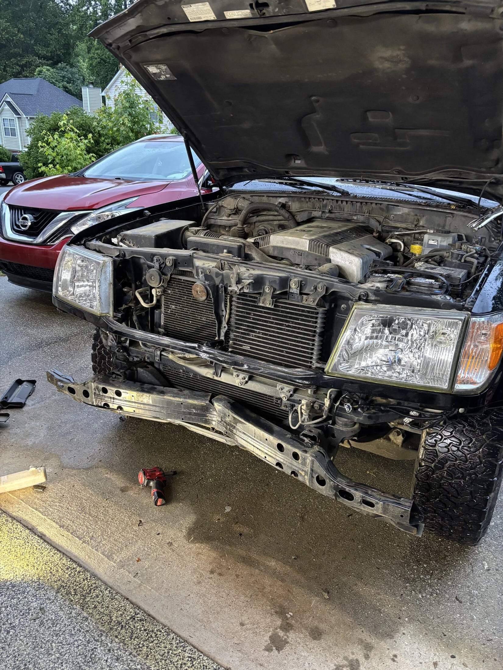

>> Real classy, at least the gold emblems are still in tact, that's worth $2k right there

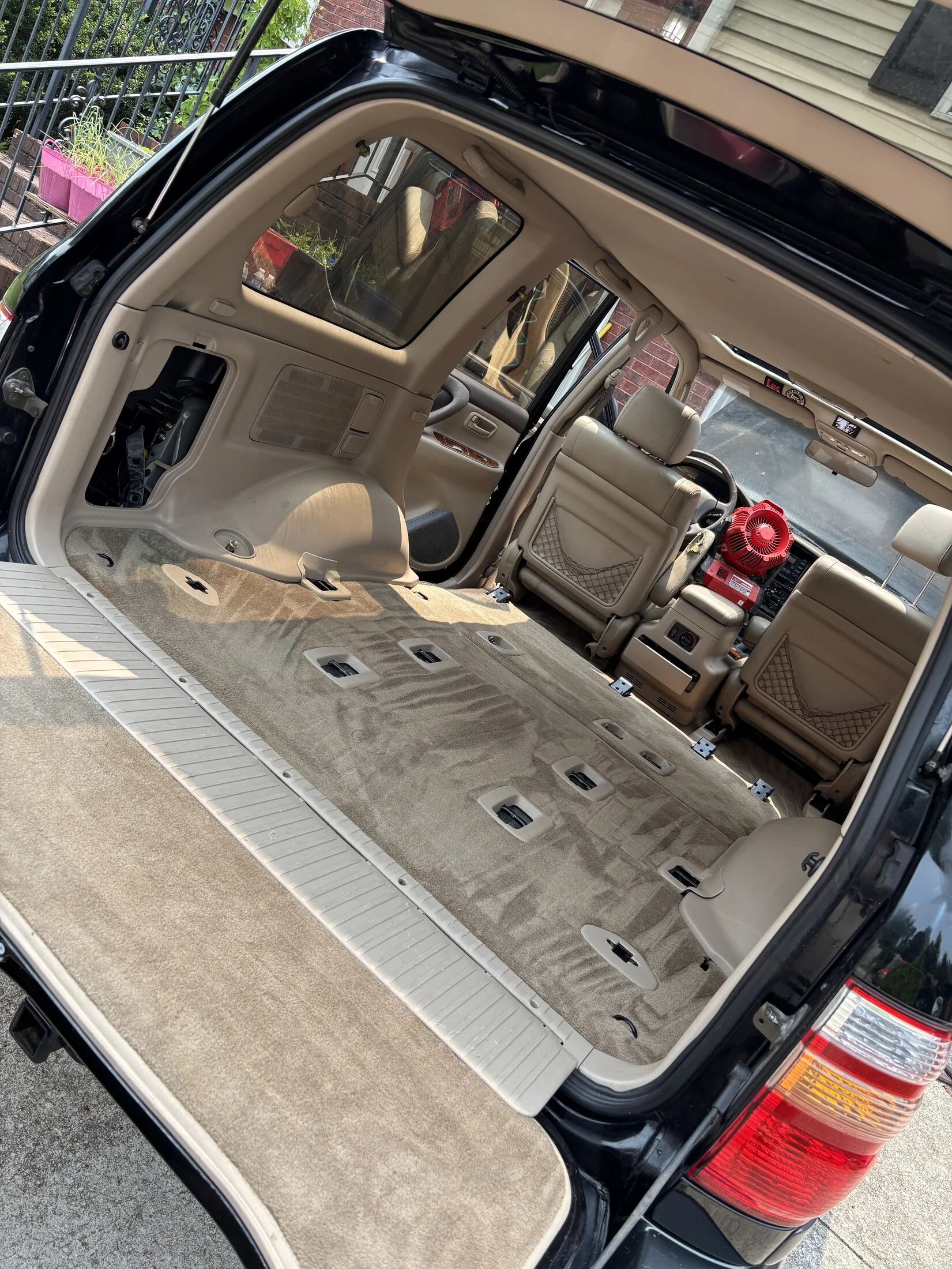

>> Less stuff to care about. Just send it.. I first replaced with full leather from Land Cruiser Heaven and then eventually covered them again with Cordura covers from Cal Trend lol damn dog....anyway they worked out really nicely but you lose the leather vibe

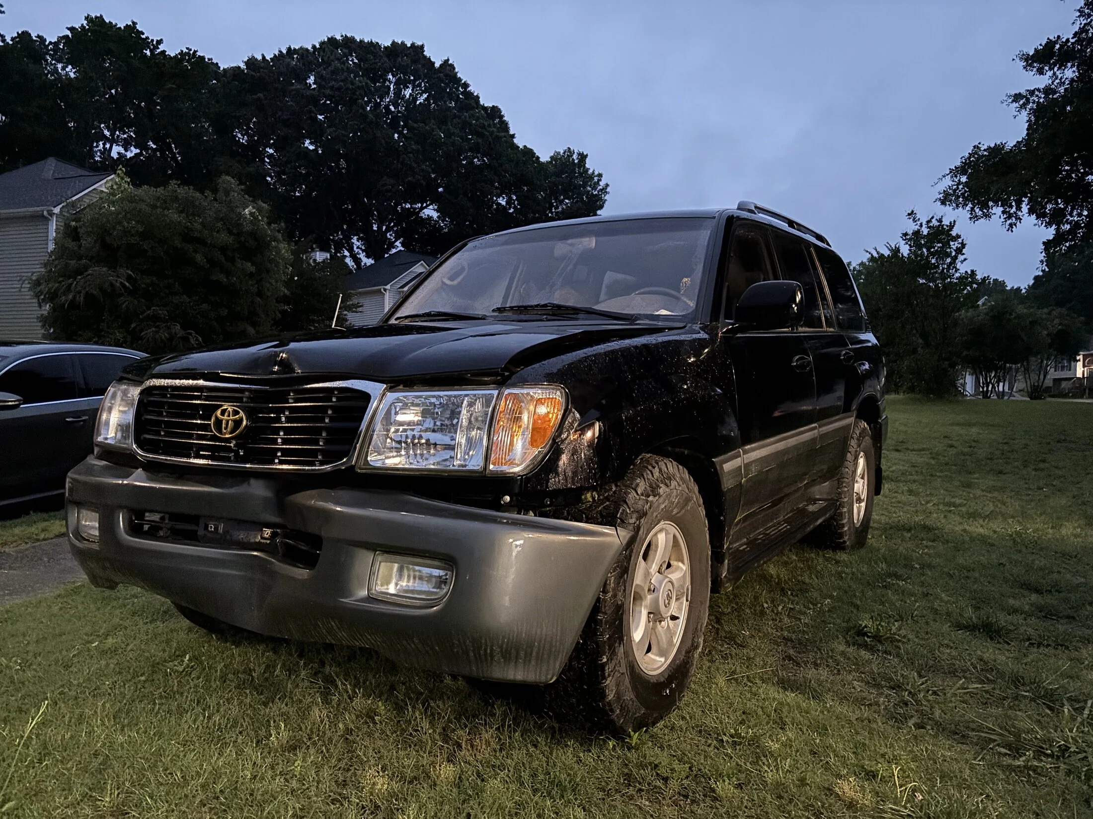

damage doesnt look bad, i used a 2" ratchet strap to bend back the radiator support by attaching it to my datsun in the garage. i replaced the hood and now just need a grill support and a winch bumper

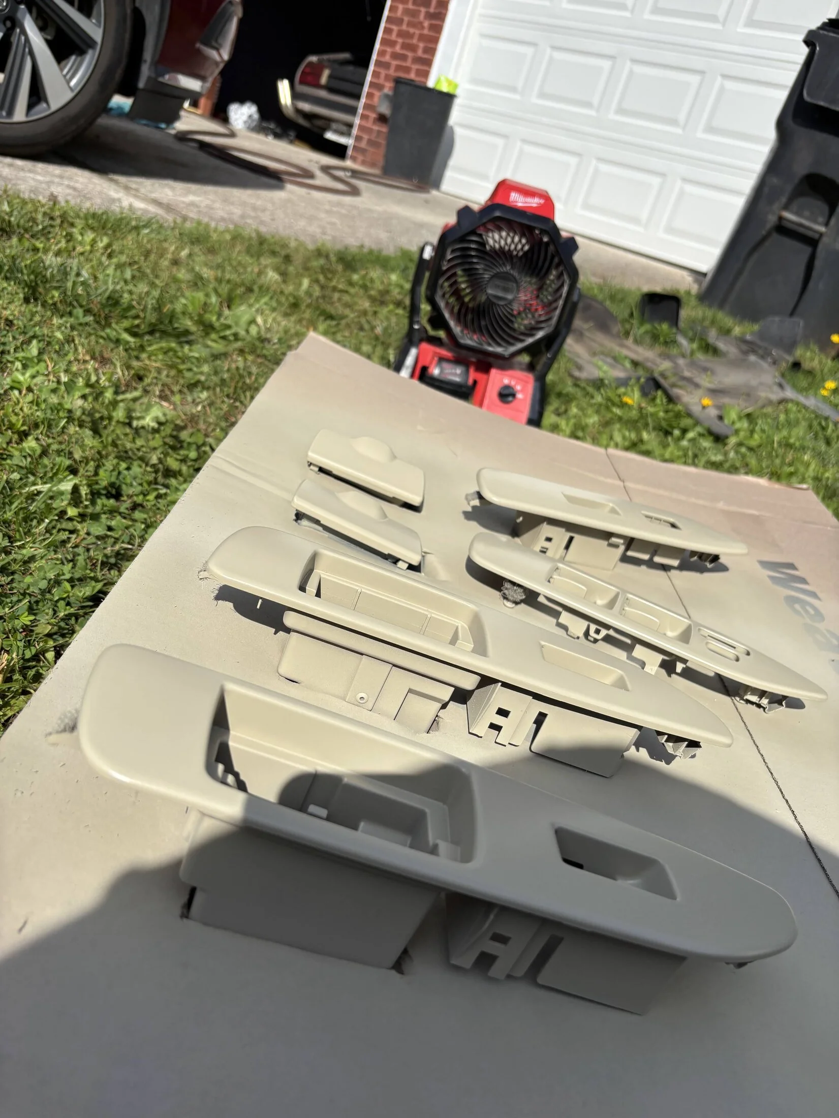

That interior looks great! Heat gun (applies gently) and plastic trim tools -and patience- are great for removing the wood trim, then denatured alcohol to remove the adhesive remnants. I've done this one four different 100s, works like a charm.
