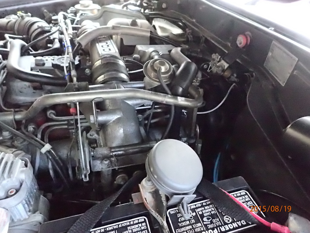

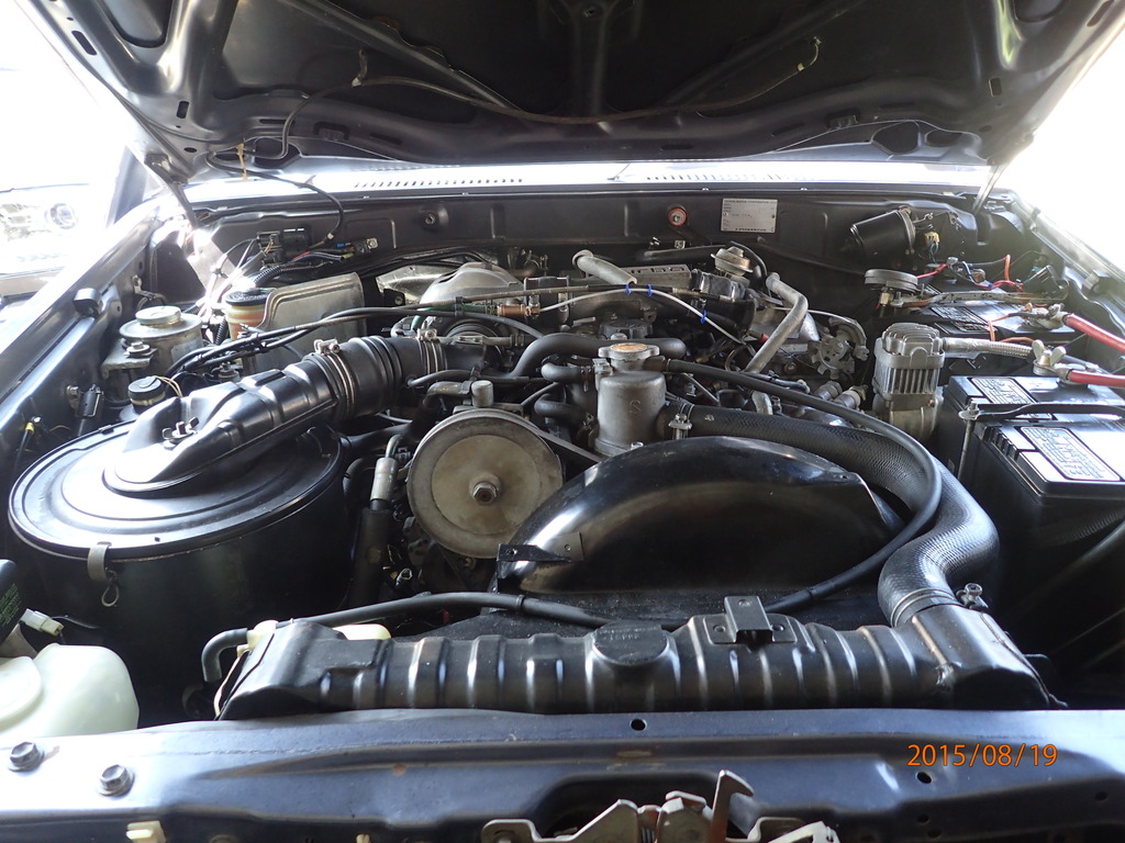

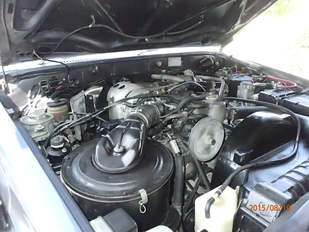

Once I got it home, I had to go through everything and drool some more. I hate to say it Charles, but it will likely never be this clean again, but man, oh man, does she shine up well.

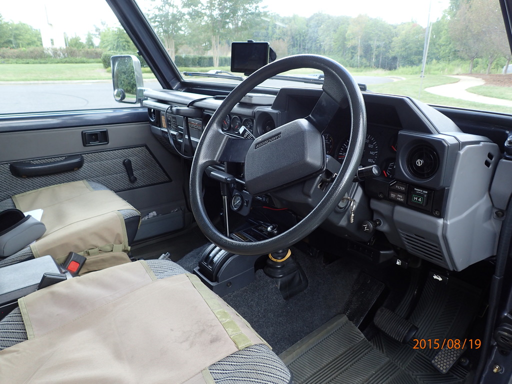

As it sat when I bought the truck, it had less than 110,000 kms on the clock, the carpet and the rest of the interior looked much nicer than one would expect for a 28 year old truck, and the previous owner(s) has treated the truck very well and had tastefully upgraded her.
The basic truck is a BJ74 LX with an A440, factory AC, suspension seats, and PTO winch. The upgrades included.

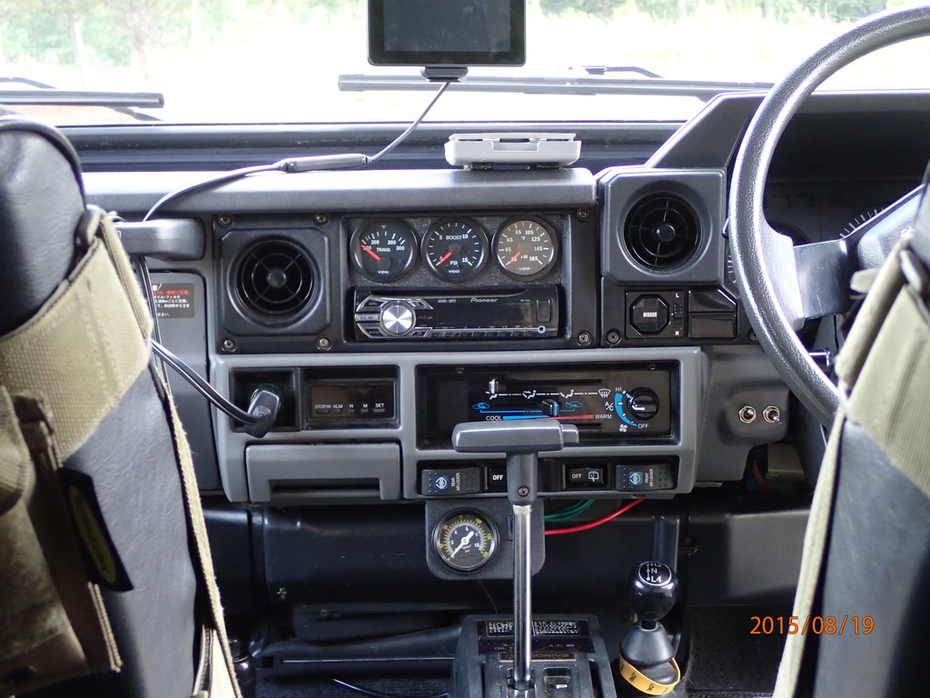

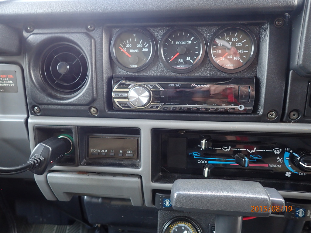

I had Rob Smith (Charles' top notch diesel Cruiser guru) add VDO trans temp, EGT, and boost gauges prior to taking delivery.

Xtra Clean Interior

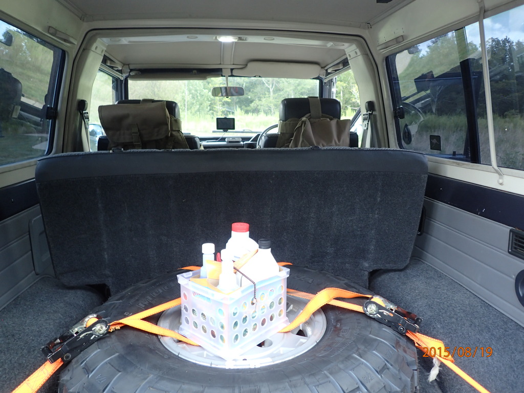

Temporary storage of the new spare ...

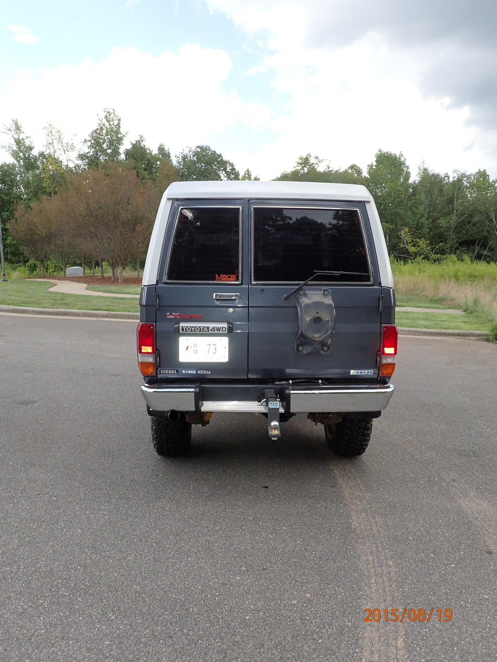

The one thing I was able to keep @Gun Runner 5 from buying was a new spare. The tires on the truck are BFG KM/2s in 33x10.5R15, a size which BFG has discontinued :bang:. The spare was an 11 year old 30x9.5R15 BFG AT that had never been on the ground. My local tire guy said that his distributor showed a total of 4 of the KM/2s in inventory east of the Mississippi River ... there are now three in inventory :)

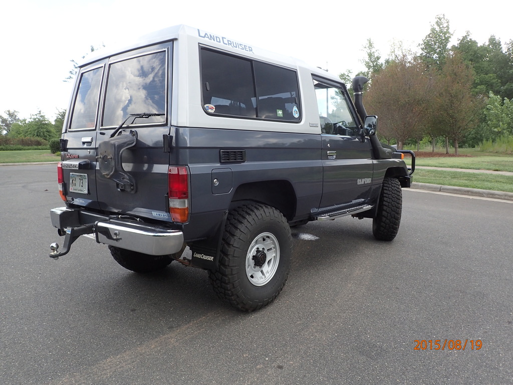

This explains the temporary storage of the spare on the floor behind the back seat. The 33" spare would not clear the bumper on the spare tire carrier and flipping the carrier created an issue for the rear wiper.
With the welding help of @Cirbo , this was corrected.
Step 1 - cut the studs off the stock carrier and grind flush
Step 2 - drill new holes ~1.25" higher
Step 3 - Obtain M12-1.5 x 60mm long, grade 10.8 all thread bolts (not shown)
Step 4 - Get a buddy who can really weld to tack the bolts in place (not shown)
Step 5 - Rattle can paint the whole shooting match satin black
Step 5 - Reattach stock carrier to door and mount spare
Step 6 - Order bumper with swing out from @reevesci (to come ...)

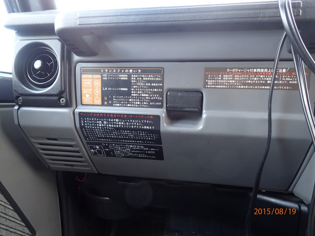

I noticed that the PTO shift knob was a little loose and found that the required screws are in the US parts stream from Mr. T, but they do think a lot of them. I believe these were close to $4 each. No pictures of the install, but here is the part number.

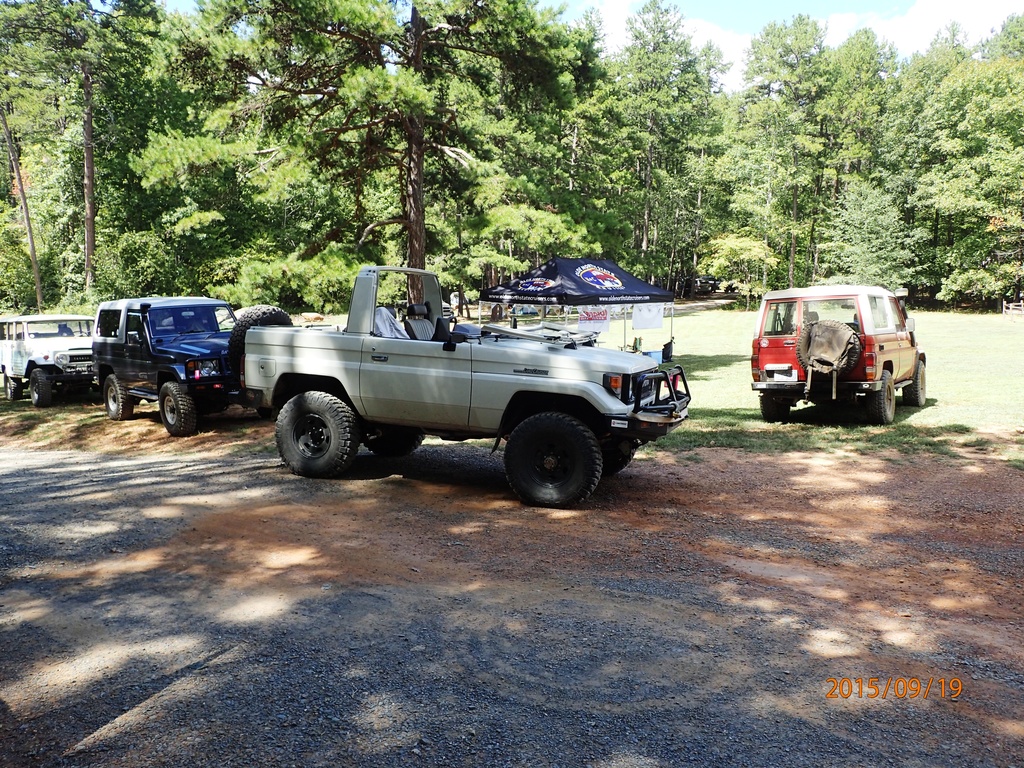

In September, I went to two events in the truck. The first was Logan's Run / Cruising the Carolina's with ONSC. I was the designated saucier and supplied both the spicy and the KC style sauce for the even (each made with some special ingredients imported from the great state of Tennessee - specifically sourced from a dry county :hillbilly: ). More info on this event can be found here ==> Cruisin' the Carolinas - Logan's Run 2015
Now for a few pictures ....

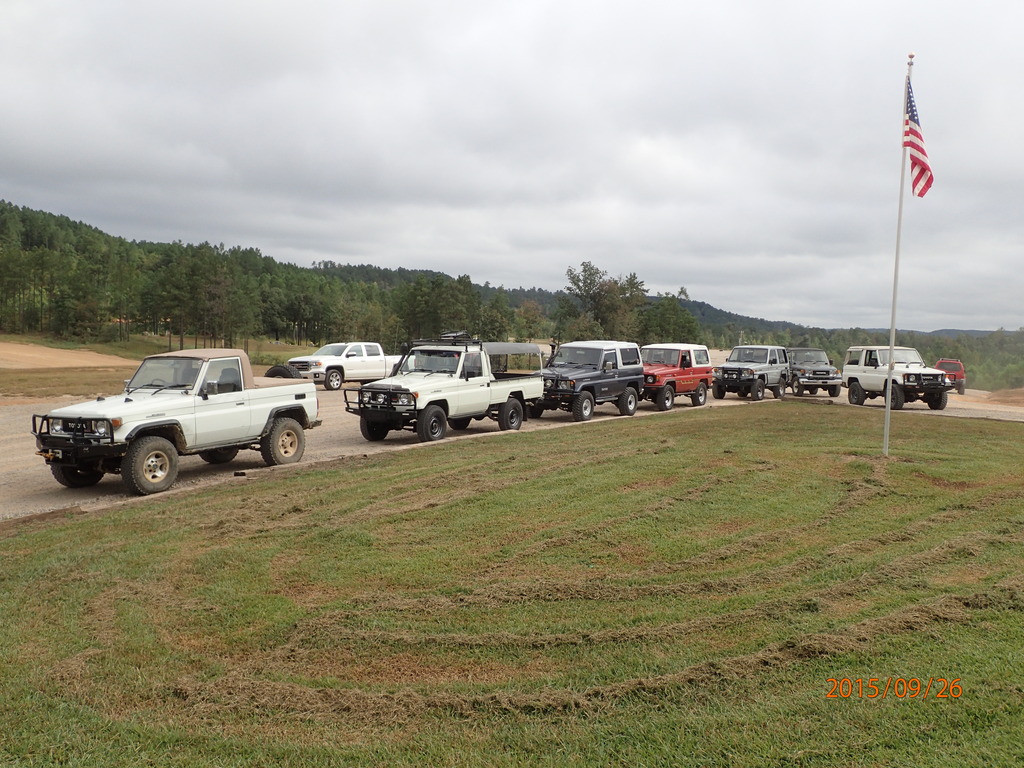

The next weekend, I made the trek to Cullman, AL for the First Annual Southeastern US 70 Series Meet and Greet . A big thank you to @peterb and @Gun Runner 5 for getting the ball rolling there. Lots of pictures are in the tail end of that thread, but here are a few ...
That damned Heep word again ... :flipoff2:

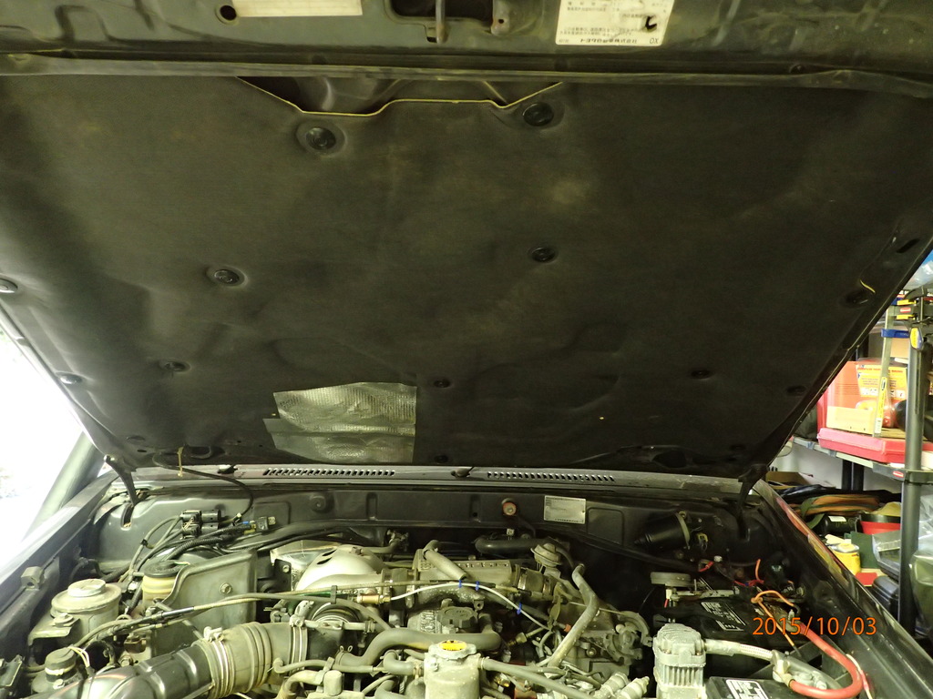

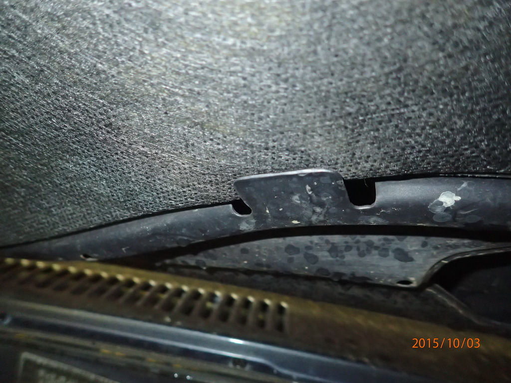

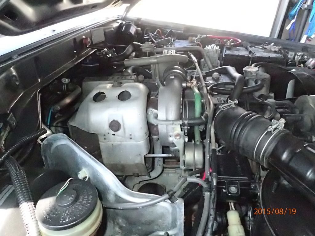

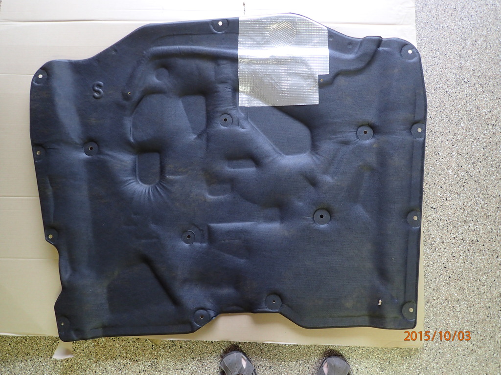

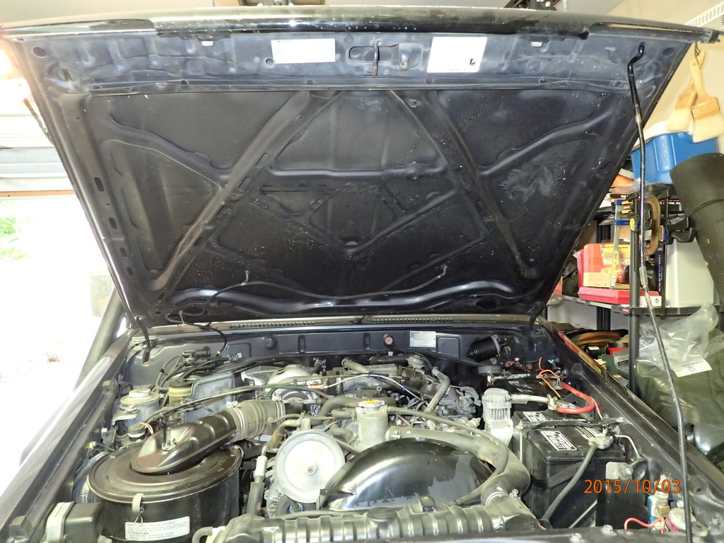

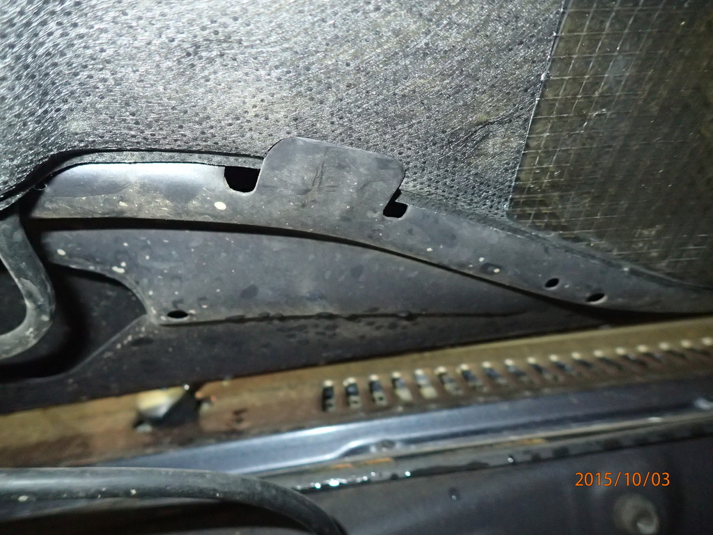

After cleaning up the engine compartment from two weekend of eating dust, it was time to install the hood insulator that I picked up from @beno on my way back from Cullman. This is a 0.1 banana job and took me all of 10 minutes. An extra person would be handy just for ease of handling, but with a little though, one person can do it easily.
Before:
Parts from @beno
And done
Tabs that retain the insulator at the back of the hood / bonnet.

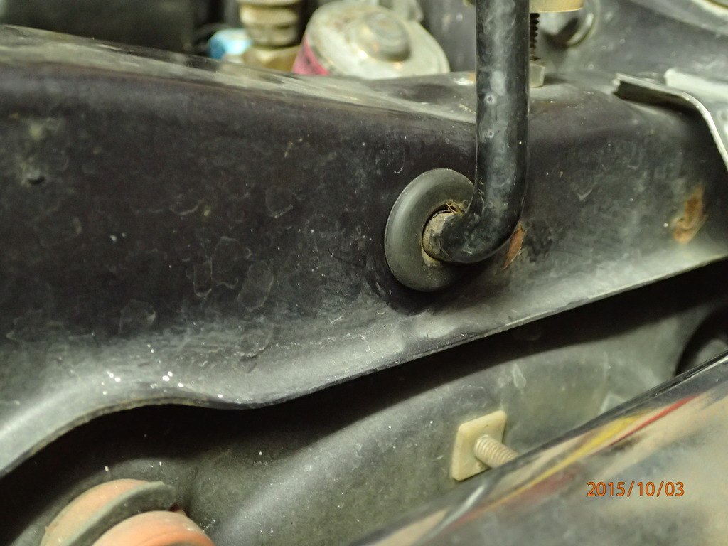

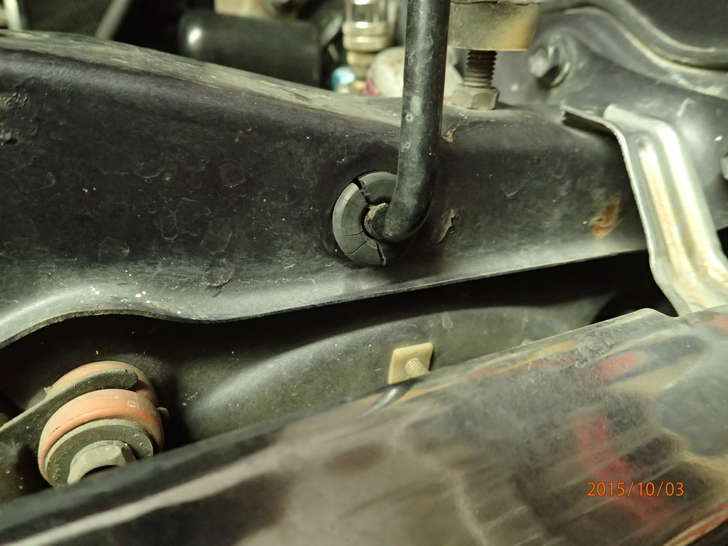

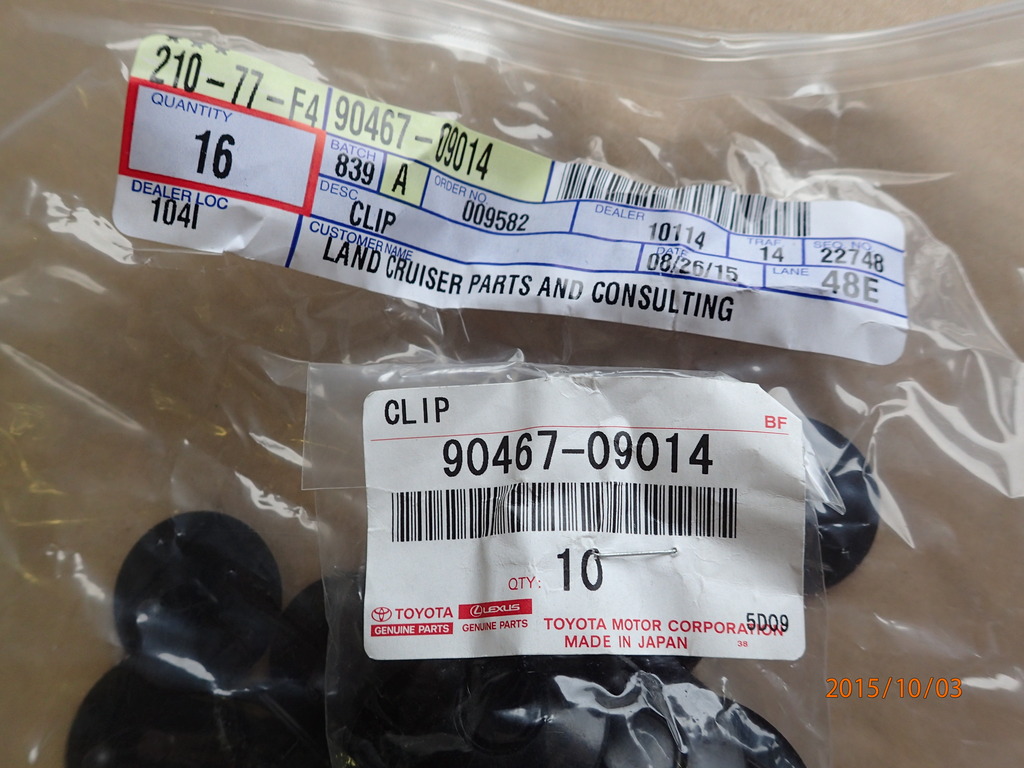

Finally, replacement of the nasty grommet at the base of the hood prop ..
Parts from the mothership via Dave Steadman
And before and after close-ups
Yes, I do have some minor surface rust to attend to there .... ;)
