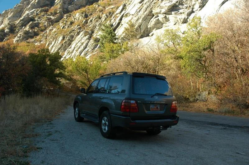

Earlier this year I picked up a 2000 100 Series Land Cruiser from a local customer & friend of mine. The Cruiser had some major brake issues and he had exhausted his patience dealing with the repairs and was ready to move on. Just so happens I like projects and we struck a deal that worked for both parties. We spent the next 3 months base-lining the Cruiser and repairing all the issues including a major overhaul of the braking system here in the shop in between customer jobs. From there it served as a occasional daily driver and a couple of road trips over the summer.
I've enjoyed traveling in my 2004 Double-Cab Tacoma all over the western US for the last 5 years. It has served me exceptionally well but my needs were changing and I needed a larger platform with similar capabilities and features. I'd had my mind on a 100 Series for quite some time but I wasn't quite committed nor did I really have time to really dive into the used Land Cruiser shopping market. The more time I spent in the 100 the more convinced I was that it would be a great replacement for my Tacoma.

On a sandy beach in Baja this last week, she earned her name. Death Star (pre-explosion)
On a more serious note, the truck exceeded my expectations, hauling 4 people and a weeks worth of gear to La Paz, MX and back including hundreds of miles of bombing down the race course as a chase rig. Part II coming soon
