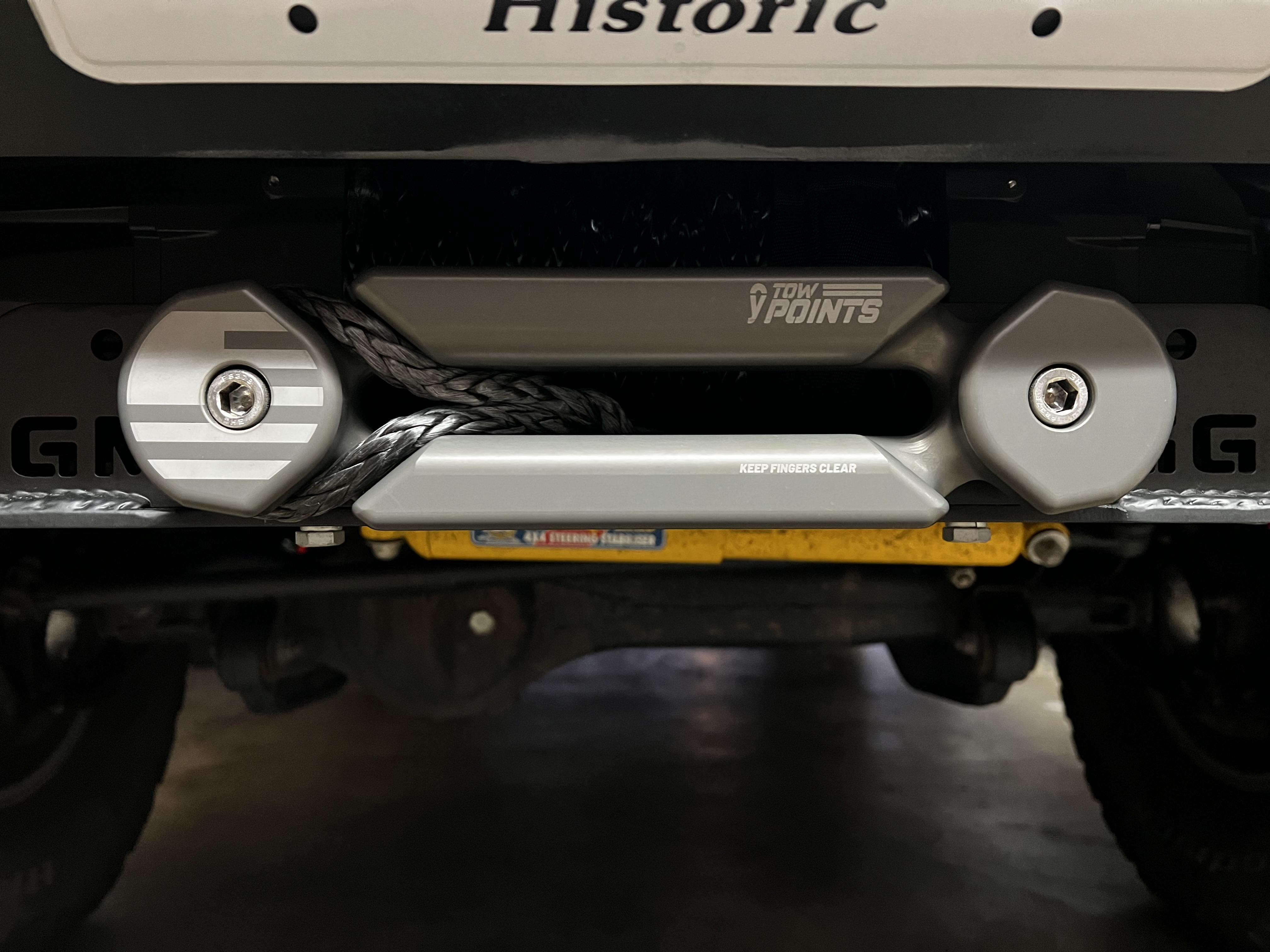

Not sure if you've seen my winch mount yet, but could work for you too....from GGM. Bolts to the bottom of the frame horns and is very solid. That said, I was looking for a solution that would work with my current ARB non winch bumper, and this fit the bill for me, not sure what you may come up with...
And decided to ditch the hook and go with the Yankum setup...
Here's GGM's thread in the vendor section with more pics of mine and what he had to cut on an OEM bumper to fit...
