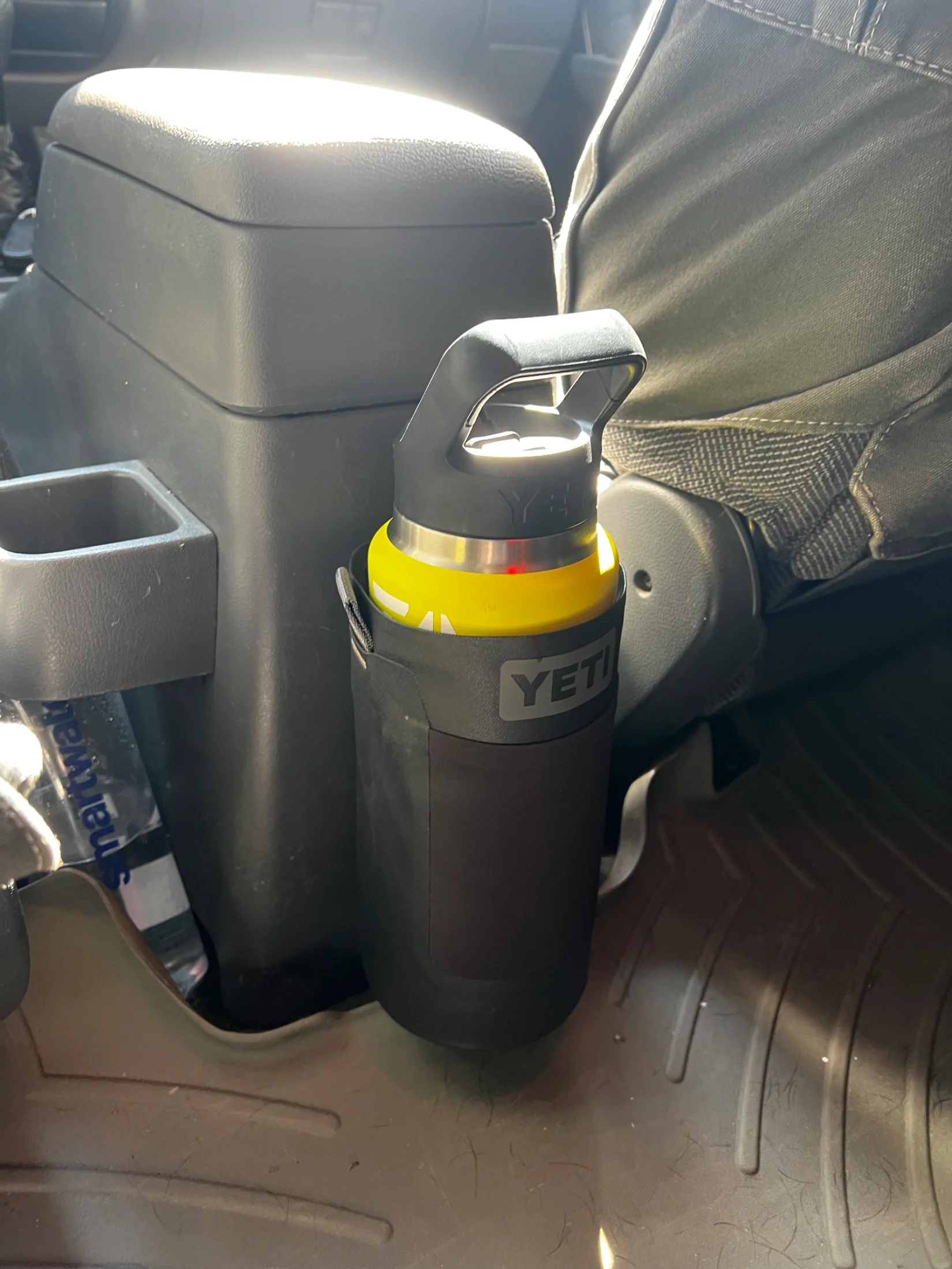

Yeti holder attached to the back of my center console

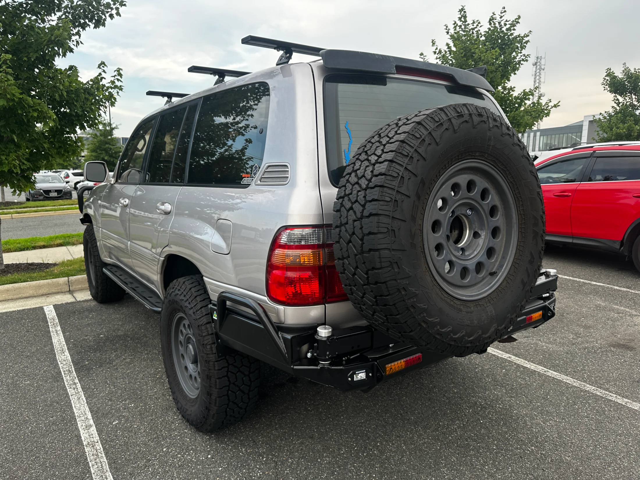

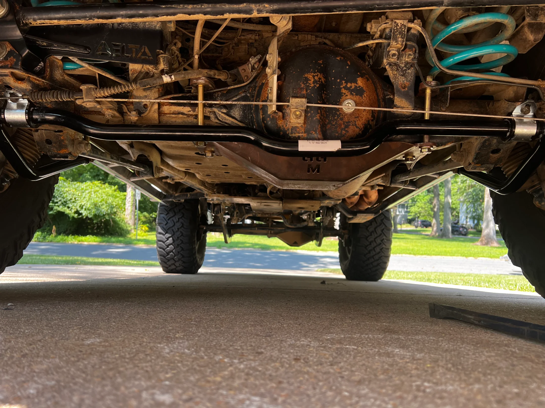

Whiteline HD rear sway bar and @GGM rear diff skid installed...I trimmed a little on top to clear the fatty sway bar

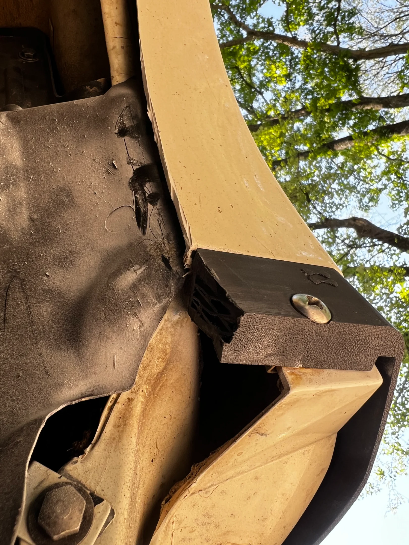

Trimmed my rear fender flares that both were getting bitten hard at GSMTR...pic makes the trim look nasty, didn't see that from the top side!

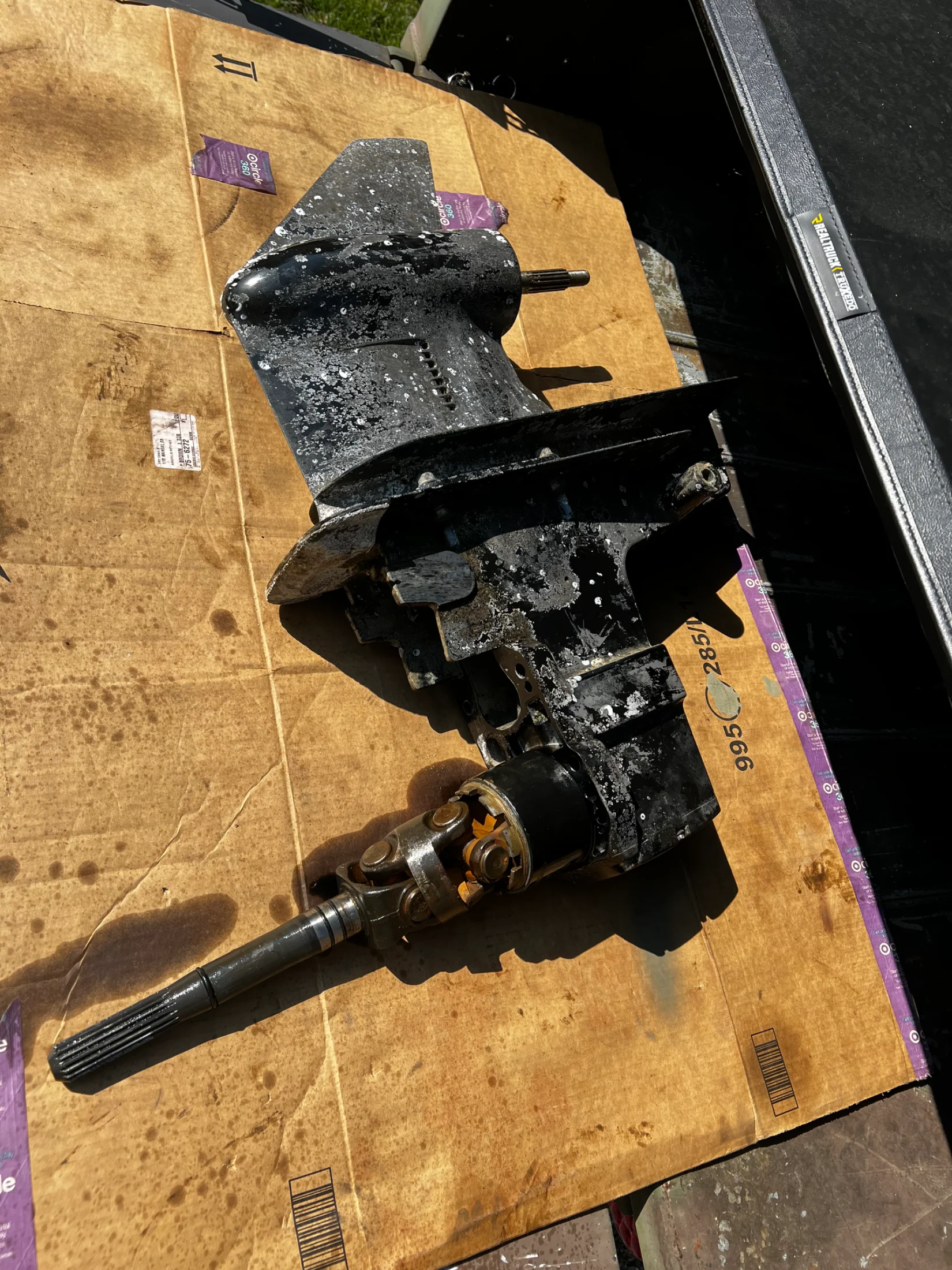

Pulled my outdrive off of my boat, growling/stiff bearings...project for another day!

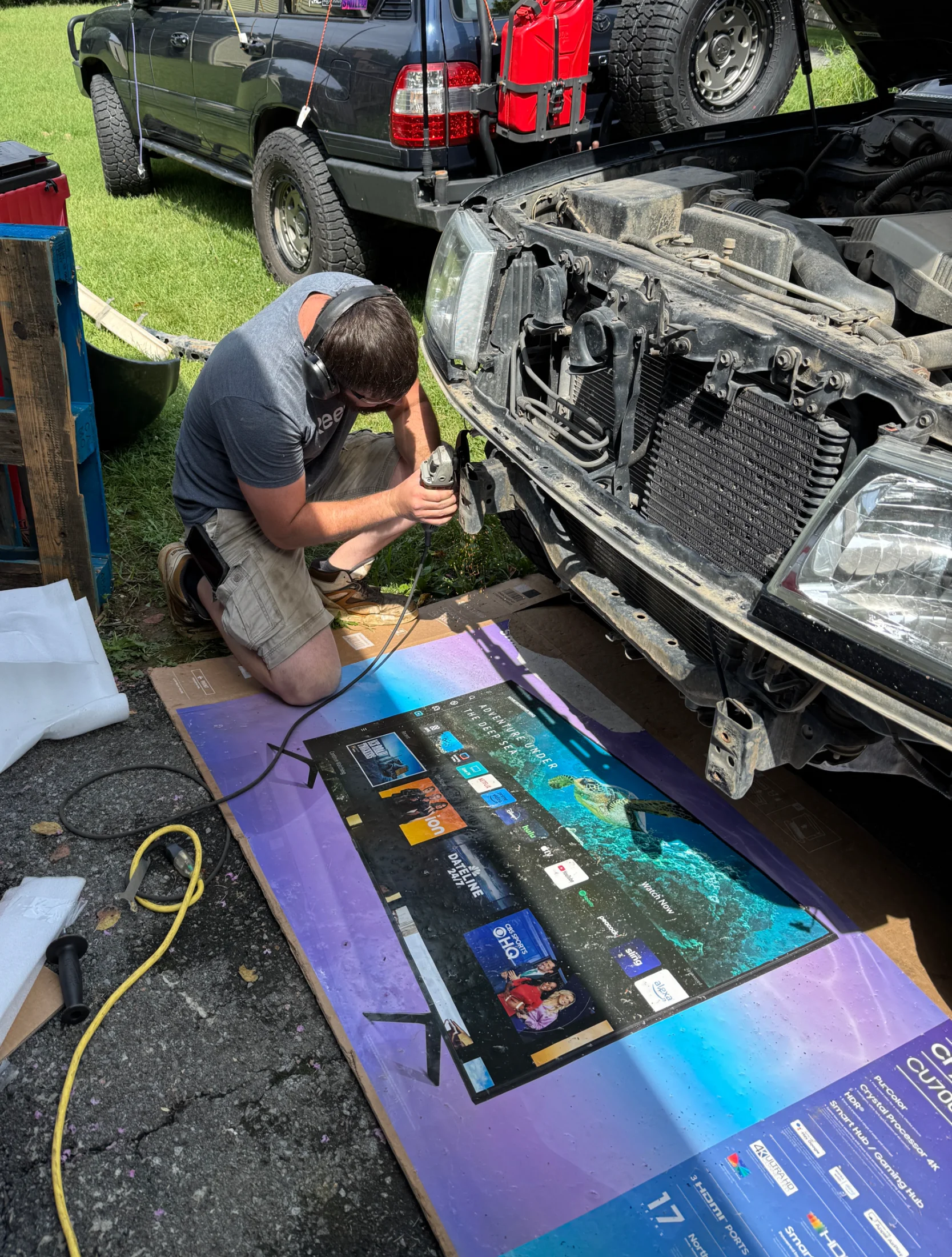

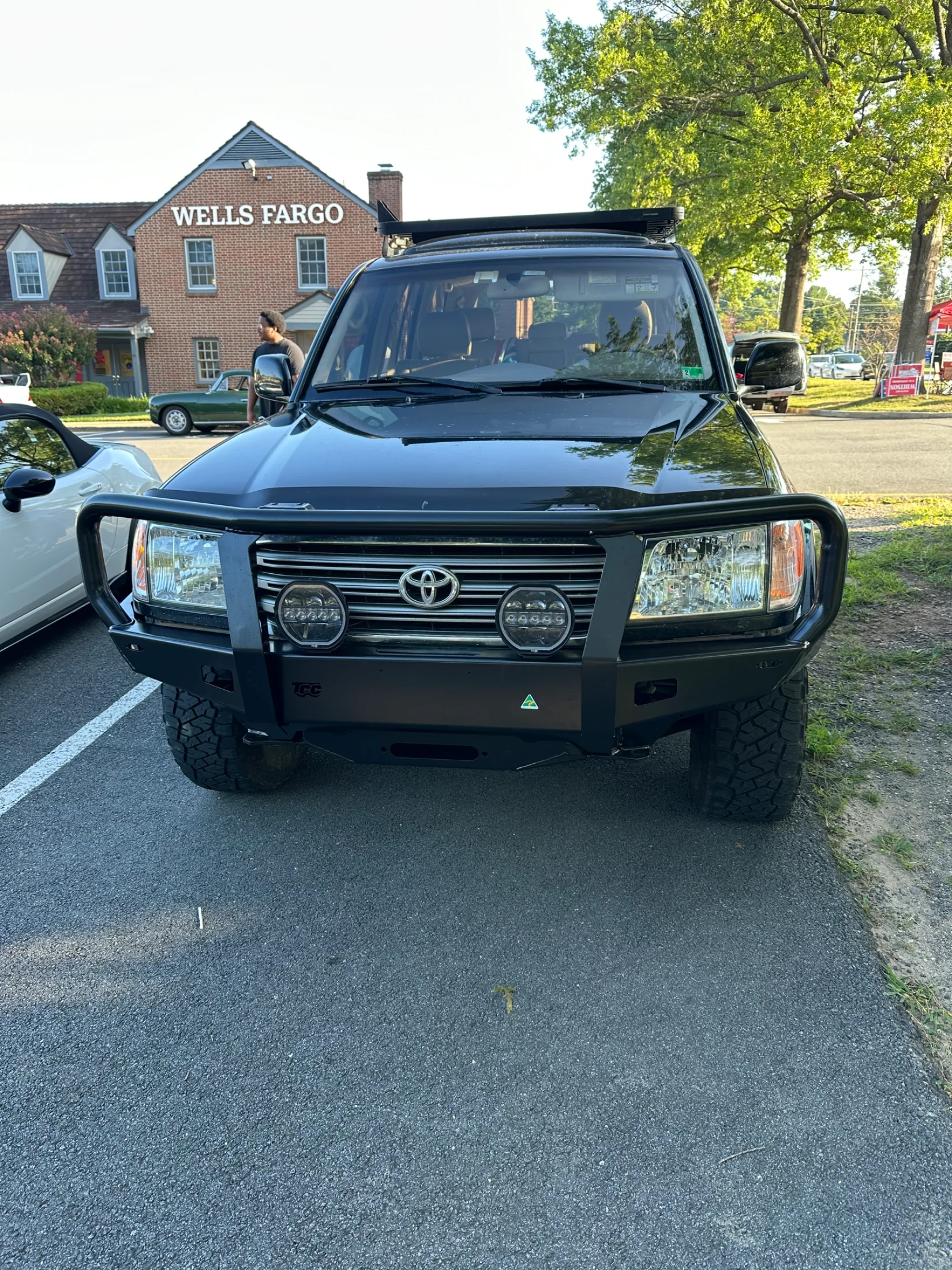

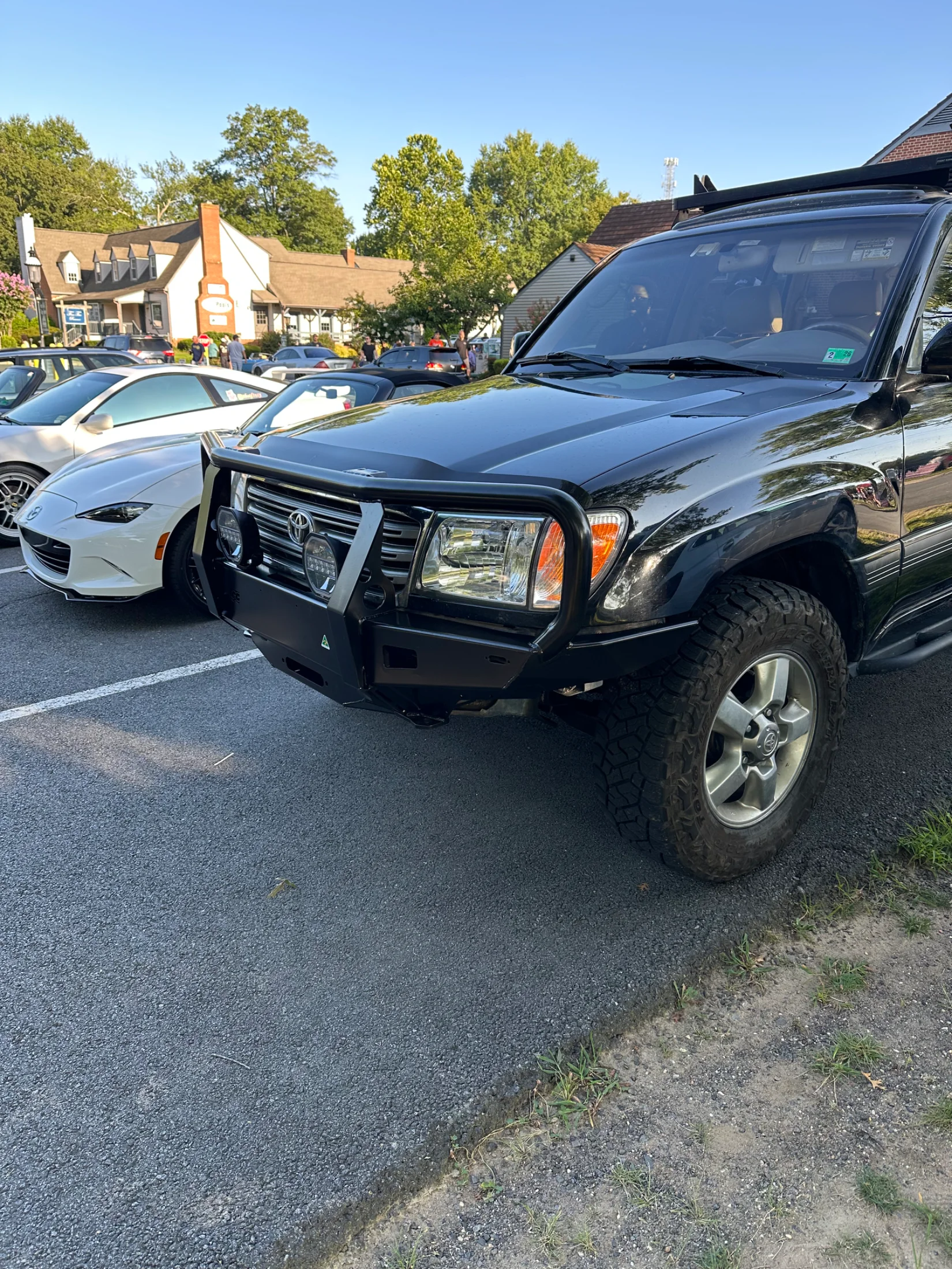

Shoutout to @JakeisbadatThis and @kouki for helping me with my bumper install this weekend!
A few months ago I placed an order for the then-unreleased TCC 100 series high clearance bullbar. LRA is selling the TCC Australian bumper in the US and I was 1 of 11 people to be in the first batch. The bumper arrived at Zack's house the day after I left for COTR (because of course it did) and he let me keep it in his garage until I had the time to install it. The weather this weekend was perfect for it, so we made it happen.
Jake stopped by with his angle grinder and was able to get the bumper to fit correctly with some slight clearance modifications on the part of the bumper that mounts to the frame rails. LRA or TCC will be sending a bracket that allows for all of their hardware to properly fit US spec trucks, but for now it's on there with the 4 bolts that are for the factory recovery points in the frame rail. I also got the wrong pod lights that were supposed to come with the bumper and I didn't get the turn signal indicators that come with it as well, but I was told that was an error in the first batch. The total lack of instructions was a bummer too, but we made it work. Without Jake and Zack I wouldn't have been able to get this thing mounted. Thanks again guys!
Zack also helped with wiring up my lights and got them connected to my AuxBeam panel.
I'm loving the look of the bumper. I was a tad skeptical in ordering a completely new-to-market one, but am really glad I went with it.
I also tightened up the torsion bars so that the truck is slightly more level. I think another turn or two will get it where I want it.
@JakeisbadatThis who approved a Ranger at a club event 😉

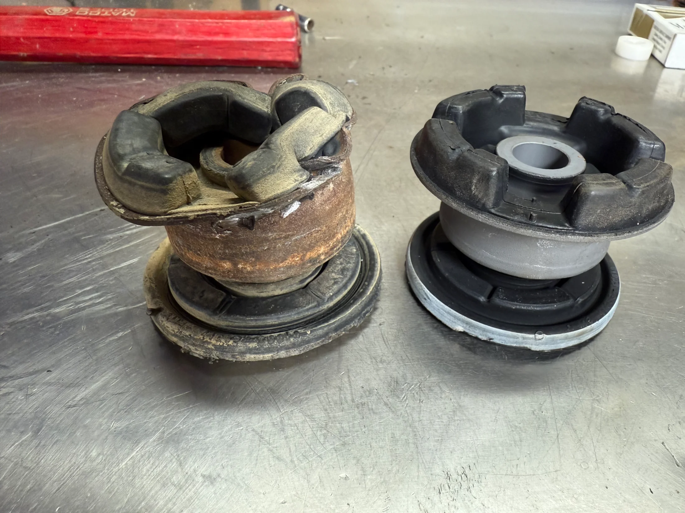

Swapped out all the front diff bushings, front end clunk seems to be gone

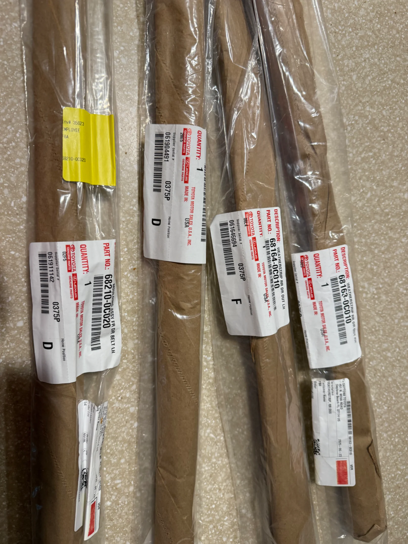

New belt moldings for the Tundra

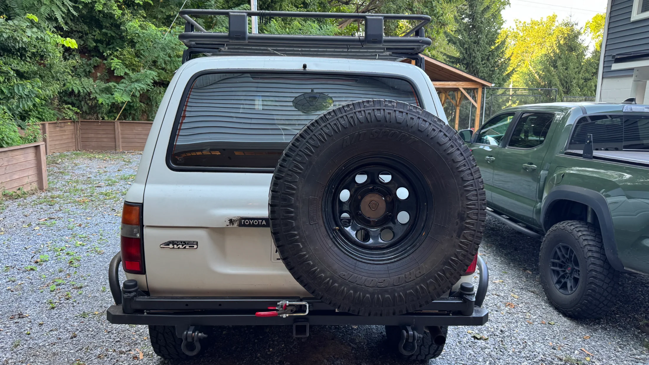

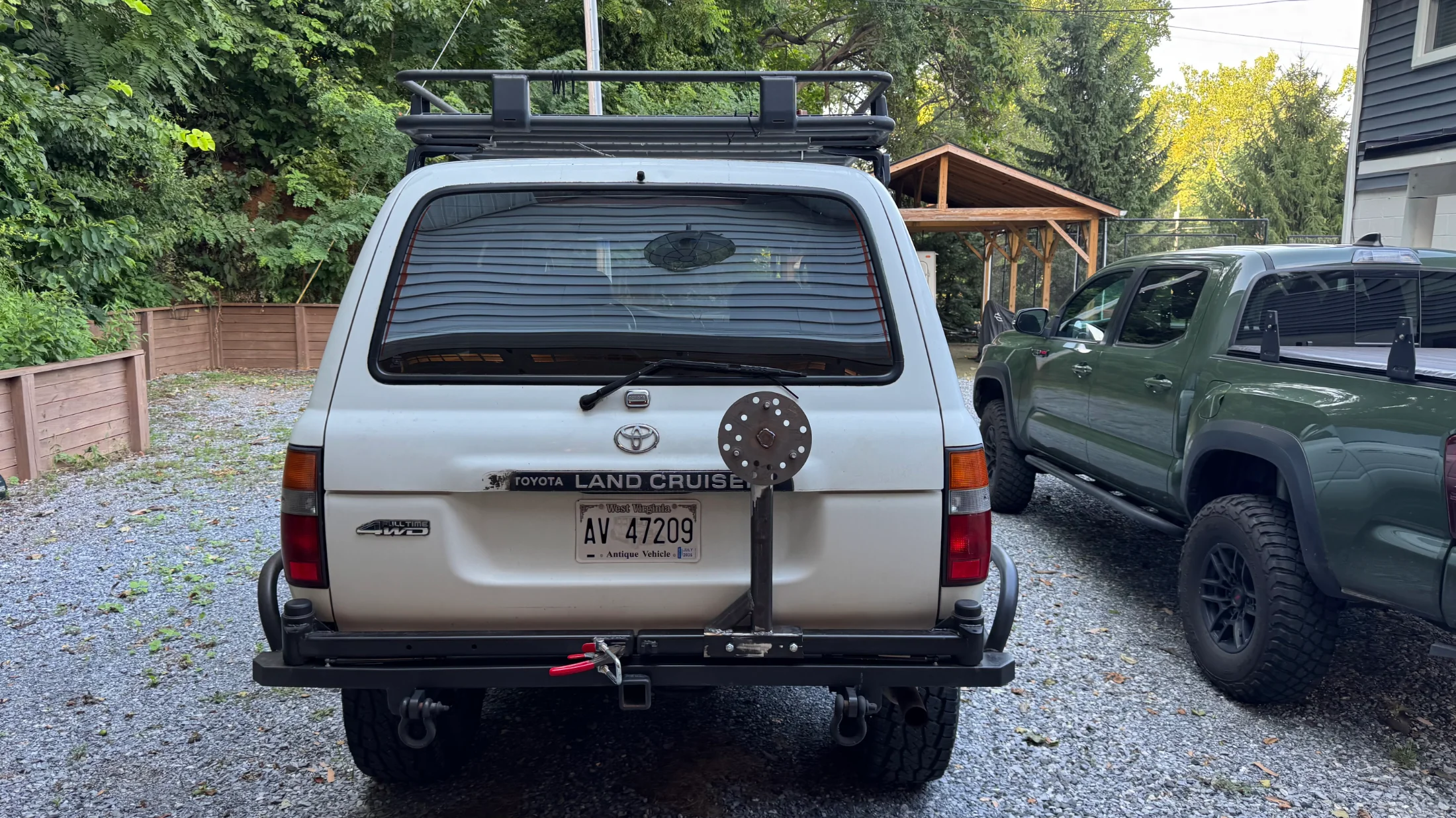

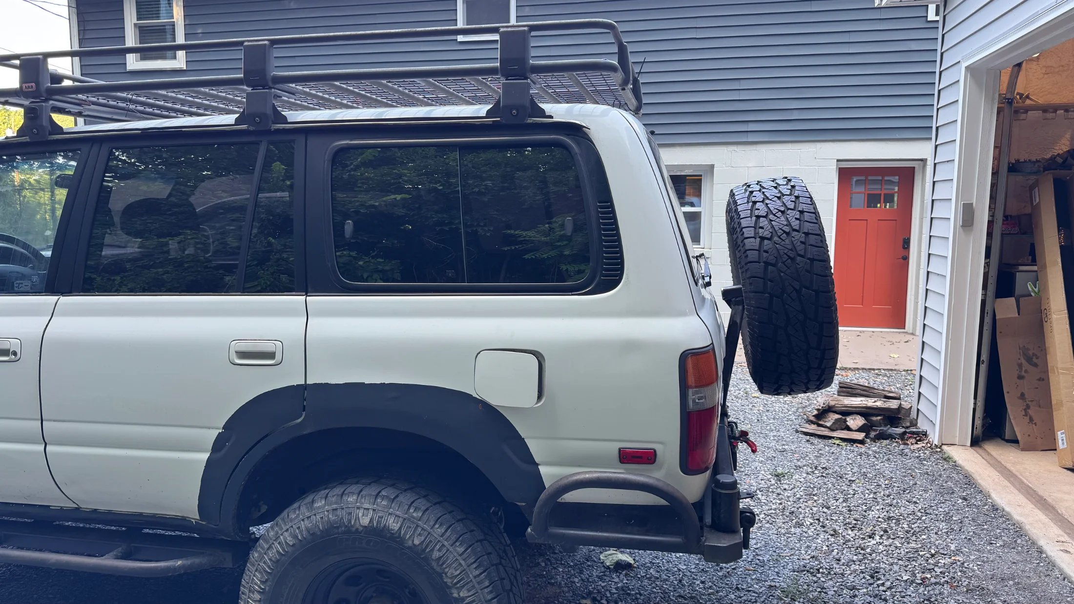

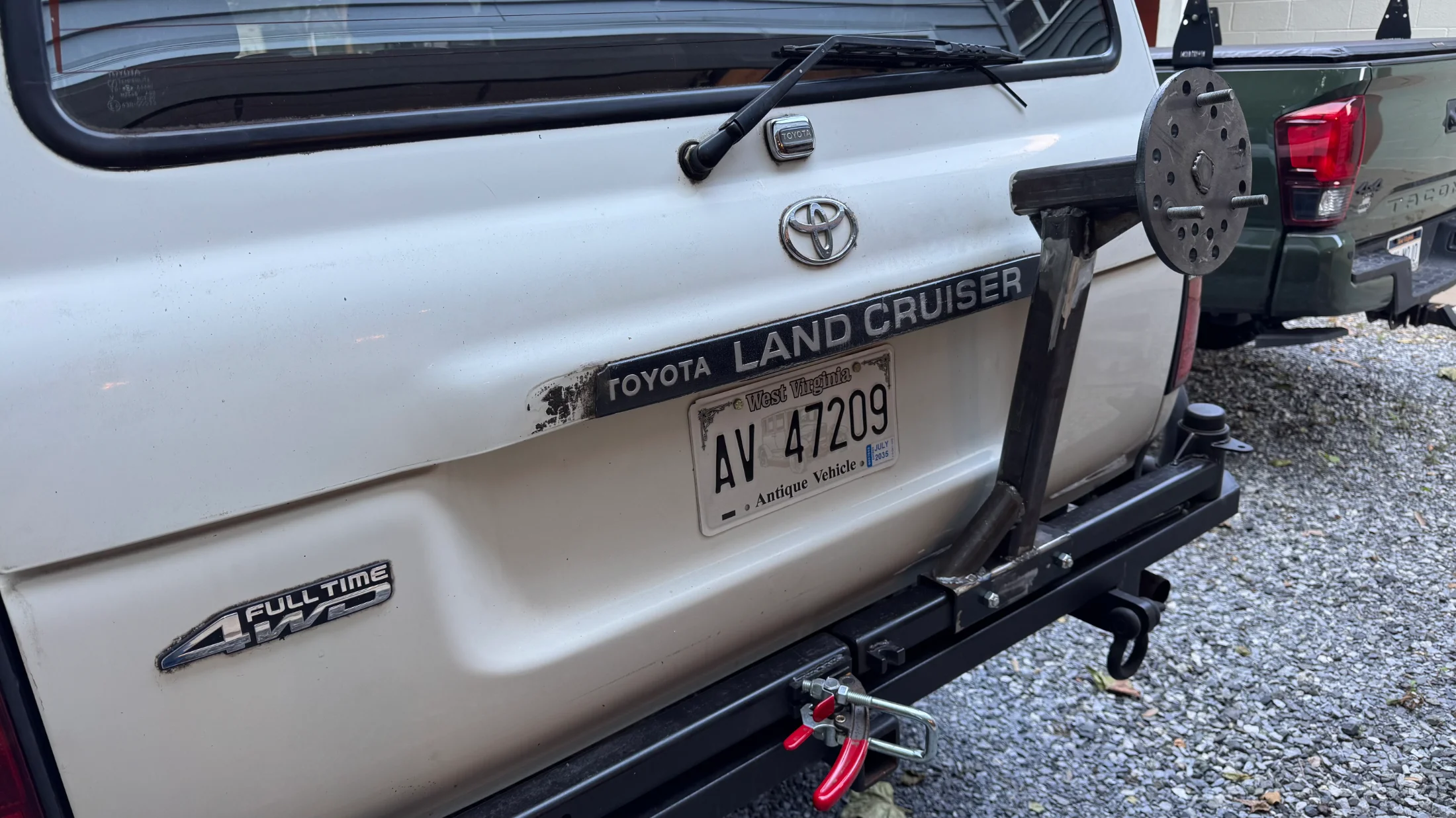

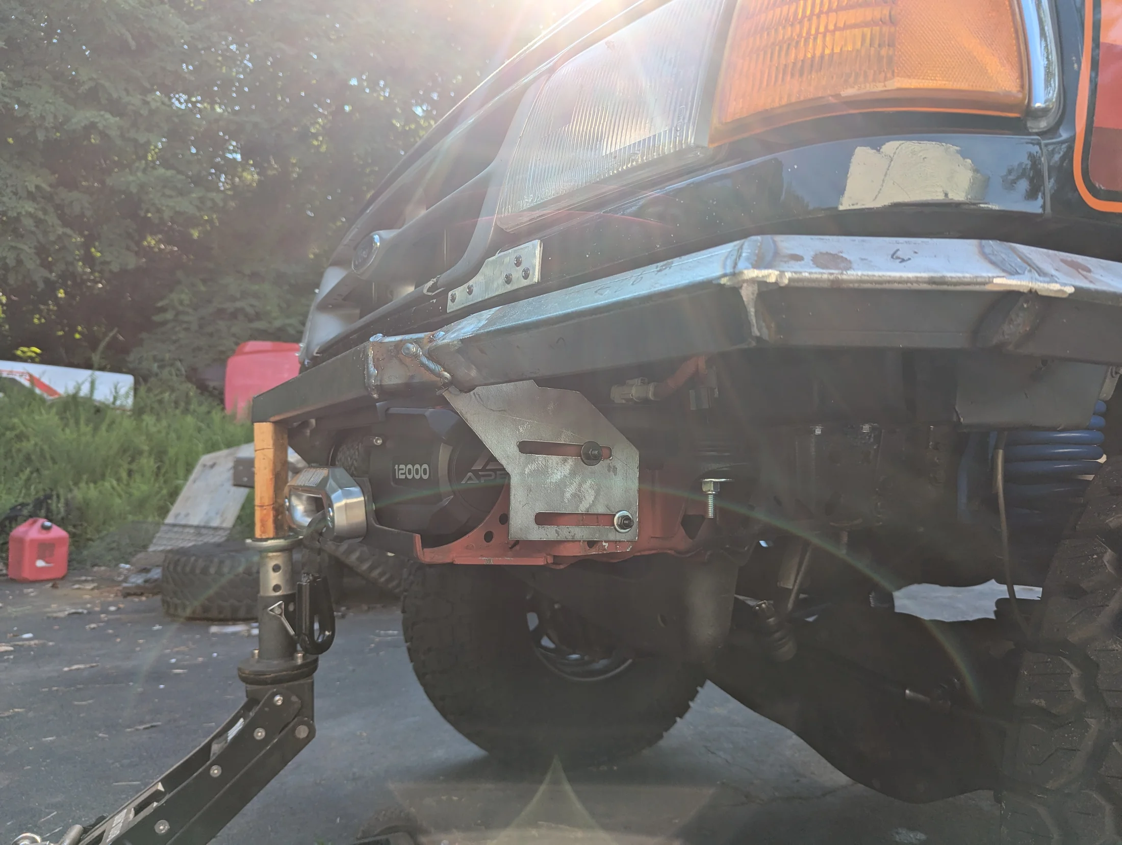

I’ve been working on the install of my TCC bumpers as well! I was in the first preorder batch as well. Talked with Aidan yesterday and they’ll be revising the mounting hardware for the front as you mentioned so mine is also only mounted with the 4 main bolts right now too.
I’ve got to wrap up wiring and some other minor details. Ohh and I’ve been struggling to get my comeup winch back together after following the instructions to clock it. Have not prioritized it since I won’t mount it to the bumper until it’s fully locked on. Comeup is ready to do all call with me when but paint pens to help alignment and 3 attempts failed so far.
Posting my bumpers, rust free crossmember and trailer receiver hitch as free for pickup in the for sale thread.
View attachment 3965871View attachment 3965872View attachment 3965873View attachment 3965874View attachment 3965875
Looks great! I was told there were 11 in the first batch, so that's kind of crazy that 2 are here in the DMV. Hope to get the correct hardware soon.

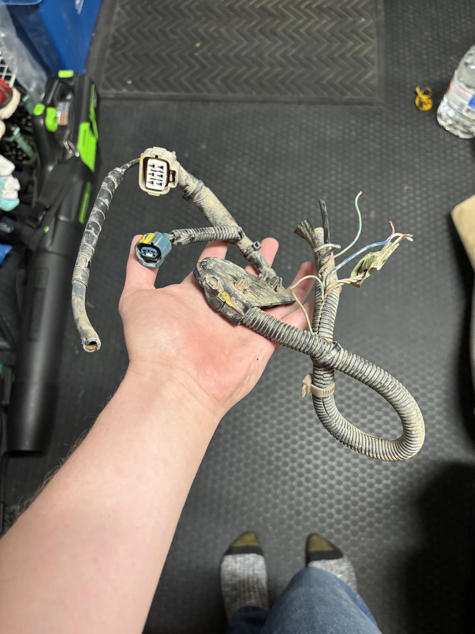

After looking at the locking rear diff harness pigtail at the meeting on Wednesday, I finally went and pulled the pigtail from the truck. Definitely confirmed my suspicions that there was in fact a breather coming from the actuator, separate from the diff breather, that’s wrapped in the harness so wasn’t as noticeable.
Since I have the pigtail pulled, and I didn’t want stuff getting into the actuator vent (see pic below), and didn’t have tubing lying around, I went ahead and blocked off the actuator with electrical tape.
At the time, I thought “surely this is not going to lead to problems because the actuator isn’t getting powered, so it won’t need to vent”, but I have a trip to Flagpole planned for tomorrow morning and now I’m having second thoughts.
Is there any risk in blocking off the actuator breather if the actuator isn’t getting any power?
I tried looking this up but most of the info I could find was about the main diff breather, not the breather on the actuator. I also don’t understand why the actuator needs a breather in the first place (why would it be generating lots of heat + wouldn’t said heat make its way through the regular diff breather?) but that’s less of a concern.
Any thoughts on this? I guess I could unblock the actuator breather and stop at a Home Depot if necessary tomorrow morning.

There was a debate about the two breathers sharing air space, but i think it came down to the breathers are independent of each other. Locker breather being closed prevents locker from moving, diff breather is for the axle. So i think for now, if the lockers not hooked up, you can just cap it.
You can buy a multi pack of vacuum caps at the parts store. Or even so 1/8" vacuum line to make a breather

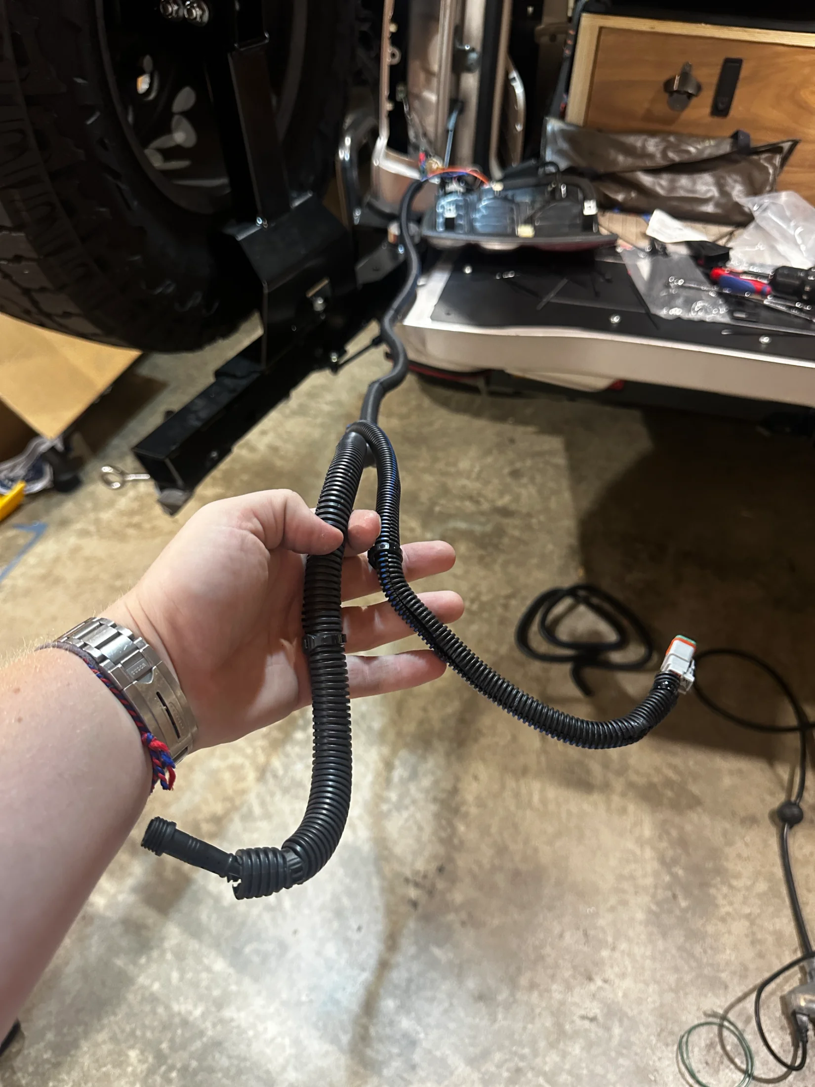

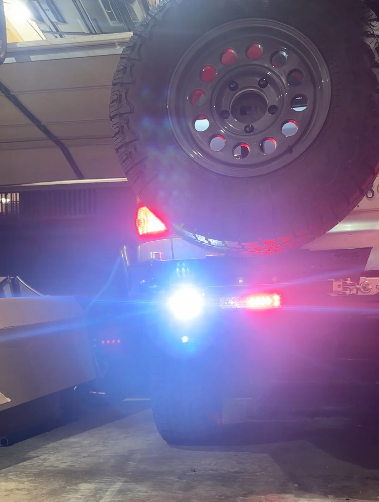

Built a loom for the bumper lights. Spliced into the taillight instead of the trailer wiring. Now to repeat on the other side.
Wiring is a lot more enjoyable when you have a tailgate to work on, not at a weird angle and have the right tools and supplies.
