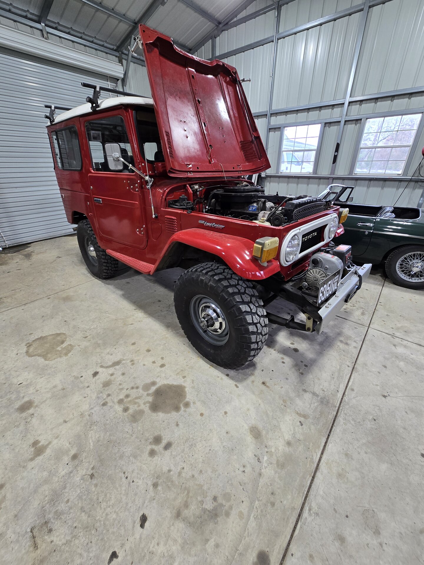

I'm starting this thread to document the maintenance and upkeep for my wife and I's '76. We went in halves on this truck a couple years ago. We bought it from some good friends to use as just a driver. The wife drives it way more than i do, that's for sure. That alone makes me happy. I feel fortunate to have a cruiser head for a wife. She loves them as much as I do.
We are going to be taking it on a trip to Asheville NC via the Blueridge Parkway on Memorial Day weekend. It's going to be a little over 800 miles round trip.
Got a list of stuff to get done and ready for that.

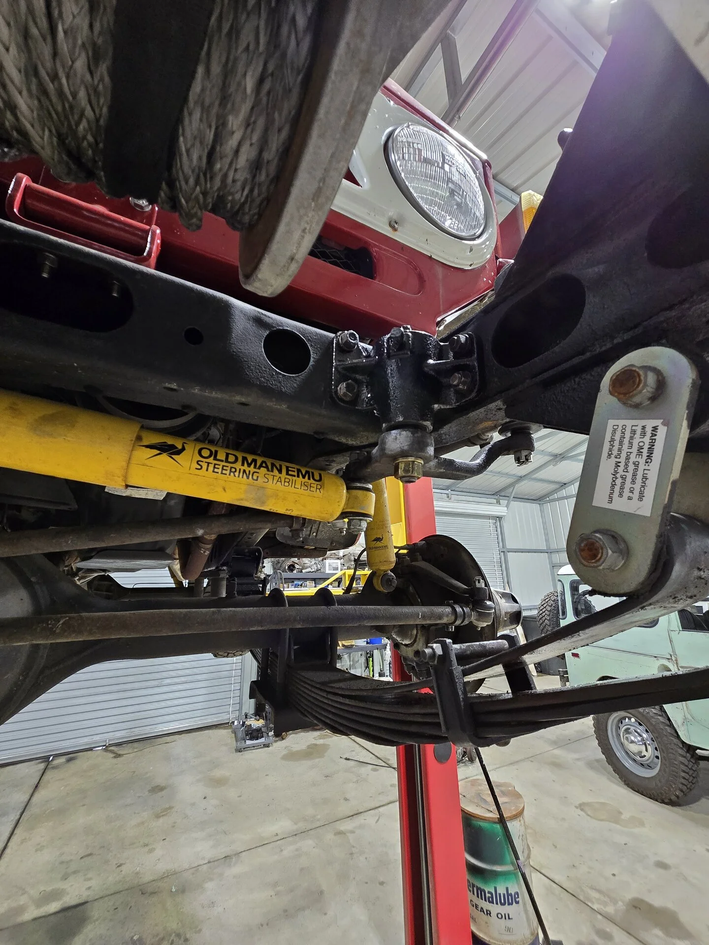

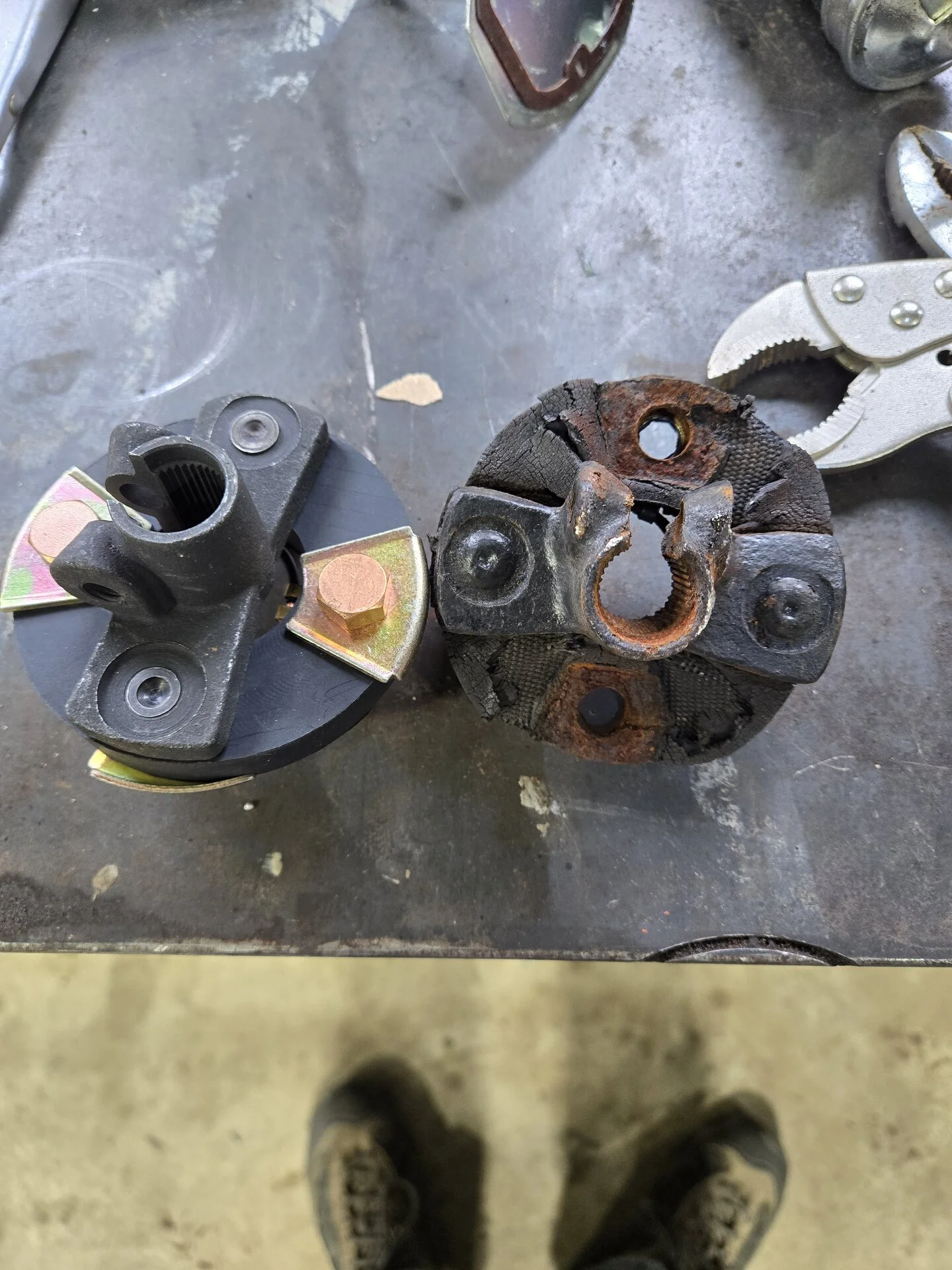

All the parts came today from Cruiser Outfitters and I got rained out at work so I got after a few things. First I replaced the worn out rag joint on the steering. I had a spare center link on the shelf so I tore It apart, cleaned it up, and rebuilt it. I will get the truck on the lift tomorrow (if it rains again🫰) and change out the TRE's.
Wrapped up the steering today. Will be starting on the axles this weekend hopefully. I have to put a brake MC and booster in my buddy's CJ Saturday.

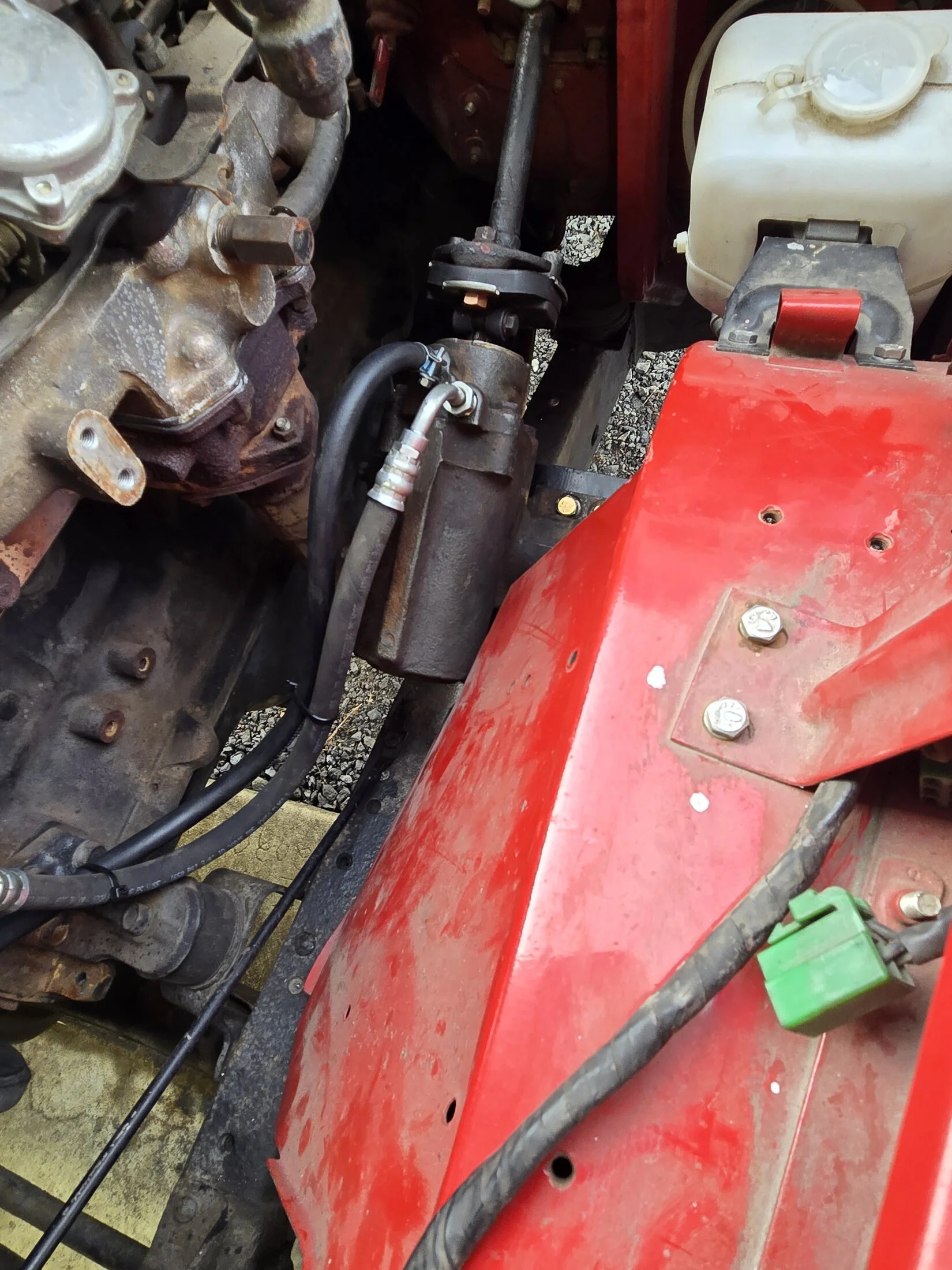

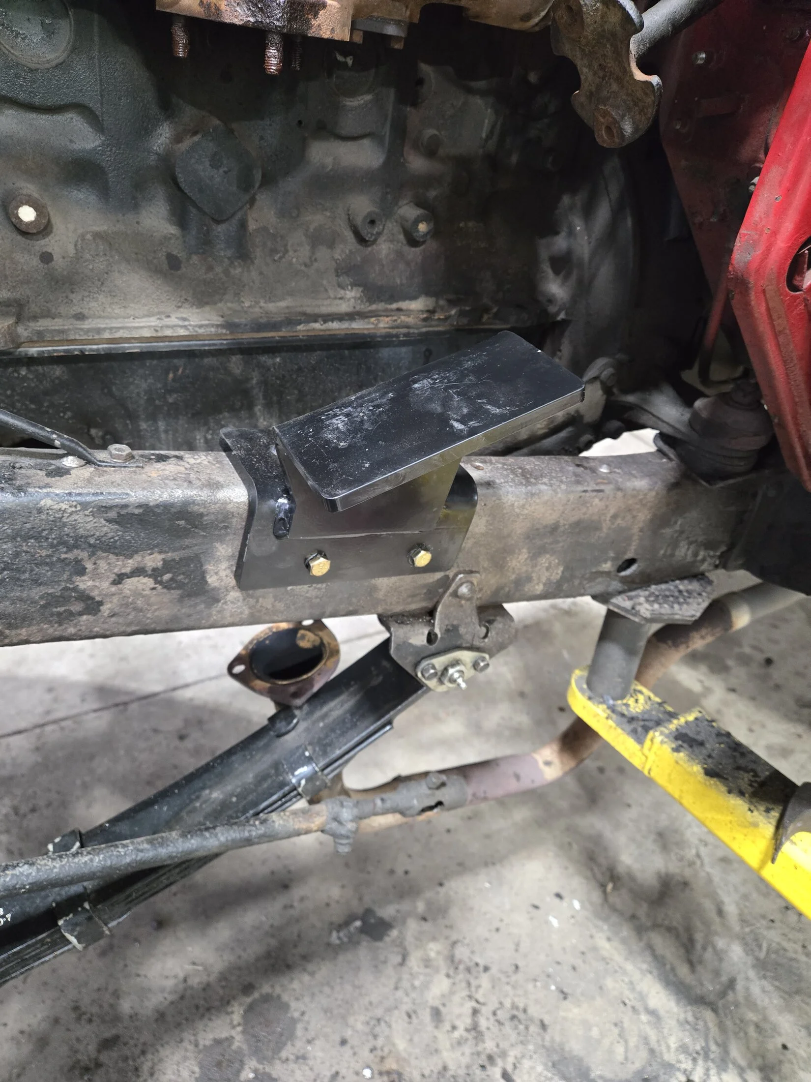

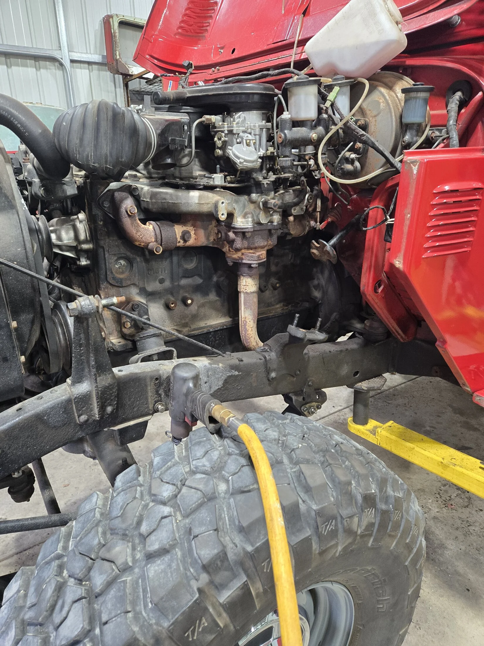

This weekend I got back to getting this more comfortable for the wife to putt around in. Swapped out the OME springs for some Pro Comp 2.5" ones, and started on the mini truck power steering swap. I will finish the swap in the next couple days, then its on to putting a clutch in that I've had on the shelf for 10 months. New Bilsteins will be here this week from City Racer.

Been busy with work so the power steering finally got finished yesterday. The wife is grinning ear to ear. Much smoother ride and easy steering.
