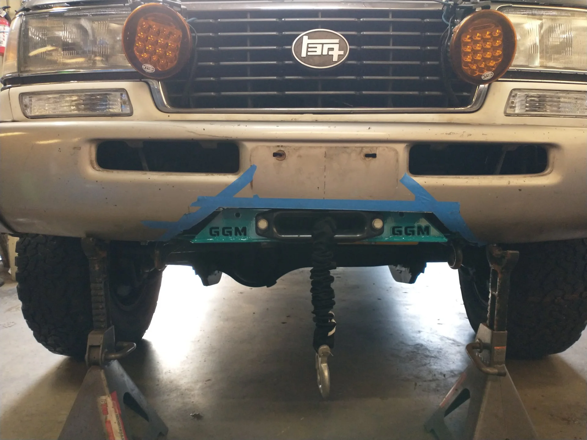

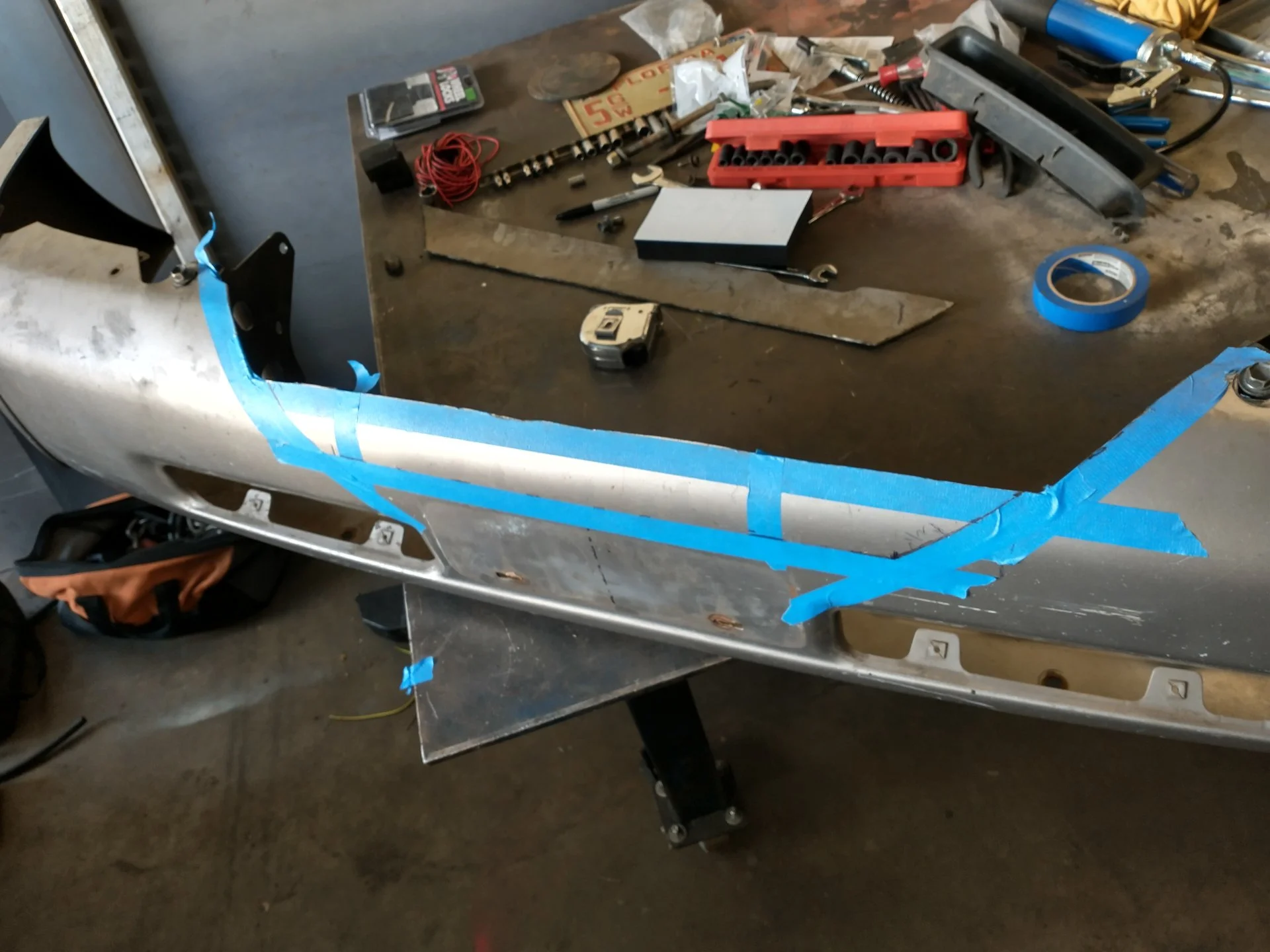

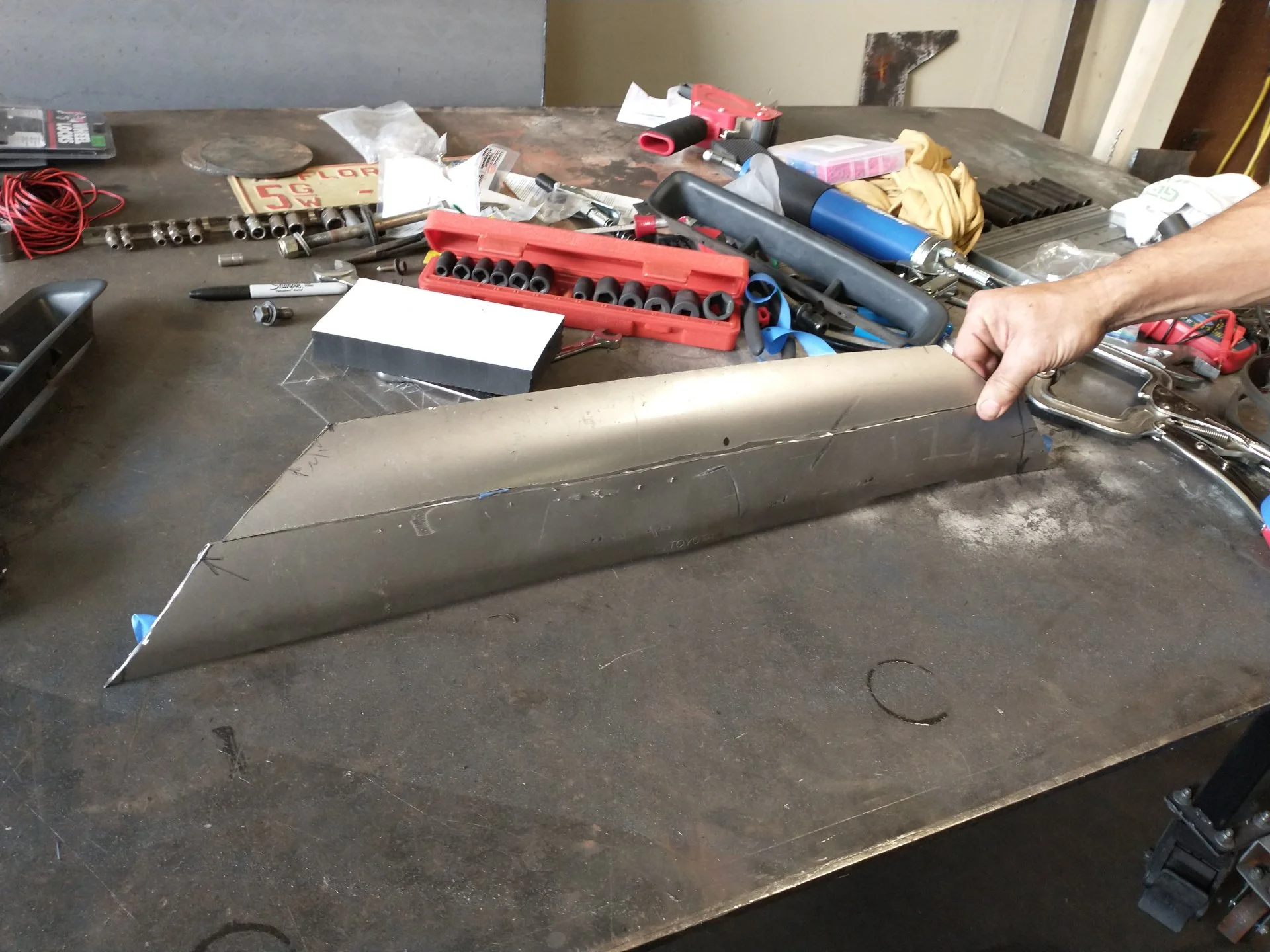

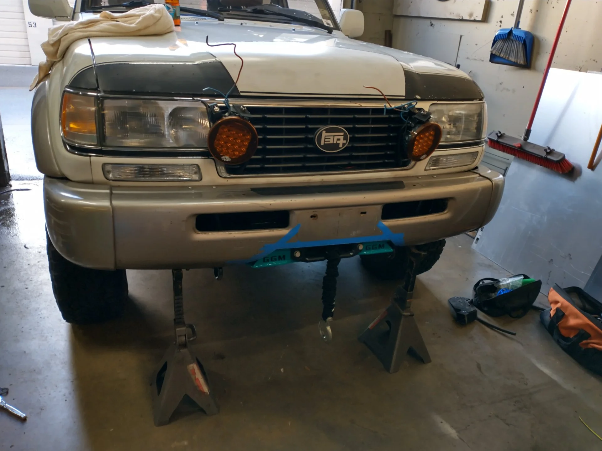

Finally got around to cutting up the front bumper. It actually turned out nice and was really easy. The bumper is sitting on the jack stands so it isn't perfectly straight in the pictures. But everything clears nicely. The last picture is what was cut off. It stays pretty hidden while retaining a lot of the bumper.

But this is a simple solution with minimal cutting - @ETCruiser - did you use a sawzall or grind to make the cuts?

Yes, I took off about 3/16" off each edge, that should be enough.
Great...for the ARB bumper, it did need a little taken off, so 3/16" should be perfect. For me, I used a diablo flap wheel on my small grinder on the mount plate and my regular Dremel with a cutoff wheel for the bumper. Hope this helps!
a regular dremel and cut-off wheel to trim the bumper down? that's sweet and dead simple... thanks @ETCruiser

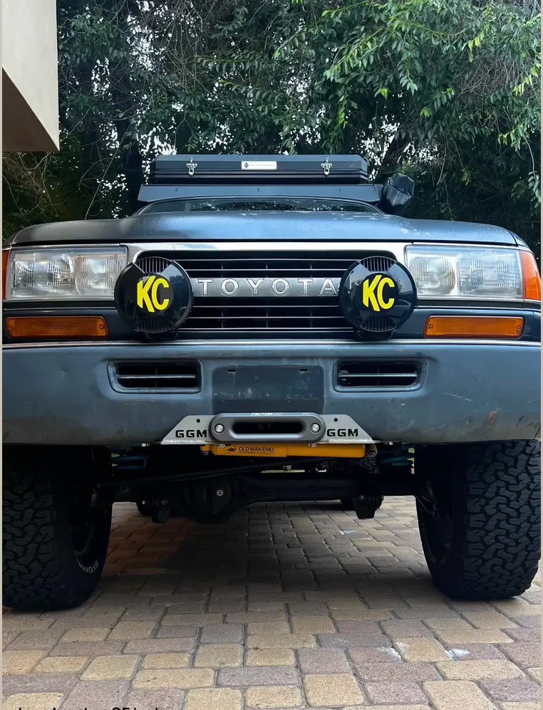

Do you have a picture of the hidden winch and bumper installed? Like to see how it turned out. Considering this for my 94.
