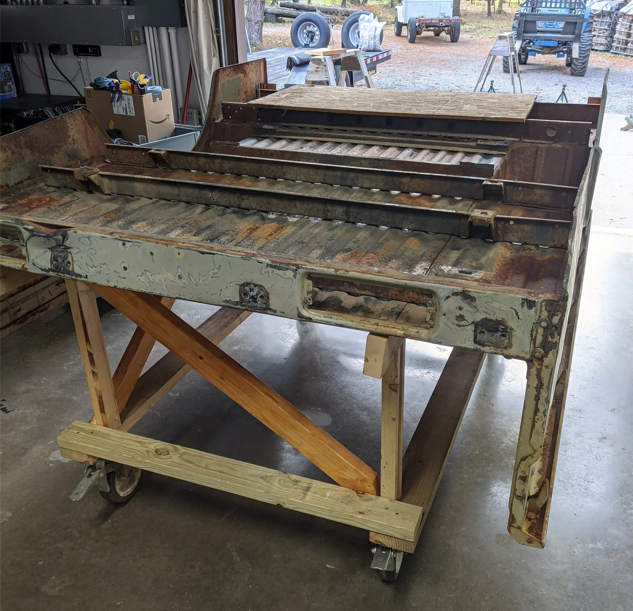

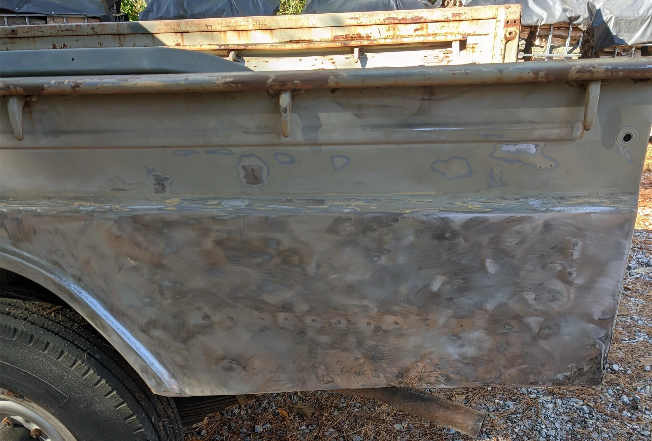

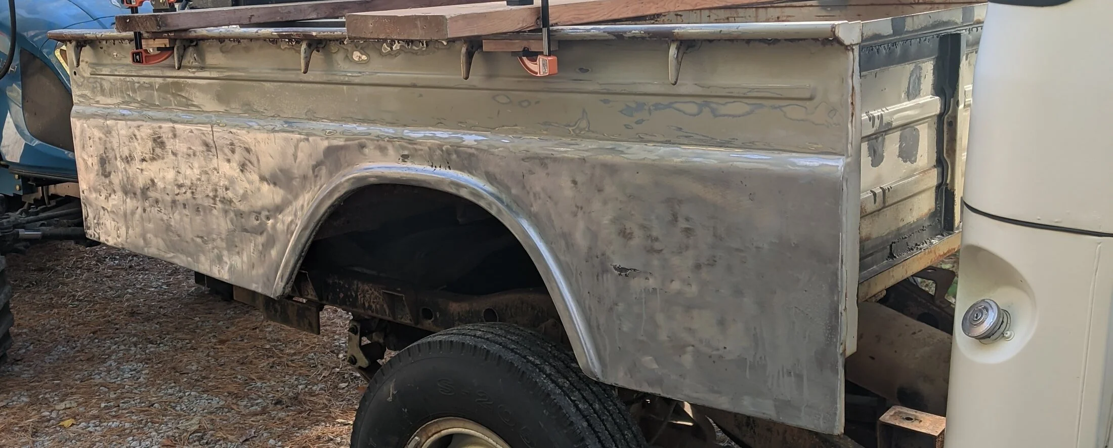

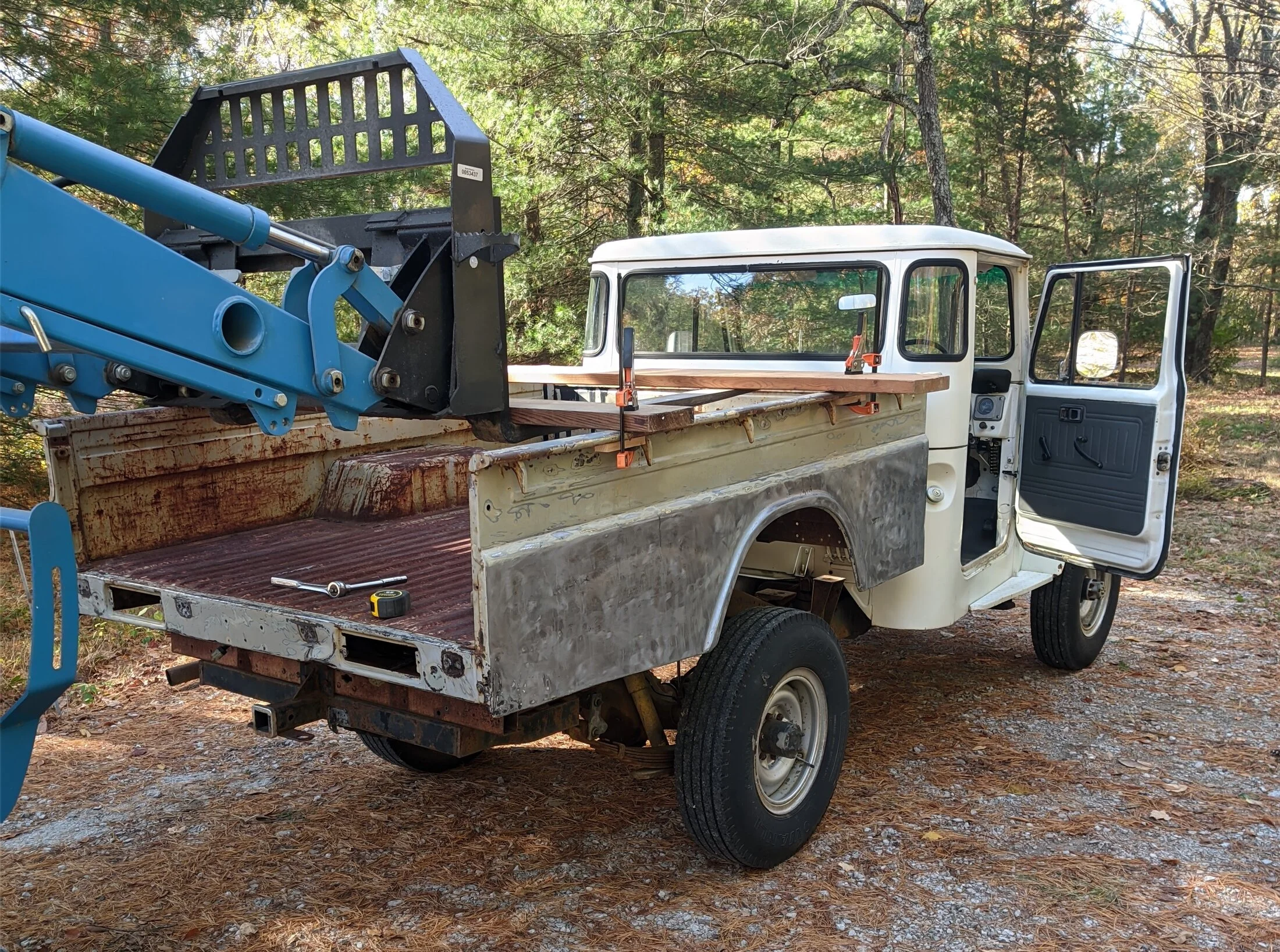

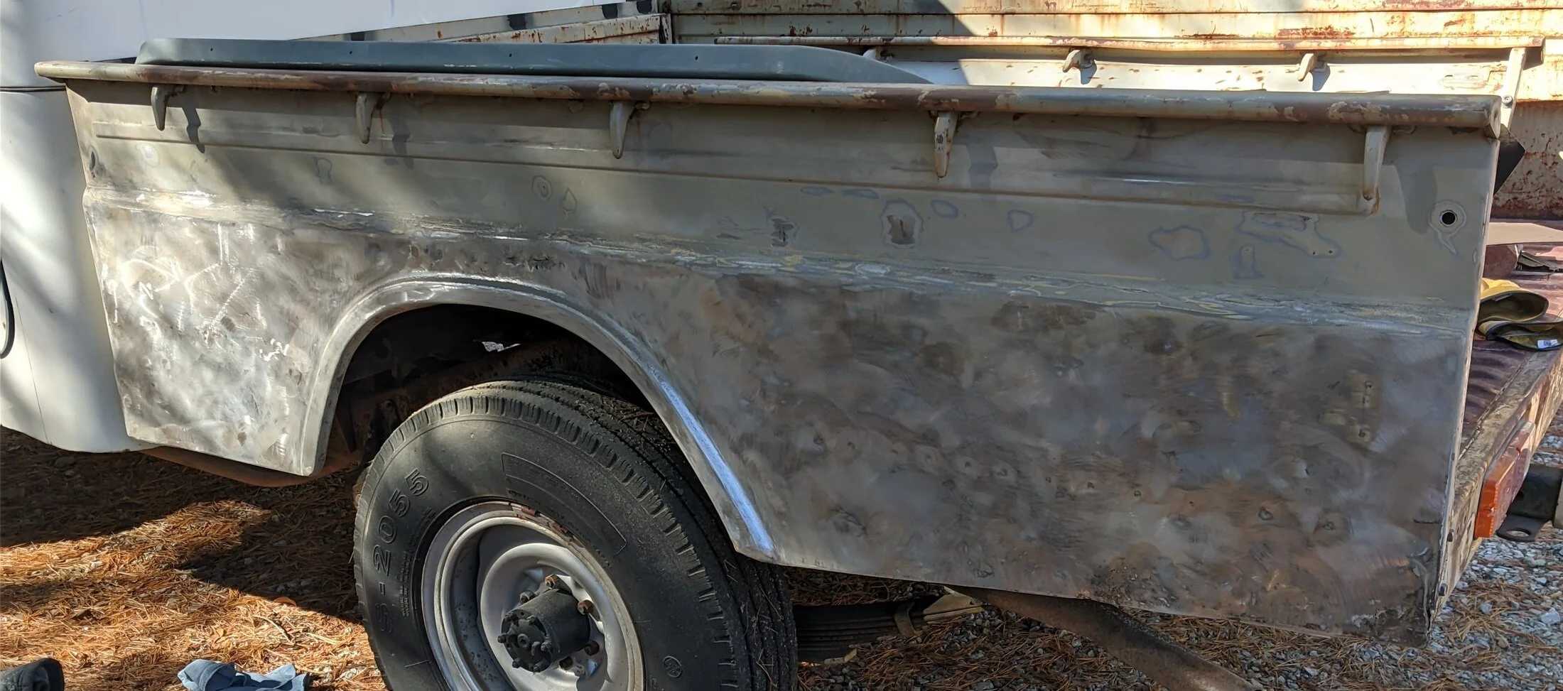

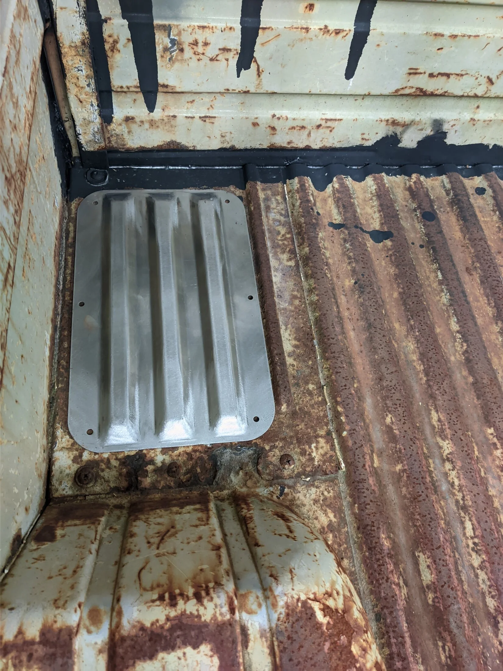

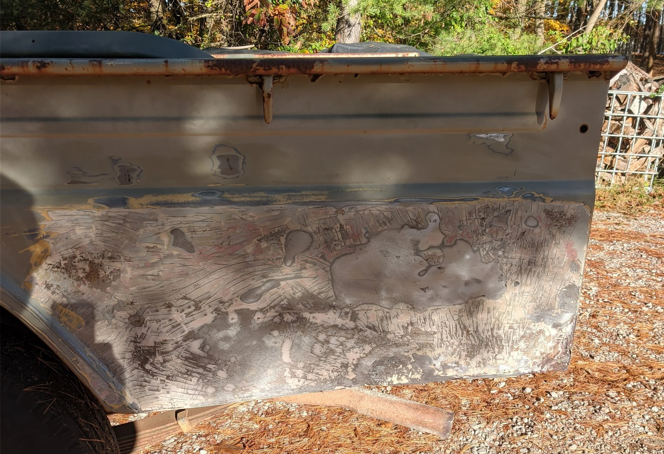

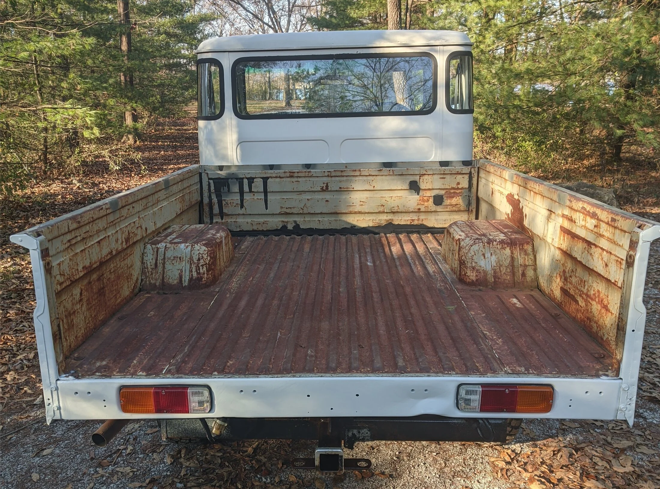

I have made some progress on the bed. I got the bondo removed from the exterior. (found that a heat gun and chisel are very effective) I was extremely lucky and found very little rust and holes. Lots of dents but that's fine. I think I'm just going to fix the pinholes with some JB Weld and see how that does. I was able to buy a can of matching spray paint from paintscratch.com I think it probably matches the original, but not super close to the paint I CLR treated and polished on the hood. So, I think I will just go with Rustoleum Canvas White. I don't have a lift, but I do have a tractor so I removed the bed yesterday. This gives me access to clean up the frame and FF and also do the underside of the bed.

I was just taking an awl to the little bubbles and then the awl slid about 1'' under bondo. So I guess now the truck has a pretty good battle wound to show off.
