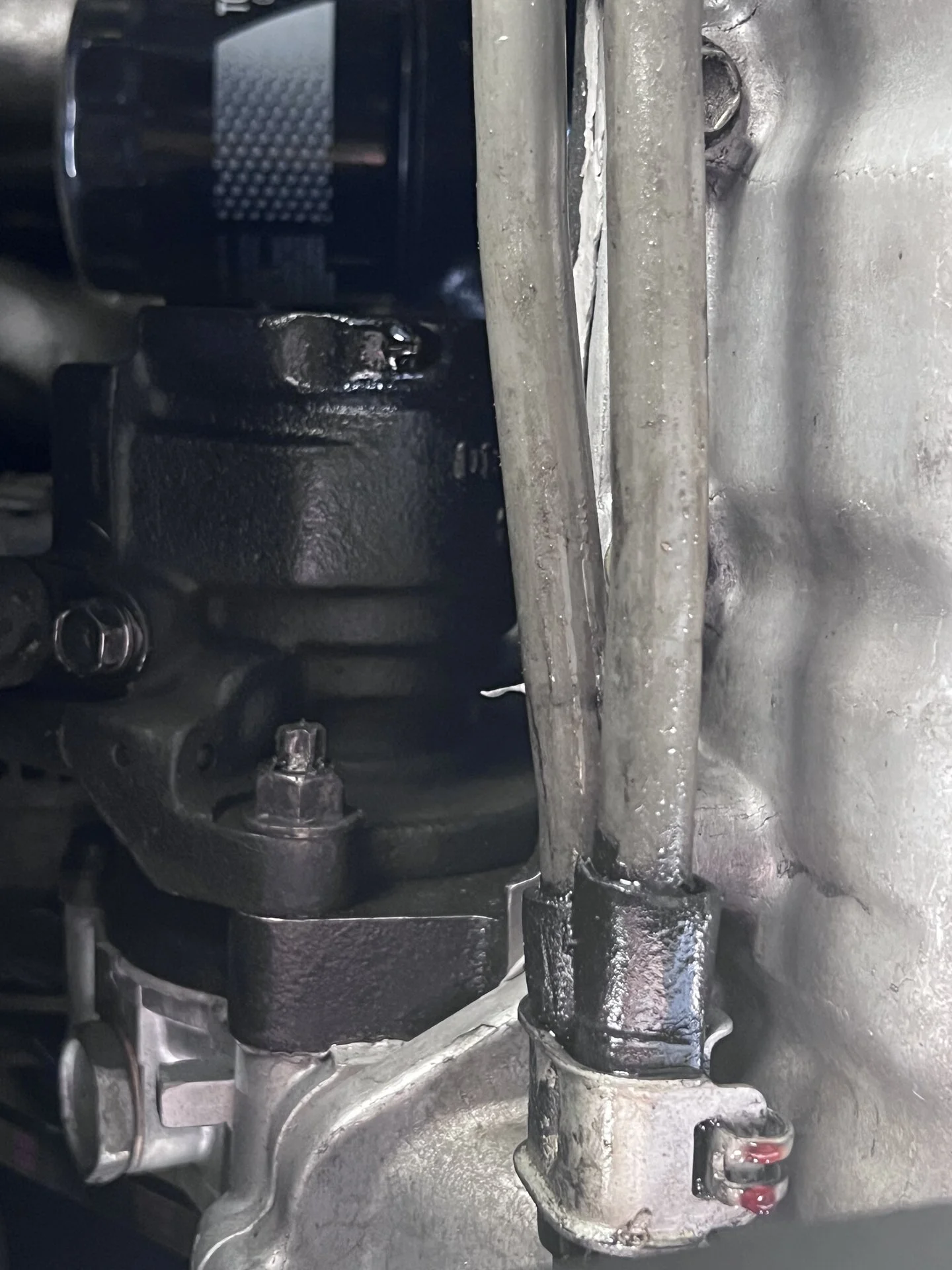

My PS seems to be leaking a bit from the rear end of the pump. It honestly doesn't leak a ton, maybe a few drops every week and everything else seems to be fine including the hoses. Is it worth fixing? If so, should i just replace the gaskets(Power steering pump gasket kit (04446-60080)), just rebuild or should i just replace the pump entirely? Any other suggestions would be appreciated too. Thanks

The engine looks very clean and the couple of bolts for the pump shown in the photo appear to have been turned in the past; has the engine been worked on, has the PS pump already been replaced??

@Kernal The PS pump has never been replaced, but it was pulled off when I was doing my engine rebuild. good eye:wrench:
