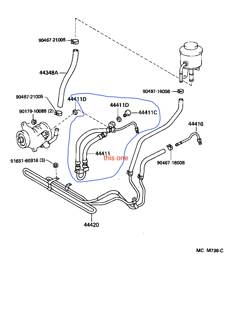

Using the UV dye, i see that the rubber hose of the high pressure line between the gear and the pump is simply cracked. OEM replacement is about $300. I don't want to spend that much. Looking for some recommendations on aftermarket hoses that will last. I see them ranging from $60 to $150 but wanted to ensure someone has tried and tested. Please advise. the OEM part number is 44411-60430. I also attached the picture of it.

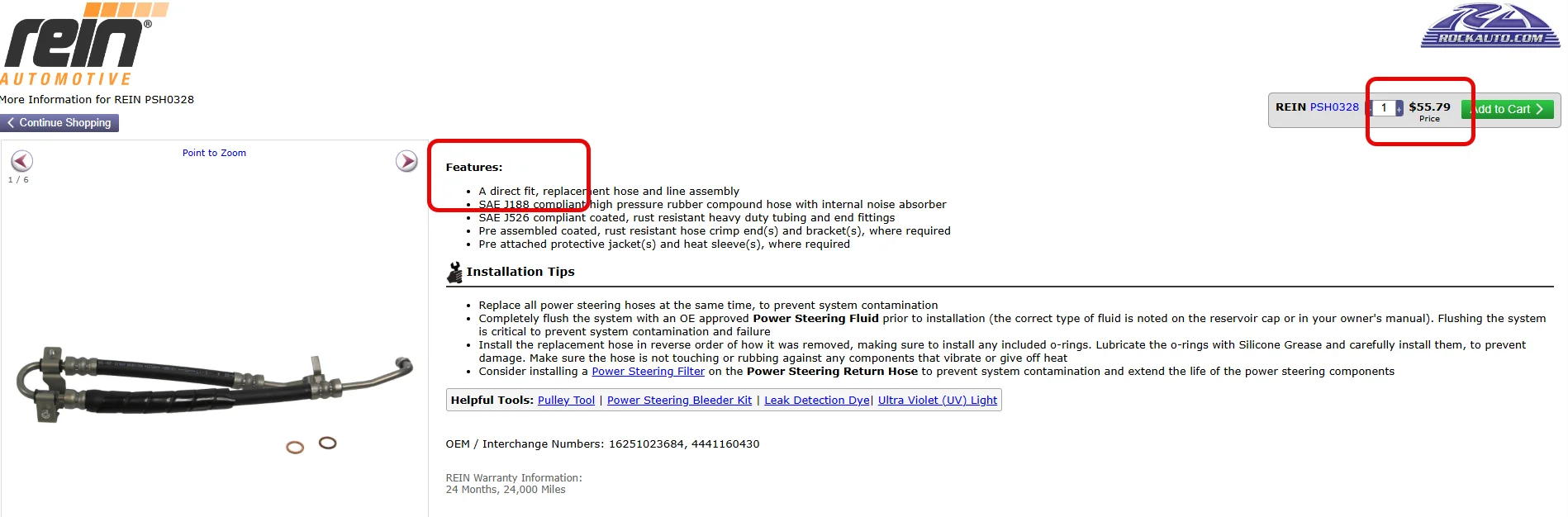

^this. Highly recommend.
I can't tell the difference between the Rein part and the Toyota branded part (except the cost). I've installed two and both are working as expected.
Cost has gone up since I bought my last one, two years ago; they were $40 then.
