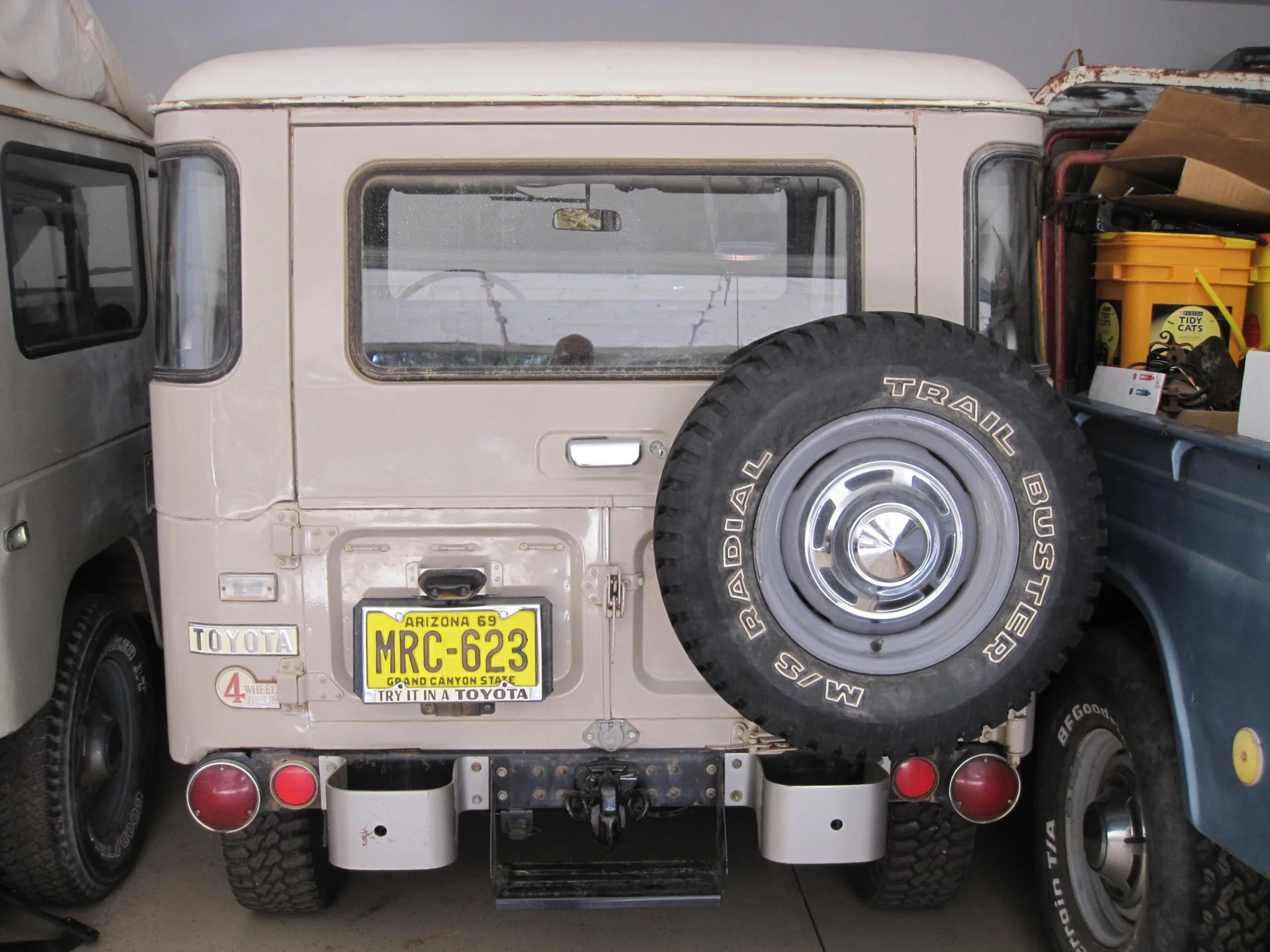

I got my blue/yellow plates from Dave'sCLP or you can find plates at any car show vendor. He guarantees his plates to be good. Then you can register them under CA DMV's YOM-Year Of Manufacture program. Pretty easy to do. Just have to have a correct year (for your LC) sticker attached to plate which he also sells.

Where was this 72 located? Arizona is probably one of the worst states as far as emissions depending on what part of the state you live in. Phoenix/Tucson areas anything from 1967 on requires emissions. The rest of the state has no emissions. That style license was the first time AZ issued a new style plate it was required to replace the previous plate. Years ago a license plate stayed with vehicle when sold. My 89 FJ62 was a couple years old plate came with the original which it still has today. My 73 FJ40 came with the original plates issued in 1973. In Arizona I will be allowed to use those plate again. Unlike all the specialty plates AZ now has that come with an extra annual fee those plates have no extra fee. Have plates that matchy cruiser's build dates I could use in Arizona.

Fairly sure it was in Bagdad (Freeport-McMoRan company town!), but will confirm when I get home. His address was on a few of the parts he ordered from Man-A-Fre when they were still in CA. EDIT - confirmed Bagdad, AZ.
Interesting about AZ emissions, had no idea the metro areas were really strict like that. Kalifornia of course is silly too...
