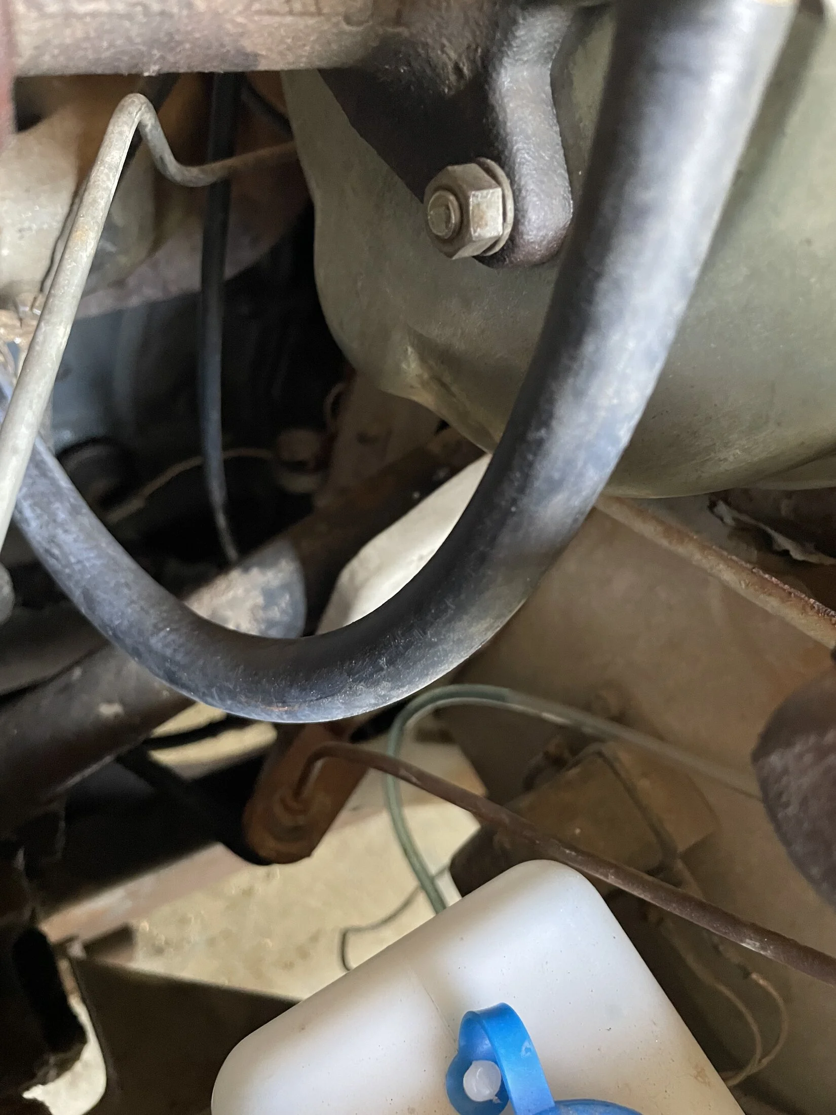

After much bleeding and hemming and hawing, decided this morning was the day to take it down to AAA and finish out registration. The brakes are not nearly where they need to be, a lot of pumping and then it loses pressure. This suggests a bad master rebuild on my part - there is one part that I didn't swap out, the seal that sits between the front and rear brake sections of the master. Since the one in the rebuild kit had seals that were a bit hard, I decided to just reuse the old part.... which was probably a mistake. I have the new part marinating in some clean brake fluid right now and the seals are getting a little softer, so that will be going in the master once I have a minute to take it back off (and redo the bleeding fiasco all over again).
Hard to tell here, but it looks like a little bit of brake fluid was seeping past the seals and onto my freshly rebuilt booster. No idea if the master is bad or if it's just that one part, but going to start with the one part and go from there.

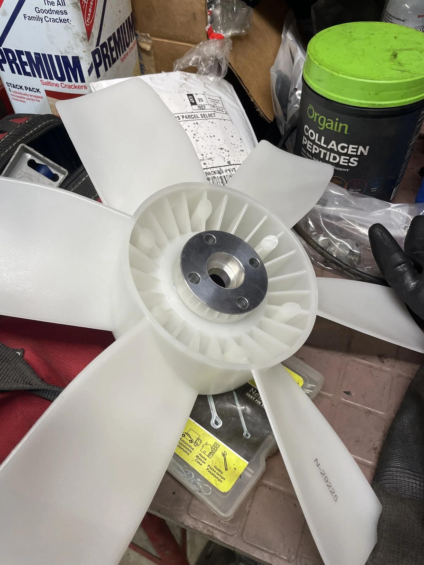

Fan and spacer procured from Mark's Off Road @65swb45 yesterday, quick work from home trip to the other side of the hill and was back in time to wrap up the day at my desk.
These look almost too nice for my rig!

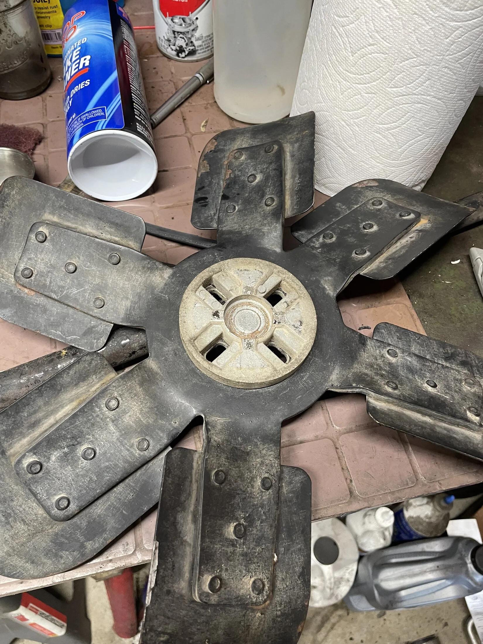

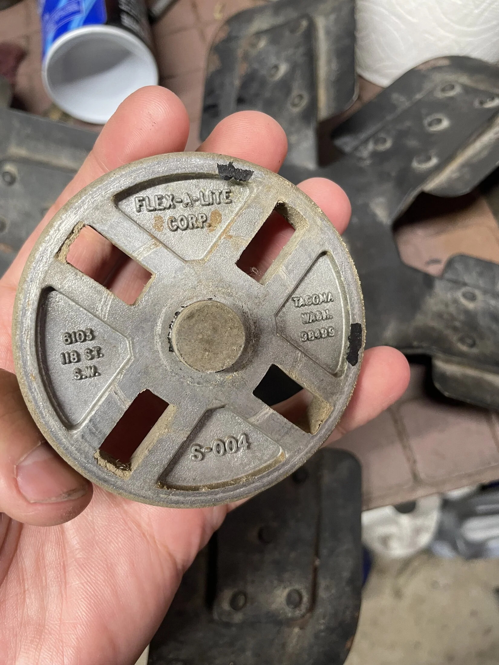

Was able to pull the old fan and shroud earlier this afternoon. Looks like this has been on here a while, kind of cool markings on the spacer but it all has to go. My guess is that these adjustable holes can lead to mounting the fan off-center, which then goes shortly to fragging the water pump, radiator, hood, who knows..
Puck, now a paperweight:
