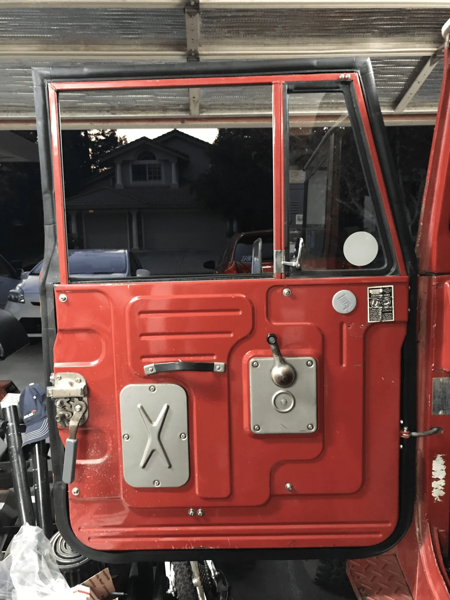

Is there any way pre-75 doors with the "metal" inners can be made to fit on late-model 40s? Specifically, looking to fit these style doors on a 1982 FJ45. I like the way these look better than the "door card" style I have now.
I think you need to change the striker plate on the B pillar.
Not sure how the late model door limit opener will work on the thinner doors. The early style limit had to open the round opening in the A pillar since the doors are thicker. I changed to later style doors because they are one piece and do not rattle as bad. Any doors you buy check the lower door skin where back post for vent window is for cracks.
Thanks for the info, something to think about. Really don’t want to use the door cards I have. They’re not ugly just very plain.

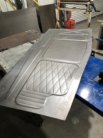

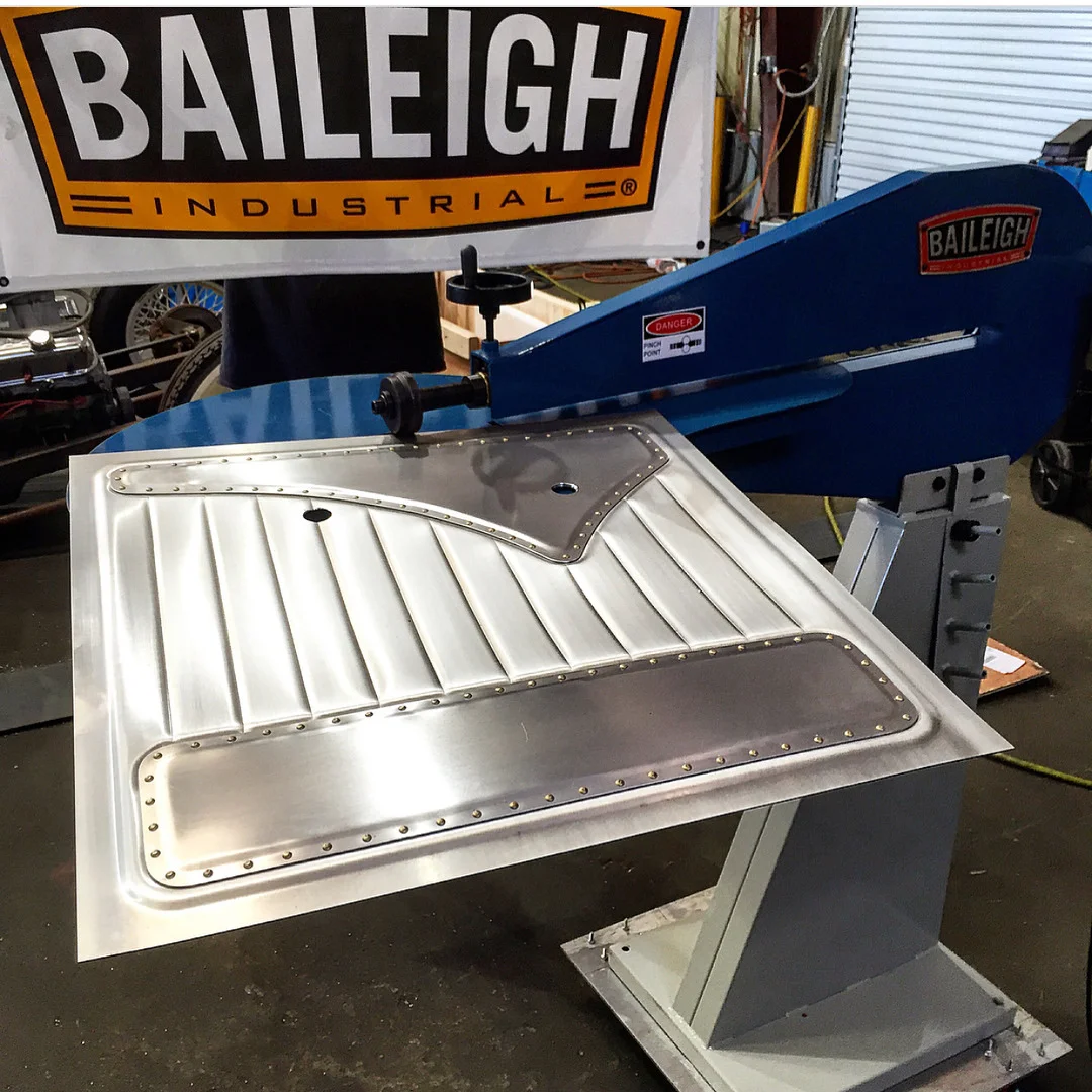

Not really. You could search door cards or something like that. Some vendors sell aftermarket ones. You could easily make up a set.

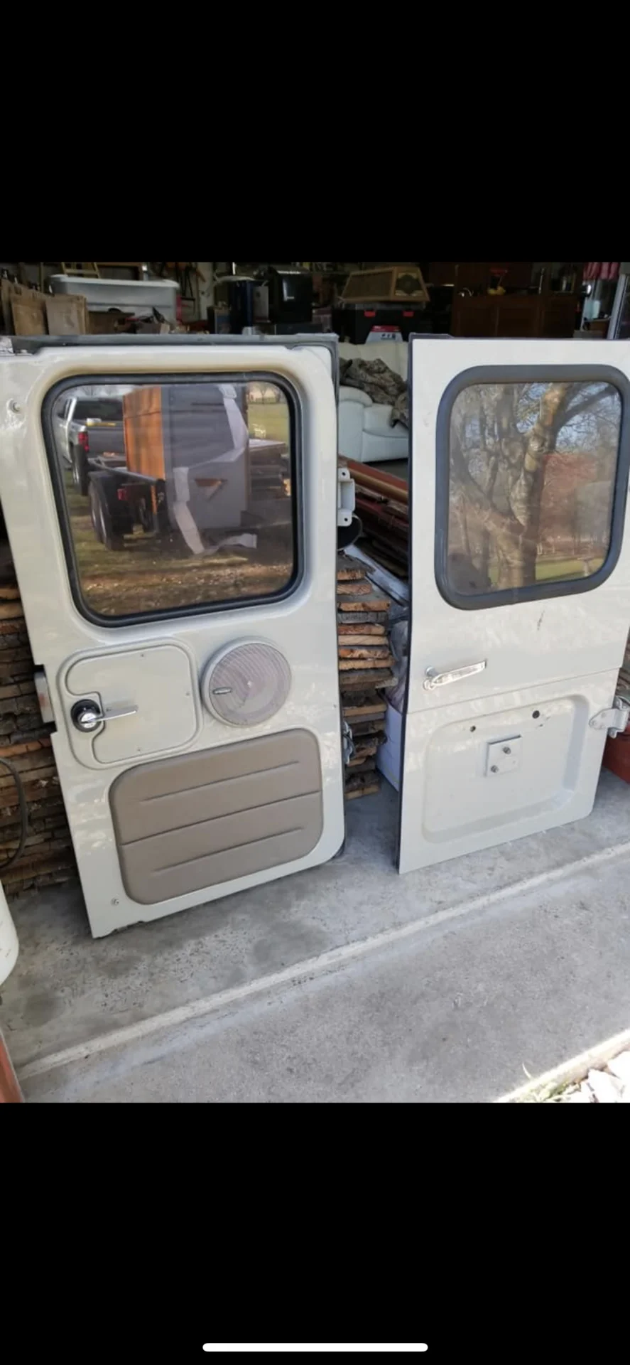

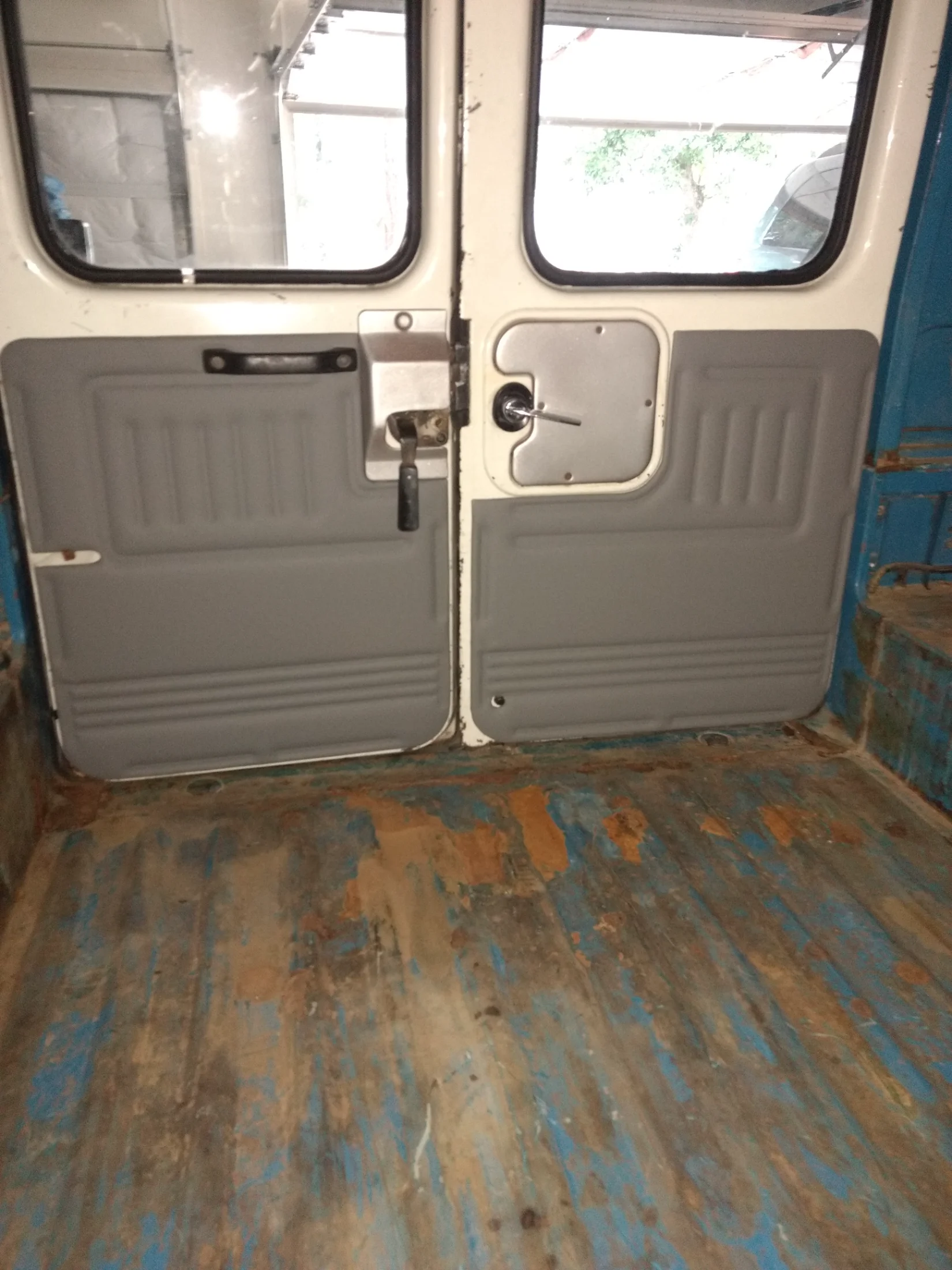

A vantage of the later doors is it's possible to add speakers without cutting the metal skin. My 73 FST came with 72 hard top and doors installed. Door skins were cut in the lower front for 6 1/2" speakers. FJ40 are noisy enough without removing the vinyl door cards and replacing them with metal. 2019 someone posted free cards for the ambulance doors just wanted pictures of the installation and instslled. Have a set of ambulance doors off a wrecked 84 troopy. Doors will never be perfect so didn't mind drilling holes for metal clips.
Save these pictures years ago. These door cards have a built speakers.
This picture shows where there is a hollow space for a speaker in the ambulance doors.
Doors never going to be perfect wouldn't mind cutting the inner skin to install speakers. Sound deadening in the hard top cap. Some type of sound deadening for floors, wheel wells and firewall. Will never sound like the Mark Levinson in a Lexus but I can dream.

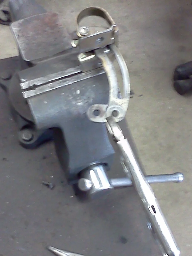

When the early doors were installed on my late model aluminum tub, we changed the late model door limiter by welding the limiter as shown in this photo. The B pillar was good just by bolting on the striker.
Guess that answers the door limit needing to be modified. Been forty years since I added 79 doors onto my 68. Wasn't positive I needed to widen the opening. I've also run FST doors on my 68 which are even thinner than the early two piece hard doors thirty years ago. The striker on the B pillar has different spacing for the bolts. It also needs to mount closer to the outside with the early doors. Going later door on a earlier tub I had make a small adapter out metal to get the door to fit tight.
