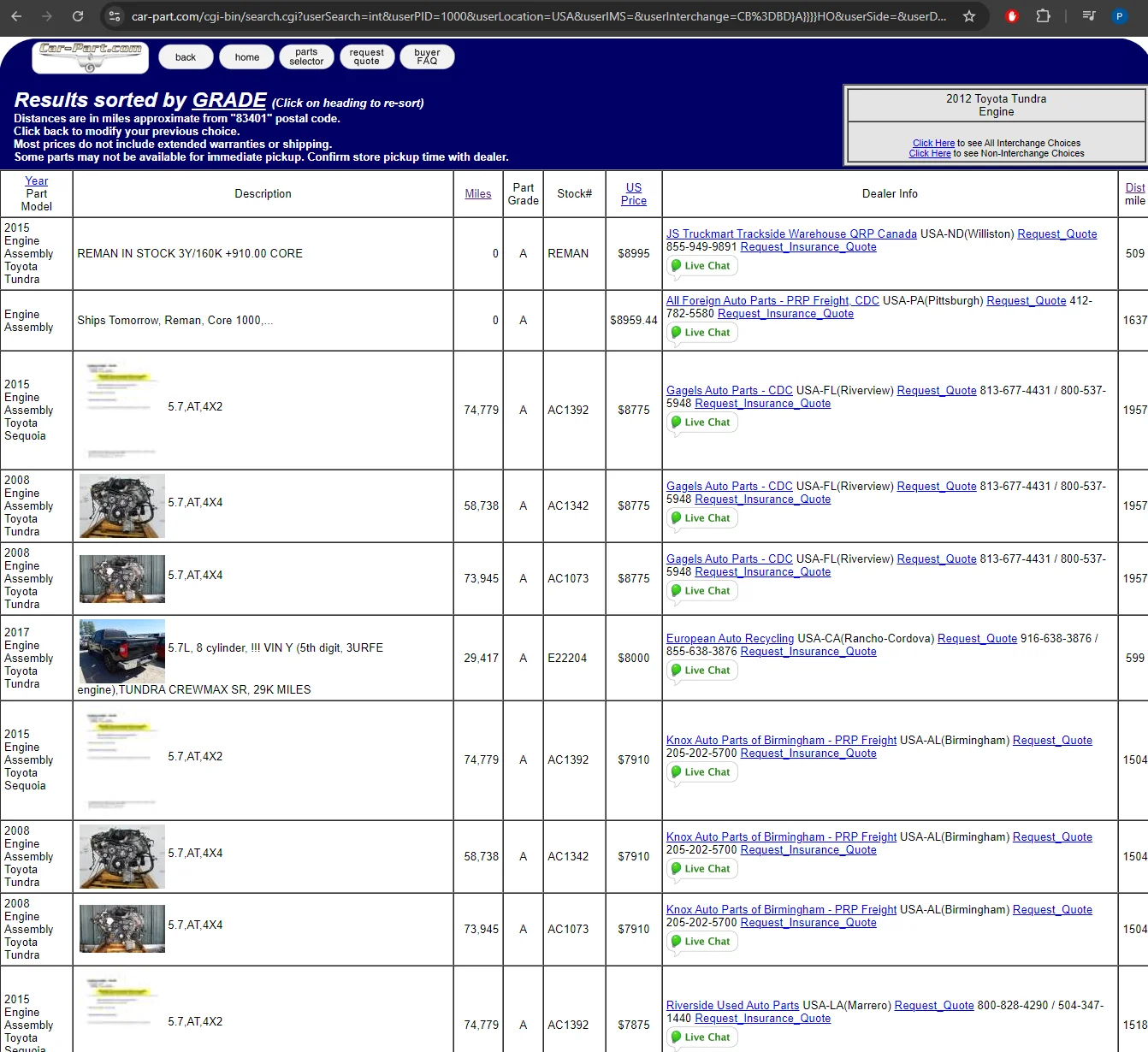

Personally, I would look at wreckers for a good factory sealed engine, that is lower mileage, and rated in A condition from car-parts.com. $6-8k. Plus $2-4k of labor to drop it in and done. Every engine on the road today is a "used engine". It is a leap of faith, but honestly, in my mind, I would do that way before any rebuilt aftermarket engine that has less historical provenance (other than it's built from a core that has suffered as part of some engine failure requiring the rebuild), and slapped together by a shop and crew of unknown quality.
While I like the idea of sourcing new blocks and heads, it's still potentially less desirable for me, because again, you're trusting some general mechanic to do the due diligence in assembly, to get all the bearing clearances, procedure, and stuff right. Mechanics in dealerships aren't engine builders and they don't do internal procedures often.
I'd generally suggest the same strategy but I believe @Bryanmc had a lot of trouble sourcing an engine that actually looked good when it landed in the shop.
